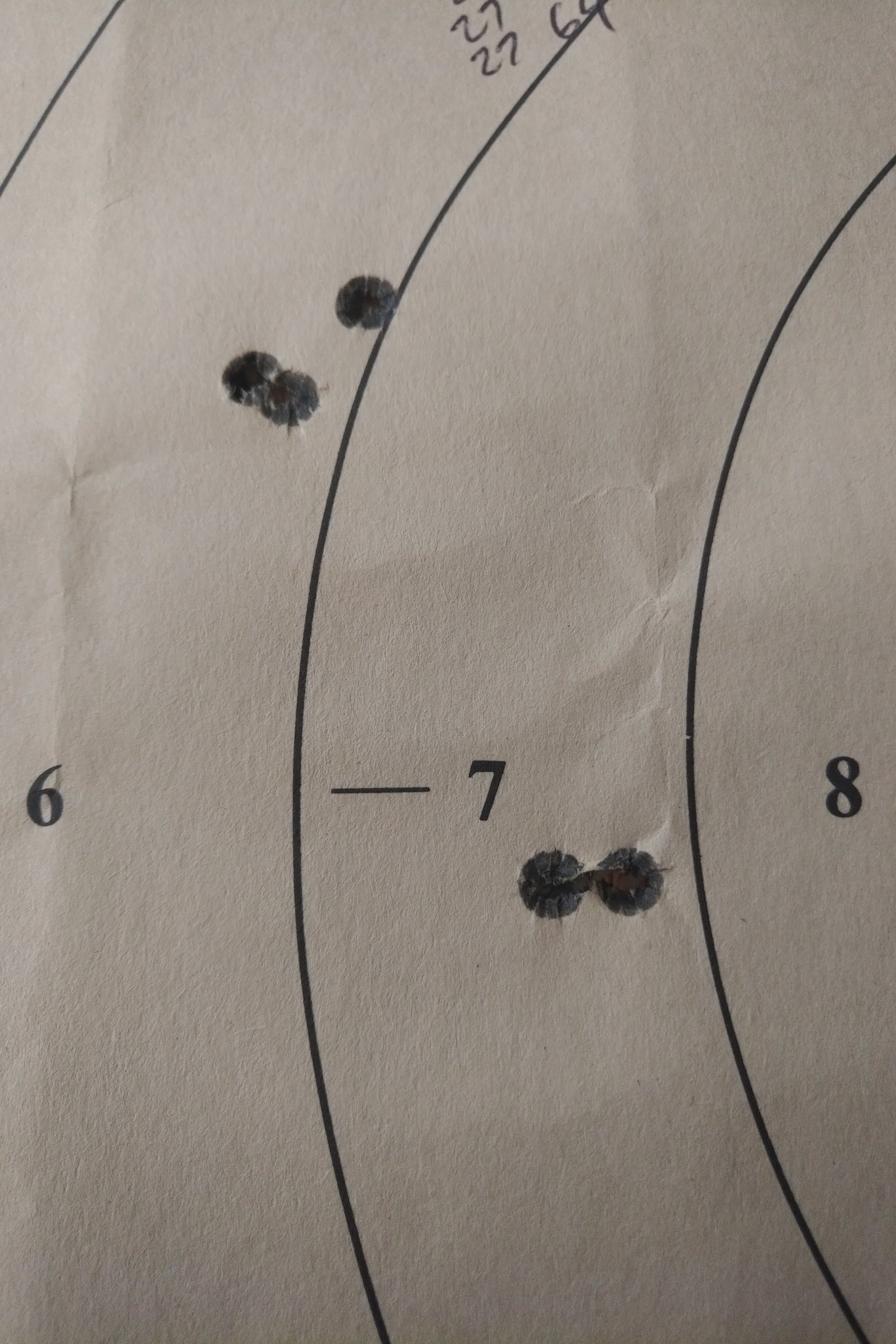

    Yesterday before I did a bunch of Ladder/OCW/whatever load testing, I shot a few of the listed Hornady 147 ELD Match to confirm zero and see where they are at: factory load Base to Ogive length has them "jumping" 0.050" in my chamber.
    7034693
    So, as you can see, printing on paper at 100, they look great!! If you're killing paper at 100, pay no mind to anything below this point.

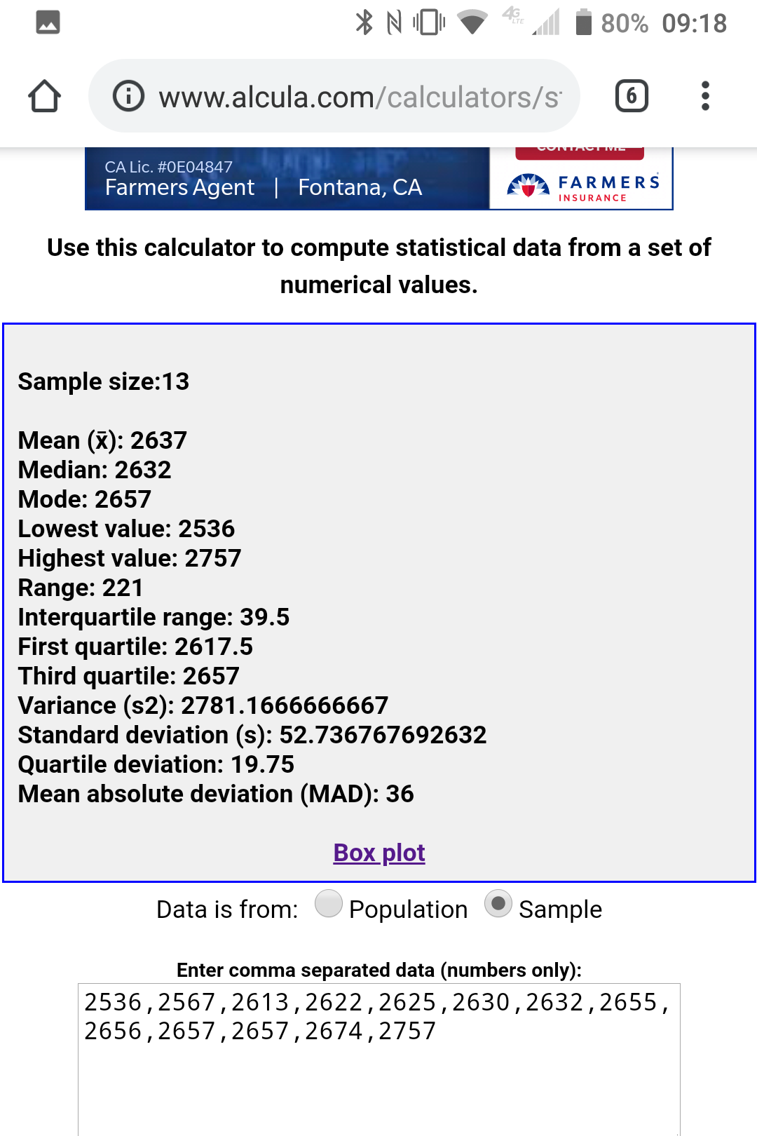

    Here's the statistical data:
    7034695
    7034696
    So, with a SD of 52 and Range/ES of 221...

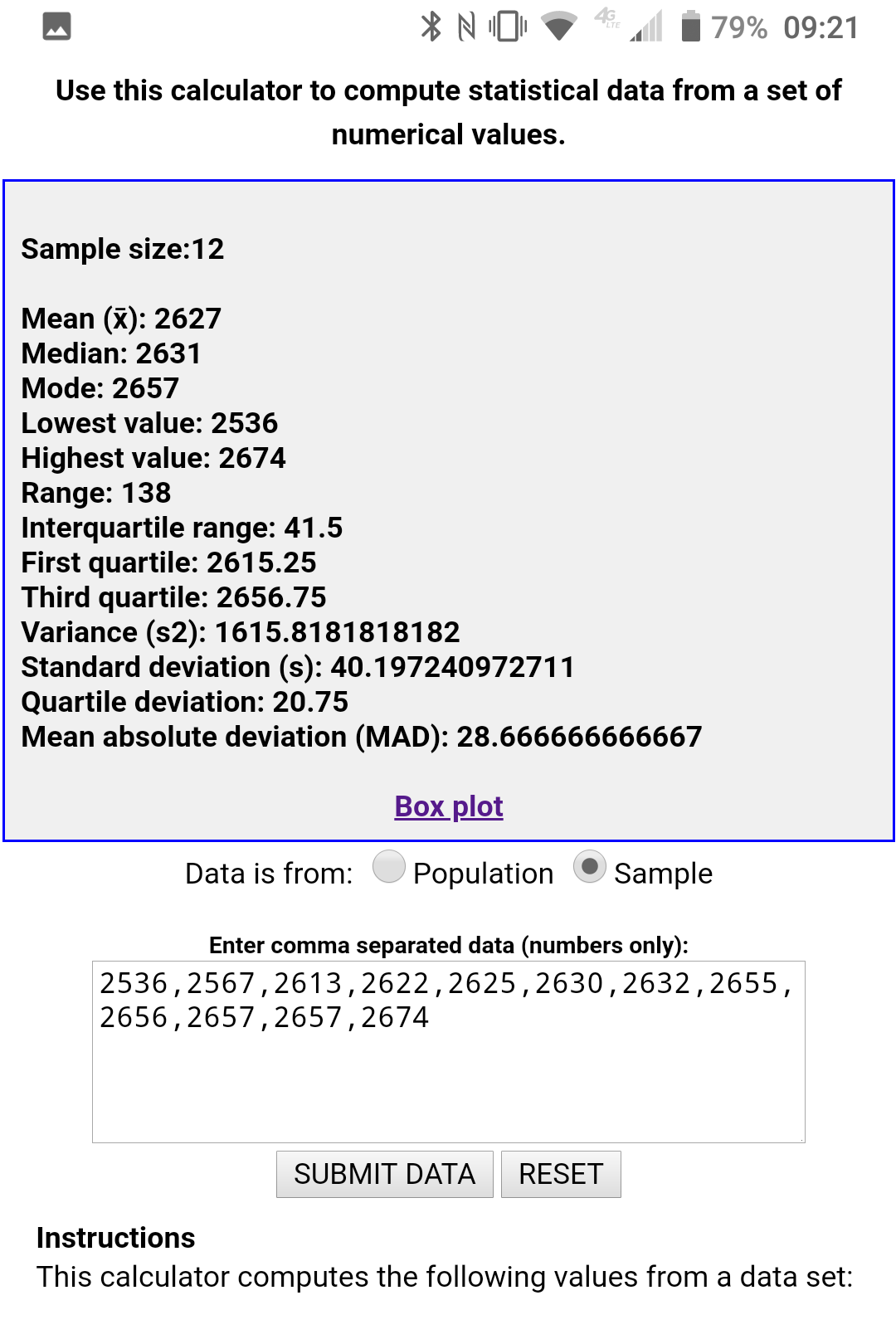

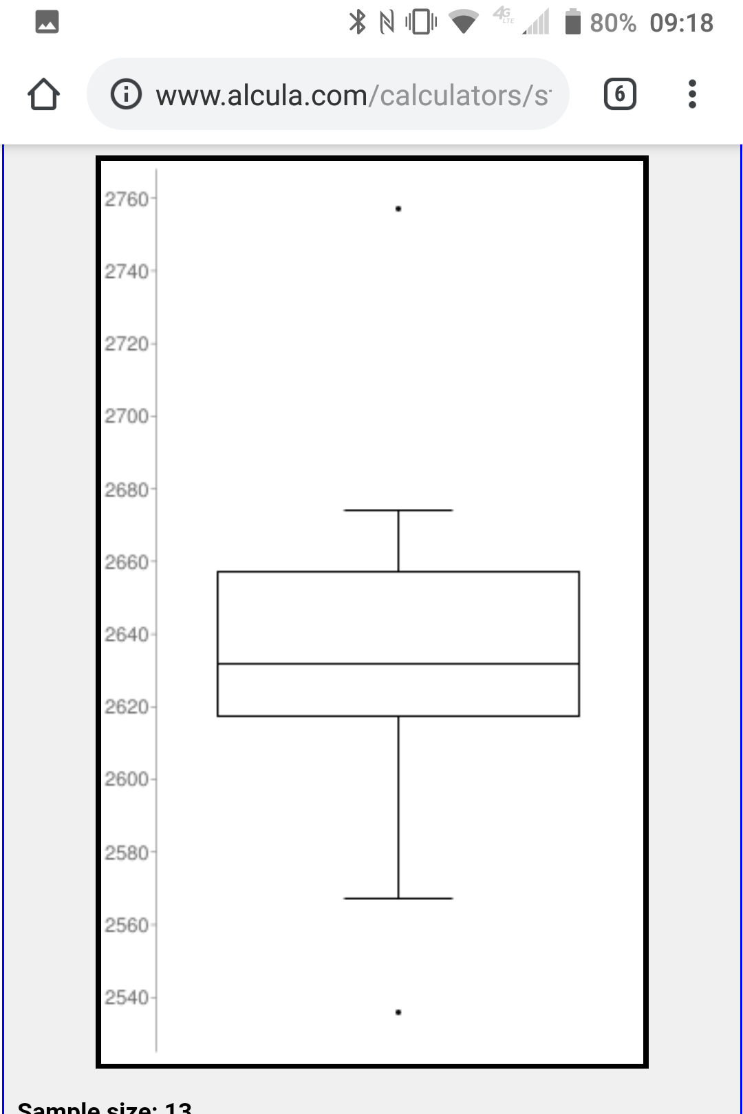

    Even when I toss the 2757 outlier... SD still 40 and ES/Range is 138.
    7034697
    Your gun may be more better, numbers-wise, with this factory offering.
