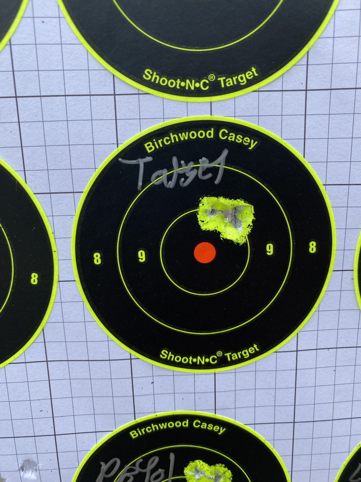

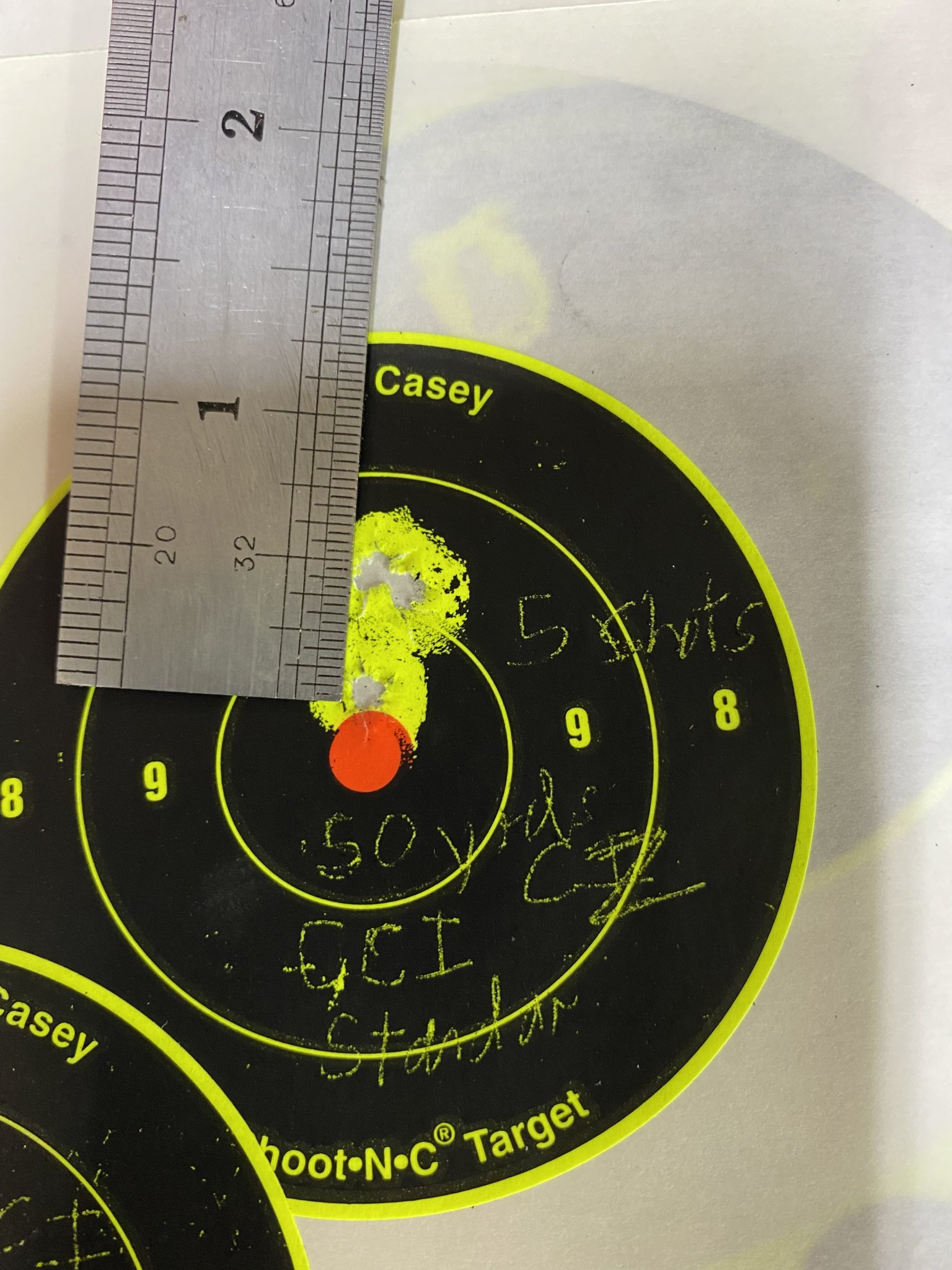

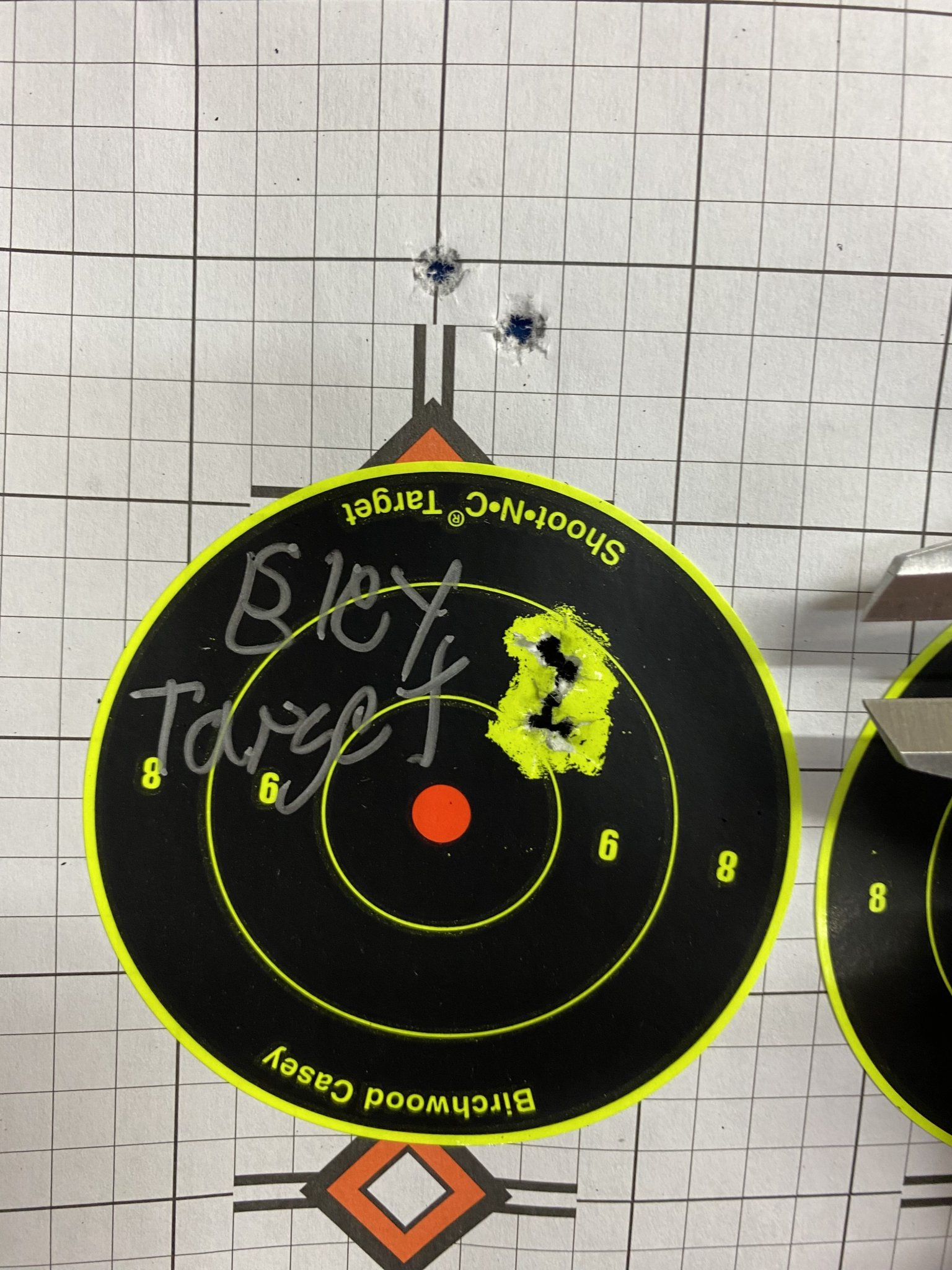

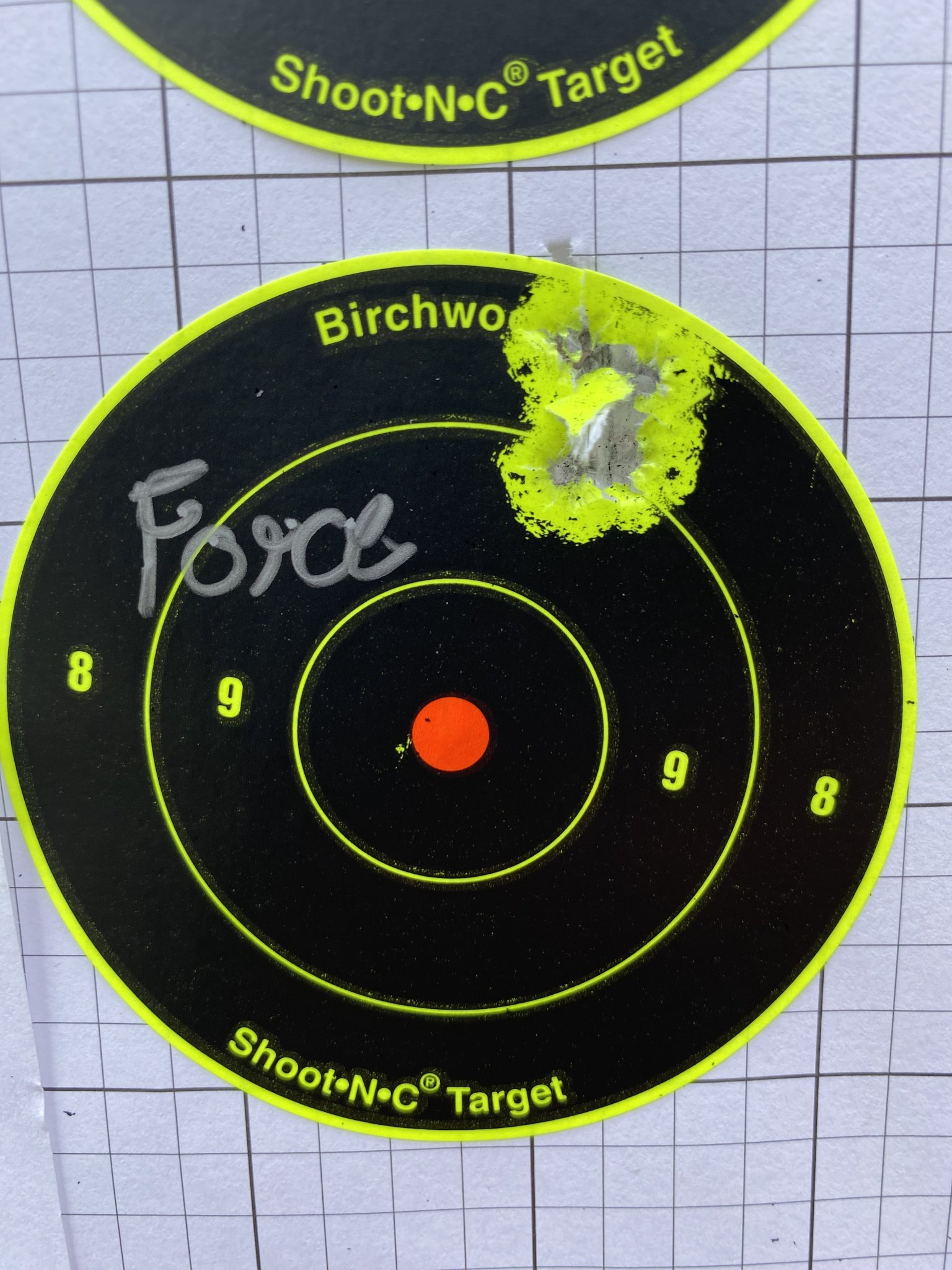

+1 on Randy at CPC, best money I’ve ever spent. My factory target models hangs with the full aftermarket ones now. Best of all no parts get tossed into a box to never be used again. It loves Eley target and Force (only fancy ammo I’ve tried) CCI standard will hold about a 1/2” for 10rds at 50yrds usually too. The groups are not cherry picked the gun shoots that well. Cheers
