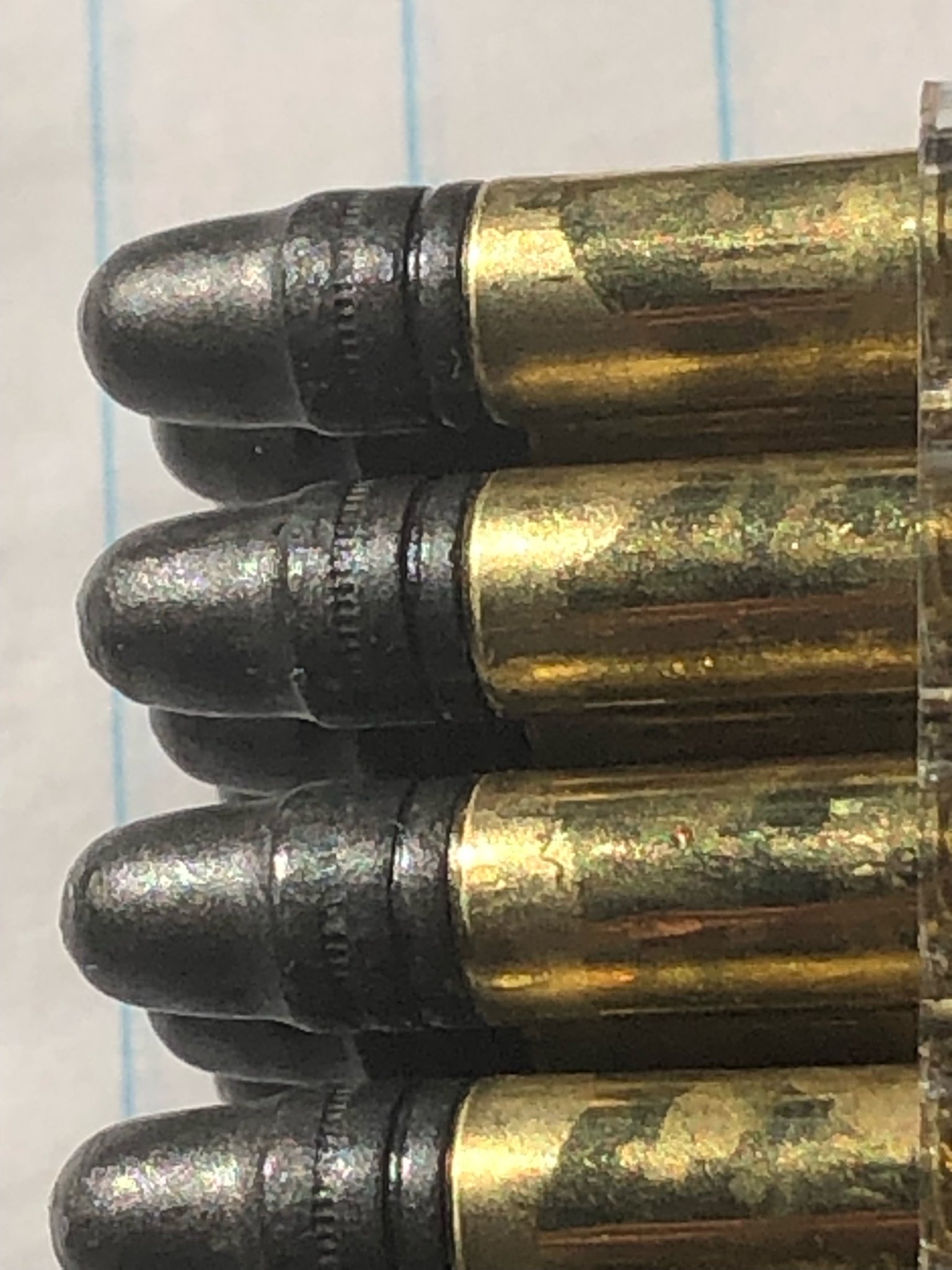

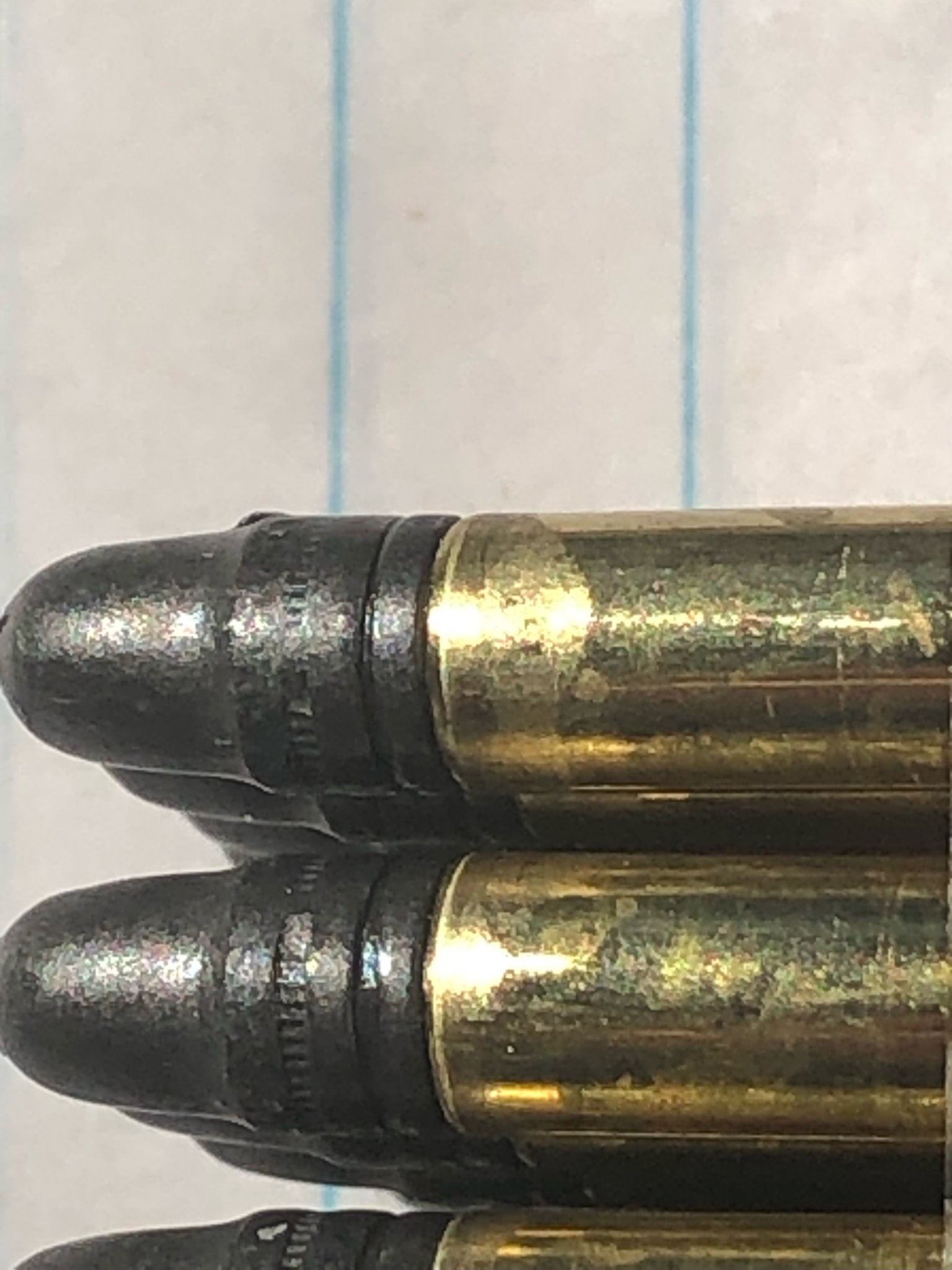

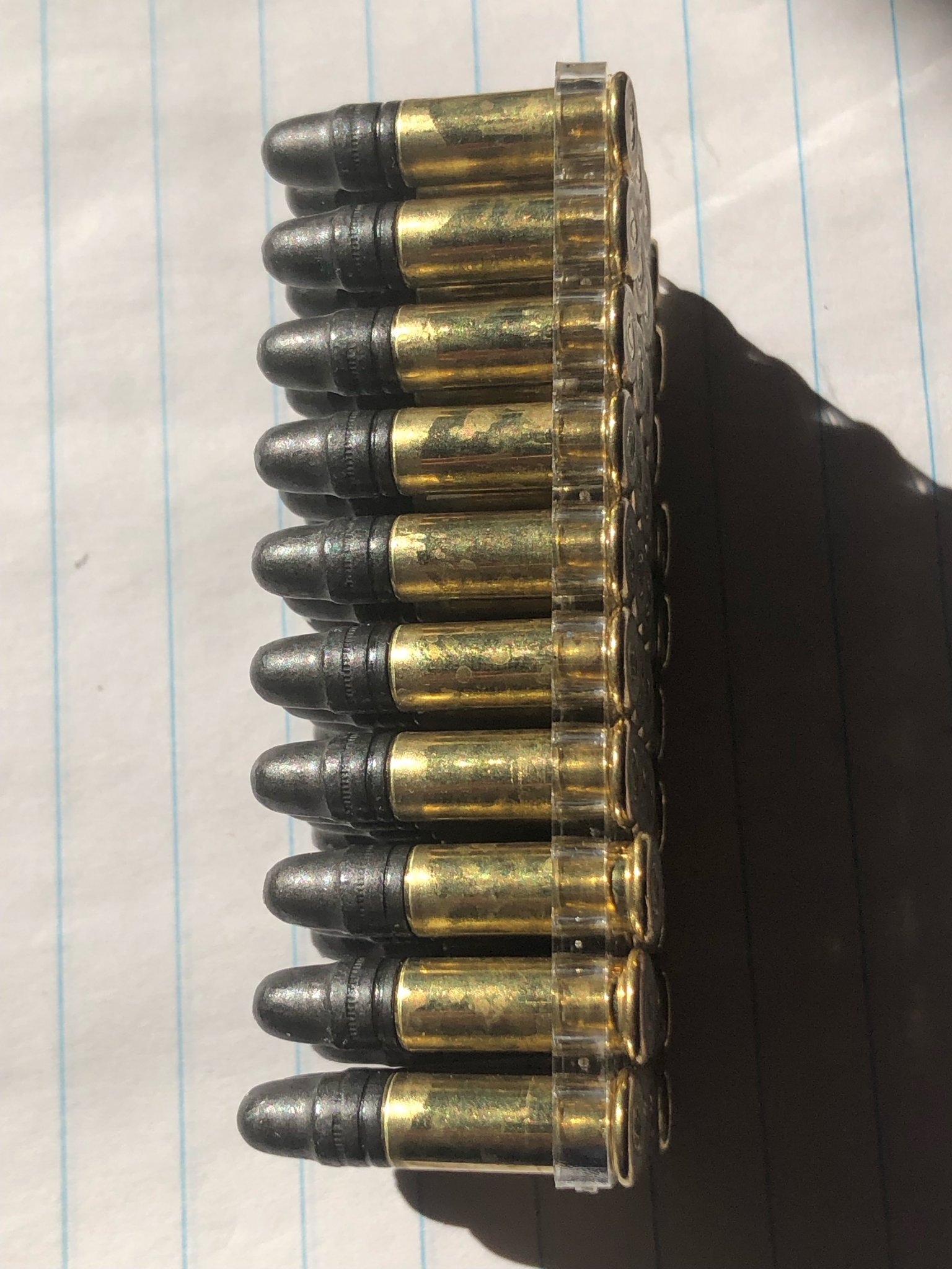

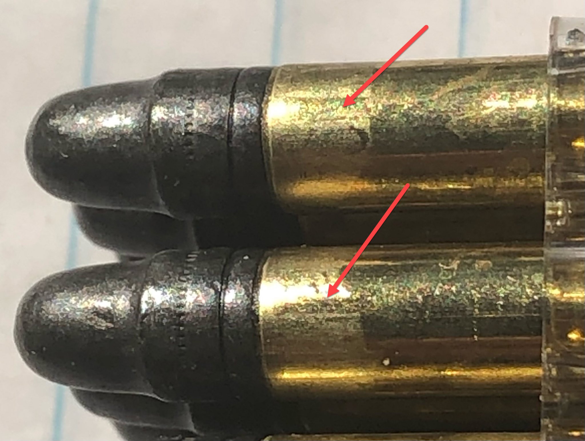

I'm Running a Vudoo V22 G1. I use CCI SV as my training ammo. Had extraction issues too.
I FINALLY got to the bottom of it. It's NOT mechanical. I can now open a box, make a quick observation, and tell if you if it’s going to extract or not. It was the freezing temperatures this February that really made the problem worse and visually apparent at the same time.
Apparently, during the manufacturing process CCI dips their Standard Velocity bullets into a high viscosity fluid.
I believe this fluid is intended to only be applied to the bullet head. However, sometimes this fluid ends up on the brass.
This is what is causing the problem. I can see the fluid on the brass. It has a dull appearance and the amount is random. It ranges from barely noticeable to 1/4 inch away from the bullet. See arrows on pic where i scrapped it off.
My theory:\: The round is chambered with excess fluid on the brass. The round is fired creating heat that reduces the fluid viscosity allowing it, via capillary action, to flow and fill the available gap. Then the temperature decreases rapidly because the chamber metal is 25°F. Upon attempted extraction the case has sufficient resistance to motion because of adhesion and the case fails to extract.
My match ammo is Lapua Center-X. If you shoot it you know it also has a low viscosity fluid applied to the case. However, it is on purpose. When I load my mags with Center-X I can see my fingerprint on the brass after loading, especially when its cold. The important point here is the low viscosity fluid remains viscous when cold. With this in mind I used Hornady One Shot Dyna Glide Plus Case Lube and wiped the CCI SV brass cases down, one whole box of 50. After polishing the case looked uniform without a dull band as before.
Proof Test: I cycled the entire polished box without a single extraction failure at 25°F. Then I polished 4 more boxes, not a single extraction failure.
This solves the problem for me ... hope it works for you too!
