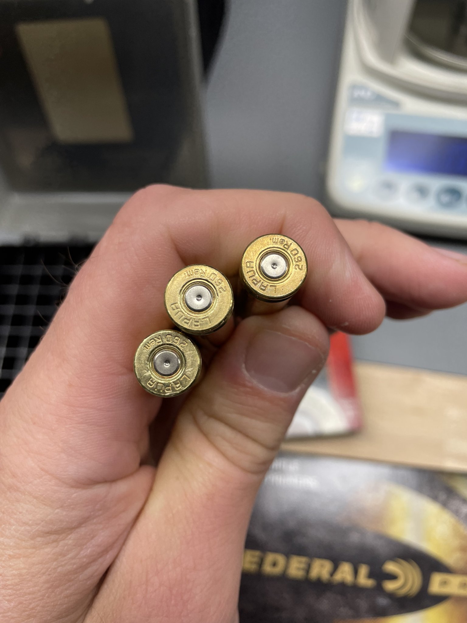

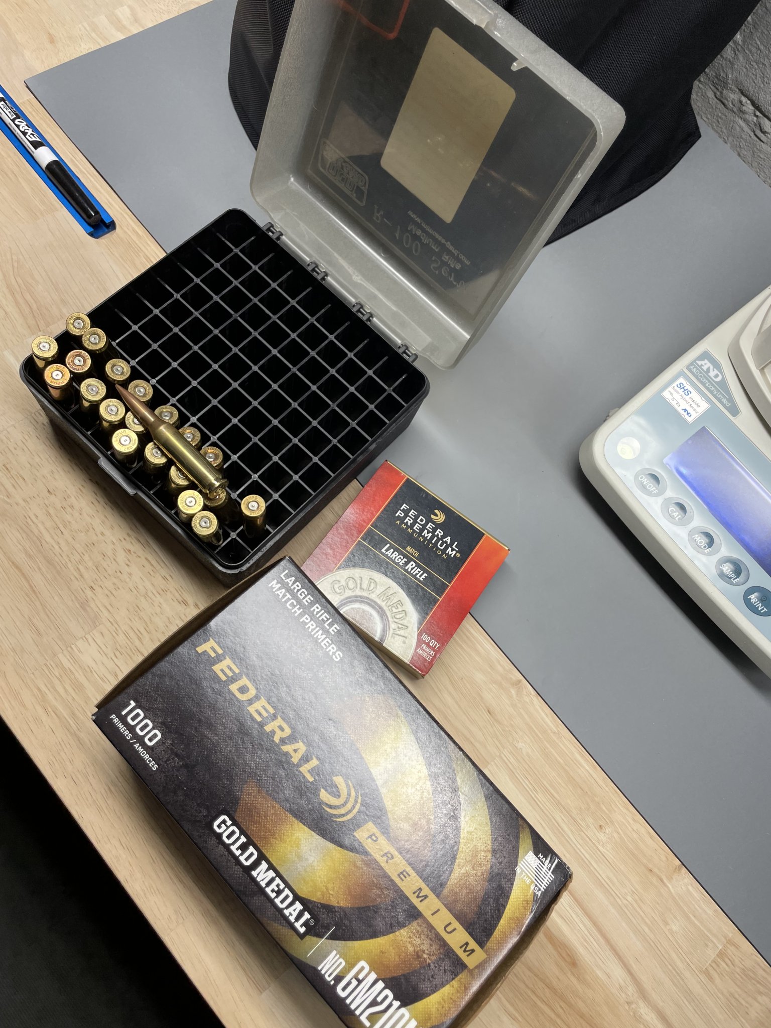

Loaded up some 260 with Federal gold medal primers. The primers were from about 2018 but always kept in a sealed ammo box . Had about every third one not go ‘boom.’ I think I’m getting a decent primer strike and even attempted to fire one of the rounds a second time.. no joy. Is it common to have a ‘bad batch’ of primers or am I missing something? Thanks!

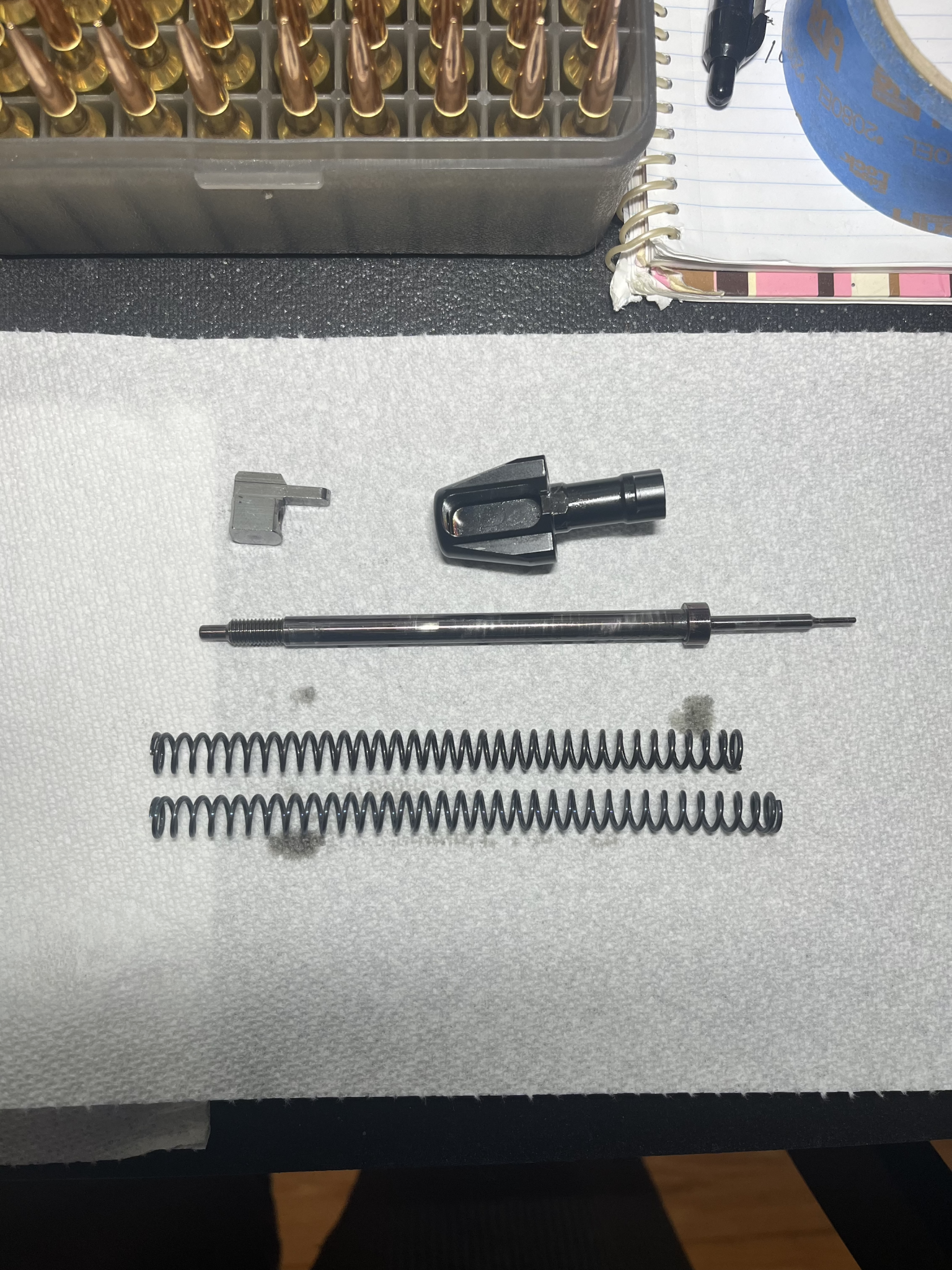

Loaded up some 260 with Federal gold medal primers. The primers were from about 2018 but always kept in a sealed ammo box . Had about every third one not go ‘boom.’ I think I’m getting a decent primer strike and even attempted to fire one of the rounds a second time.. no joy. Is it common to have a ‘bad batch’ of primers or am I missing something? Thanks!View attachment 8492743View attachment 8492741View attachment 8492742
Like some other's have said, it looks to me like light strikes, which could be from a not so good seating depth of the primer and/or the headspace is too much and/or the firing pin protrusion isn't enough (make sure the firing pin is clean unobstructed).

I had this happen to a bunch of Prime (Norma) .260 ammo a few years ago. It was with a last of the Remington 700s before bankruptcy. They started using a different firing pin assembly and it always seemed weak. It got to the point where it ruined several primers. I ended up replacing the assembly with a NOS unit and solved the problem.

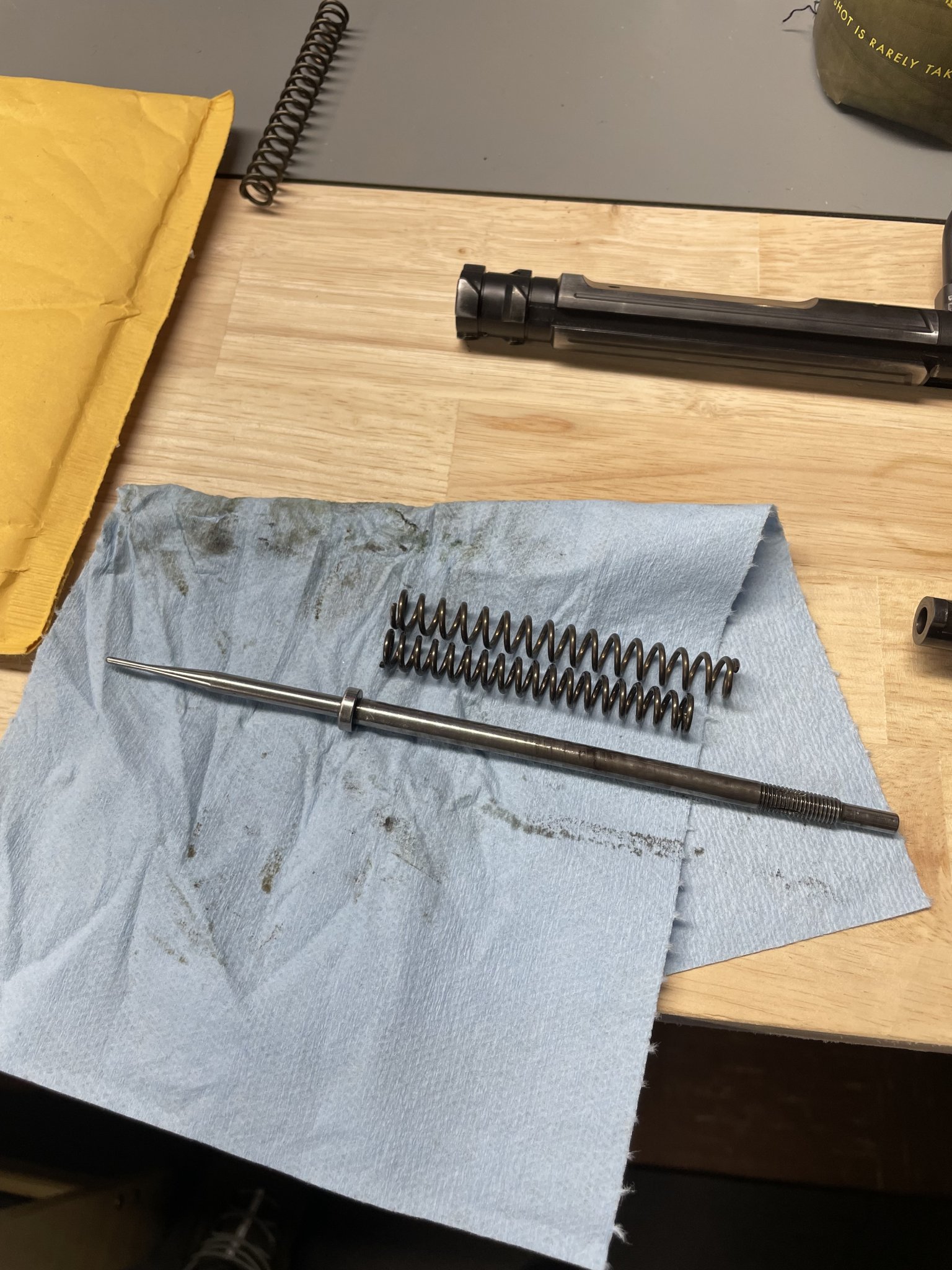

I've been there man, sometimes it is the equipment (and not us). I change my firing pin spring once a year now lol.
I've thought about doing that with my RPR's, but after 8 years with my .308 spring at about 14,000 cycles I estimate, it seems to be doing just fine (though I don't compete). A few years ago I bought a couple springs in anticipation of replacing the spring if I saw a need. Primer contacts for me are still looking good. I admit, I'm very surprised about this.
It must help that I always keep my RPR's decocked when they're not in use??? ;) 🤷‍♂️
IDK, but I imagine every action is different. I'm just guessing here, but as a complete off-the-shelf factory gun, I'd bet an RPR is mostly designed to be robust and go bang every time and make trips back for warranty service versus a "custom" action where they're also after things like light bolt-lift, faster lock time, and such for bolt-gun cork-sniffers lol...
Primer size probably matters too. In my case, with my Origin, I've never had a single issue with LRPs and old/worn firing pin springs, only with the harder-to-set-off magnum SRPs (CCI 450s) and/or mil-spec SRPs (CCI #41s or Win #41s), and even with those and old/worn springs, I've never had more than what could be counted on two hands over the course of many hundreds of rounds.
After first checking that it wasn't me (by bumping my brass too much or by not seating the primers deep enough), a fresh spring has always made everything work 100% again.

Definitely light strikes.
I've had problems with Elf triggers in a AR308 and PTGs in a 700.....
Both looked exactly like those rounds.
Replacing the trigger groups fixed the issue.
If it had only happened to me once with a solitary trigger assembly I wouldn't be so sure....
But once you've been there a few times it's obvious what you're looking at.
