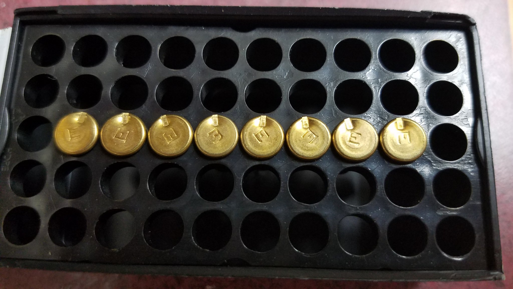

Tough to get a good photo but here are the three rounds that FTF. Pin hits look good, haven't torn the rounds apart yet to see if I can tell primer condidtion.

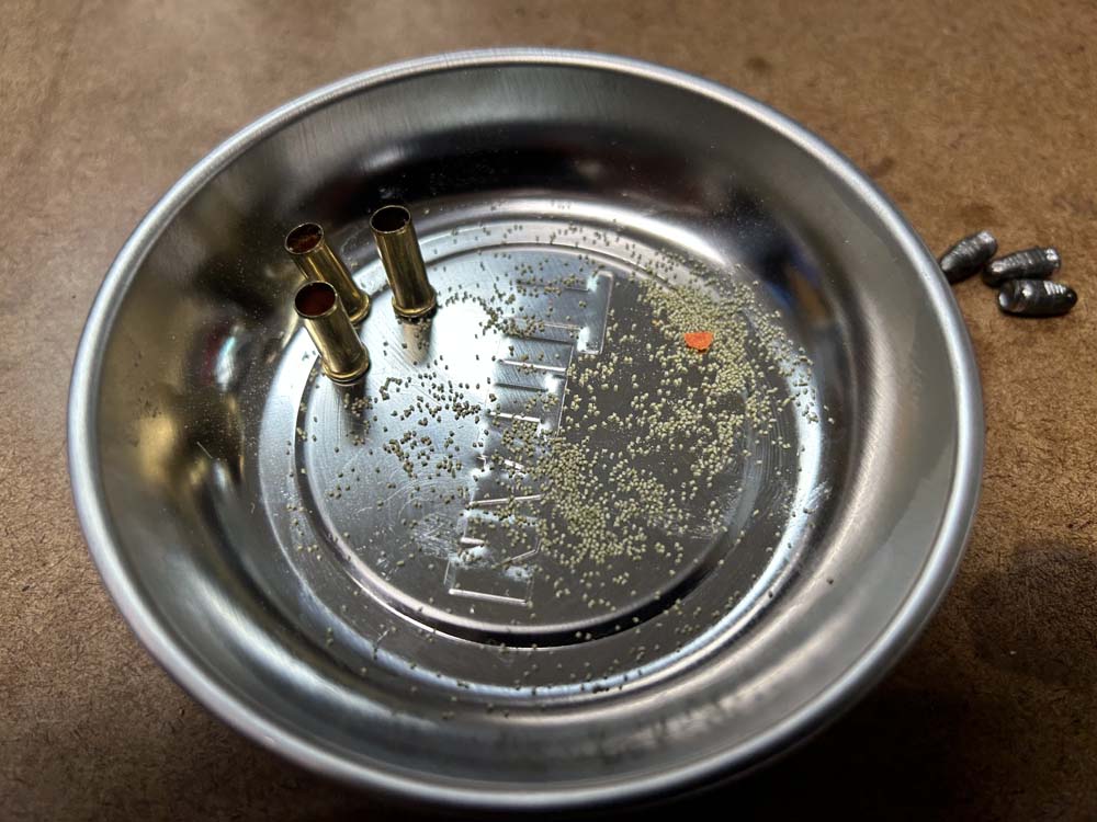

Tough to tell regarding the primer. Only one round had a piece of primer fall out, others are difficult to tell as orange primer in the bottom reflect brass color.
Those rim strikes are light. Try a heavier firing pin spring. Try your other ammo brands to see if same strike. Firing pin springs do wear out.

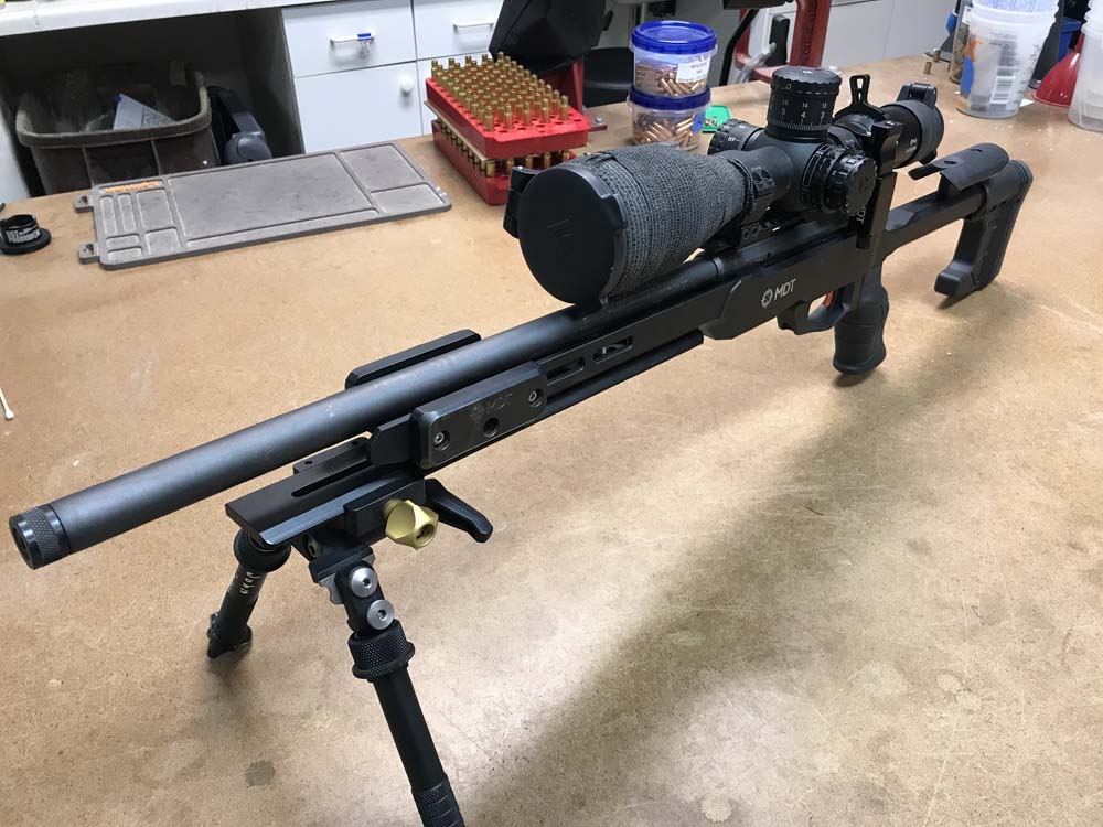

Interesting conversations. My Base gun is a Savage B22. Went with that gun to start with because I have couple other rifles with the MDT ACC chassis and like the chassis. Photo attached of the Savage.

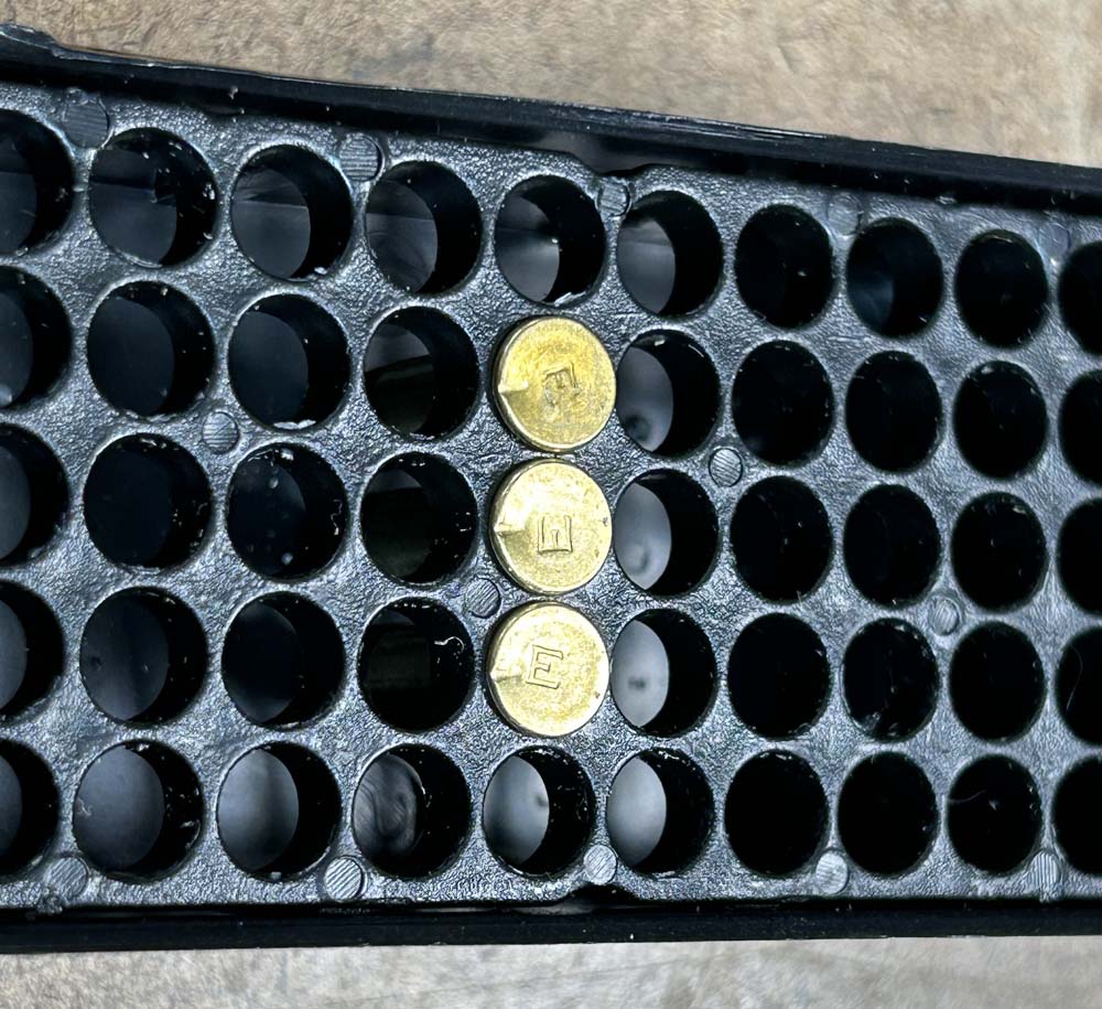

Latest update. Mounted the new 30MOA scope base and off to the club. Ran into a shooting buddy that is a highly competitive shooter with a long history shooting Vudoo. Started off again with the Eley Target and third round, no bang. Had another no bang with that mag of ten. Tried some of his SK Semi-Auto, about third round, no bang. Tried that round in his gun, no problem. Tried another mag of SK Rifle, red box, had one no bang in twenty rounds. Better but still not good. Now working on getting new stronger firing pin spring. Gen2, two 90 bolt.
I have to admit, I have not seen that chart before. That's very helpful. I just pulled four of the no bang rounds out of my pocket I saved that weren't fired in the friends gun. Two were Eley and hits definitely looked lite. Two were SK, one looked lite, one looked stronger. All the hits extend past the rim of the case. Looking closer at the impact I'm surprised that the indent tapers from light towards the center and deeper at the rim. Opposite of picture #4.

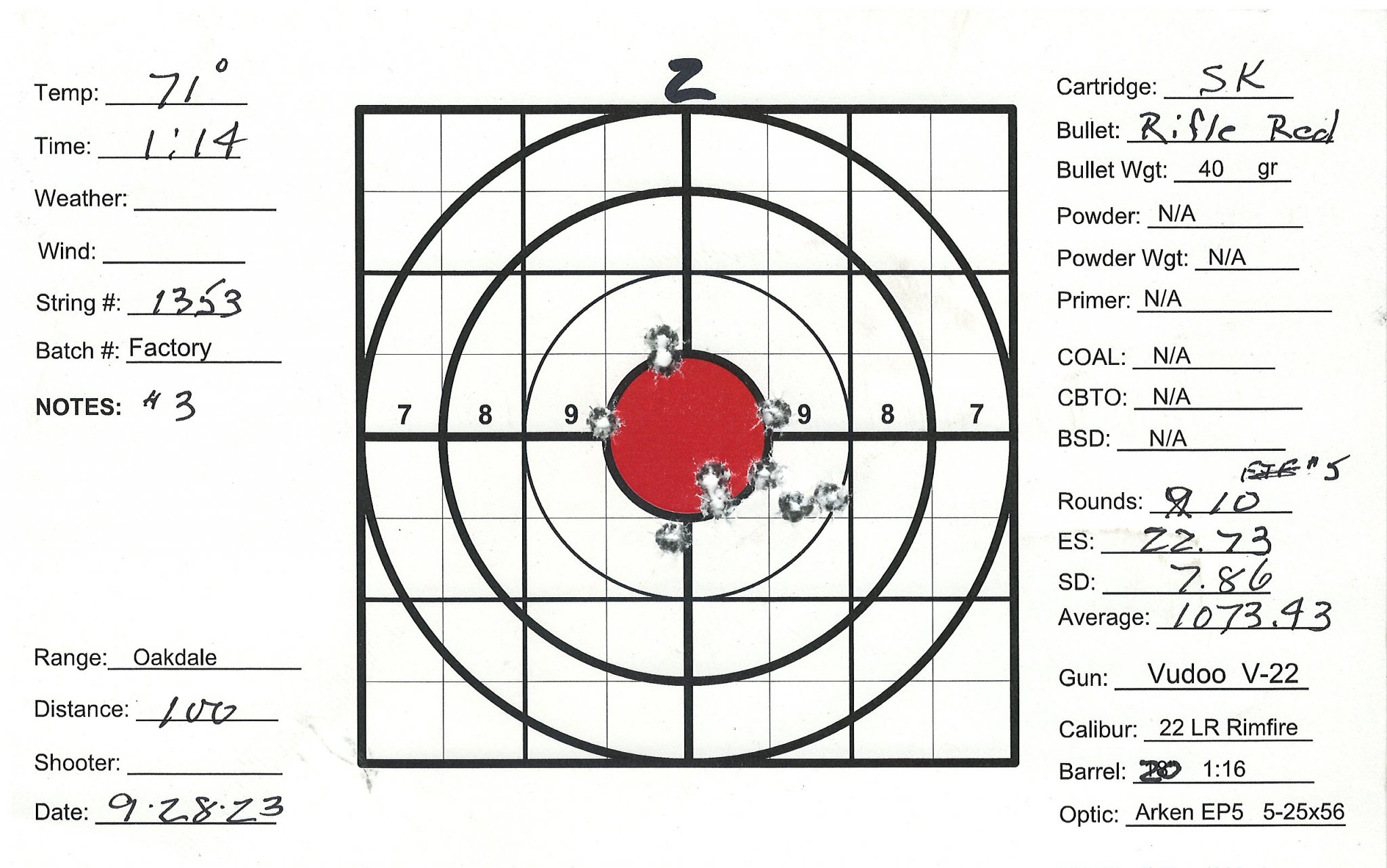

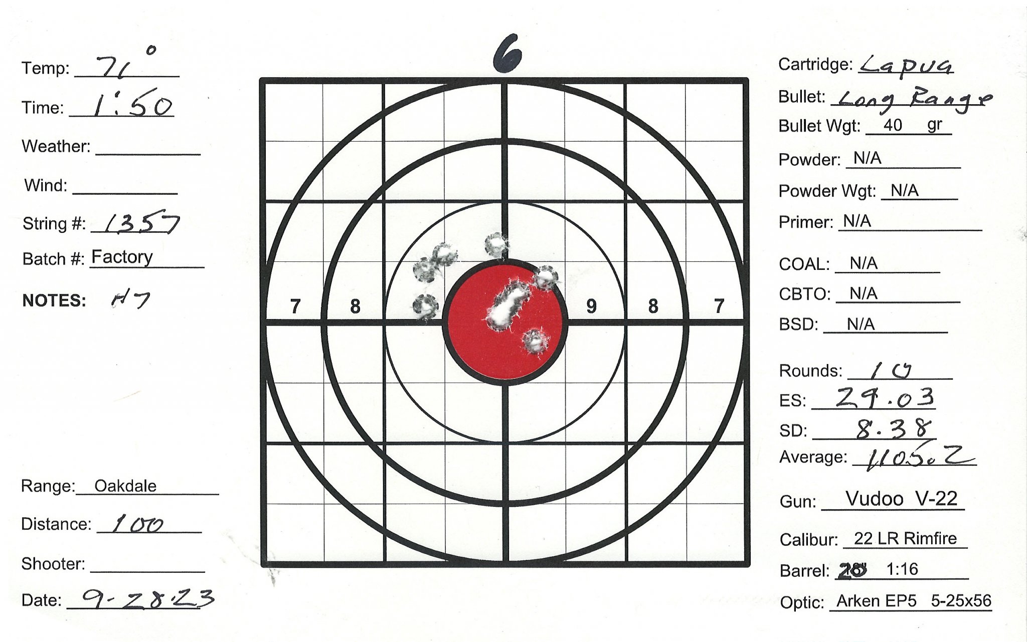

Successful range trip yesterday. Was able to chronograph (30) SK rifle (red), (30) SK Long Range (black) and (20) Lapua Long Range. Had three no bangs with the Rifle, one no bang with the SK Long Range and one no bang with the Lapua. Saved all the failed rounds and pin strike are way light compared to the above. No surprise, had best group with the Lapua, second best were the SK Rifle.
