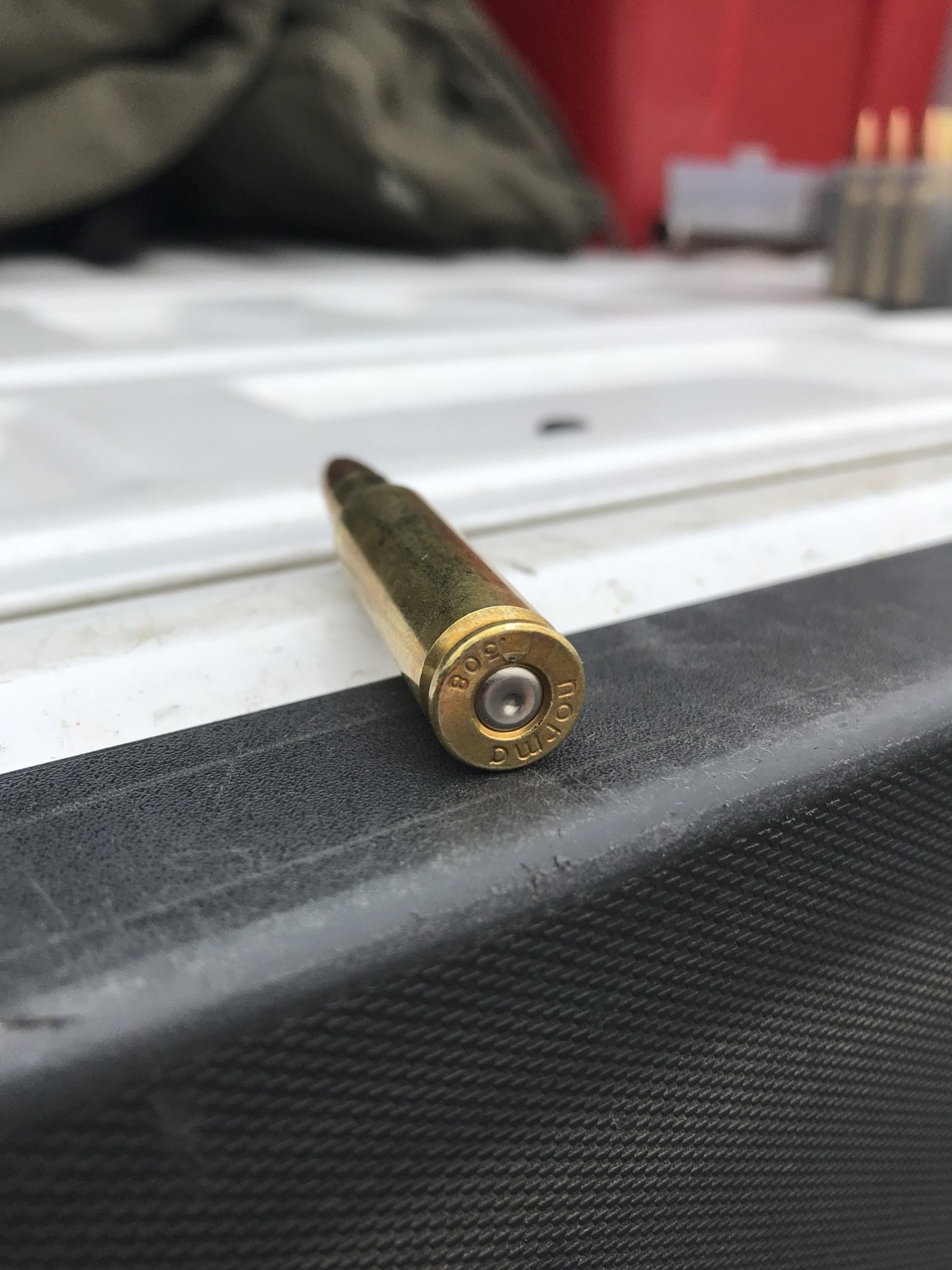

I’m still new to reloading, but have never experienced this with any of my reloads before( .22-250&.308).I just picked up a new to me 308 rem700 bout a month ago. Finally got out to to test some loads aaaaand click. Loaded another round and click. Nothing. I had five rds left over from an ar10 I use to have and sighted the rifle in with those prior to my newly loaded rds, no issues. I used the same seating tool, same cci primers, same 1x fired Norma brass. Any ideas?

Thanks for the replys.I loaded up 25 rds ,5 rds for 5 different charge weights. I tried a round from each weight and same thing, nothing. My first thought was maybe the rifle, but it fired the first 5 rds from an older reload batch just fine. Second was the powder but I don’t think I would have missed putting powder in 5 cases. I’ll pull all the bullets just to just to make sure. All the primers look to me like they are seated fine, none crushed or protruding. Guess I’ll check the pin and spring next.
It is possible your problems aren't primer or ignition-system related at all. If you are over sizing the brass (usually by quite a bit), you can create a condition where the case has room to be 'pushed forward' in the chamber by several thousandths by the firing pin impact. The symptoms it will exhibit are exactly as you're describing. It's certainly something to check.
You probably ought to have a headspace/shoulder bump comparator regardless...because it's an essential/required tool for precision reloading.
Could easily be something with primers or ignition system though....just tossing it out there as a possibility if everything else checks out.
At the very least you could get your dies setup correctly, vs how you have them now (i.e. i can guarantee you're oversizing as is).
For bolt guns you generally want to shoot for a .002 bump. For gas guns, somewhere in the range of ~.004-.005.
Edit: If you don't have one, you can get away with using a deprimed .40 S&W case as a comparator on a .308.

Alright so, I disassembled the bolt. Firing pin and spring were clean and good to go. Firing pin protrusion is also good.
I also measured the headspace on the cases that failed to fire. 1.620,1.621,1.620,1.621, 1.620
I also bought some FGMM ammo, measured the first 5 out of the box. All were 1.620. And it fired all 20 rds of the FGMM(quite accuractly too). So I guess it’s not headspace or rifle driven.

So . . . apparently, something is going on with those particular cases and/or how they're loaded. You might check to see how deep you're seating those primers. I'd say,seat them no deeper than .003 - .004 below the base. CCI primers have always worked well for me, though this doesn't mean there aren't any bad one's out there. Keep in mind the CCI primers have a little harder material for firing pins to dent than some other primers (like say, Federal 210's). So, if seating depth is just fine, you might try a different primer to see if that'll solve this problem.

I believe I found the issue. Me not being patient and using still damp brass. I pulled apart the first cartridge and dumped the powder. In the bottom was , I’d guess, 5 grs of clumped powder clinging to the brass. Popped the primer out and that looked wet as well.
That would do it.
I appreciate everyone chiming in and helping me narrow it down. I get so antsy with new rifles haha, just got to go.
MikeMcCasland, thanks for bringing up the possible sizing issue. I’ll go ahead and set my die for less shoulder bump.
