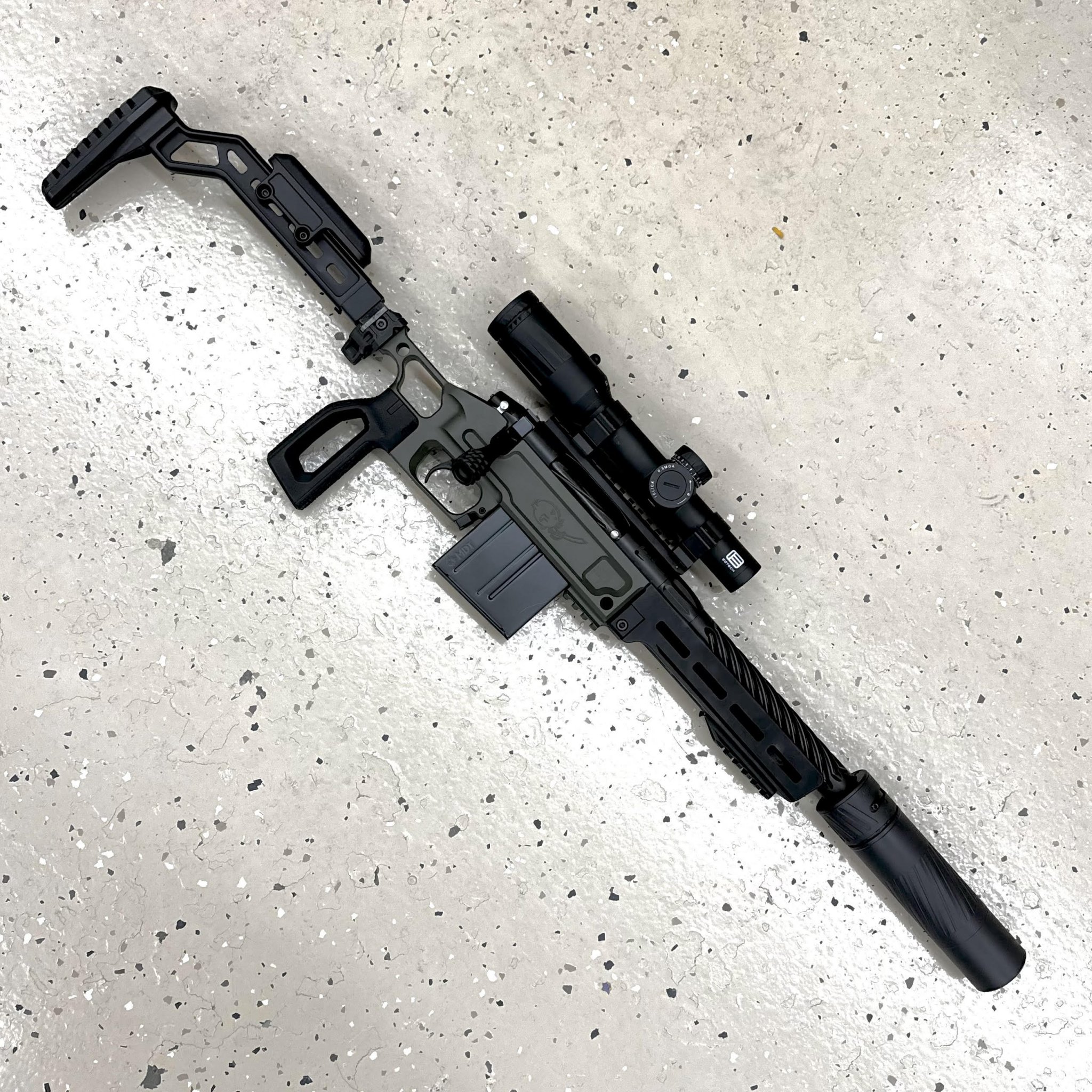

I have been scratching my head for a week now and have kind of hit a wall. I have a Zermatt/Big Horn TL3 SA Action in a Pork Sword Chassis build I am completing and for the life of me, I cannot get it to fire AAC ammo. It is chambered in 300 Blackout and the sole intention of this thing is to be a well-rounded garbage disposal. Here are the parts for anyone who may take the time to help me trouble shoot.
Action: Zermatt TL3-SA
Trigger: Geissele Super 700
Barrel: Black Collar Arms 9" 300BLK
Tools Used:
Zermatt Action Wrench
12pt 1-1/8 Crowfoot
Forster Go/No-Go Gauges.
Here is a picture of the build:

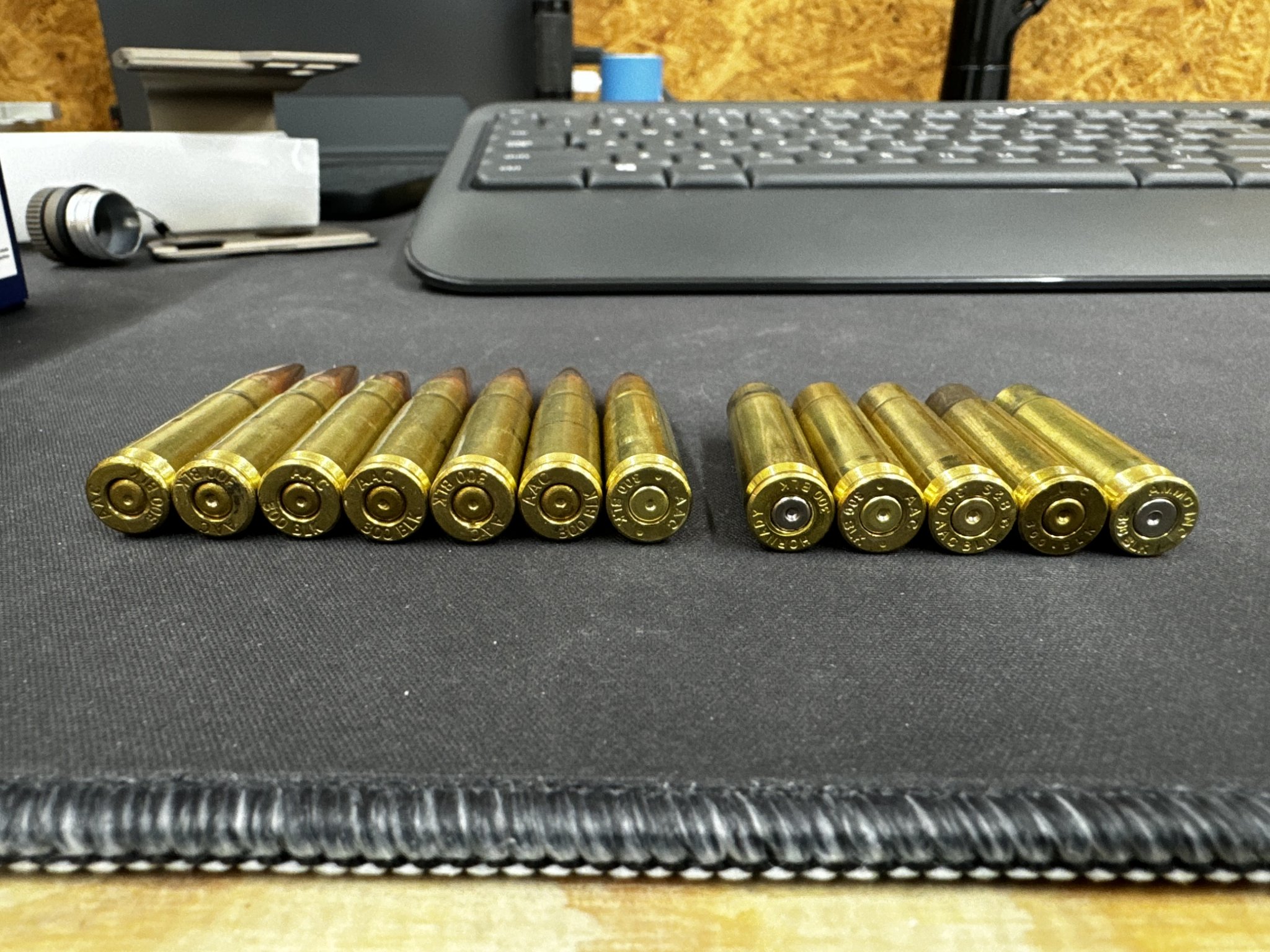

The left group (FTF) of ammo is all AAC (115gr, 110gr, 125gr SMK) and the right group (Fired) is Hornady, Sabre, S&B Tactical, Winchester Super Suppressed and Ammo Inc. Not Shown is the Hornady black.​
Sorry for the huge pictures, hopefully they give an idea. Here is what I tried:
I have rebuilt the action and head-spaced about three times, each giving the same result. It does not feel tight or "forced" when closing the bolt. I believe it is head spaced right.
I have changed the trigger out to a Triggertech Special Pro from the Geissele. I have read in other posts people remedied similar issues by swapping them out due to potential drag or sear issues. No change in results.
I field stripped the bolt and cleaned the spring and firing pin to eliminate any drag from debris or thick lubricants.
My guess? The primers are hard as hell.
Question is, what can I do?
Zermatt offered to remove material to allow for up to another 10 thou in travel for the firing pin but I am not sure that will fix this. When I pull the trigger on this ammo, it's a very distinct, soft "thud". When I headspaced, the extractor was removed, so I don't think I gave myself a false head space. I am no means a bolt action expert and I am at a point of confusion as to how I can get this thing to do what I need it to do. Any input is greatly appreciated. Anyone who may figure it out, you get some coffee on me.
Steve

Do you have the tools to measure the differences between what fires, and what doesn't? If all that's the same, and one group of ammo doesn't fire when the primer is struck, and you feel that's a problem with the primers in that lot of ammo ... then the "Captain Obvious" in me says "Don't use those primers anymore."
Right. If you are under the impression I loaded them, I am sorry, I didn't. They were purchased from PSA. I am trying to find out if there is any adjustments or safe alterations that can be made to make the ammo function as intended.
Looks like it just needs a teensy bit more hammer spring....like so close to setting it off.
I have to run a stiffer spring for my 5.45x39 ARs than I do my others - to compensate for harder primers.
None of the ”nice” drop-in triggers will work 100%of the time on my Russian ammo.
Your chamber headspace could be on the long side, and the AAC ammo could be on the short side. This would cause the loaded round to bounce off the firing pin and not get allow a good strike.
I would try turning your barrel in to the action an 1/8th or 1/4 turn to make the headspace a little tighter.
Reactions: sgtsmmiii
Is the normal sound/symptom of that a soft thud?
I don’t know about the actual sound - other than no BANG!
I think the firing pin spring may need to be adjusted, not sure I can do anything about a hammer spring in the bolt itself.
Ooff.
I didn’t catch that it wasn’t an AR.
I should not post until after my morning caffeine fix.
Reactions: TheOE800 and USK308
Have you talked to Zermatt? You need to gauge that ammo, I’ll second that.
No idea what it is worth and why people really want it. I thought it was cool when I got it but I think it is way out of my league haha.
I’ll pay what you paid plus ride to be fair.
I wouldn’t have the alter the action/firing pin for what is most likely an ammo issue.
How did you headspace the barrel, go gauge?
I would measure the go gauge with a comparator on your calipers and then measure the fired cases and those that don’t fire and compare. If those that don’t fire are significantly shorter in the shoulder then that’s what’s allowing the strike to be dampened as the case has too much room to freely rattle around chamber.
Measure firing pin protrusion ,they all look like a light strike . If it is within spec I would suspect the bolt is not locking in the round . I had an AK do that and just about everyone said hard primers , it was the bolt out of time not primers .
But how do you know it isn't a headspace issue?
I've had very similar issues in a 223 with a barrel nut. The nut started to loosen and the barrel unscrewed a small amount, which increased headspace. Lots of failures to fire until I figured out headspace was the issue.
I didn’t see this mentioned but have you pulled a bullet to check if there’s powder inside? Just a thought. I’ve done that before with reloads by mistake, early on in my reloading days however. Don’t ask me how lol.
If it was mine, I should shorten the headspace a little and try again. Good chance that will solve the issue. You could also remove your extractor and chamber a “ dud “ round. See if it is snug in the chamber or loose.
My thoughts, too. To me, this is the easy (first) fix.
Reactions: MarshallDodge
I'm not doing my loading, does that matter? I see AAC as the problem, I am more wondering if allowing Zermatt to increase travel is worth it.
You can use it to check the AAC ammo.
If the ammo gages correctly, it might be a hard primer issue or a tolerance stacking issue.
I wouldn't modify my firearm because one brand of ammo doesn't work.
AAC ammo doesn't have the best reputation.
