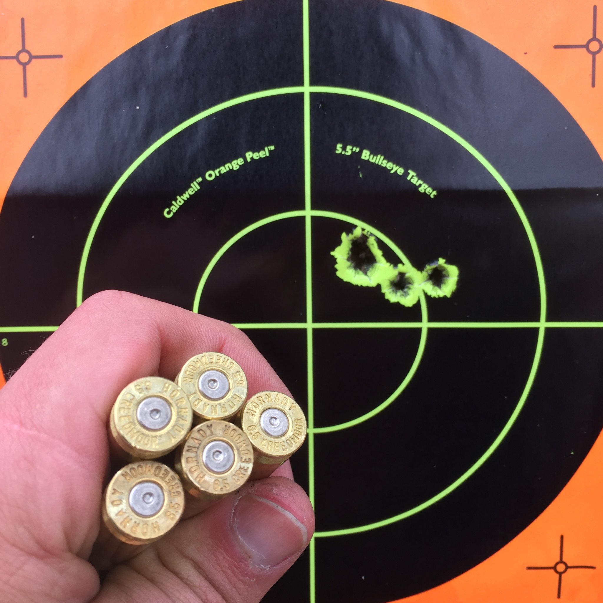

Here are three 3 shot groups I just shot at 100.
Reactions: The DFC

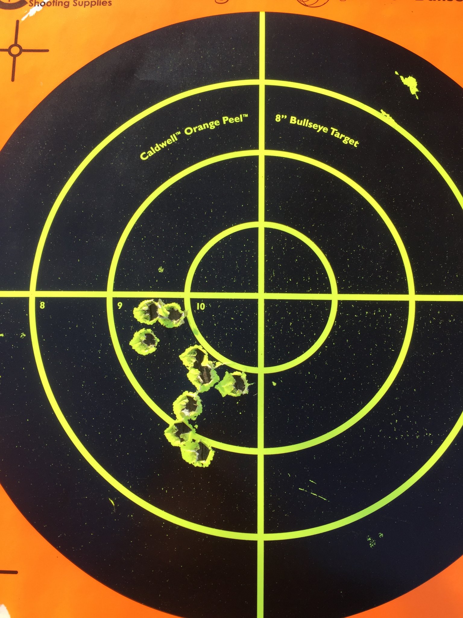

Another update, she’s been running like a champ and seems to like the Hornady Precision Hunter. 5 shot group from yesterday after I removed and painted the scope.
Not bad for a $1,600 build.

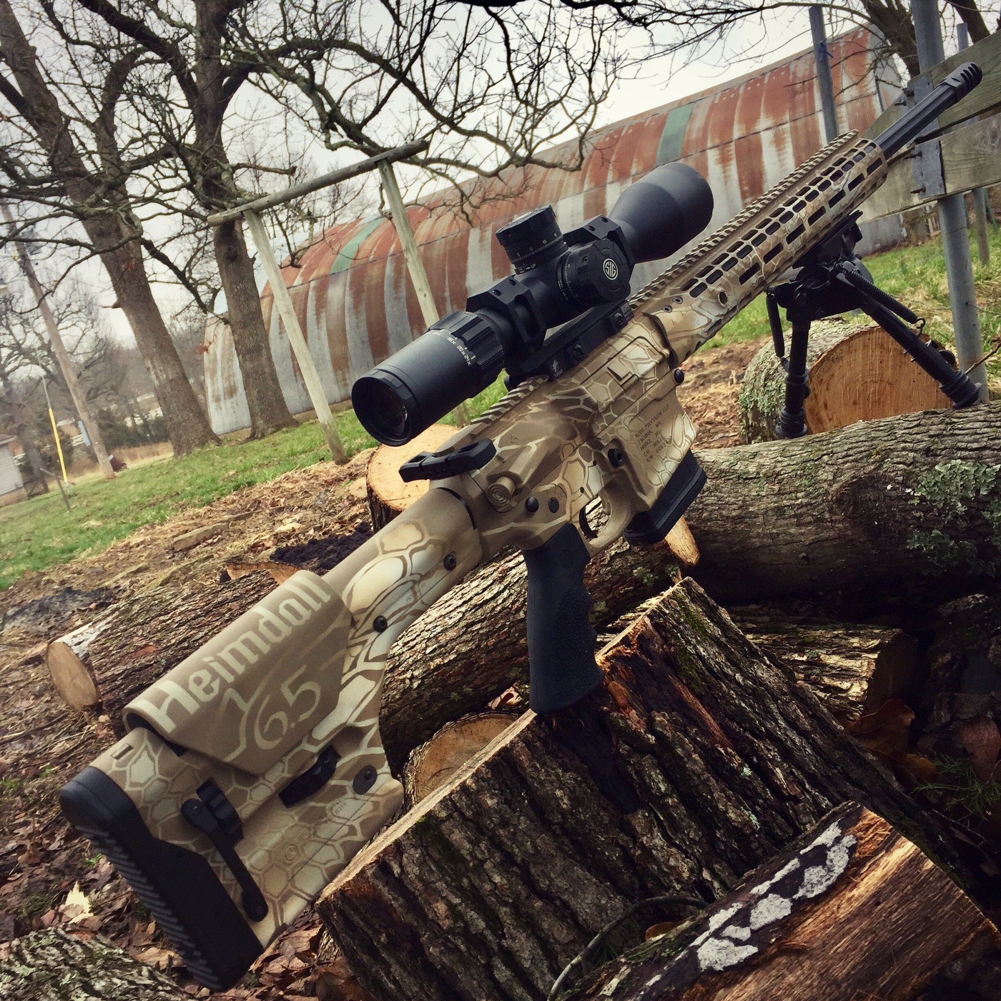

I repainted a kryptek style camo on it. Not sure if I like it or want to go back to FDE or OD, but here she is for now.
That's badass, and as someone whos painted guns with Duracoat, I know how much work it is to spray an intricate pattern like that. The stencils are tedious. IMO, you'd be out of your mind to spray anything over that. I would probably spray the barrel in the darker brown color though.

Yeah it’s at least a two day process for me. The barrel was bead blasted which I definitely didn’t like. The magpul FDE May look better on it than the black for sure though, and that’s simple job. Thanks for the tip, I may just do that.

Using Duracoat. And yeah, changing the ratio of the hardener can help make colors a little flatter. I haven't tried using their ultra flat colors. I usually do a few light layers and it turns out nicely. If I turn it up to a thicker layer there is definitely too much shine.
