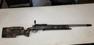

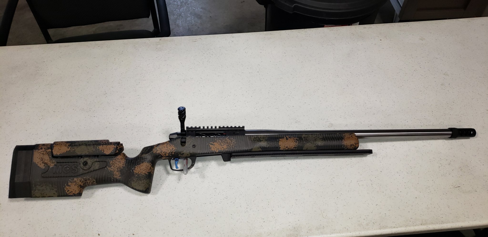

Early pic with no scope but this is in 6GT. My son is shooting it. Been shooting awesome with no issues. It's an early 7even action.
Yes from what I remember the bottom of the action isn't a true 700 foot print but Manners fit it to the stock with no issues.
