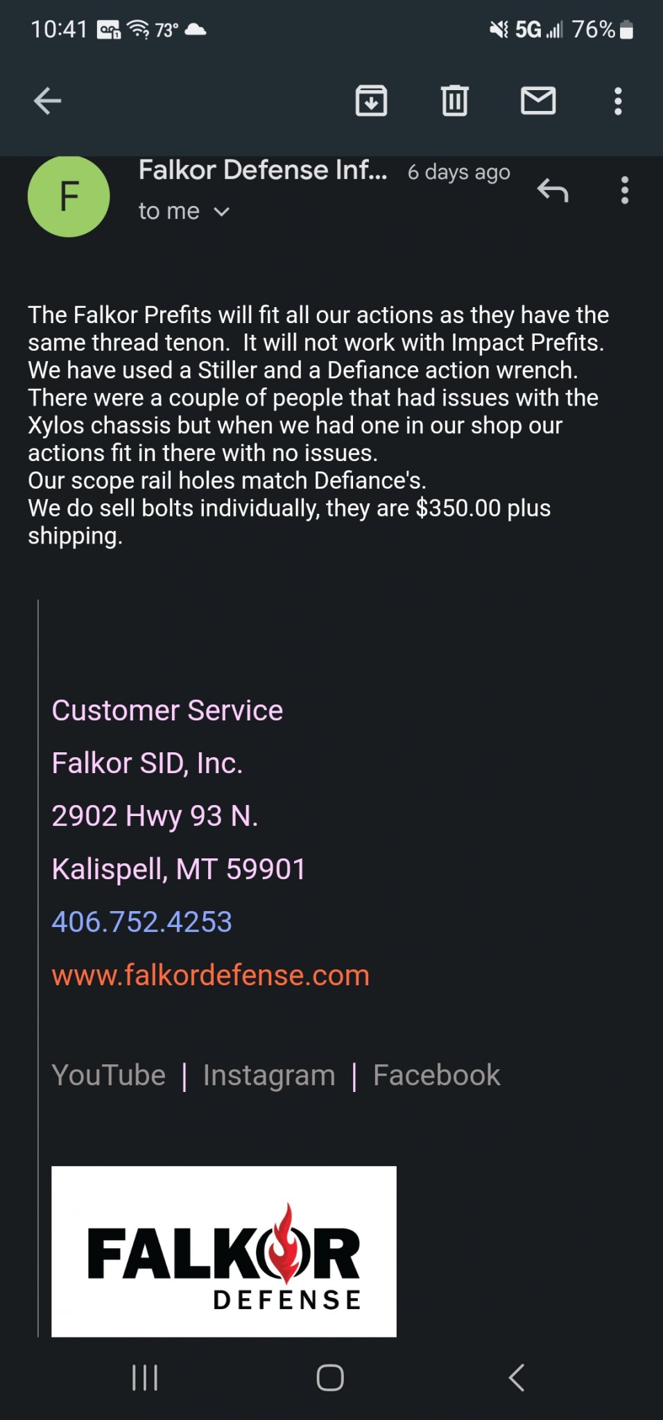

A month or so ago I posted some questions about barrel profiles and components for an nrl hunter build. Just when I thought I had it all figured out I watched both the eagle eye shooting and x ring yourube videos involving the lw7 action. This action checks a lot of boxes and frees me up in the weight department a lot as well. After countless uses of the search button and Google to oblivion I'm left with some unanswered questions and some half answered questions.
Does this action accept the same 7even prefits? Some websites list the 7even and mt7 separately so I wasn't really sure. Additionally it seems that impact prefits will work as well, any experience?
What action wrenches are people using for barrel installs? There isn't one listed on falkors website nor a head on short action customs for their modular wrench.
I saw a guy had issues fitting his 7even into his xylo chassis a few years ago in a thread on here and was wondering if there were other fitment issues with other chassis as well? The xylo is one of the main chassis I'm looking at so I figured I'd ask the question before making the investment.
Altus lists the scope rail holes as proprietary, falkor only offers split rails, but in the eagle eye video they use a defiance rail, was this a drop on or modified to fit? any other info as to if there are single piece rails that will fit with out modification?
I don't see spare bolts listed anywhere for caliber swaps, is this something where I'd need to contact the manufacturer or buy another action with another bolt?
I wanted to see if anybody on here had any wisdom or experience with this or other falkor actions that could chime in before I email them directly as I'm not exactly ready to buy within the next month.
Thanks in advance.

Forgot to post the response. They were prompt and helpful.
