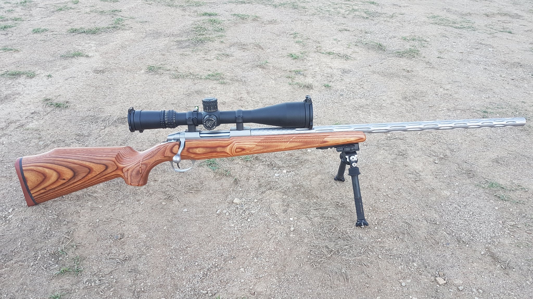

26" 1-8 twist 22-250, pushing 80gr ELDs at 3240fps super accurate using H4350.

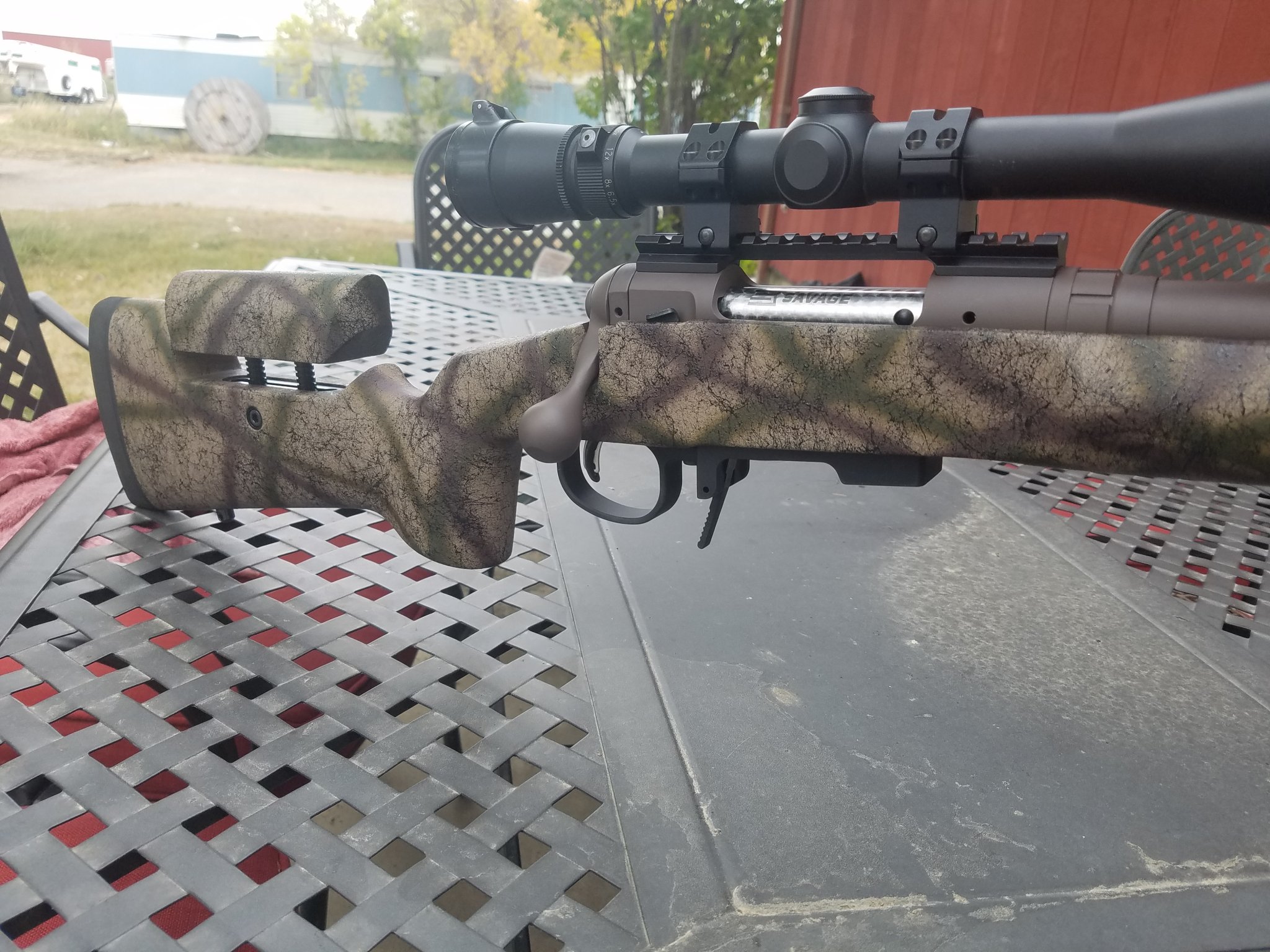

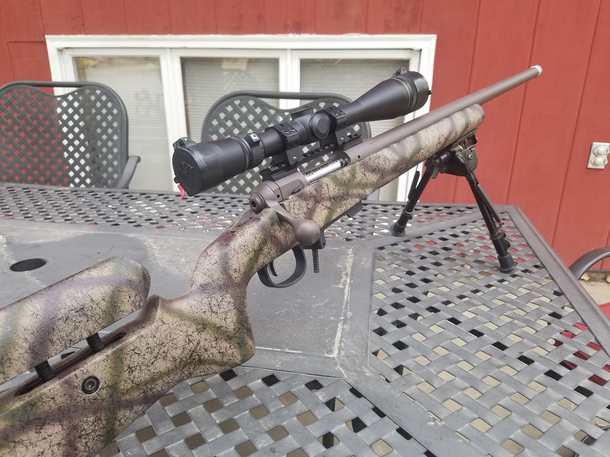

It is assembled and has a donor scope at the moment.. Did a bit of shooting with it today and it's not amazing but not bad. Doesn't like my 55gr reloads that well.. tried some 80gr bergers with imr4451 and was bad going to try some h4350 with the 80s and some 90smks soon.
Reactions: FF05
I have 75gr eldms, 80gr bergers and 90gr smks ro try in this.. Never had a fast twist 22 before.. Wish I throated it longer but standard throat will work I think I dont need crazy speed. Just want to be between 3000-3100

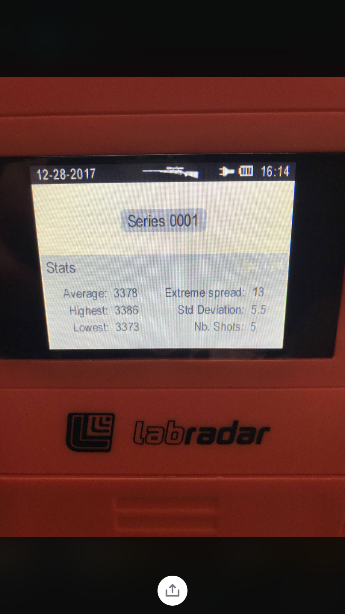

75 ELDMs at 3380 fps out of my 1:8 twist 22" barrel Tikka T3X. Both accuracy and ES are plenty good for me.
