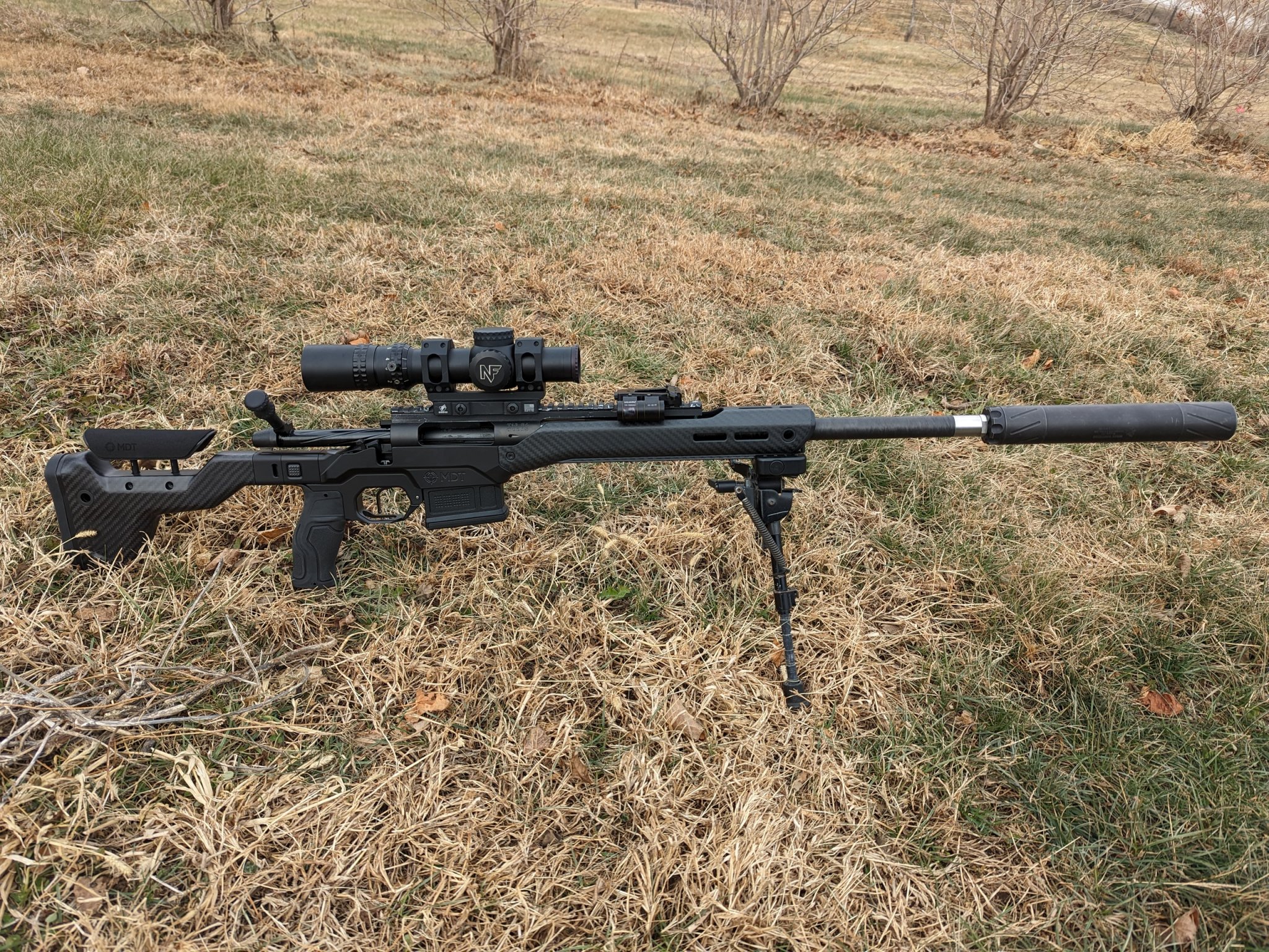

Another vote for KRG Bravo here. I bought it intending to have it be a placeholder until I could get a chassis but the light weight and simplicity are super nice
ETA: I have run a PVS30 and 1.5" mount with great success (spigot backbone mount). Once I finalize the scope on this rifle, I will very likely get a 20 MOA mount and mount it backwards to eliminate the 20 MOA base of the Zeus action. This will give me uniform optic height and cant.

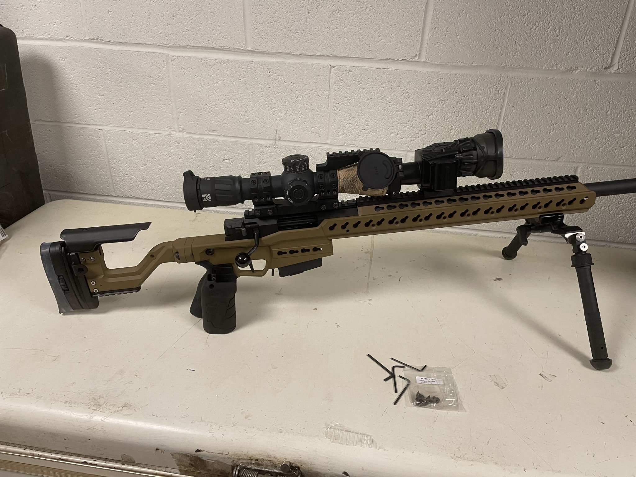

Yeah I was looking at the at-x but was told k need a super high mount
Something like a 1.7
Possibly.
This is a 1.5 scope With a 1.3 thermal
