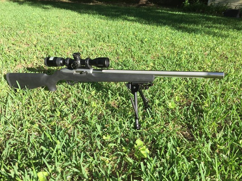

What started like this:
ka6noDvtoWPDlfQ9Ki-N7lhDY2c6FqCJlsRjyHlGgu_QcpCIVrJumSW8Lt7gJ-5gjVcwY0GdfVXmEQ=w459-h220
Ended up with this...

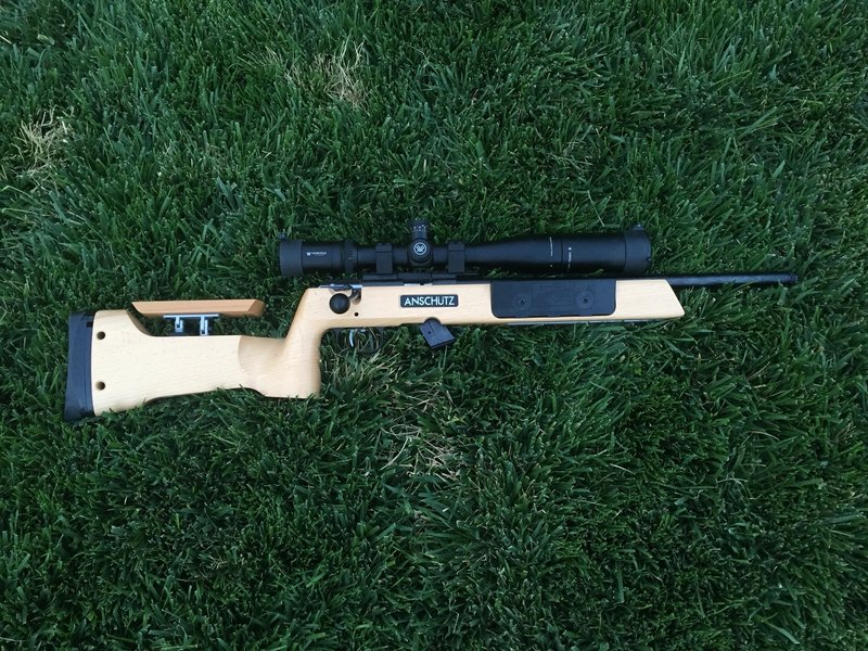

Sure. It's an Anschutz 2013 in an Anschutz precise stock. Ammo is Lapua Center-X that I got from the Lapua Test Center in Phoenix, AZ in 2015. We tested about a dozen lots of various Lapua ammo through it in their tunnel, and this one was the best. I have enough of it to get me through 2017 match schedule, will probably need to bring it back down to find a new lot around this time next year.

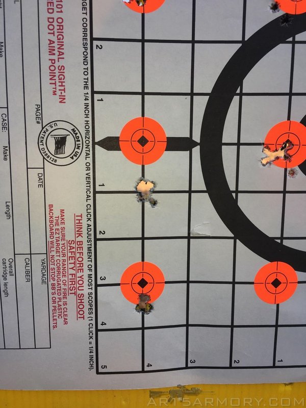

My only real upgrade is to my 10/22, that couldn't hit a coke can at 50 yards, with a Clark Custom Heavy Barrel Conversion. https://clarkcustomguns.com/gun/ruger-1022-1017/
And a brick of Wolf Match Target.
fetch
It will now shoot. These are two 10-round groups shot at 50 yards. The third group, on the right side of the pic, is a 10-shot group of Blazer.
