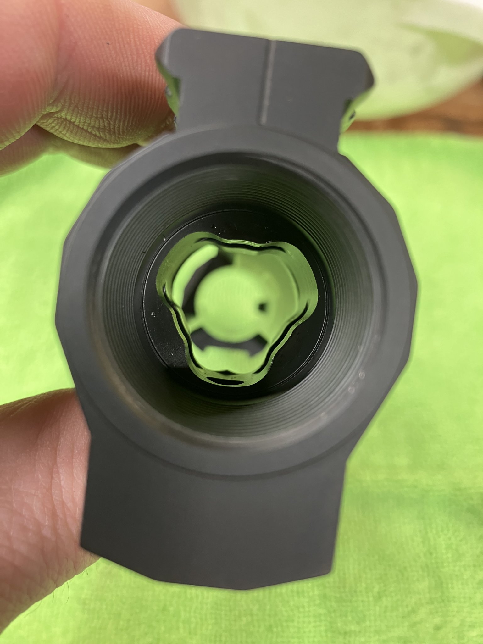

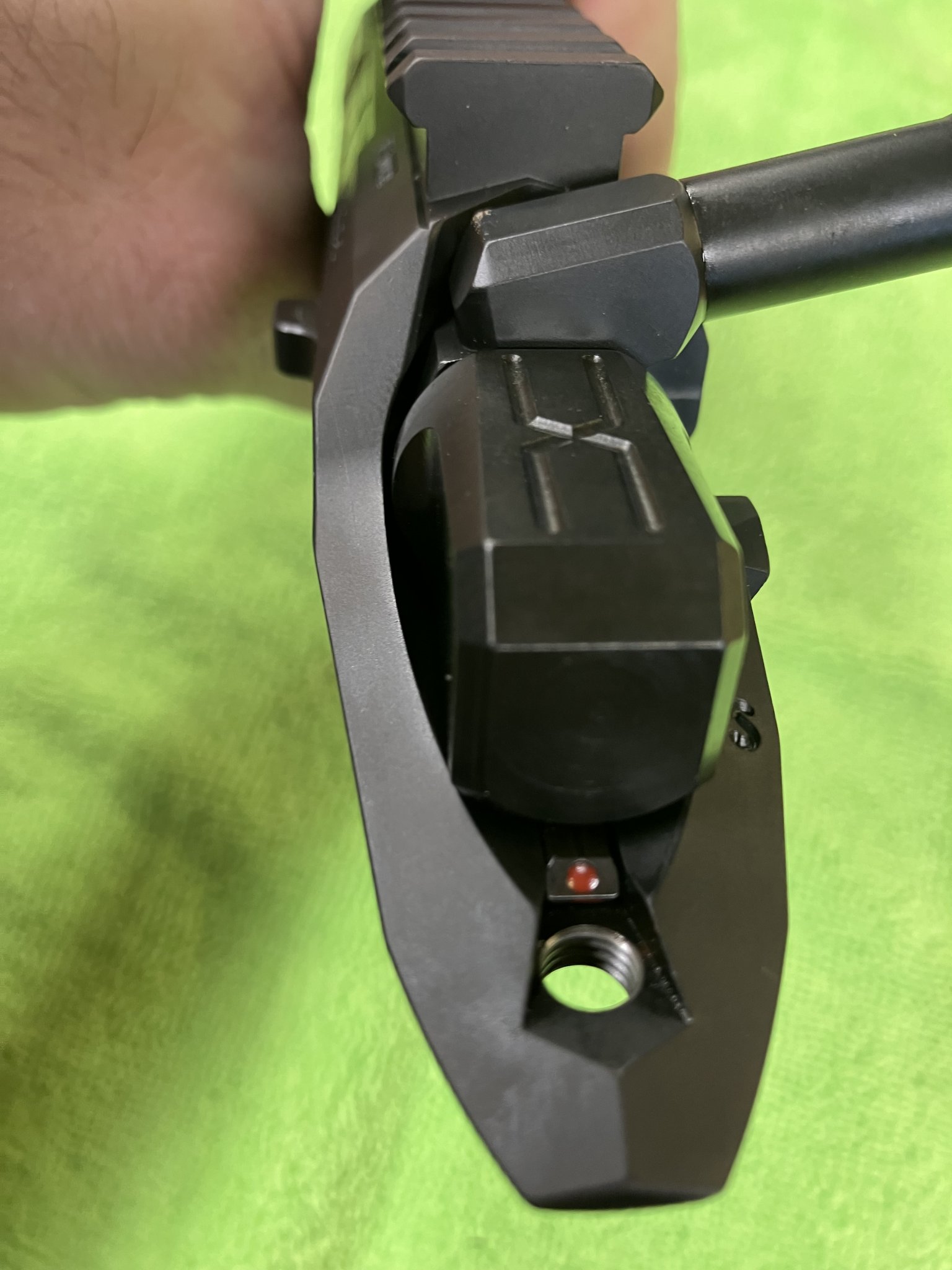

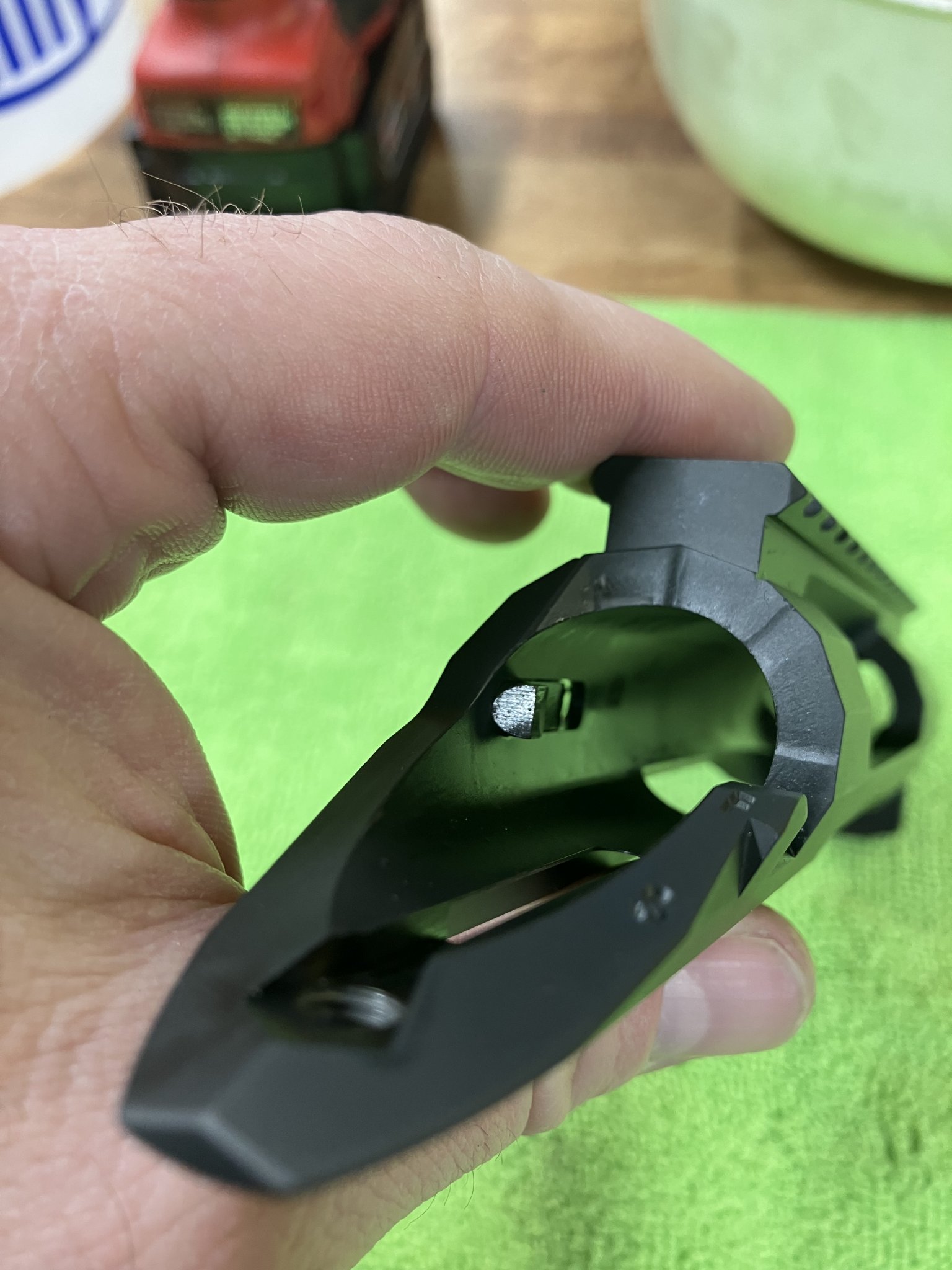

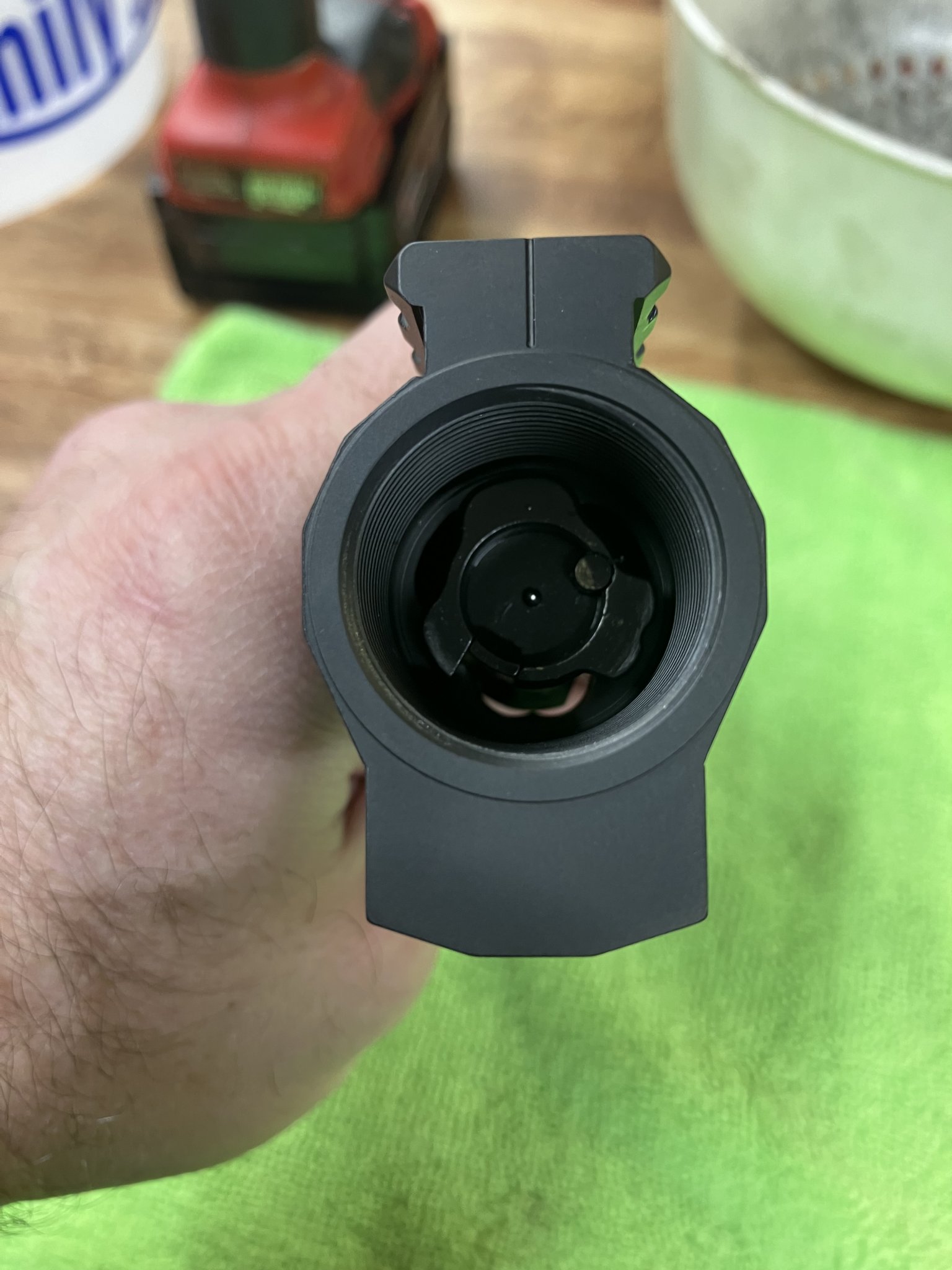

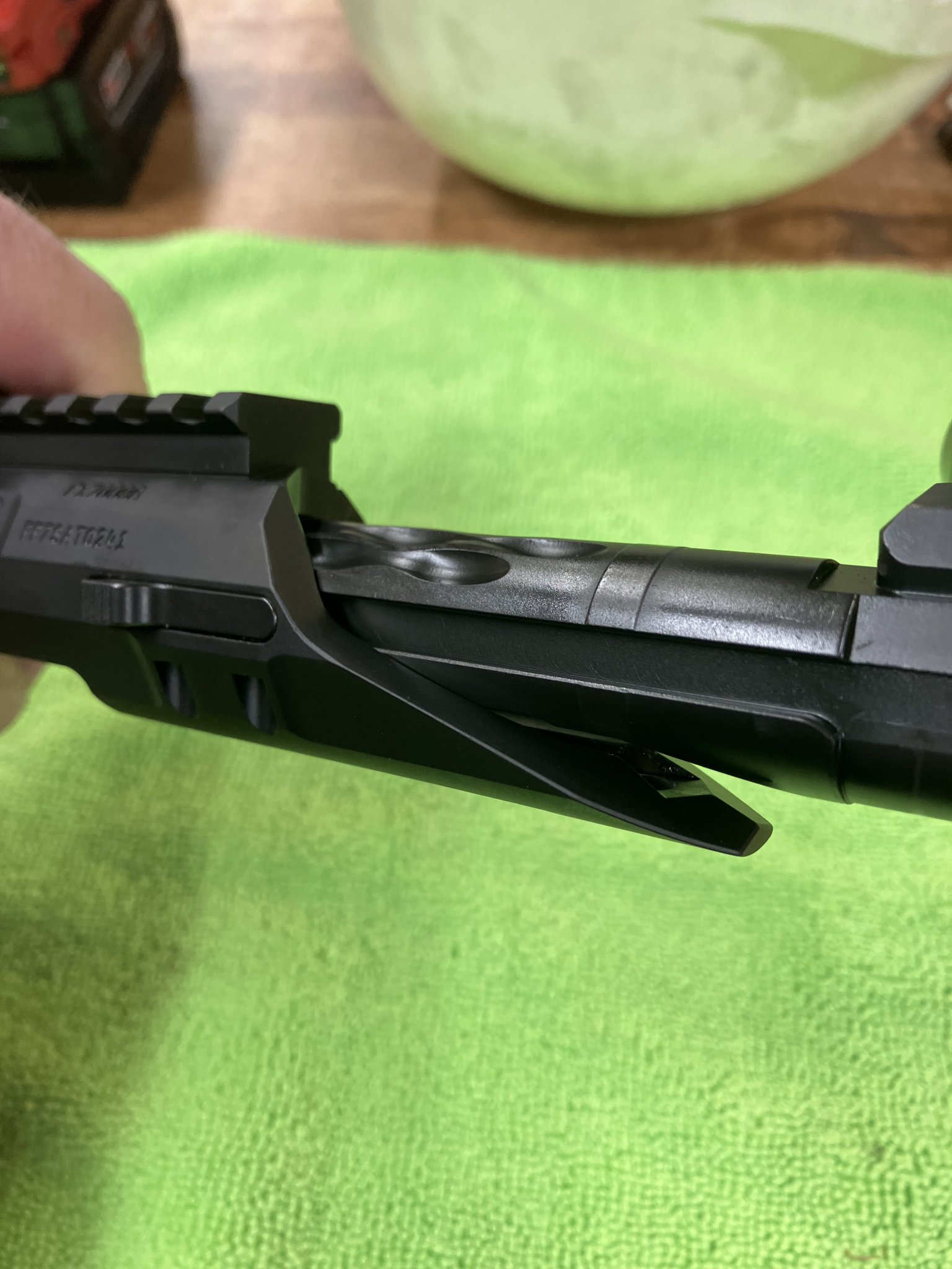

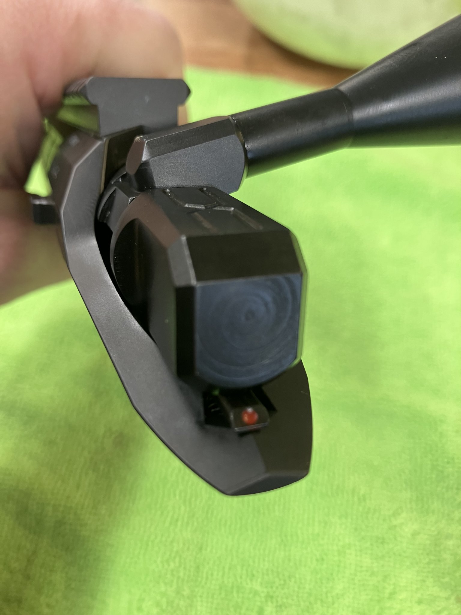

Action is nicely machined, I got the matte finish. It's really a good looking action. One nice little feature is the indexing mark on the front for barrels if a guy wanted to have indexing lines to match up. Compared to my Terminus Zeus I think the bolt lift is a but stiffer for those that don't like that. It may get a little better as it gets some of course. The trigger hanger doesn't interfere with my XLR Envy. I have a trigger tech diamond that I put in it that is set a about 4-6 ounces and could not get it to slam fire by running the bolt hard and fast, so that's a good thing there. My terminus barrels headspace correctly but line up a quarter turn off from the Zeus, the ejection side markings on my barrels land at 12 o'clock on the Faxon. Here's the part that people will find the biggest draw back I think, this action does not have raceways on it like all the actions I have had. The bolt is guided by the bolt stop and the grove in the side of the bolt as seen in the picture. This is what guides it almost all the way until the lugs enter the front portion of the action. The bolt cocking piece also guides it once it reaches the rear of the receiver which is why there is a slight flare where the cocking piece enters. I noticed that if don't hold upward pressure on the bolt handle it hangs up slightly while running the bolt closed. If I use just a little upward pressure while closing the bolt it runs pretty smooth.
Overall the Faxon is pretty nice especially for the money I think, but it will take a little getting used running the bolt without the raceways the full length of the receiver to guide it like most actions. If any one has any specific questions about anything I didn't think of or notice go ahead ask away and I'll answer as best I can.

Looks well-machined. How smooth is it with the 6 lugs? I know it's got to be fast with that 70º bolt throw...

As far as opening a closing, the bolt is smooth and the timing for primary extraction is good. The down fall is making sure that alignment when pushing the bolt forward is good. Without the typical raceways for the lugs to ride in for the full length of the receiver it can get slightly off. The slot in the bolt just doesn't keep it aligned well enough. The lugs on the Bolt can run into the receiver lugs just slightly while running the bolt forward if not running it deliberately like I stated with Slight upward bolt handle pressure. As nicely as the entire thing is machined I can't imagine the will be much runout, but I am just assuming on that.

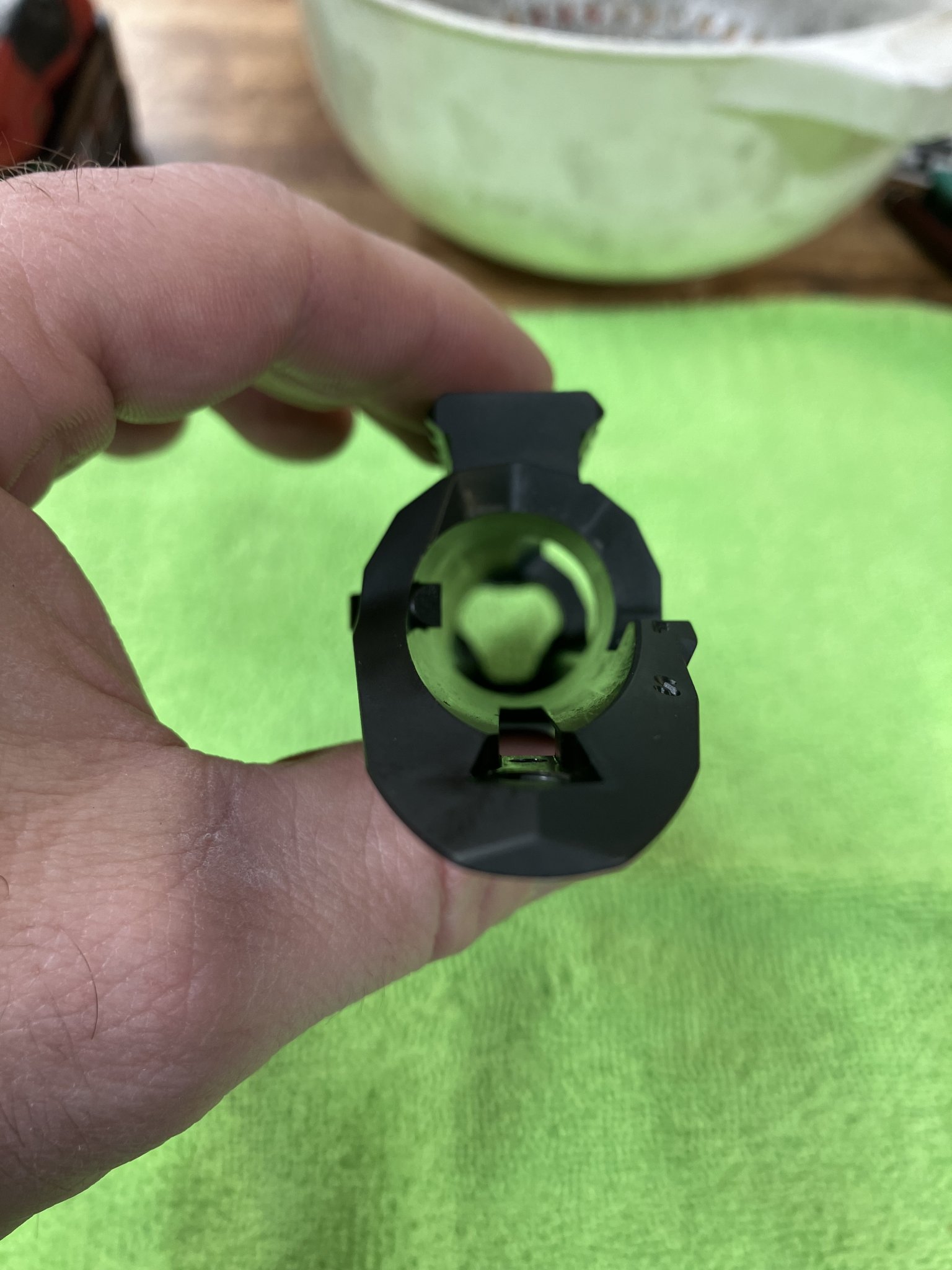

I purchased a 6.5 M24 barreled action about 2 weeks ago, shot it once so far but did really well 0.3in 5 shot at 200yrd, BUT i am having sticky bolt cycles and many times if i slow down too much i also have feed issues with the nose jamming again the edge of the barrel. if i go faster it makes it over, but i looked at several after doing it and there is a significant bump on the nose, i'm sure it would cause flight issues. Have you seen the same? should i go in there with a dremal and take the edge off in the ramp spot? same results with 2 poly mages, and 1 metal mag
Reactions: TacT-MecH
Yeah, I get the same. The feed ramp sucks. It’s shaped like a M4 feed ramp and is too steep and split in the middle. If it was a single smoother feed ramp with less angle it would be much better. Straight up the feeding sucks ass. I’m actually not happy at all with the bolt operation and feeding after having out to the range a couple times. I’m probably going to get in touch with Faxon get it returned. It could be a great action but it needs some adjustments
Reactions: Islas82 and CVAN3
May be you can try AW mag instead of AICS mag.
The split feed ramp maybe works better with AW mag. Do you have one try?
I did use AW mags. Also used ARC mags and MDT and accurate mags. With a 22 Bra barrel and 6x47 Lapua barrel. Bottom line is it doesn’t feed well. Even worse with the center feed mags because the bullets hit the center portion of the feed ramp. It causes the rounds to be pushed to the side some and just doesn’t feed well. With a single wider feed ramp with more angle I’m certain it would feed much better. I have even had several round hit the feed ramp and nose dive back into the mag. I have several thousand rounds on my terminus and have not had any of these issues.
