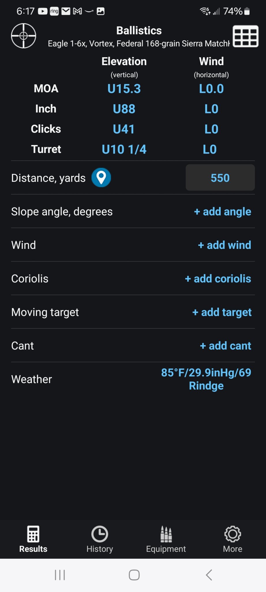

Hi all. I think I have solved the mistery... I feel quite dumb right now, though. So my 20-round average speed is this:
Now dialing the suggested elevation from Chairgun elite
I hit exactly the rock that anchored my target hanging from a 2x4 at 550 yards.
Now what I didn't account for is that the center of the 15 inches gong is about 3 feet from the ground so I needed to go up quite a bit to hit the steel (that is where my 20.5 MOA came from) and when I input that elevation on the app, it gave me back that low velocity.
I probably never noticed so much difference with all my other cartridges because they all shoot flatter at that distance than the 308.
This is the target :
Sorry for having bothered you all.... I should have thought about it a little more.
