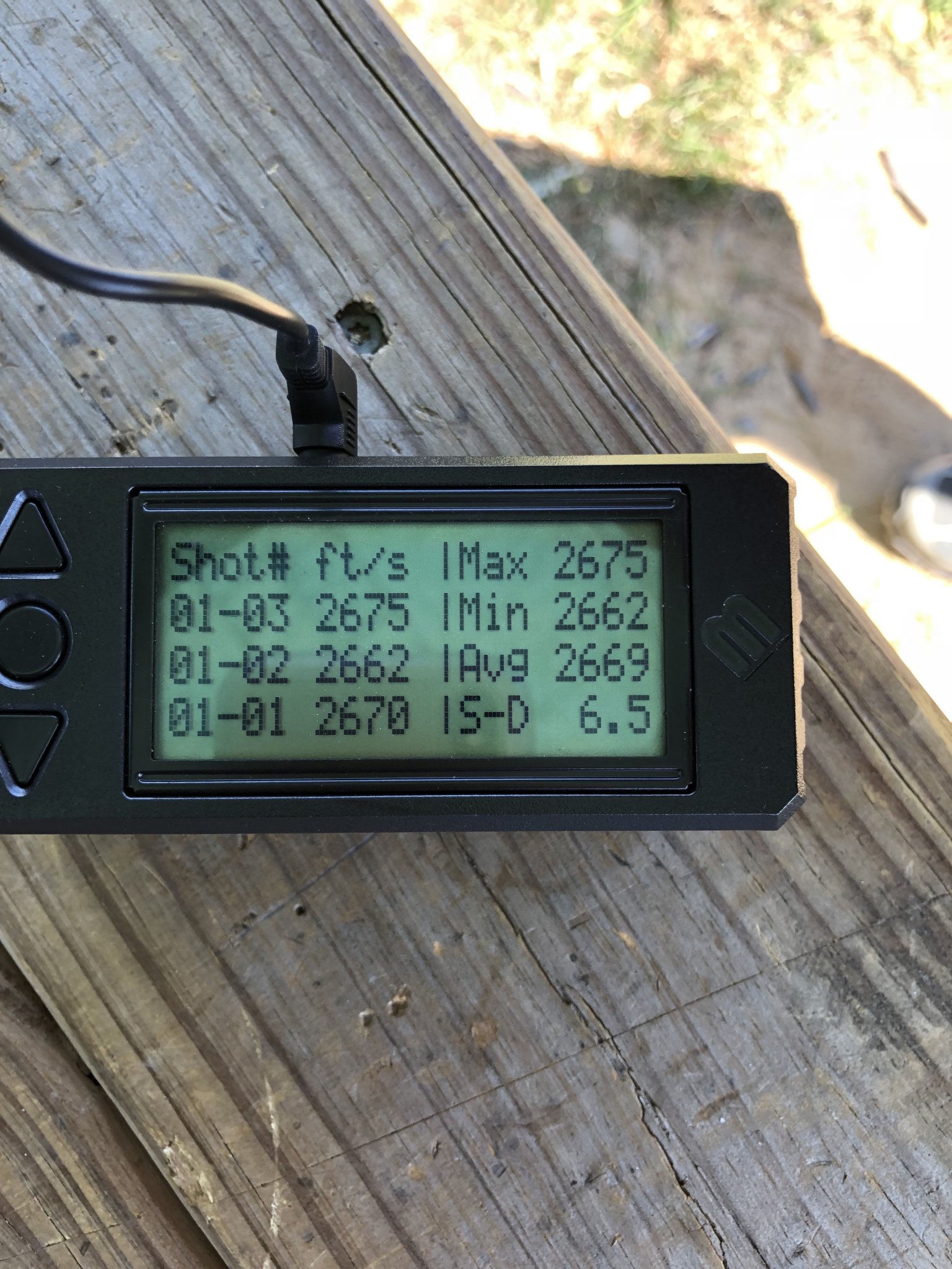

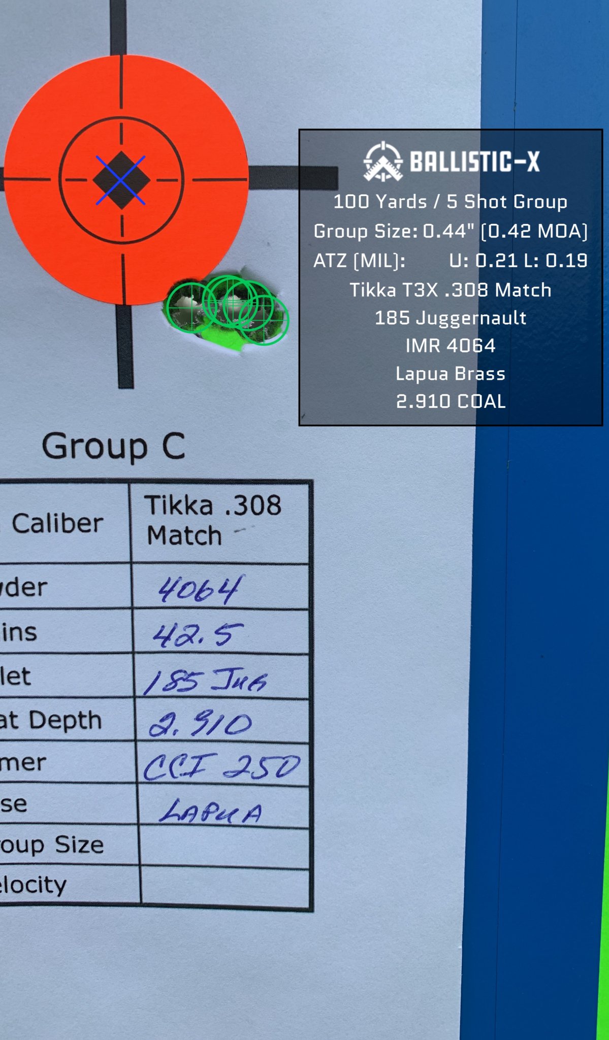

I load the 185 Juggernauts for my 26" .308 AI barrel. I can get consistent .5 moa or better and velocities at 2780. No pressure signs on my load. Really like the round for 308. This load is using 200-MR
I am having good results at loading them at 2.910 COAL (.025 off the lands). However, that is what my rifle likes.
i've used Varget, RL-15 and H4895 and my besst results are with RL-15.

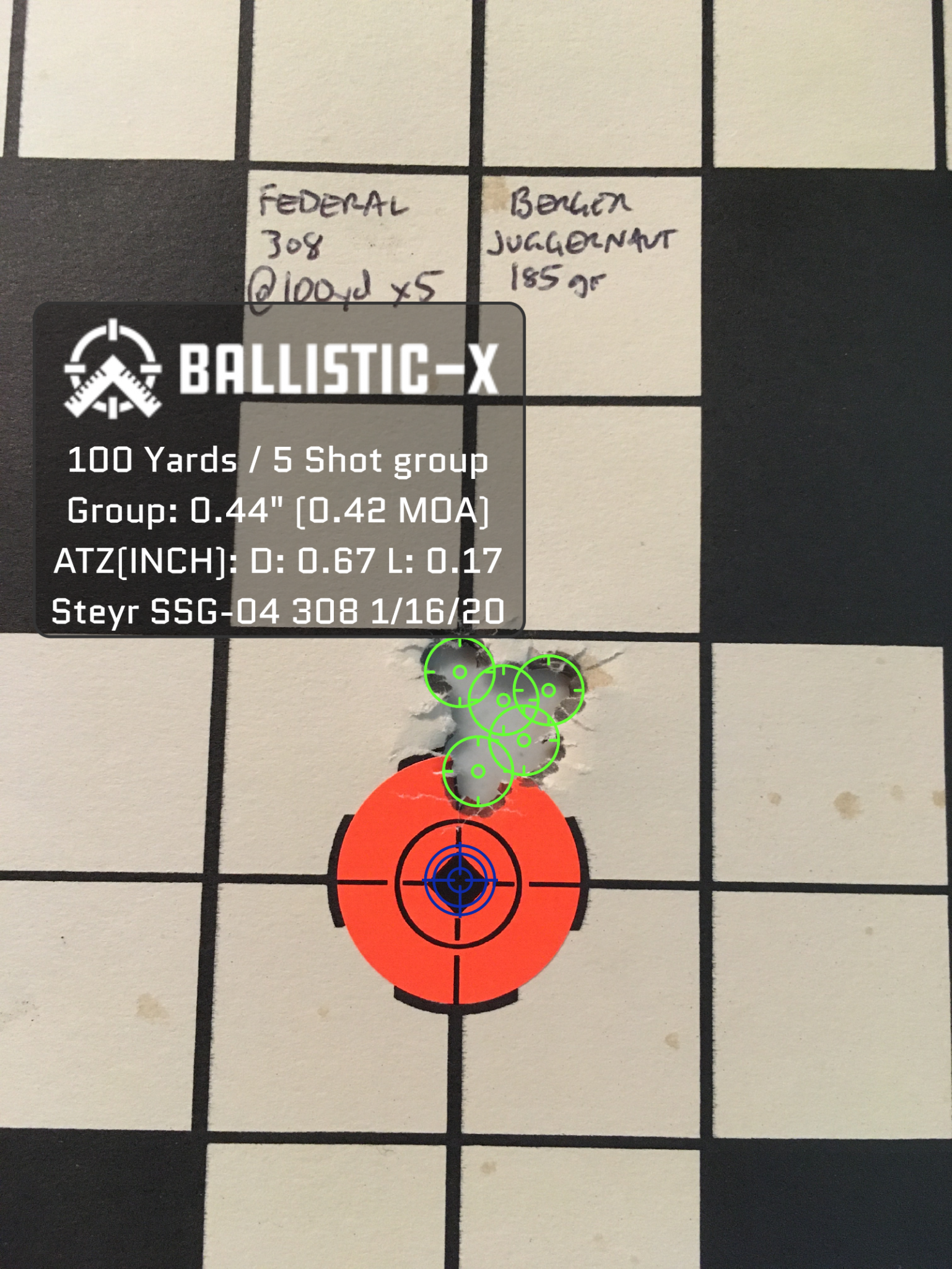

Factory loaded FGMM 185 Juggs.
First 3 rounds out of a brand new barrel. Schneider 1:12 24.5"
This stuff has been my go-to for a while. The ballistics out past 500yd when compared to the 175gr SMK is striking. Elevation dope at 800yds is 6.0 mil flat vs. 175's at 7.2mil.
