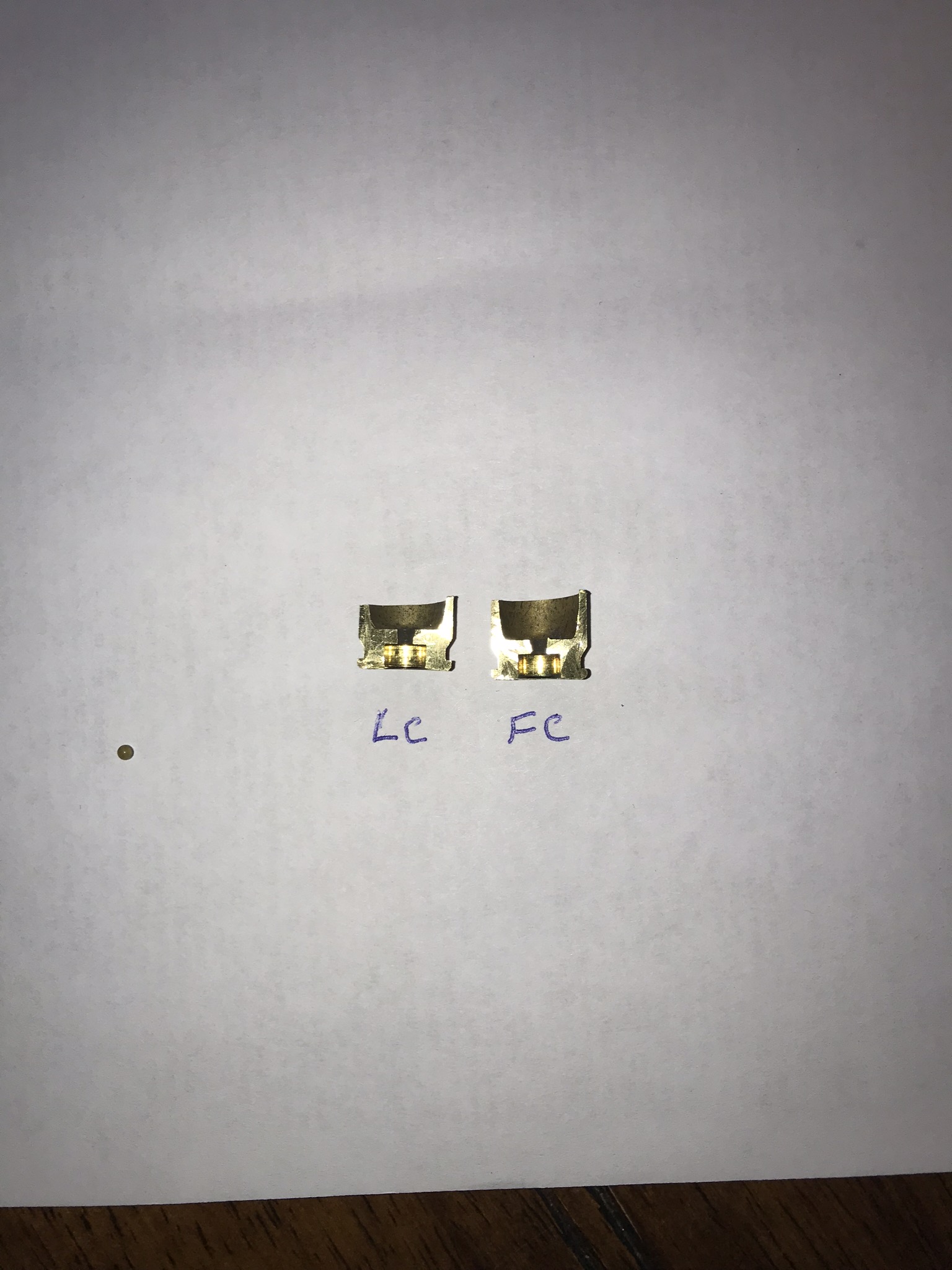

Someone somewhere sectioned a couple of pieces of 308 (?) which showed a thinner base than some other brands which explains the typical complaint about primer pocket growth with hotter loads. From my experience, limited to 308, FGMM brass is no different than any FC brass. It is however very consistent. I weighed 40 rounds and the spread was less than 1 grain.
It is not thinner. The reason the primer pockets fail is because the brass is soft.
