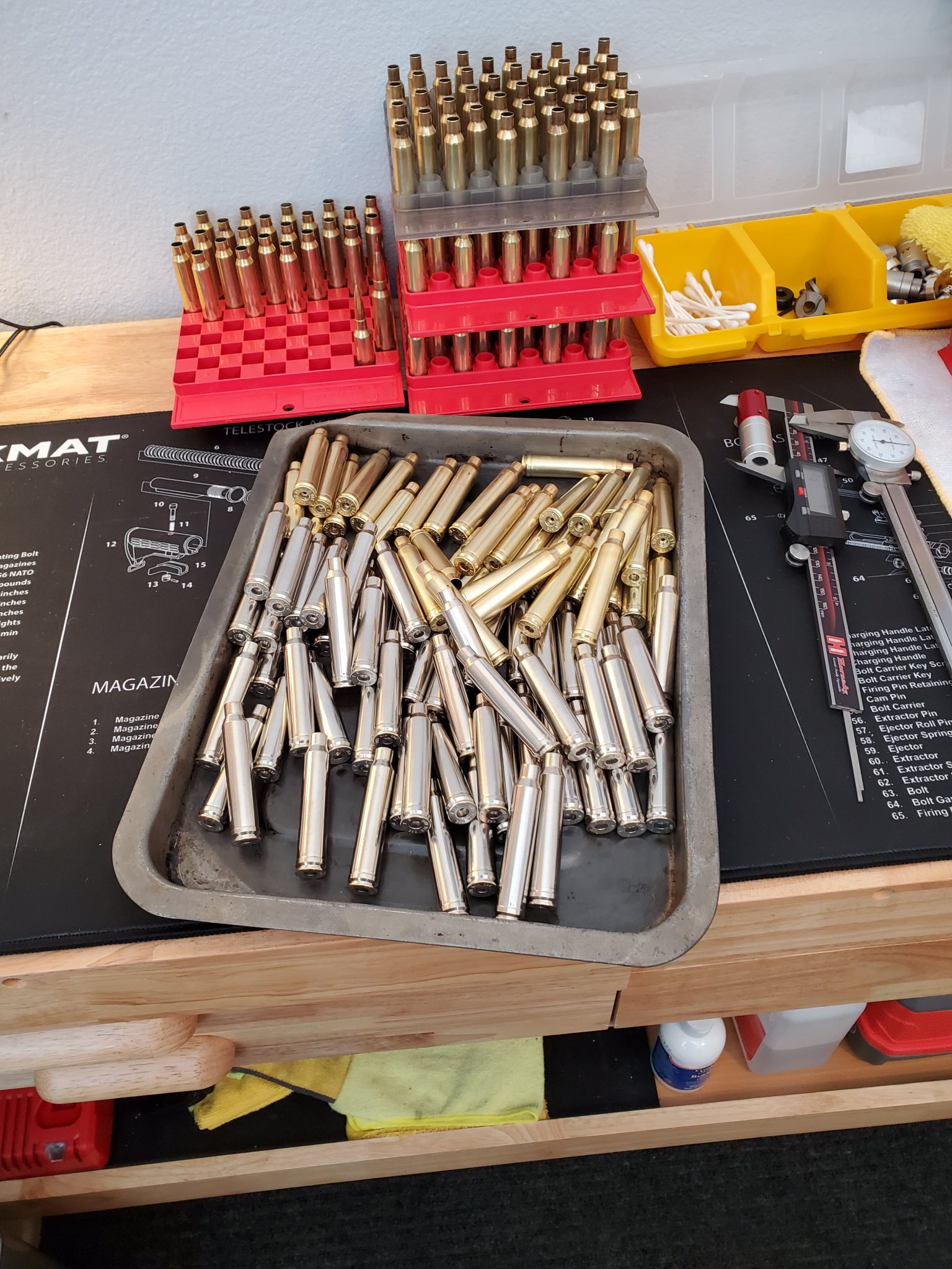

I have about a hundred federal nickel cases for my 300WM that have been fired once. My question is are they worth the effort to reload? I annealed a bunch of brass yesterday and did them as well. Afterwards I sized a couple of the nickel cases and what a bitch.....i don't know what direction to go with them. Are they worth the extra effort?

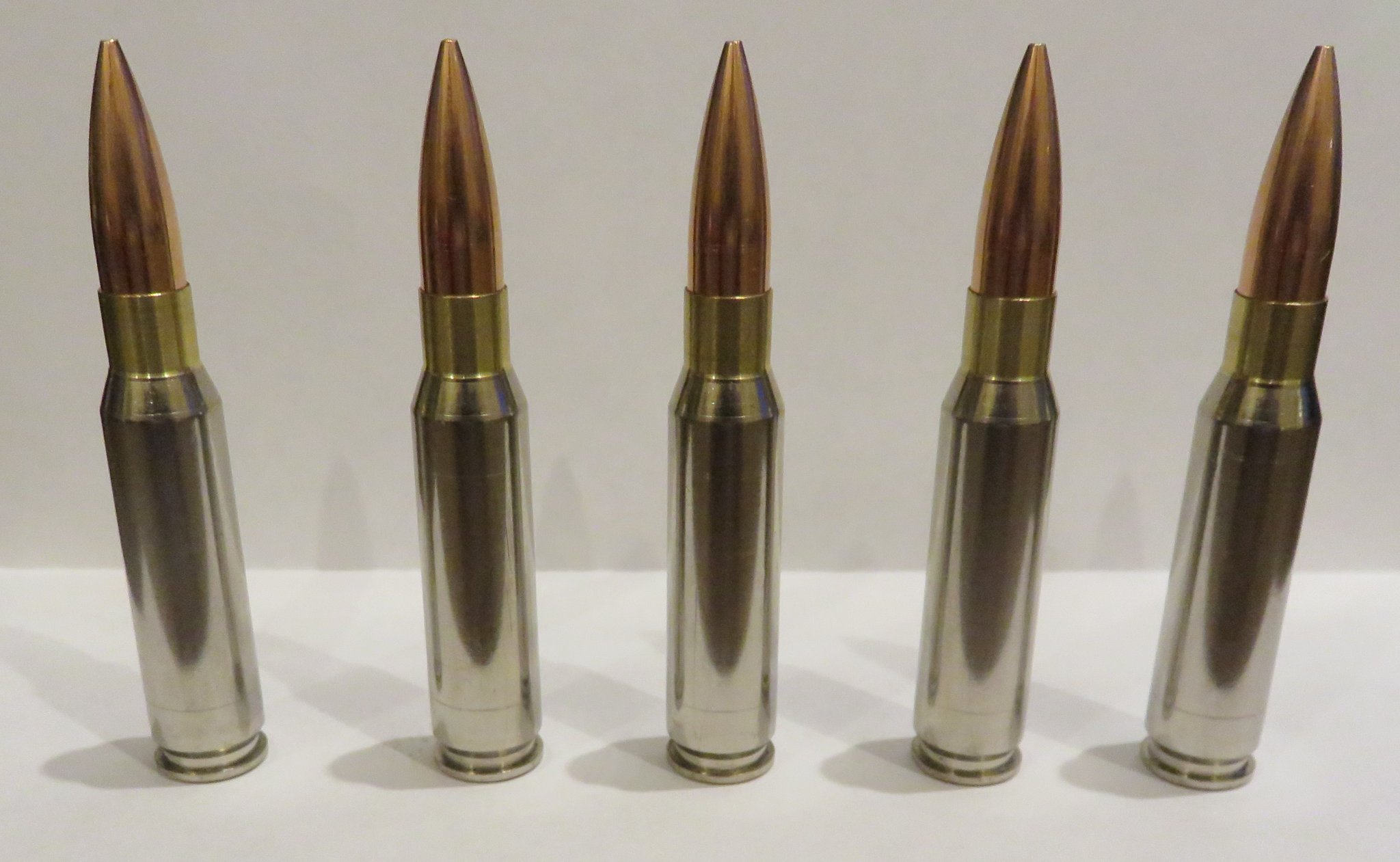

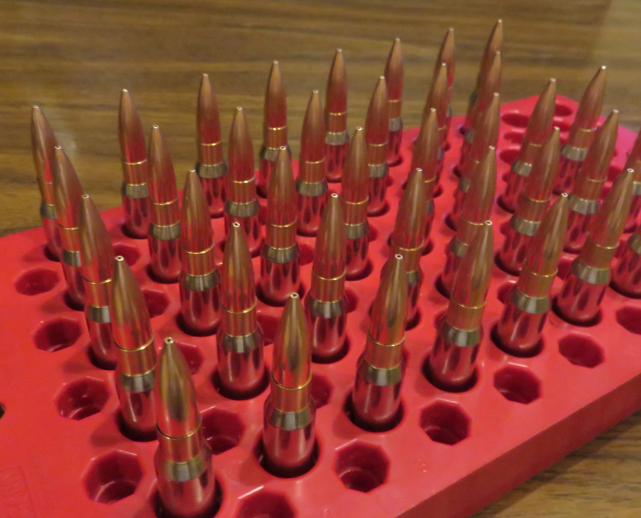

I've FL sized some Federal .308 nickel plated cases and didn't really notice anything different when doing so. They've only been fired 2x, so far. I even turned the necks, which you can probably tell in the pics below on these I just loaded up last night:
