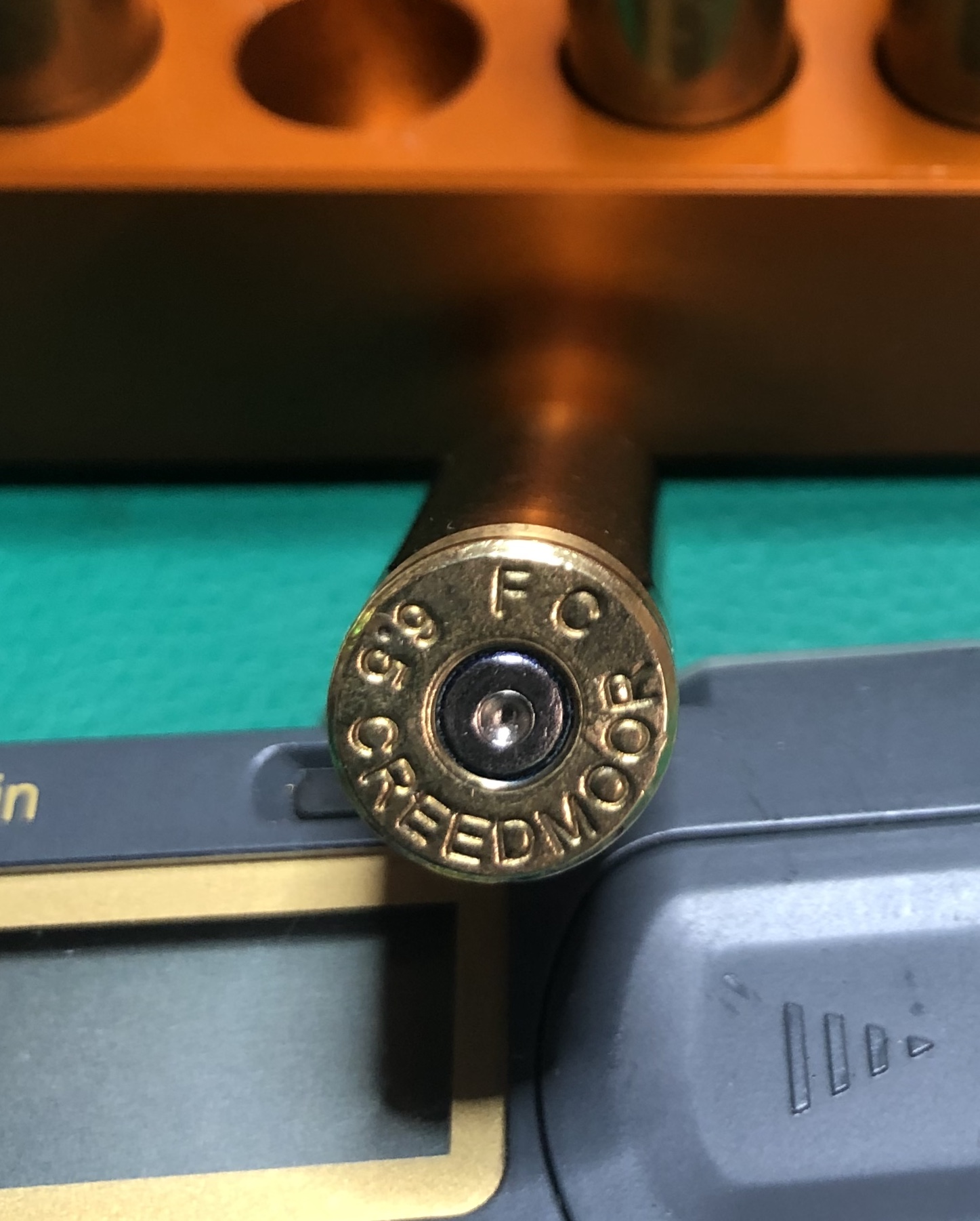

Picked up an FC case at the range that turned out to be SRP brass. Was not aware Federal made small rifle primer brass. Or are they getting it from Starline or Peterson?

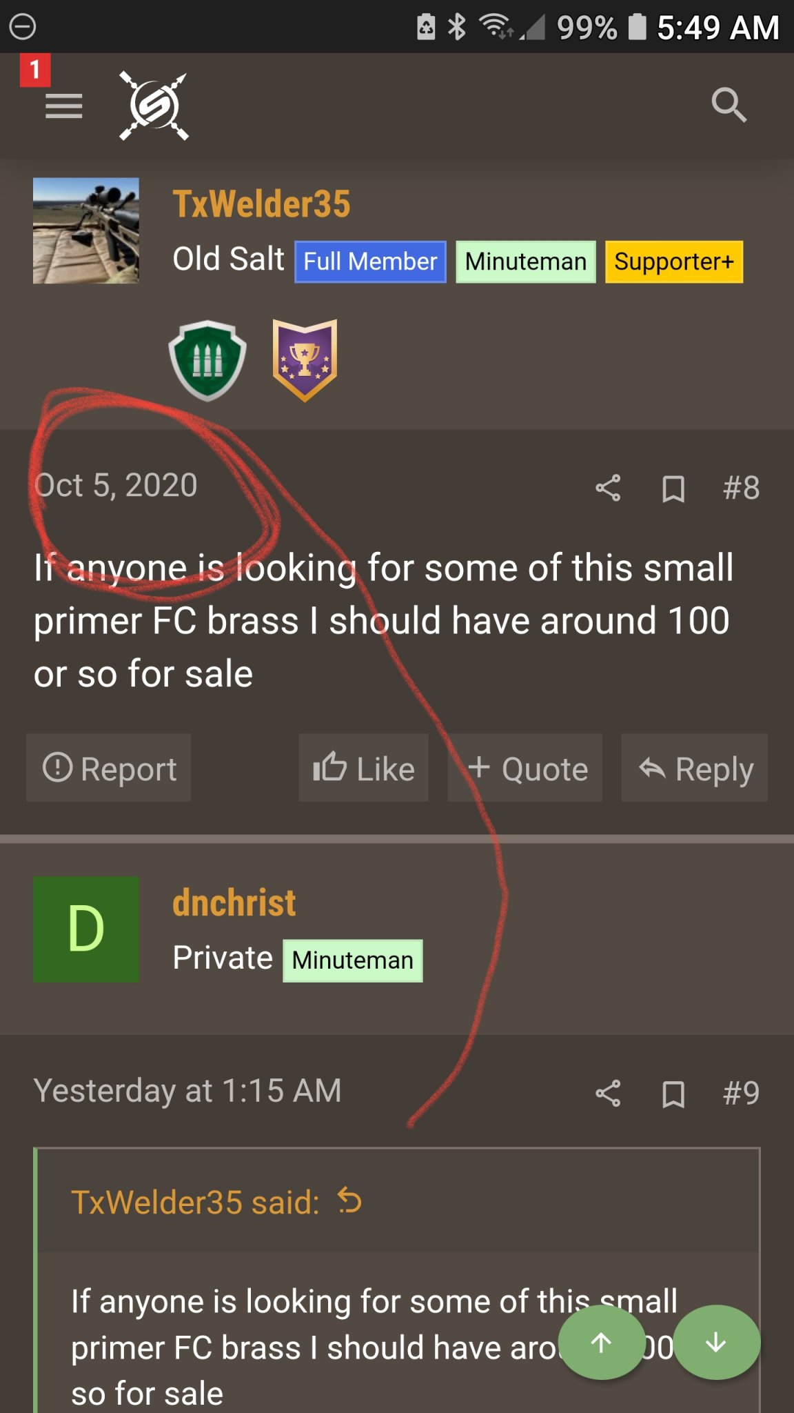

That might be your post time.
Now I am totally confused....
IS TxWelder35 a ghost from the past, or did he just answer me?
Being a newbee, I'm a bit unclear on dates and times that are showing up in a member's post. I'm 76, so some of this is not registering...

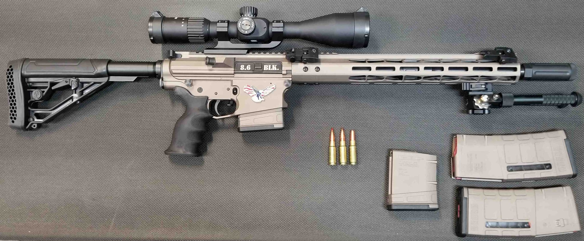

I am looking for FEDERAL small primer 6.5 Creedmoor that I can convert to 8.6 Blackout. I also have a Creedmoor, but this brass is for the Blackout. I prefer small primer for BOTH Creedmoor and Blackout, and have extra large primer brass that I don't need.
This is my 8.6 Blackout. Lower is an 80% AR-10 I did on my mill.
