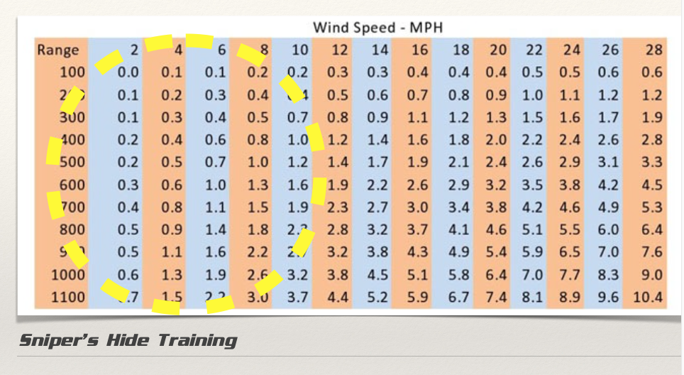

Here is an example of a custom wind chart, using a 175gr SMK with a BC of .496

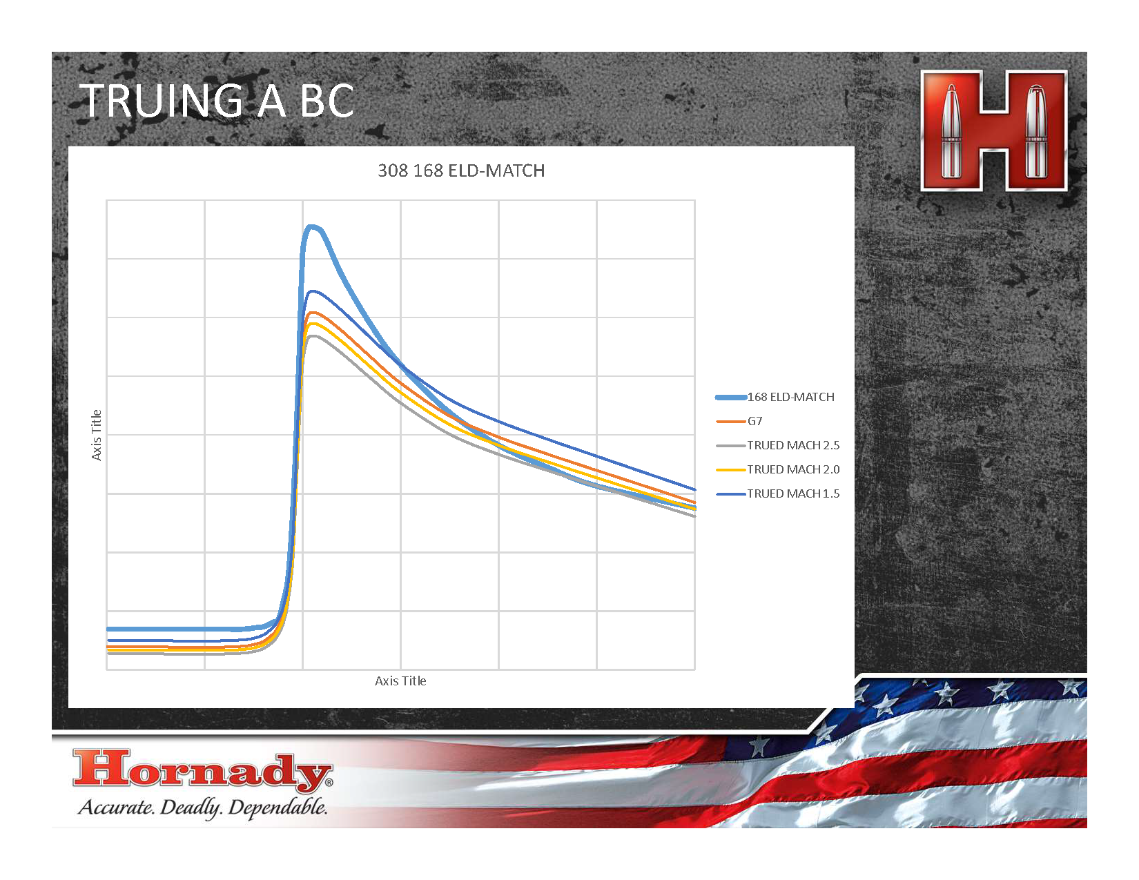

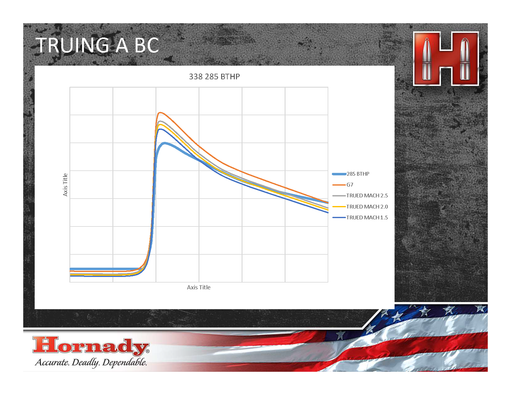

Take the New Hornady 4DOF, they don't use BCs at all, it's all Form Factor. You don't even insert a BC number, doesn't use a traditional BC. You adjust the form factor.
Lapua also use the CD Doppler data, go to JBM and pick CD, that is a Doppler number.
In many cases, I recommend before they true any software like AB, Shooter, Ballistics, etc, to try the G1 number first and compare the prediction to both. In a lot of cases, the G1 works better, it depends on the rifle and shooter.
The only time you should see a difference is at Transonic and Beyond, at Supersonic ranges, there should not be a difference in the solution. As I already said, I rarely default or use G7, I only try to use it with AB and even then I keep all the extra stuff like SD, CE, off, it matches the real world better.

Why do you think we always used G1, the first number of the value, equals the wind speed.
Look at my wind chart, then consider a .G1 BC value that starts .4XX, that means a 4 MPH wind will appear like I posted if the BC in the bullet is .6XX you would move the values under 4MPH to the 6MPH column.
The Real world Doppler values do not line until you true it, and unfortunately when you true with MV you are doing it to where it honestly only works under those conditions. Inside 1k, it will work ok, but the reality is, it's a poor way to go about doing business.
The bullet doesn't care G1 or G7, the software does if they use the old Freeware like they do. You can write the software to not care or to care more, just depends on the author.

The BC for the standard .308 is .4xx so you use a 4 mph window.
100 = .1 mil at 4 mph
200 = .2 mil
300 = .3 mil
400 = .4 mil
500 = .5 mil
600 = .7 mil due to velocity bleed off and correcting the estmate
700 = .8 mil
800 = .9 mil
900 = 1 mil
100 - 1.1 mil
Every four mph window then becomes a multiple, so 16 mph wind at 500 is (16/4) 4 times .5 mil or 2 mils
This can be used for 5.56 with a BC of .3xx, using 3 mph windows, the 300 Win Mag with .5xx BC using 5 mph windows and so on. Adding .1 mil to the window for each mph, ie 5 mph at 500 is .6 mil will get you on the target.
This is minute of man accurate, it’s not gonna get you a soda can hit at 1400yds but it will get you a hit on a human size target.
