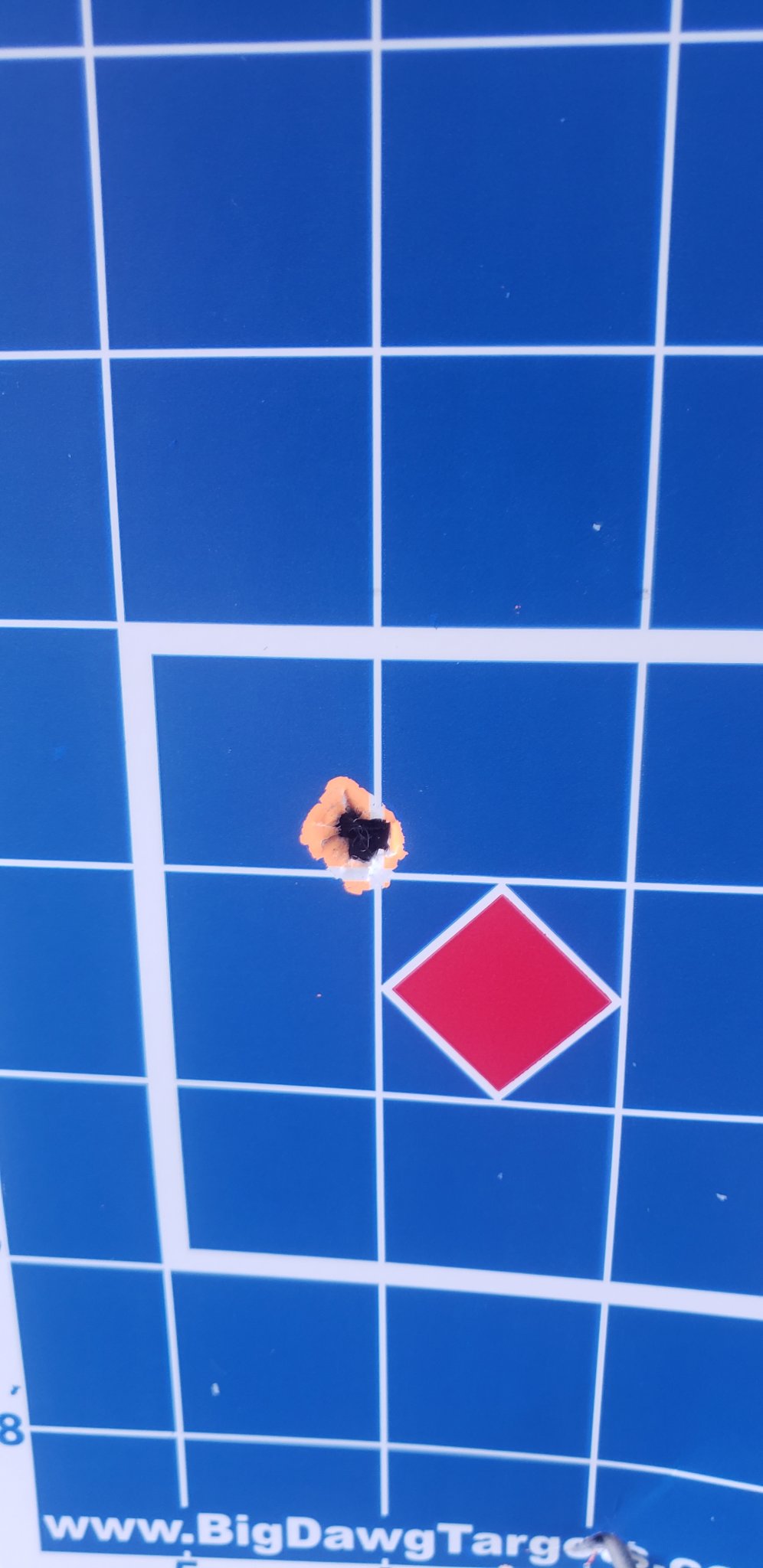

Used 2 shots to see where i was hitting.....3 to zero...then shot this 5 shot group. Its only 25yds...but im not a good a good shot
18" Fedderson

That's the way mine shoots too. First time I shot the rifle I zero'd the scope then shot a five shot, one hole group, in a test target for my nephew who got it for christmas when he was 12.

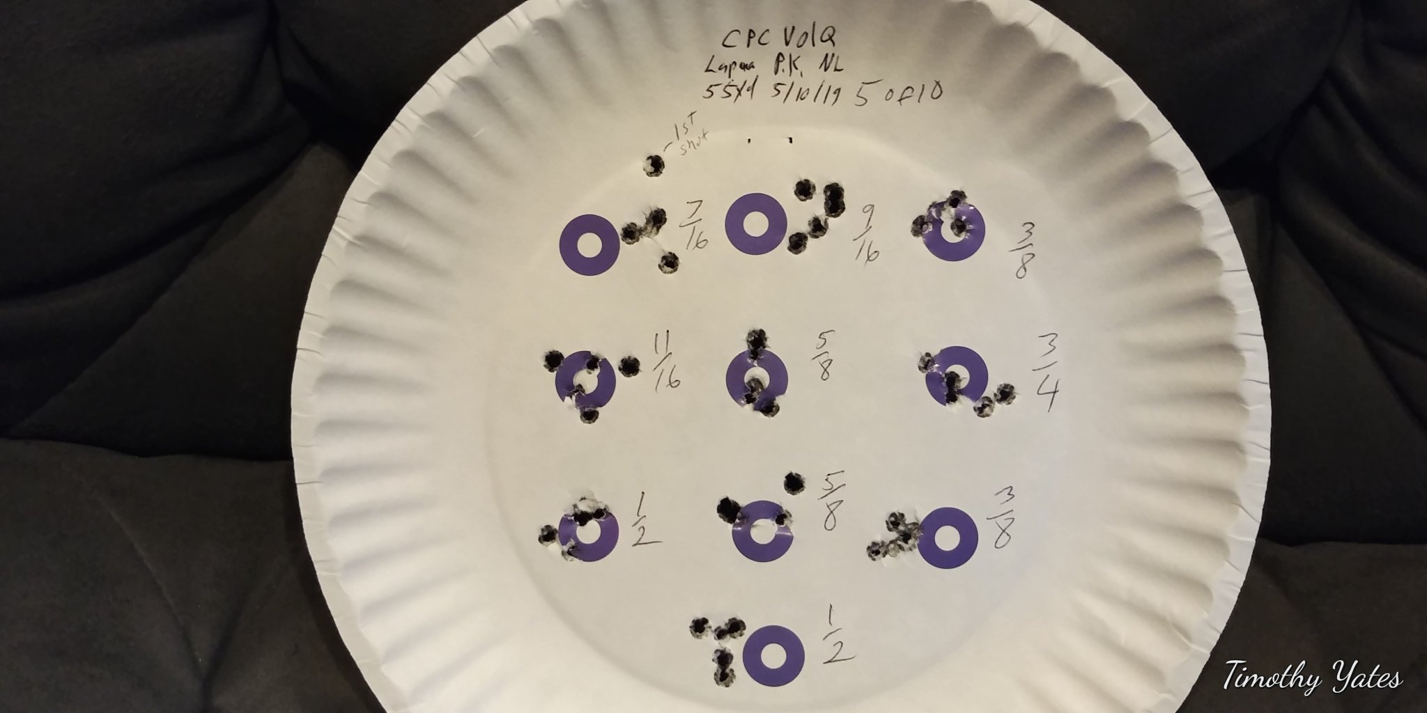

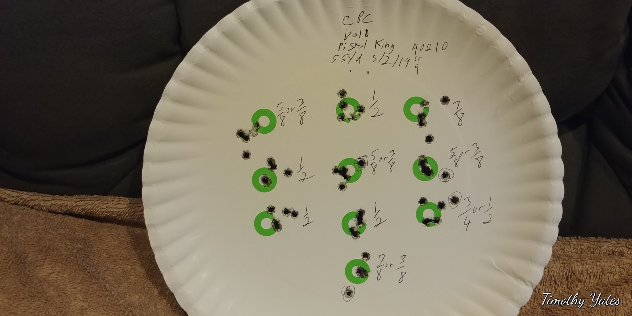

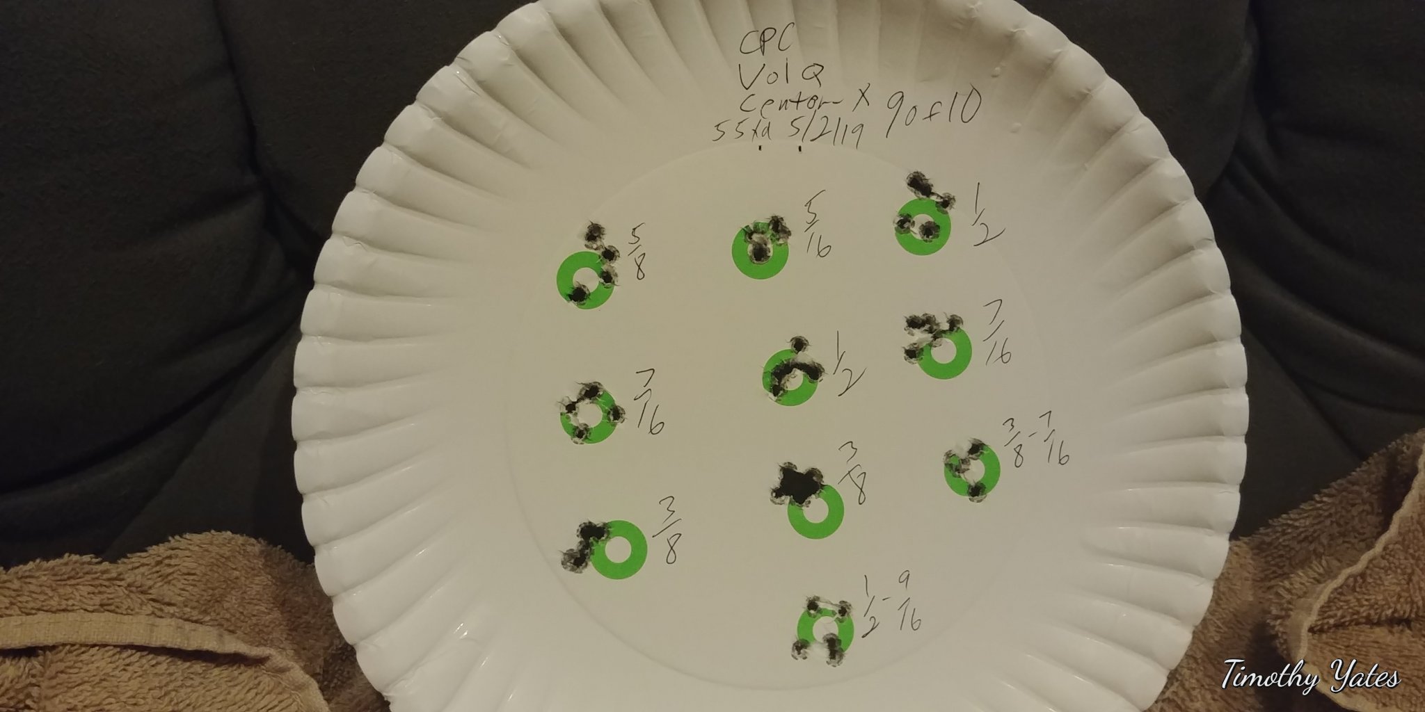

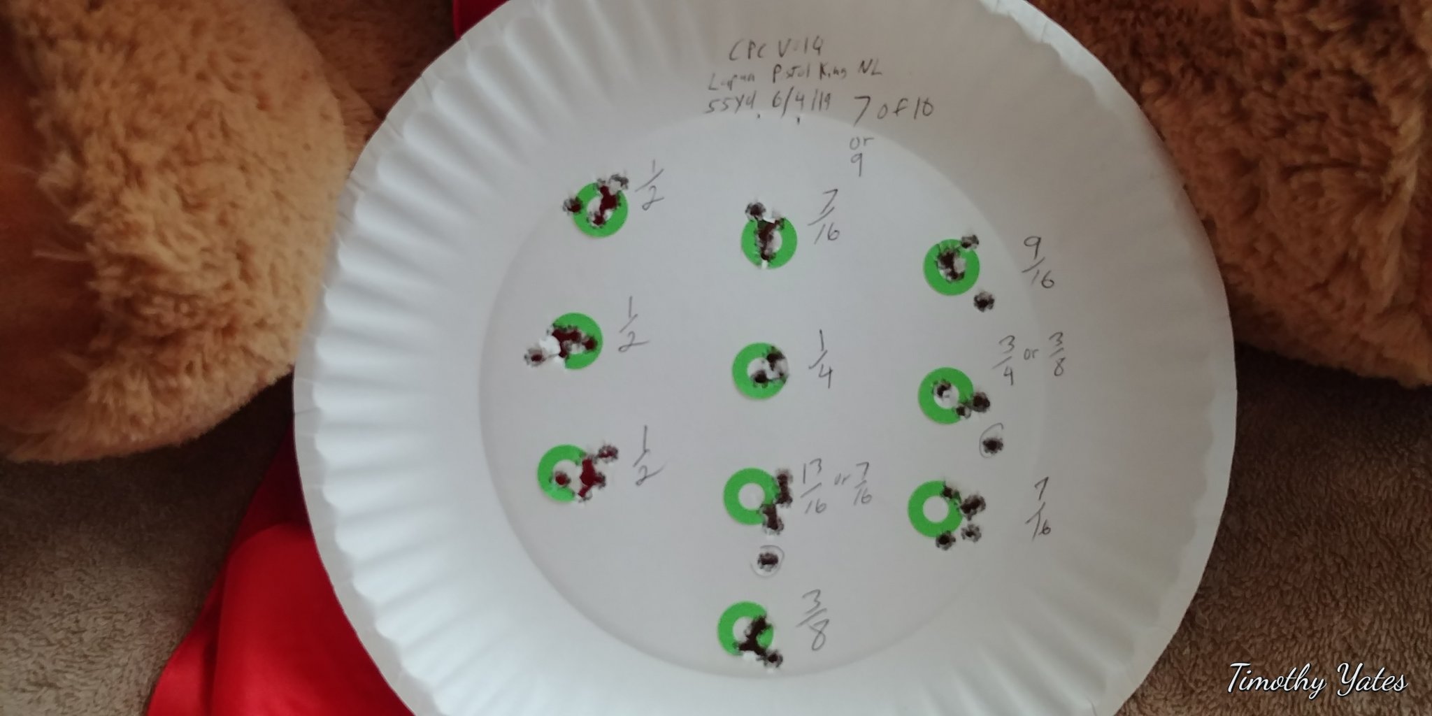

Typical groups. Nothing special. IMO 10/22's are money pits that everyone can't help themselves but fall into. I didn't learn my lesson the first time 20 years ago and a few years back I go and do it again.
