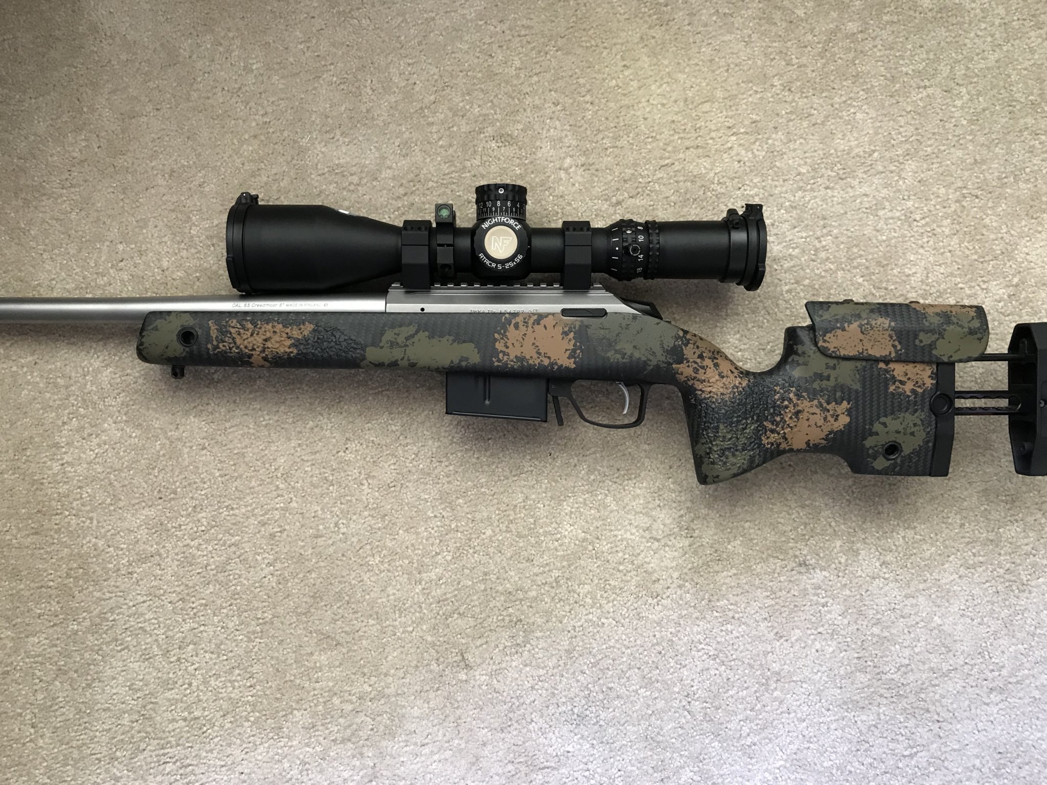

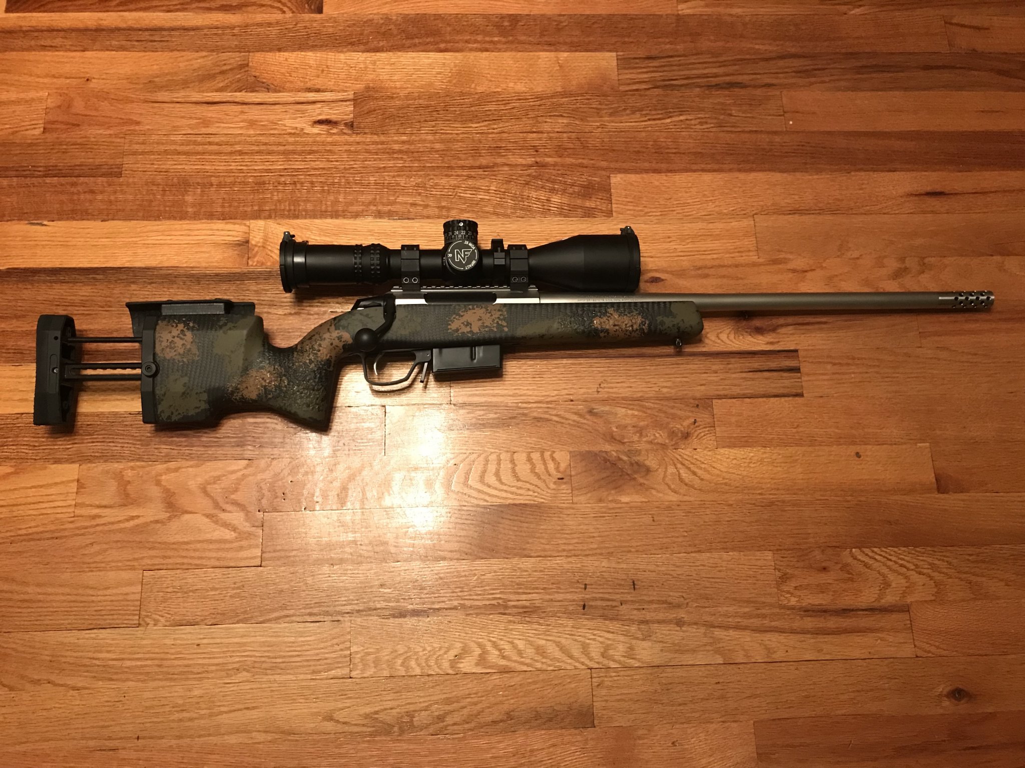

Another vote for the manners CS stock, not t to heavy and will grow as she grows. Not to mention daddy can have fun with it to, here’s mine for my kids
