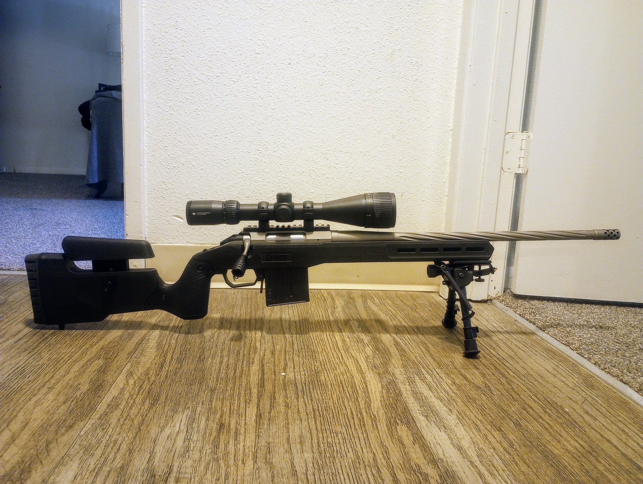

Ruger American Gen1 6mm Creedmoor in a KRG Bravo. Built it as a hunting rifle, with the Mk3 HD weighs just over 8lbs. So far feeds 100% with the MDT mags.

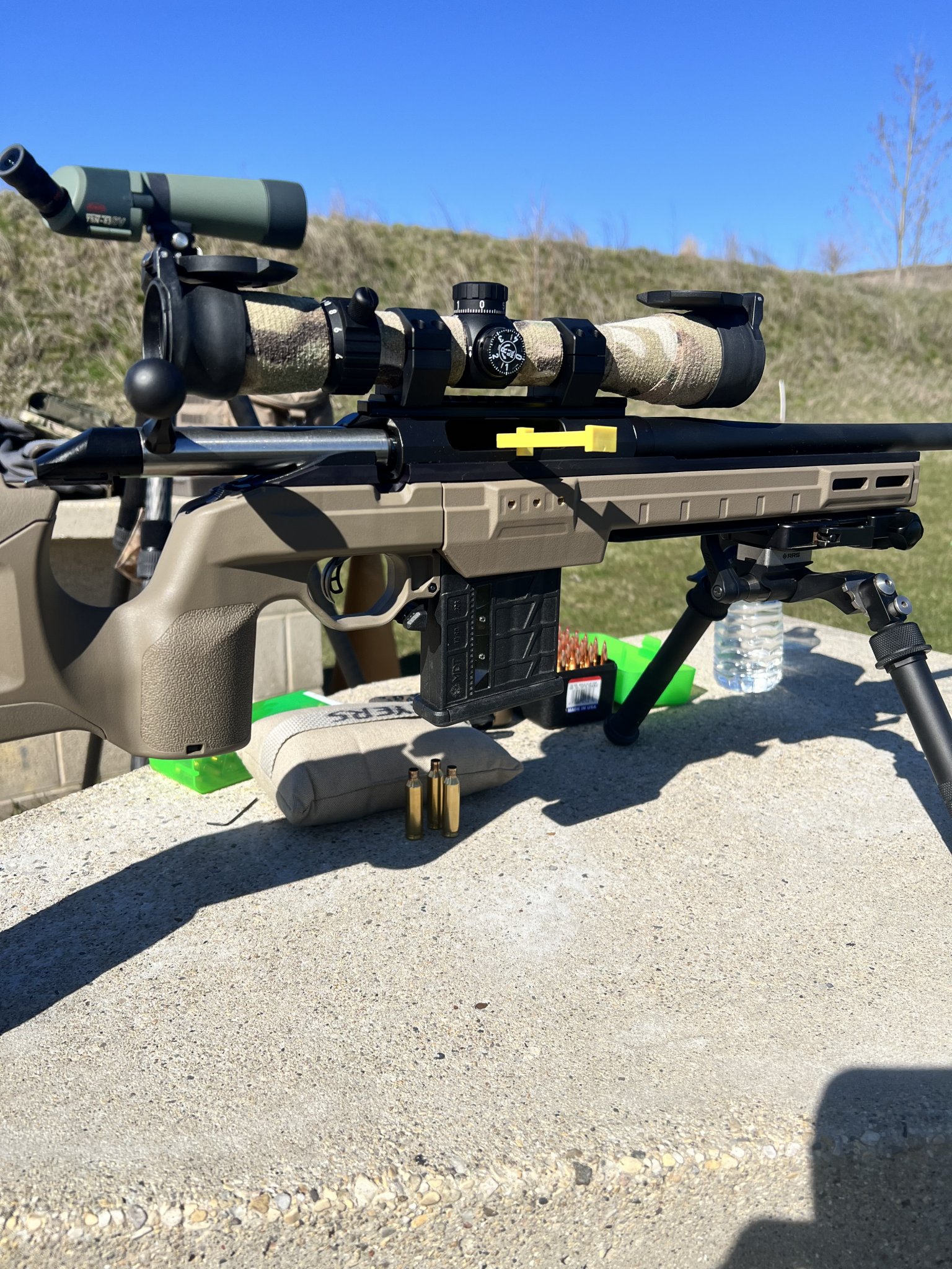

I put the MDT Field Stock on my Ruger American gen 2 in .223. It's the first aftermarket stock I've bought so I can't compare it to the others, but it's a huge improvement. It's way more rigid and comfortable than the factory stock and helped my accuracy a lot. It does add a few pounds of weight so might be a little heavy to hike with, but for target shooting (which is what I do) the extra weight is a plus.
I did have issues with the mags feeding when I first got it and figured out that it was due to the mag release latch being too short. MDT sent me a couple of replacements and since I got the right size latch in it's been running great.

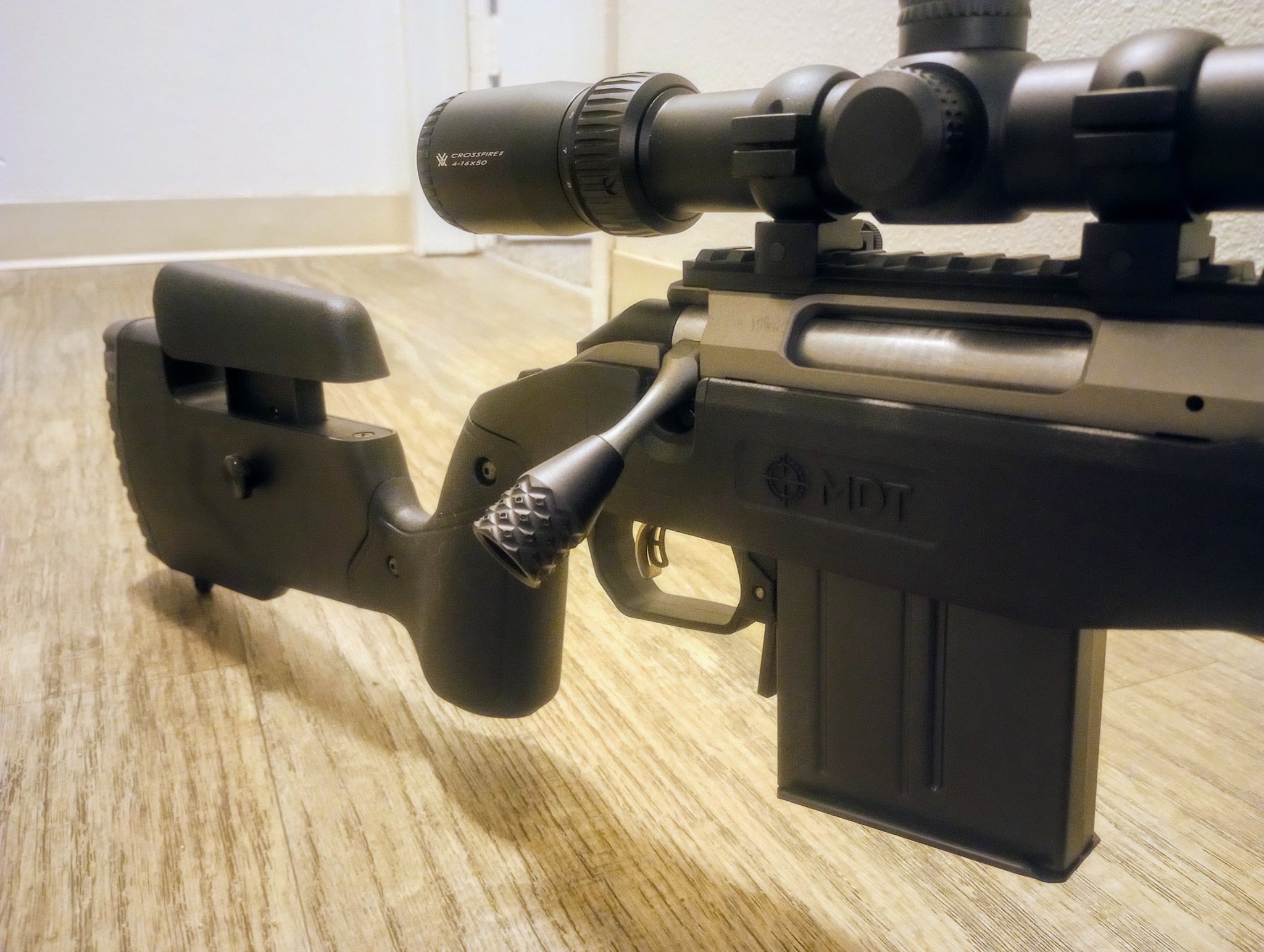

I have the oryx stock on a ruger american predator that I had PVA barrel put on to convert it to a 22 creedmoor from a 6 mm creedmoor. The rifle shoots well and no issues with the stock itself. I have had issues with MDT's ACIS magazines (poly) feeding in this gun. The poly mags also would jam with more than 4 rounds in them (MDT 10 round mag) and not feed properly. When I switched over to the MDT metal/poly mag that fixed both issues on this gun, although I also had to smooth out the feed ramp on the action with a cadex bit.
The field stock wasn't available before, so I had 2 other guns in their XRS chassis, a 243 and a 6.5 creedmoor. Both guns shot better with this version of stock and no feeding issues with them. Again just the jamming issue with more than 4 rounds in the MDT poly mags and the metal/poly mags fixed that issue. Biggest issue was the placement of the QD sling mount. I had to place my sling on the right hand side because it would interfere (sling) with head placement when shooting.
These guns are all used for hunting. Only other issue that I have had on all these stocks is trying to get the pin placed in the mag latch with that spring. Seems to take me forever to get it started right and seated.
If the field stock had been available, that is probably the one I would have first used.

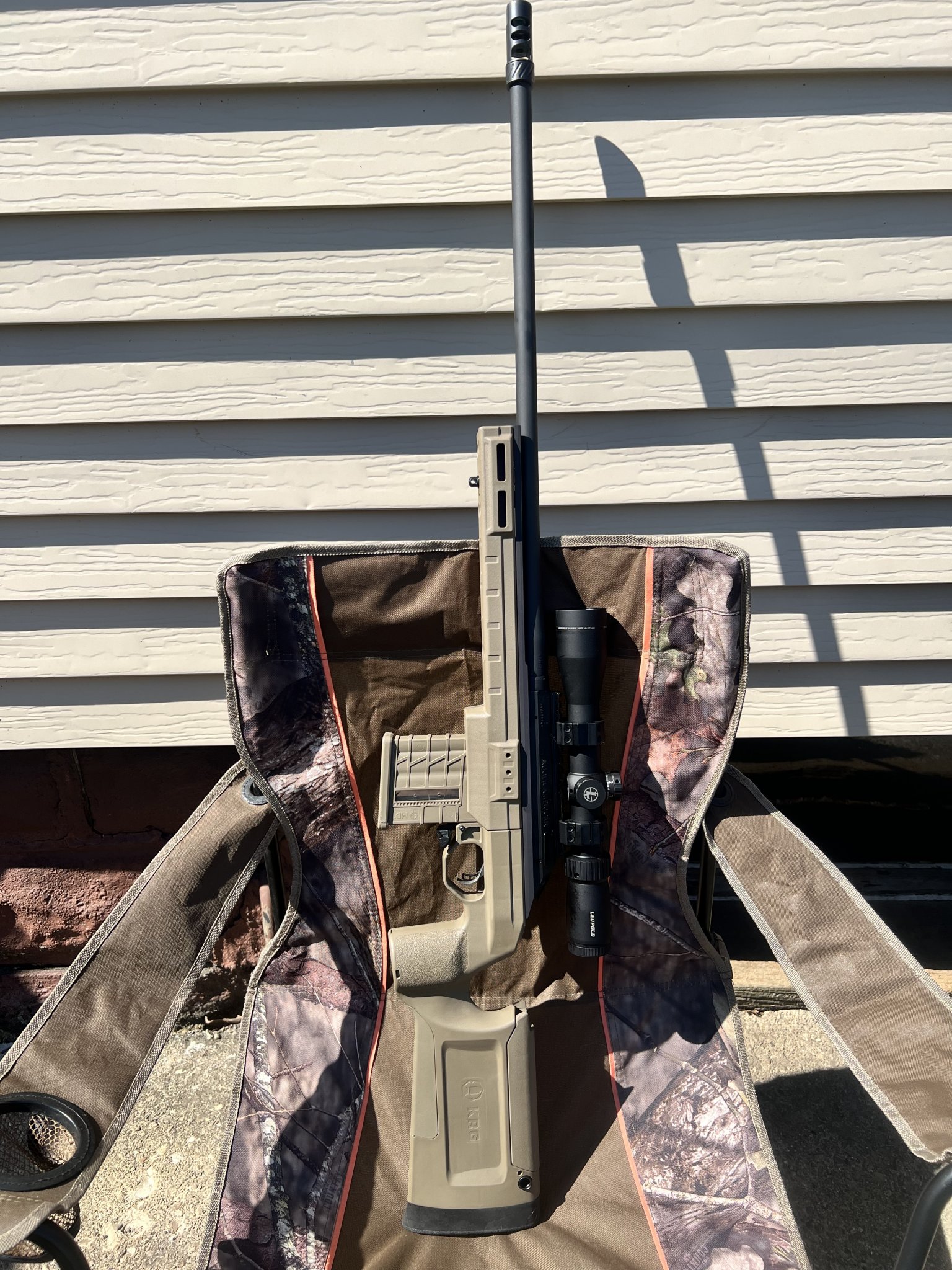

Thanks for everyone's feedback. I received my PVA barrel and decided to go for the Oryx stock since I found one for a good price. When I get everything together and shoot it I'll post up some pics. I found that MDT does recommend the metal mag so that's what I'll be using right from the beginning. A bit pricey, but I don't mind payimg a little more if it results in zero issues
Reactions: Harman117
Well, today I put the action and original barrel into the Oryx stock. I realized I may need slightly taller scope rings to make sure the objective clears the barrel, so I figured I would first try things ot with only the stock being changed. Wow, I didn't know the mag release was going to be such a PIA on these things. And it doesn't allow a straight shot to the rear action screw, so I'll have to see if that's a problem. On the bright side, I heeded the advise to get the hybrid metal/polymer mags and my dummy rounds feed and ejected 100%. Excited to try it out and then tackle the barrel replacement

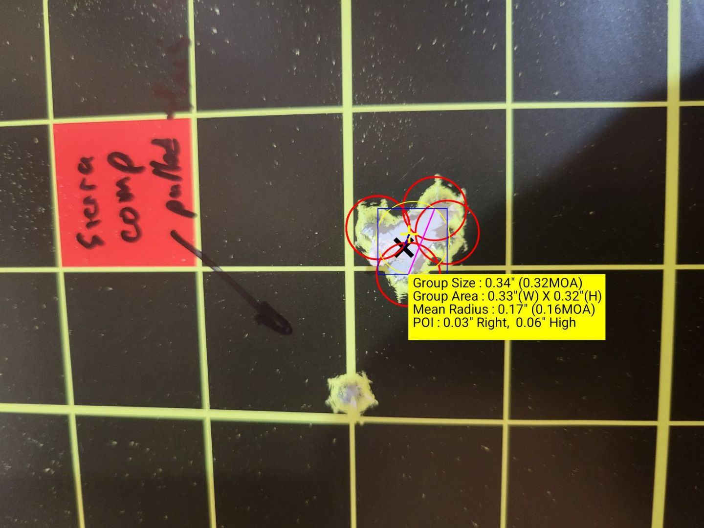

Update: PVA barrel is installed, took it out a few days ago to break it in and see what it would do. Other than the fact that having to take out the mag release and re-install it is a major PIA, I'm pretty happy with the results. Shooting Sierra 223 77gr "Competition" rounds, did a 4 shot group at 0.32 MOA (I pulled the 5th shot, touched the trigger before I was 100% set (last round of the day and I was getting hungry...)
