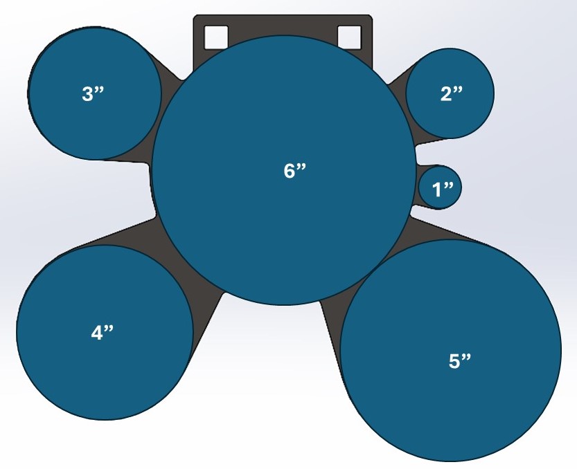

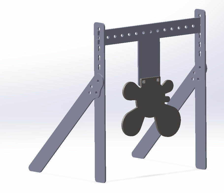

Background: My friend has a little land where we can setup and shoot distance and I've bought some steel targets and stands for this purpose. I have found them to be a little clumsy or fragile and limited in number of targets/sizes you can use until you get way up in price.
So I thought I'd make something that might satisfy some of the annoyances which were mainly: storage/transportation/ease of setup/limited target size selection/stand construction (thin steel tubes)
Attached are the pictures of what I came up with.
Stand - flat pack and made of plain carbon steel everything attached with clevis pins (1/4")
Hanger - rubber strap
Target - 6 in 1 1"-6" target in 1" increments AR500 (designed to keep center of gravity in the middle) 3/8"
Top crossbar AR500 3/8"
I have not had any of these parts cut out yet. I wanted to get feedback on the design first of both the target and the stand.

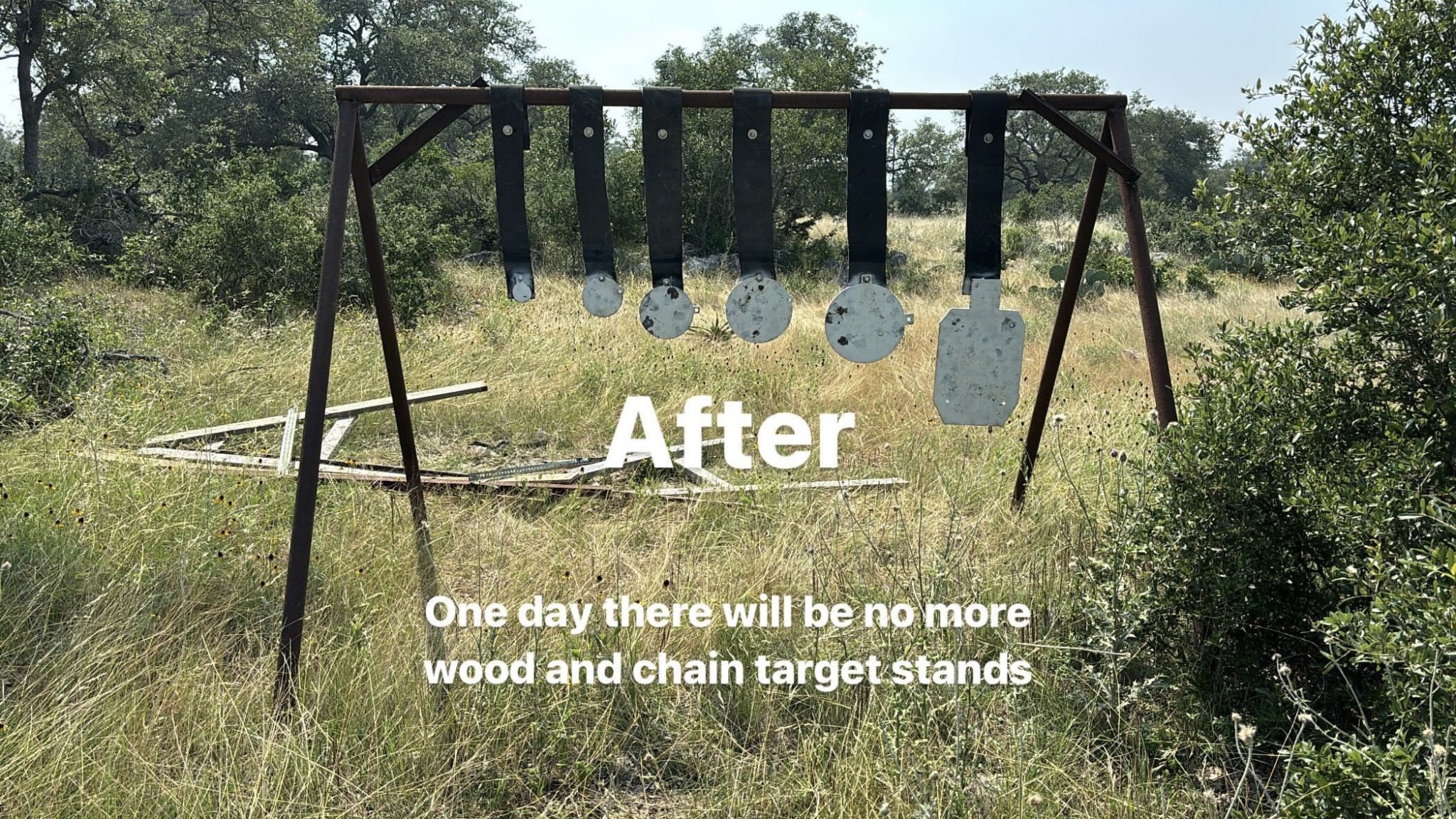

I bought this one from Highwild:
Haven't gotten to set it up yet but doesn't flat pack.

If it’s made of steel then it should last well enough and not get chewed by spall like wood does.
Being in line with the target the vertical legs will cause any paint to get chewed up and likely rust if left in the elements if that matters to you.

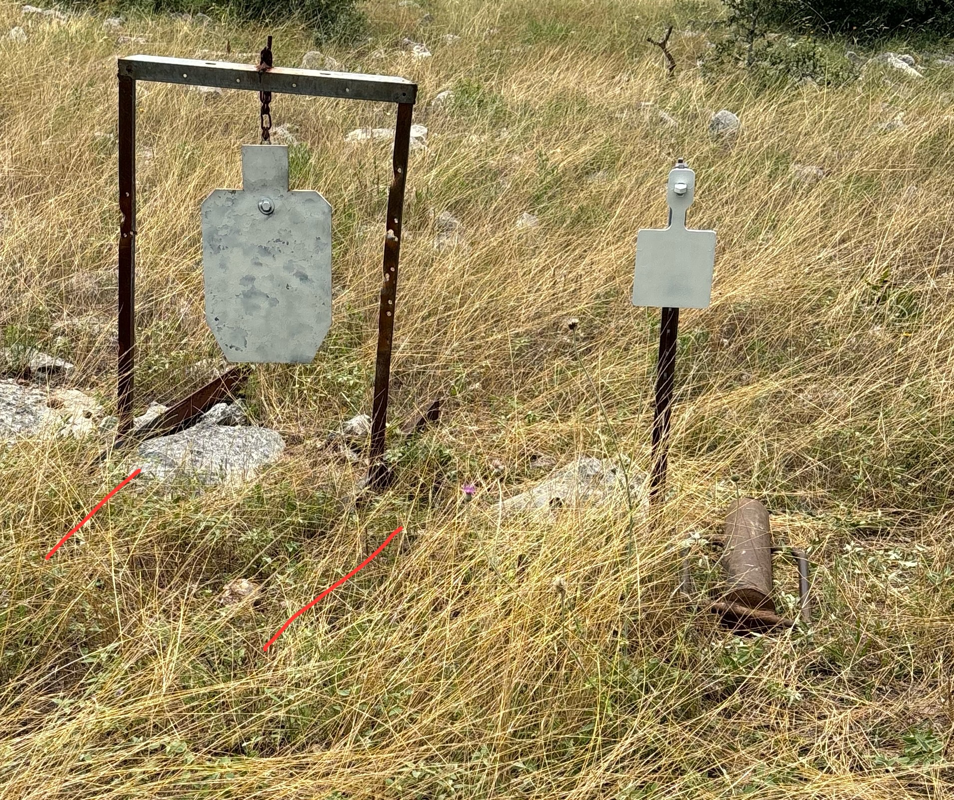

It should avoid tipping but having it tilted back a bit will help to avoid flipping forward. At least have a leg that comes out front to brace it a bit. This is my 750 yard vertical target stand but the bottom legs actually extend under the grass out front traced with the red line.
If you leave it up and they have cows, they will tip stuff over if they can.
That’s my main issue with the emt conduit brackets, cows catching a horn under the leg and toppling the whole stand over lifting their head and sliding the legs out.
I’ve gone to the sawhorse A frame style on my new stands so that the weight is hung between the two legs instead of over one. Less toppleable.
This one obviously isn’t mobile though.
Be careful about shooting angles. Ideally you want the target at a little angle to direct the spall down. Having swinging targets helps, but as they get bigger, the swinging directs less spall down.
It looks like you have a big single plate, with every target connected it may never stop swinging. If you shoot it as it swings twords you, it may be more likely to splash you with lead.
