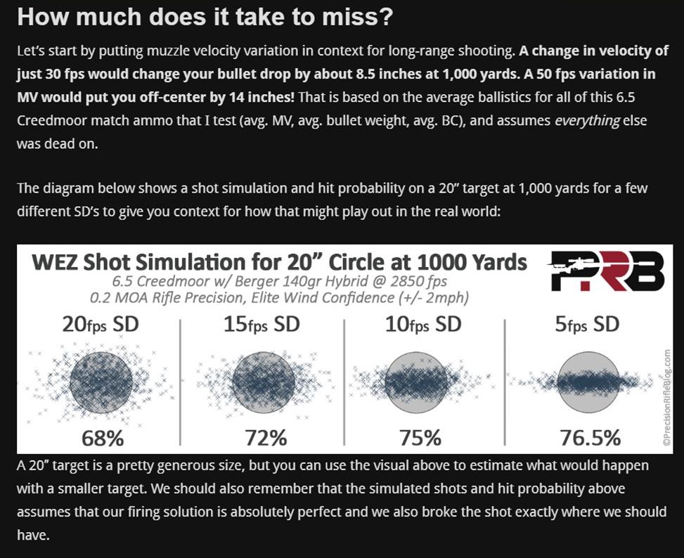

How about SD's and ES . . . which can be pretty important when shooting at distances like 1,000 yds???
Not if you ask guys who actually compete at those ranges. Many of the guys at the top will tell you that those numbers don't matter. Where bullets land matter, and you can have a load with spectacular es and SD and it prints like trash, and the inverse as well.
Hmmm??? Yes, where the bullets land matters. If you have poor consistency in velocity (which is what SD's measure) and you have poor vertical ES's, it's going to be tough to get the bullets to land where you expect them to.

I have been chronographing my factory Hornady 147 gr loads out of a 24" proof CF barrel over the last two months. 8 total strings of fire collected, averaging 20 rounds each string (some more, some less). Avg Velocity is 2,708, Avg SD is 13, Avg ES is 53. That data is statistically relevant. So anything that good or better will make me happy. What I can guarantee will make me unhappy is weighing every charge. I have weighed thousands of charges on RCBS Chargemasters and for me, in my life right now, with the time I have available, the juice is not worth the squeeze. If I can't crank out these rounds on a progressive and get decent results using Staball, I am going to bite the bullet and buy factory ammo. I do like the idea of using some different bullets and mastering the Dillon which is why I'm considering this. It's all about enjoying the process so I should have mentioned that this is one of my major goals as well. Enjoying and not loathing it lol.
Reactions: straightshooter1
Obtaining better performance than hornady match ammo is a tall order, especially in the case of the 6.5cm. What does that performance goal look like? How is it measured?
I can answer that. As noted above, I have been chronographing my factory Hornady 147 gr loads out of a 24" proof CF barrel over the last two months. 8 total strings of fire collected, averaging 20 rounds each string (some more, some less). Avg Velocity is 2,708, Avg SD is 13, Avg ES is 53. That data is statistically relevant. So anything that good or better will make me happy. As far as accuracy, I am happy as a pig in slop if I can get 20 consecutive shots inside of an inch.

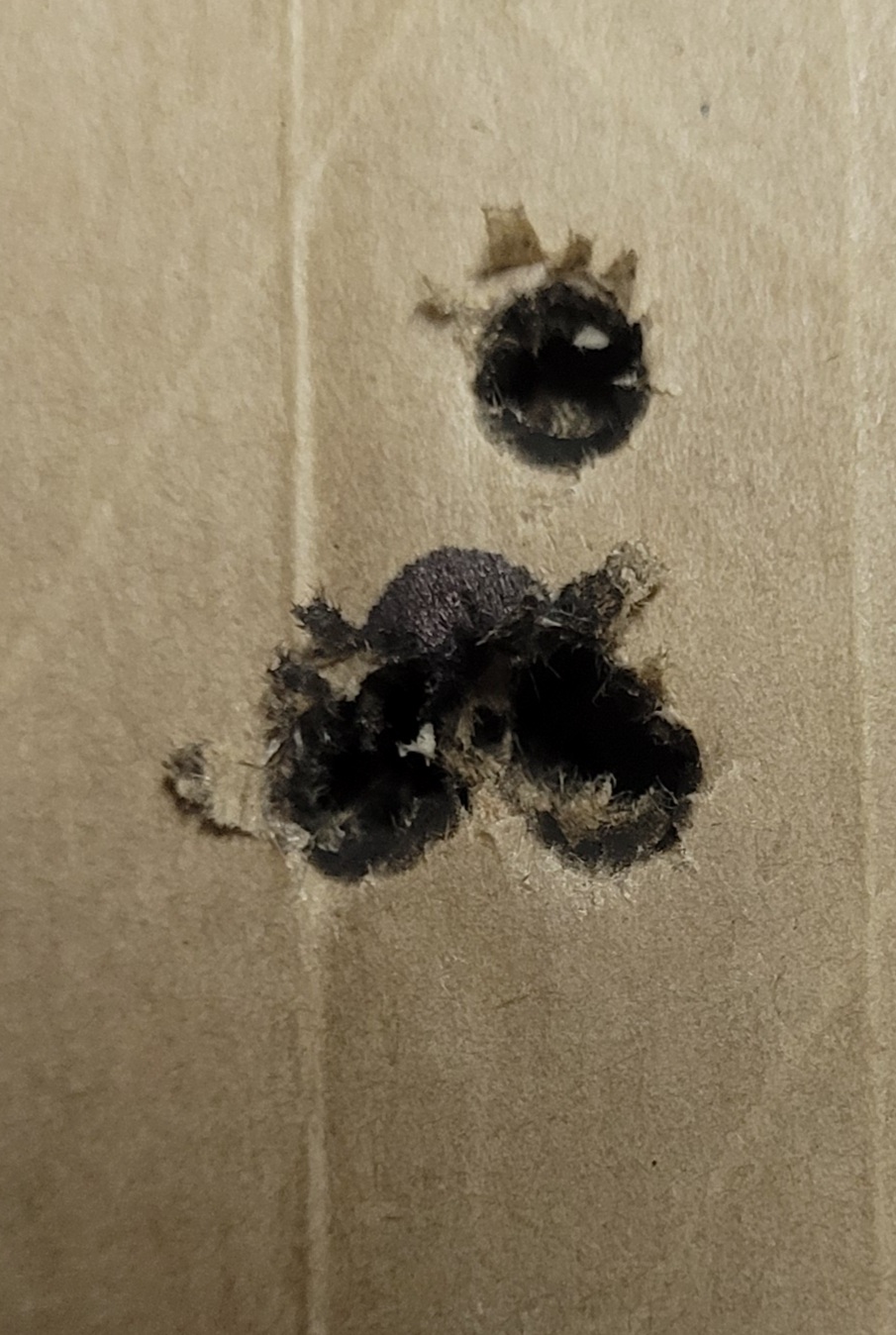

This is 5 rounds at 100m out of a Tikka 223 loaded just like described above using staball match.
The top round was the last zeroing shot for the scope, then I shot the group you see.

ES and SD make a huge difference at 600 and beyond. 1-200 not really. The last two boxes of factory Hornady 140 ELD match that I ran through my AI barrel had an ES of 70 something one box, and over 60 the other. It shot fine at 100, but that is over a MOA of just vertical dispersion past 700.

It set your primer off probably based off of residual heat, and not impact. It takes quite a bit to set a primer off. I have tumbled ammo quite a bit with no issues. Apparently some manufacturers do it. I trim all brass on the Giraud once when I get it and it is good for multiple firings.
Ok thats good to know. But i can assure you, that brass ejected out of the gun, bounced off the divider and landed square on the primer. Odds are it was the impact IMO, but a freak occurrence nonetheless. I am strongly considering your approach, it would be very fast indeed. Will virgin Lapua brass feed into the Giraud or does it have to be FL sized first?

Yes, the best SD/ES's are not the deciding factor for determining the best group(s) on target. But this thread is about get better results than factory ammo with minimum reloading effort. Factory ammo all tends to be, at best, around 13 to 14 SD. If one can get their SD's into the single digits, like a 9 SD, they're gong to see smaller dispersion on their targets. . . especially at distance. "Bad" SD's will not produce good results over a statistically valid number of samples.
Edit with additional info:
Taken from this website: https://precisionrifleblog.com/2021...ive-fire-muzzle-velocity-consistency-summary/
