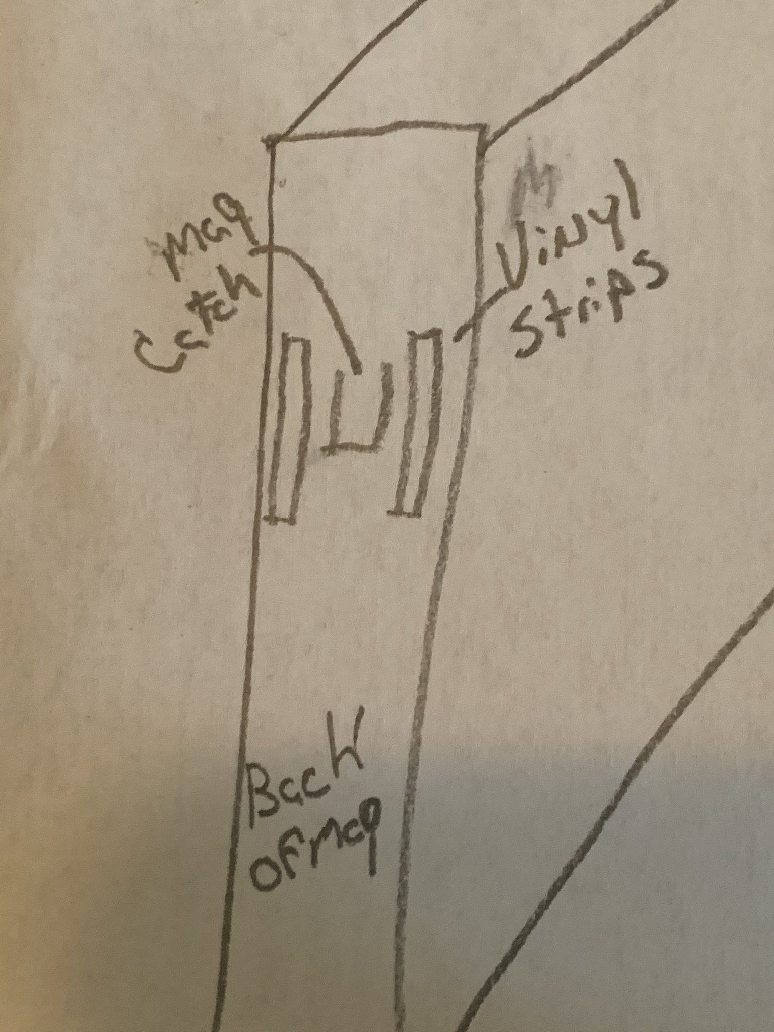

    chances are your going to have to shim the mags in the MPA....when you push into a prop the front tips down and the bullets jam into the back of the barrel
    Reactions: jdne5b
    I’m no artist lol

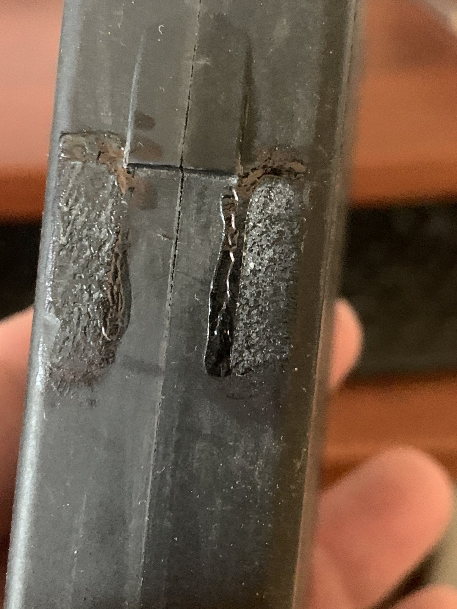

    Check out the thread I did on mag seating depth for 700 footprint 22lrs. Is there room for you to raise the mag depth closer to the action? Are you malfunctions worse when pushing into a barricade?
    I used the soft side of adhesive velcro just to test the idea. It worked, but I wasn't comfortable running it in matches.
    Unfortunately, this seems to be the best fix. Myself and a few other competitors are using this method. Others are lining the back side of the mag with tape. It’s disappointing to spend that type of money on a rifle to have these problems. But it is what it is.

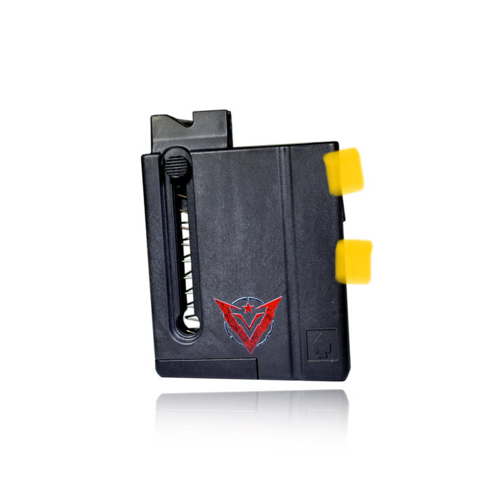

    FWIW I have 3 mags. One has a red follower, it does not require Velcro or tape but have have to be careful on a barricade as enough pressure will force the front of the mag down and cause feeding issues. A second mag has a black follower and has zero feeding issues, however the fit in the mag well is extremely tight to the point where I have to force it in there and it was like hell to get out. I got rid of it. The third mag also has a black follower but is the exact opposite, it’s extremely loose in the mag well and will cause failure to feed 1-2 times per 10 rounds without any pressure; it’s that loose.

    its not ammo causing the feed issues its the mag wells to big when you push on the mag it noses down at the front and the rounds nose dive with no pressure on the mag most feed just fine.
    Mag position is for sure key BUT-
    It CAN be ammo also. Doesn't matter what I do with the mag position the Eley Standard I got bulk packed from the CMP, my rifle will not feed it reliably. Also doesn't like to feed Aguila. Can run a mag of anything SK/Lapua through it no issues, load up a mag of Aguila or Eley Standard and it hiccups and chokes on em all day.

    All my 7 mags are early gen1 with black followers, and they indeed have a wide front shoulder, wide enough to bind in a lot of different mag wells.
    But in my older MPA castle cut chassis, they work amazing, but I run the plastic block insert and an adjustable mag release to remove all play. I have not tried a newer chassis yet, but a manners mini chassis I have worked great too.
