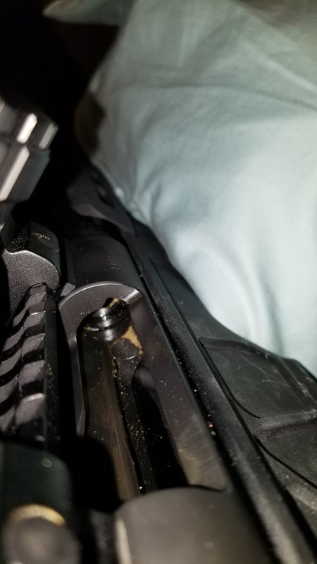

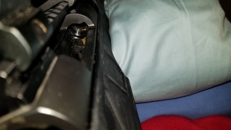

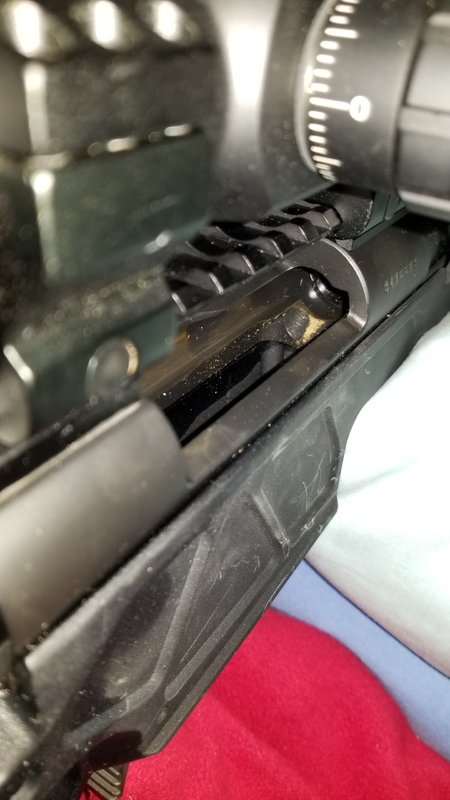

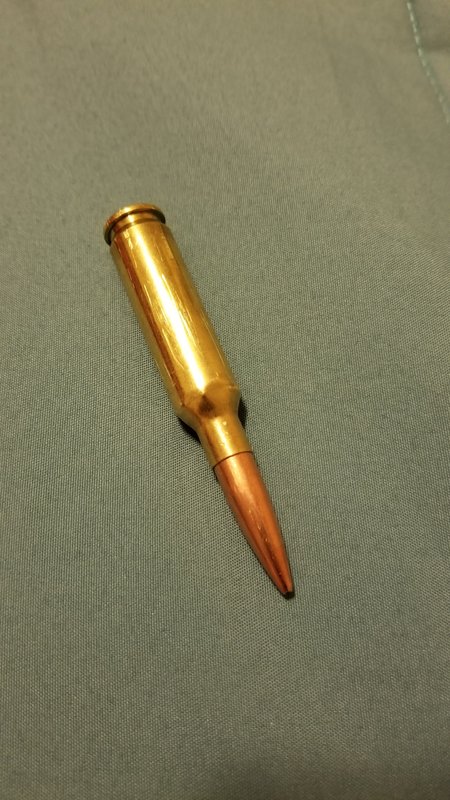

    I've recently purchased a Howa HCR and have noticed that feeding is very rough. I need to attempt really fast and really forceful for the round to go into the chamber. If I try to be gentle with it, the round will stop the bolt from pushing it into the chamber. I feel like it gets stuck right at the ramp. I've been playing with it a bit by loading the mag and just feeding rounds into it to see if I can notice anything that might help me identify the issue. While doing that, I noticed one round, it happened to be the last in the mag, got stuck halfway up the ramp. I pulled the bolt back and had to manually get it out from it being halfway in and out of the mag. As a result, the shoulder of the brass has become real dented. Aside from that, all the brass has become really scratched up and i can see so much debris in the action and chamber of the rifle. I will post pics and a vid to show this. I have contacted legacy sports and they said I could return it if I want to for them to investigate it but that I could also look around and find some simple fixes for getting it to feed better. Does anyone know if there is a simple fix to this? I would hate to have to send it back and wait or be without the rifle for some time. If there is something you guys know of that might be a solution, please let me know. By the way, I have never owned a chassis style rifle before this one and idk if this is how they all are. But I have had 300 dlr rifles that are simply just for hunting and they feed way way smoother than this does. If it matters, it is a factory hornady black round.

    **edit**
    In the pics, it is very difficult to see all the brass debris in comparison to having the rifle in person. However, we can see how the ramp has taken some abuse.
    Pics below
