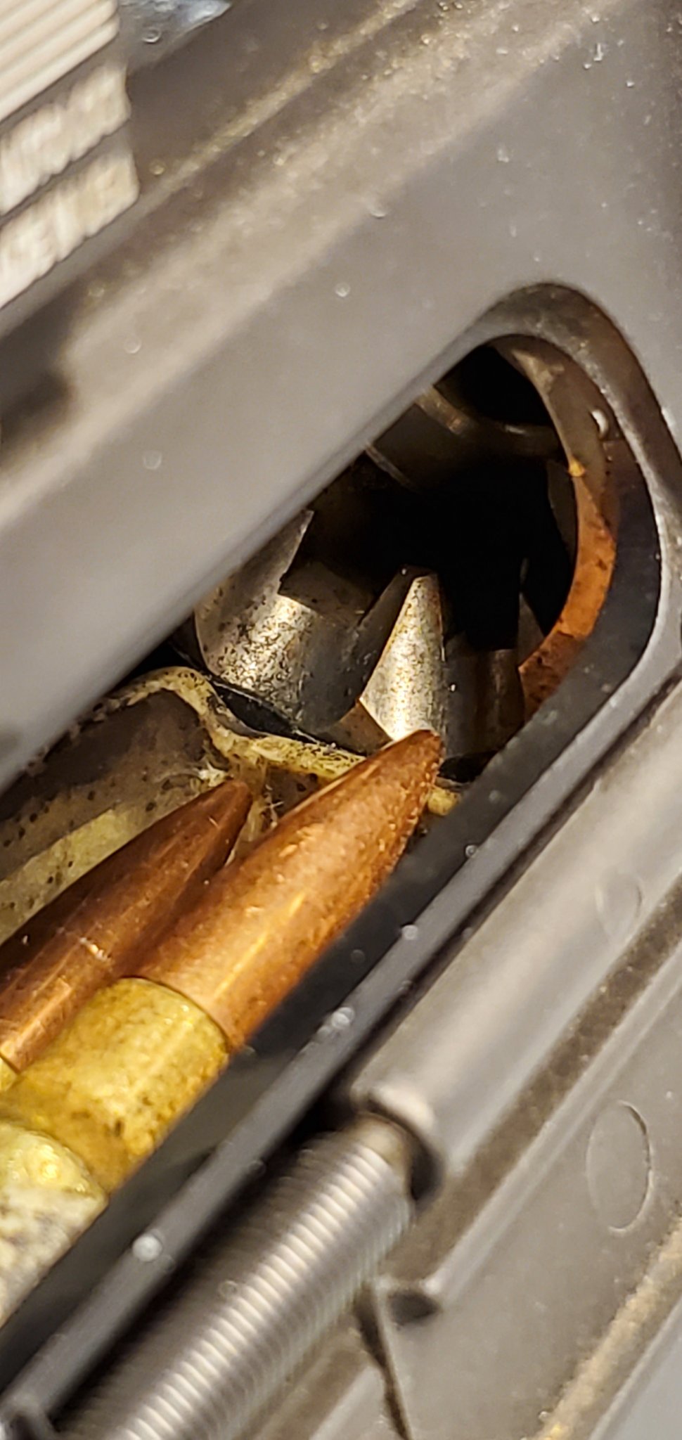

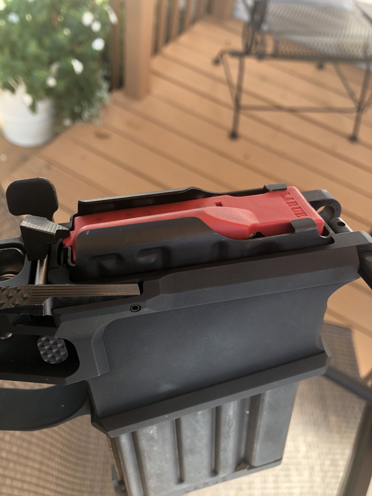

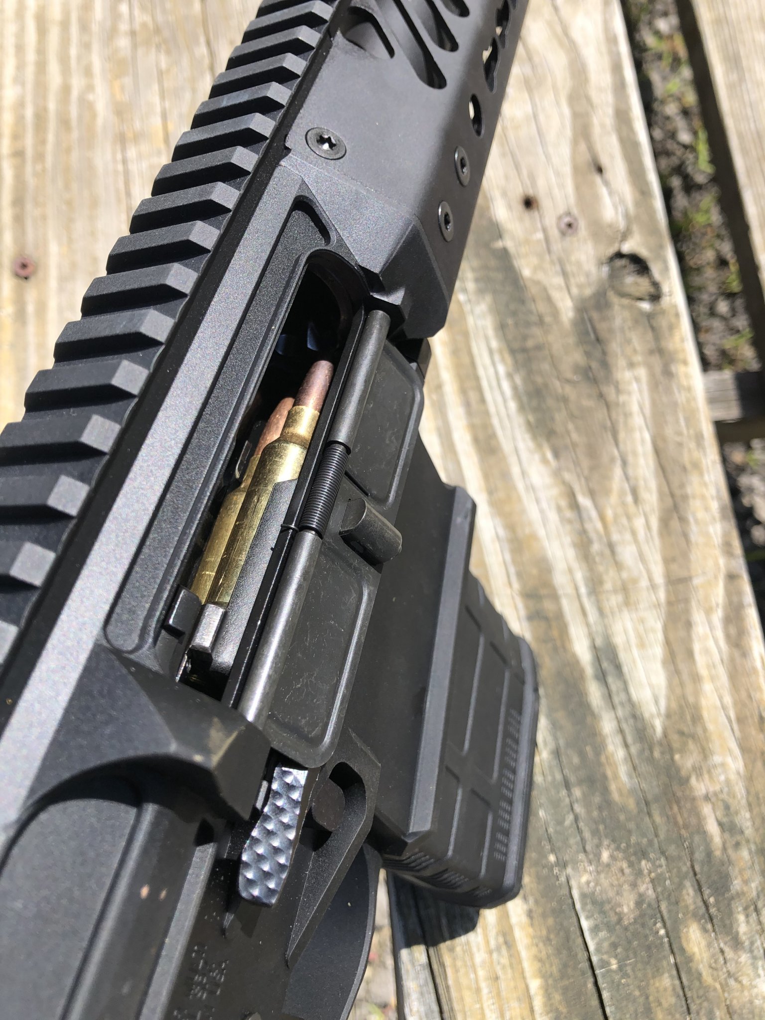

I am seeing the jam on the right side with all my open tip

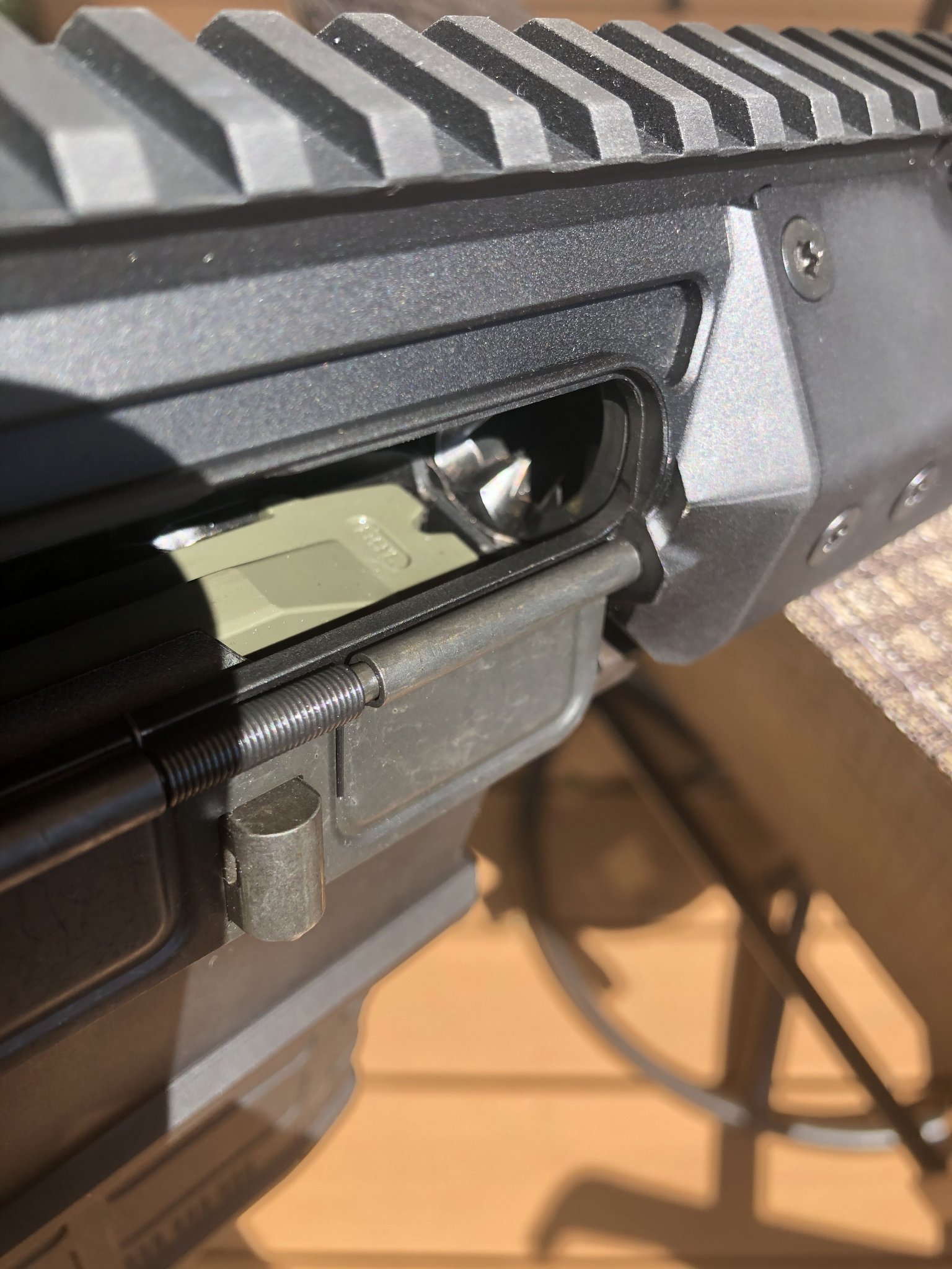

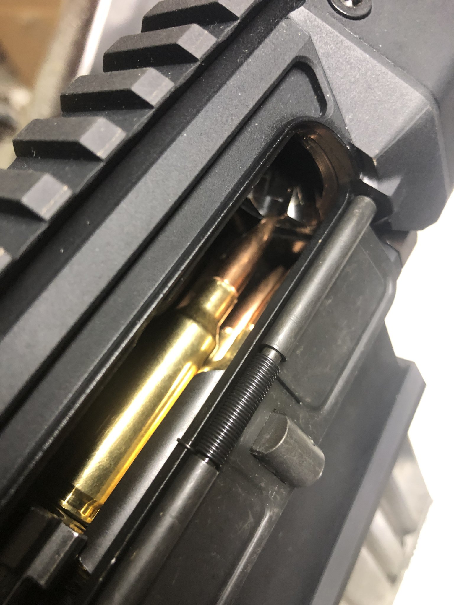

Photos left side and r before is before it was sent to seekins. still doing the same thing

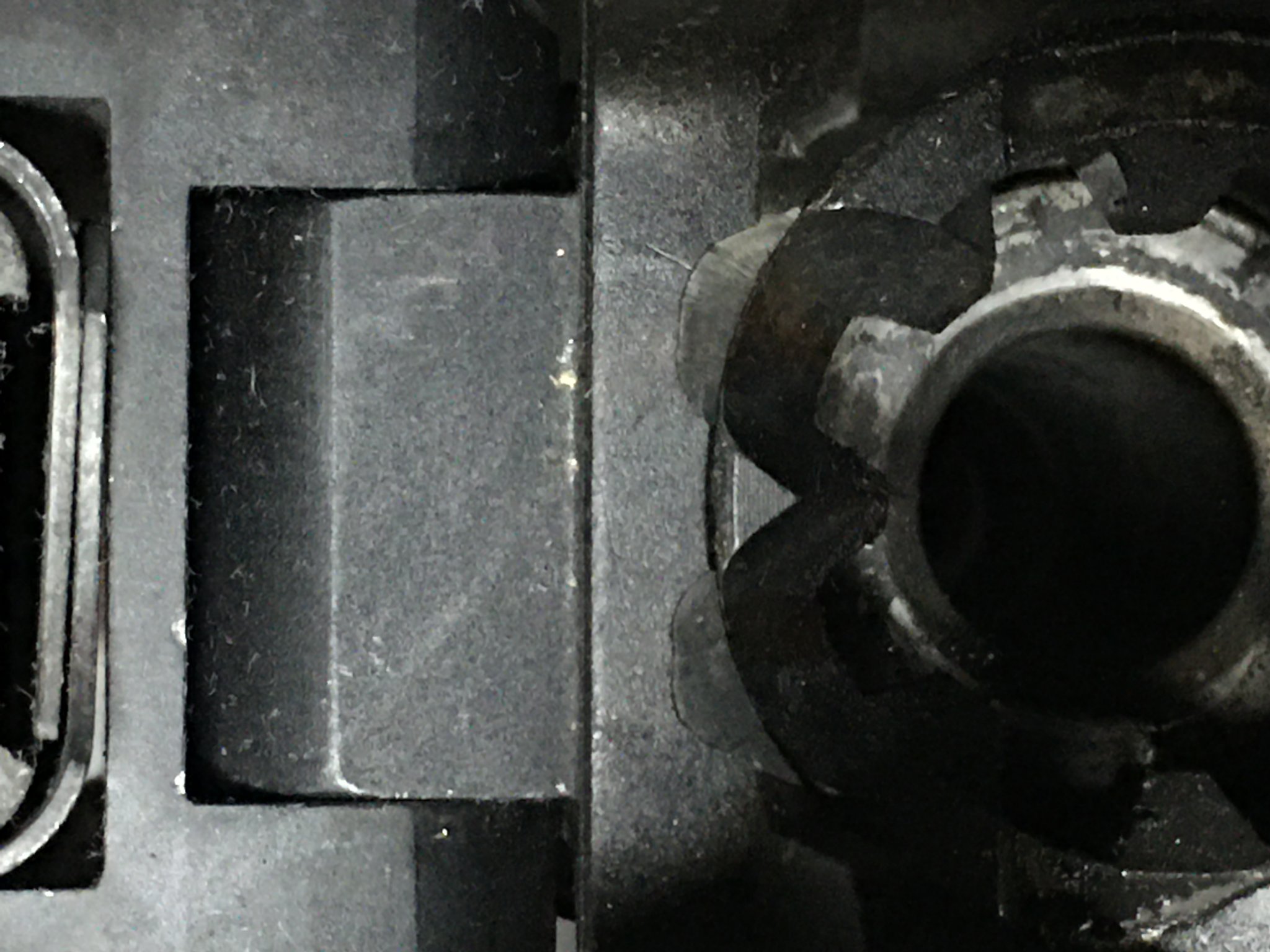

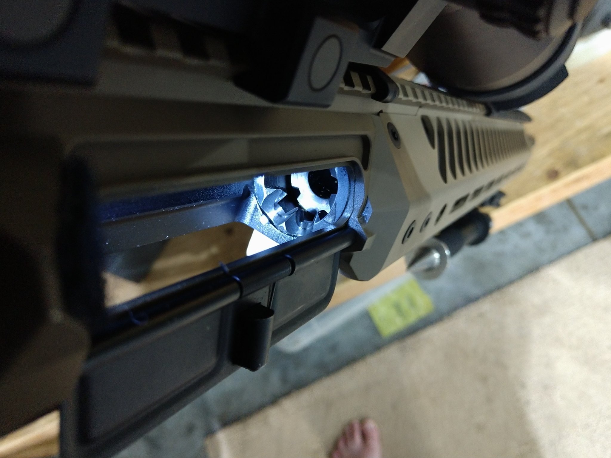

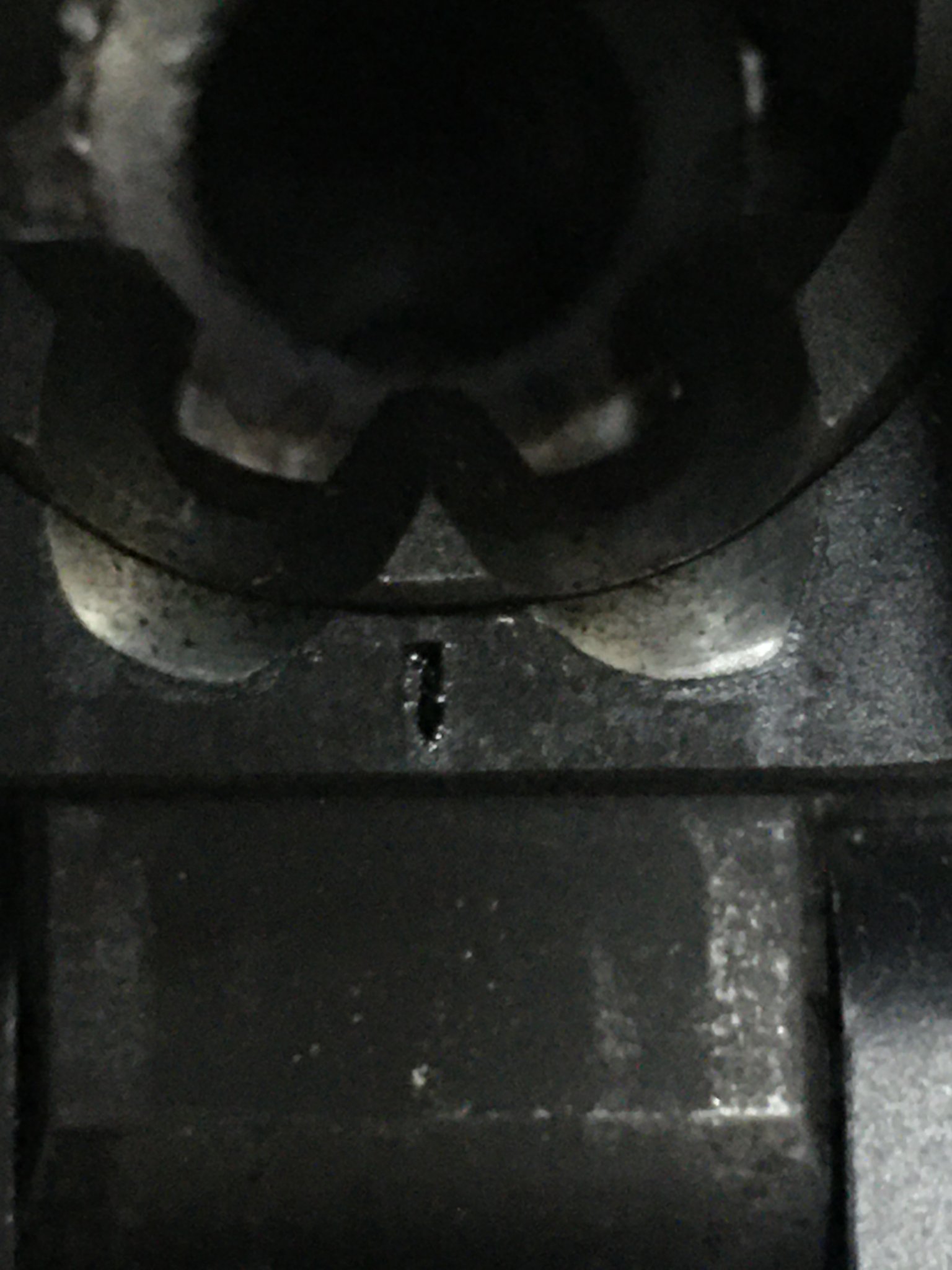

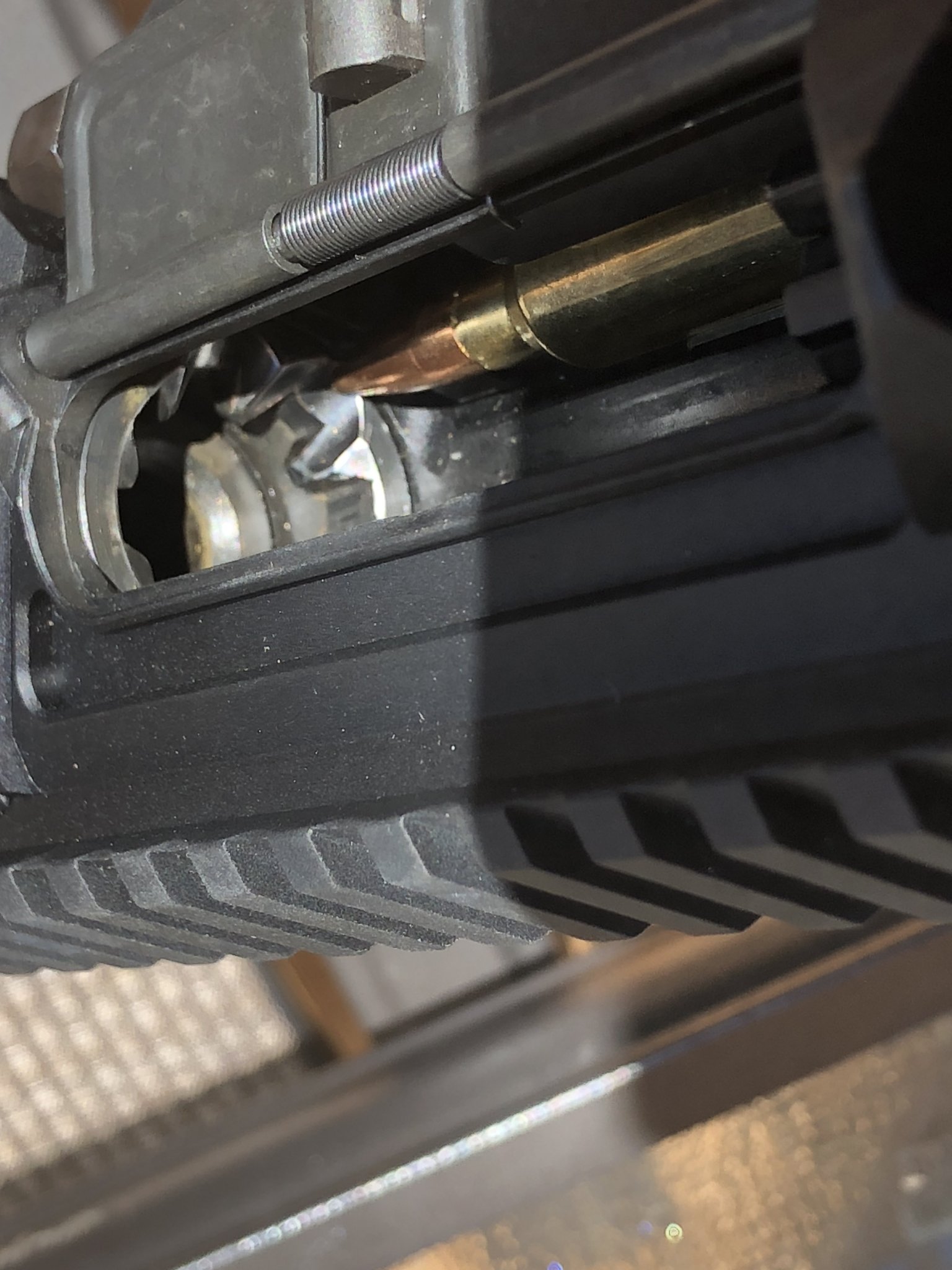

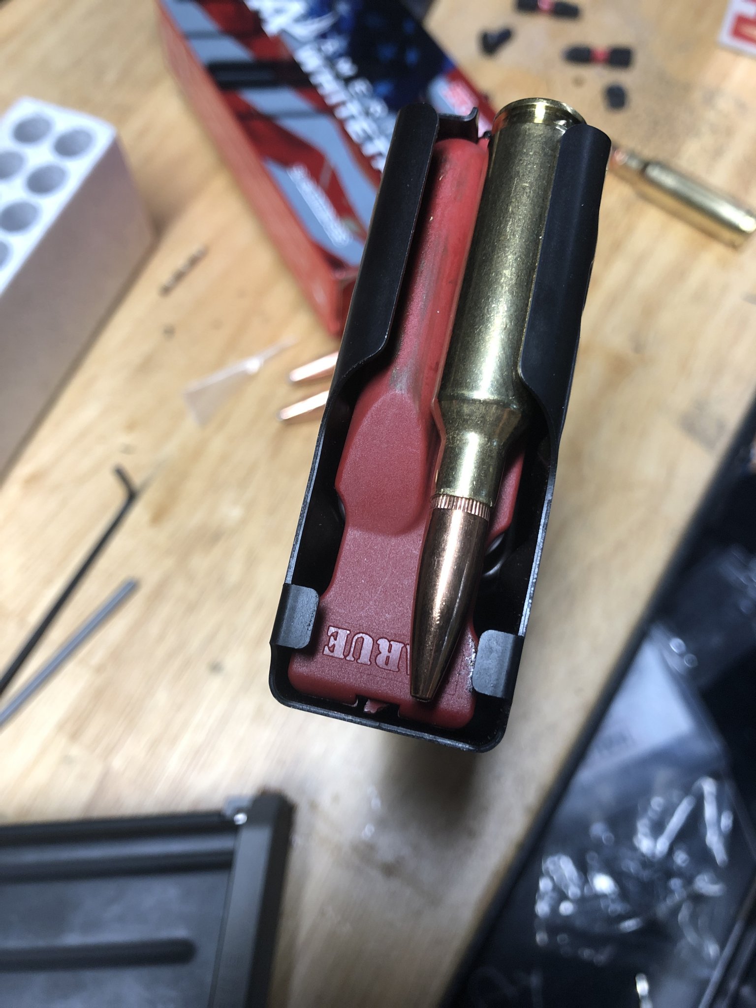

Mind taking a close up pick of mag lip to feed ramp area with and without a round jammed?
In an effort to eliminate factors, do you have another brand of magazine to try?
Is it every round in the mag or just the first ones or last ones?
- I have 2 Larua's
Is it every round in the mag or just the first ones or last ones? - some work and some don't. no particular order to when they will jam

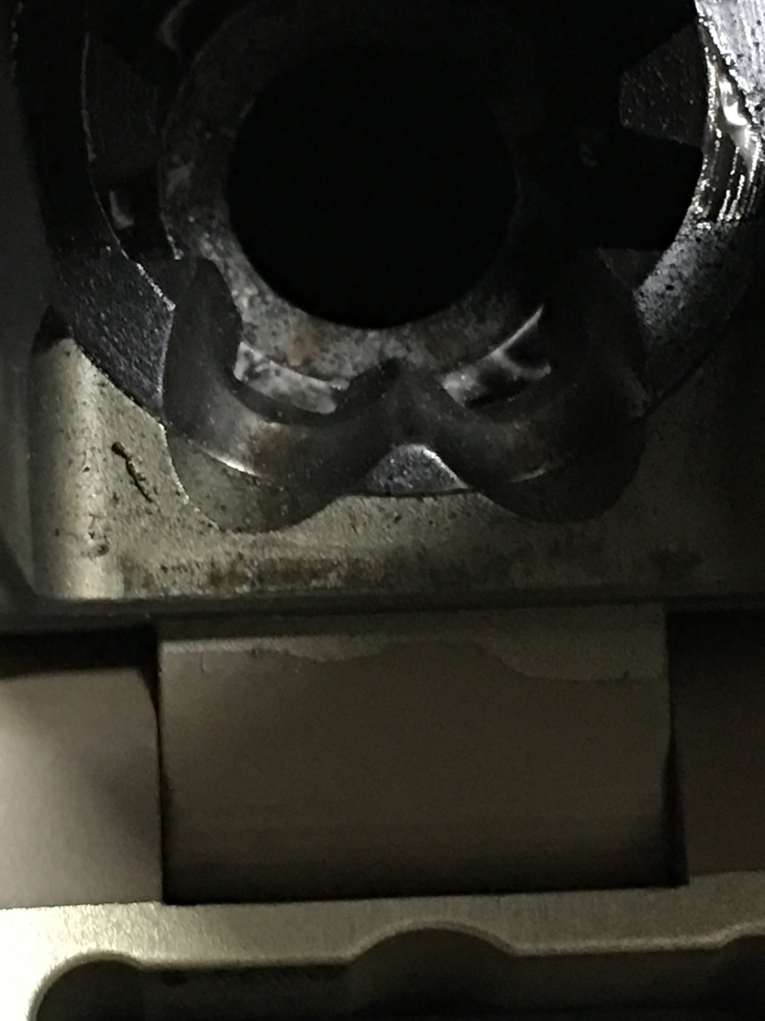

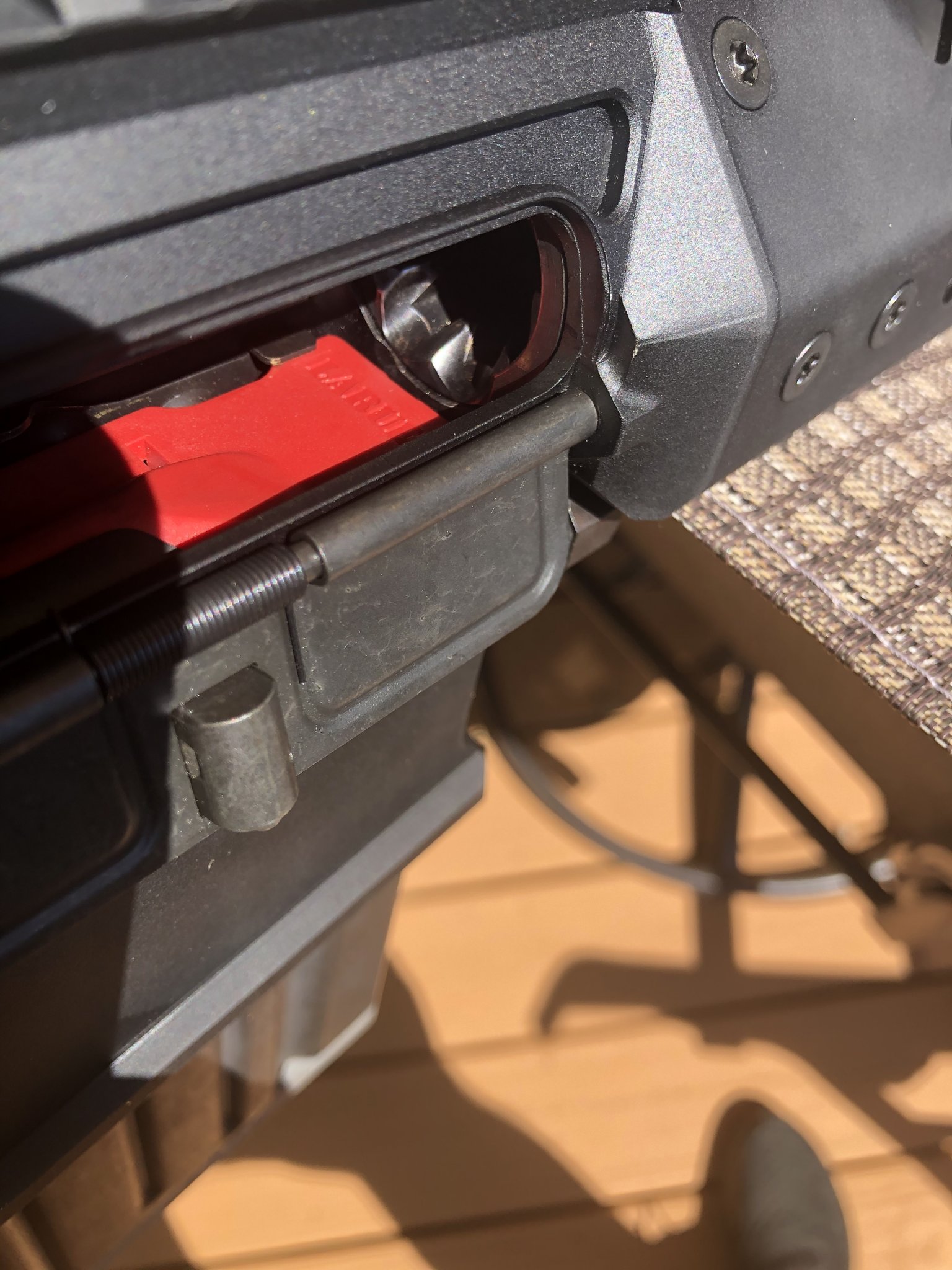

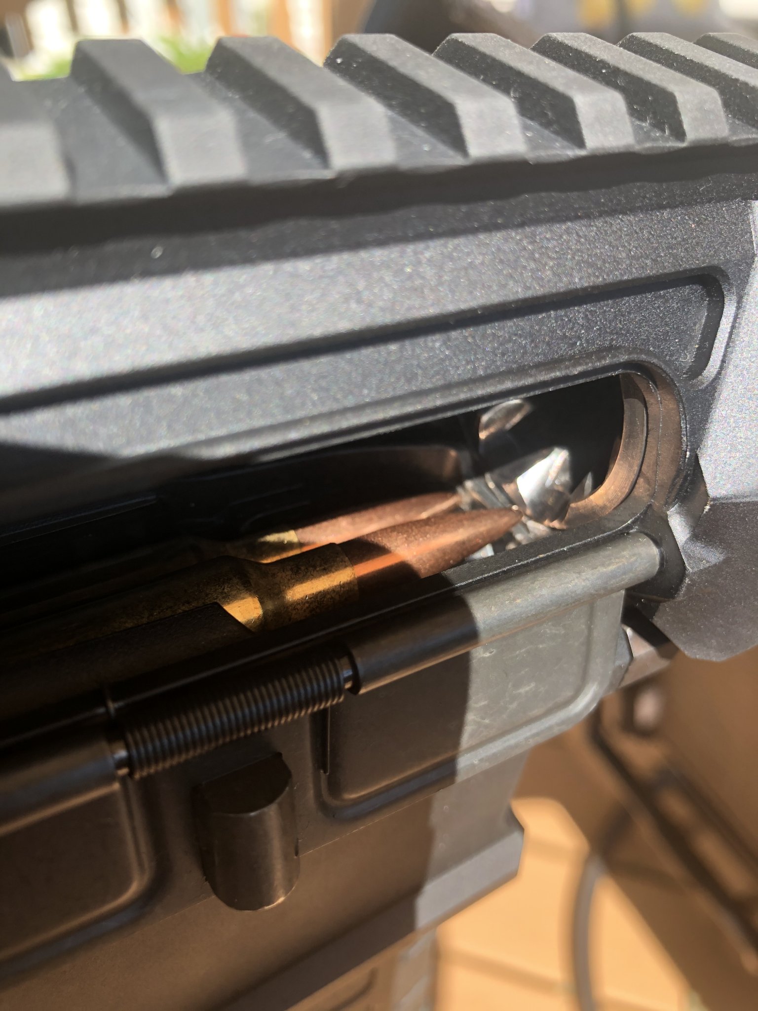

Reactions: 2aBaC̶a̶
I would request they try more than one kind of ammo. Specifically the ones that are hangingup.ir CS is very good and usually thorough but seems if they're only trying ELDM then not thorough enough apparently.
Reactions: mkris101
I sent them an email yesterday to report the continued problem. I plan on requesting that they try other ammo. In my opinion, the only thing that is let to replace is the upper. might be slightly out of spec

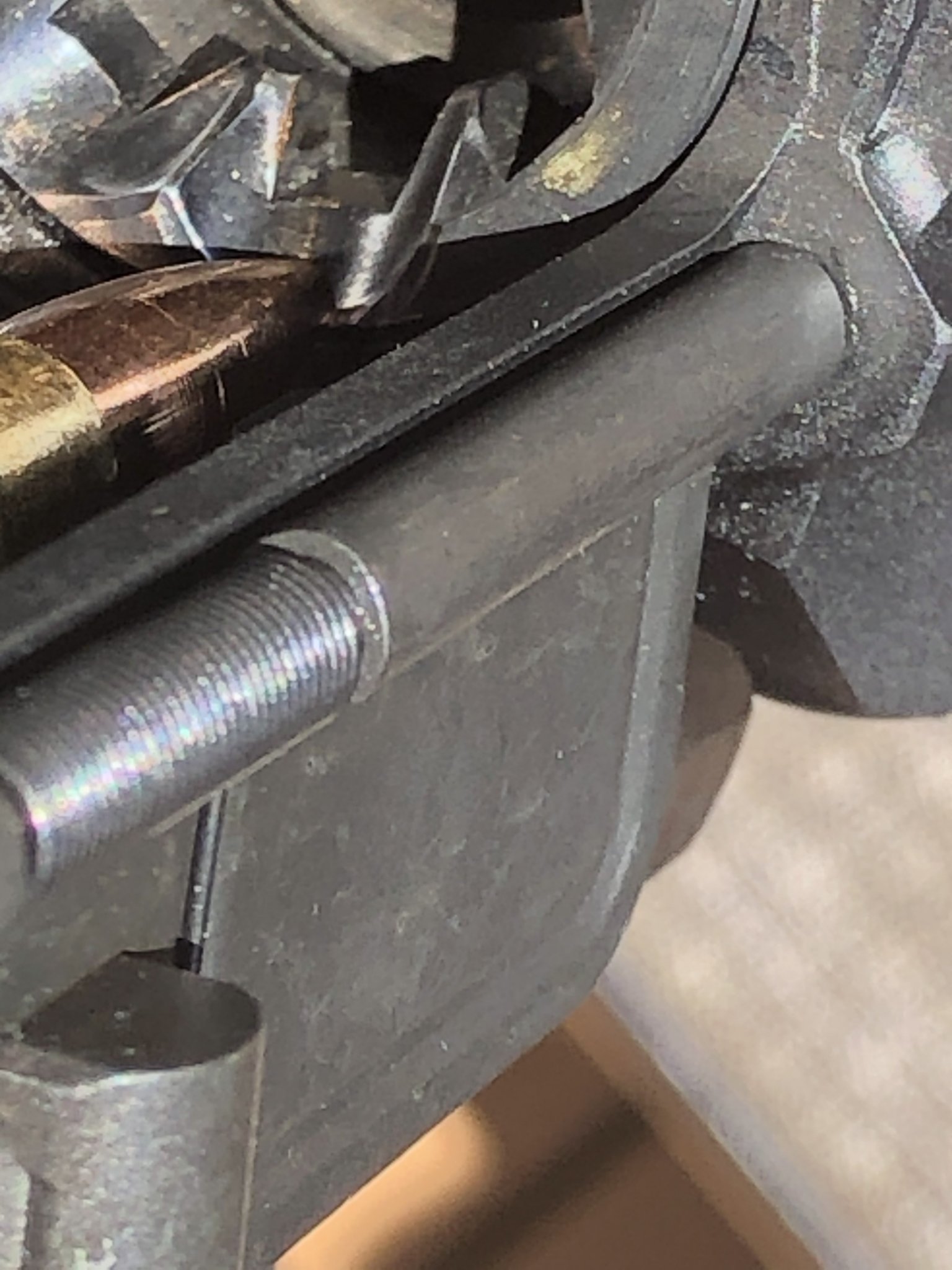

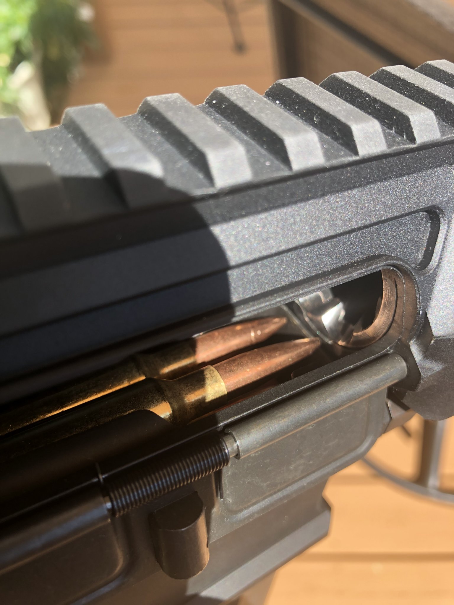

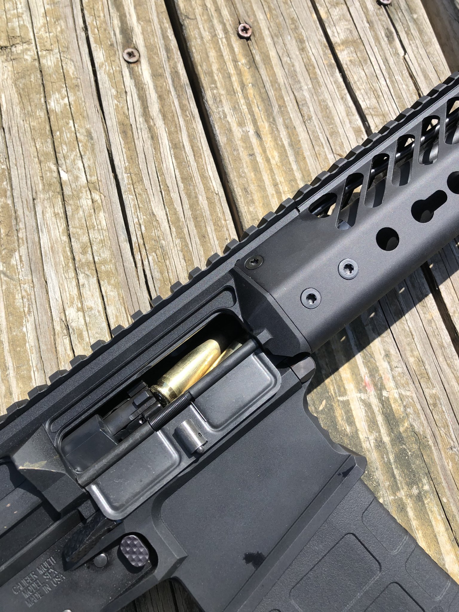

Just manually ran 5 rounds through. all were fine.. Ran the same 5 rounds and all jammed. Used the Pmag. The larue's just jammed on all
It seems to be.. Seekins said that they polished the 7777777775feed ramps

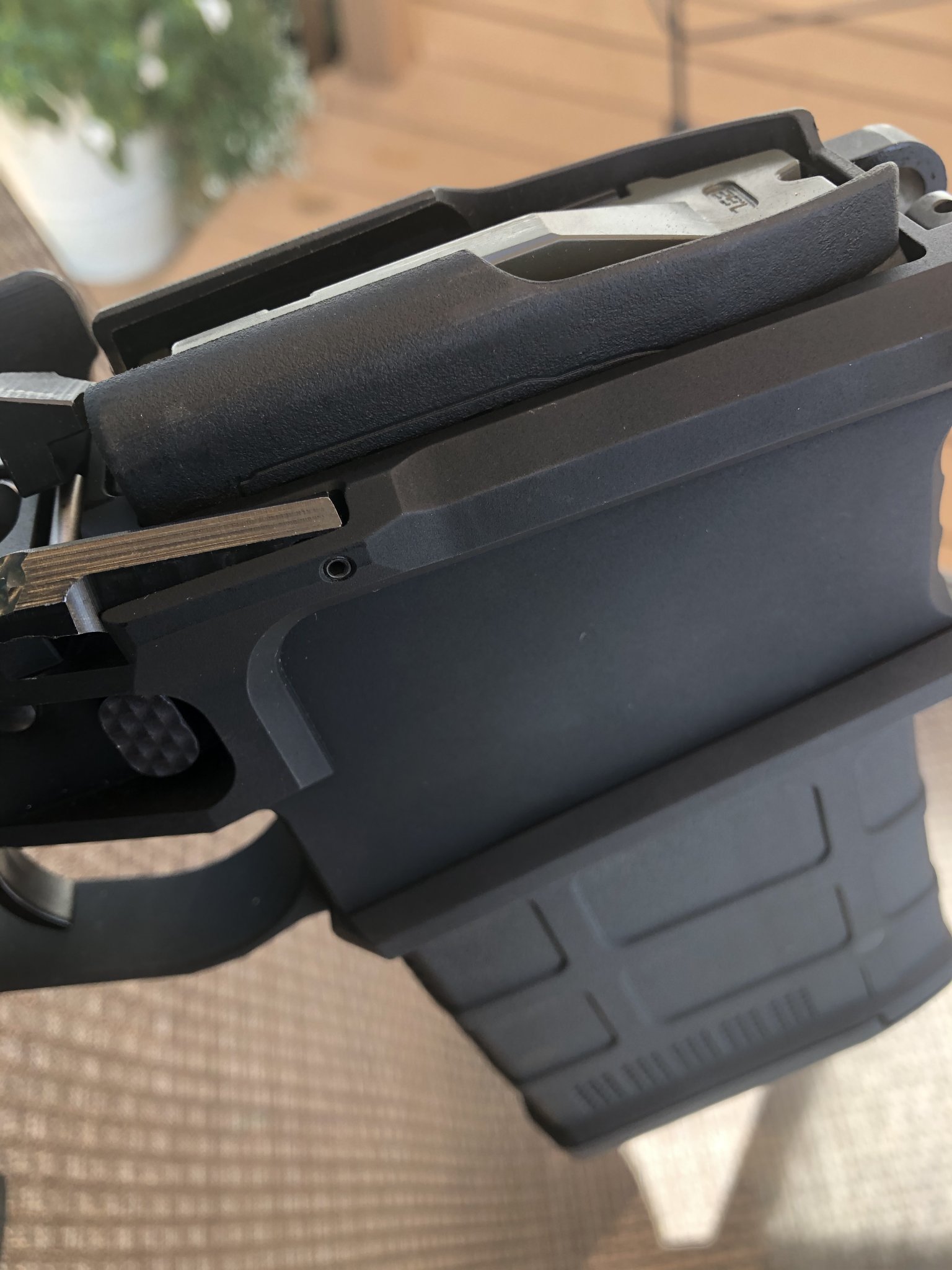

Is there any wiggle in the mags or can you push them up at all? Sort of looks like the Mags aren't seating fully and leads to a low entry point of the tips of the bullet. Coupled with a slight lip on the feed ramp to reciever.
Funny that you asked that. I was just putting pressure forward and back my pmag. no effect, but I was able to manually cycle some and jam on others, I am actually running up to buy another Pmag rule it out all together
I haven’t had that happen to me before. I use Pmags. I shoot American gunner too. My problem has been over gassing because the gas set screw came lose. I know you are talking feeding issues but check that too. It can mess up the timing and throw off the feeding.

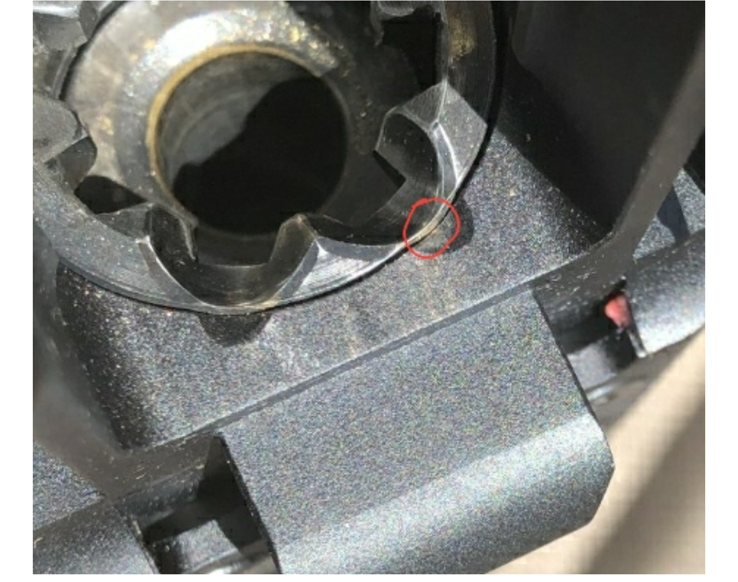

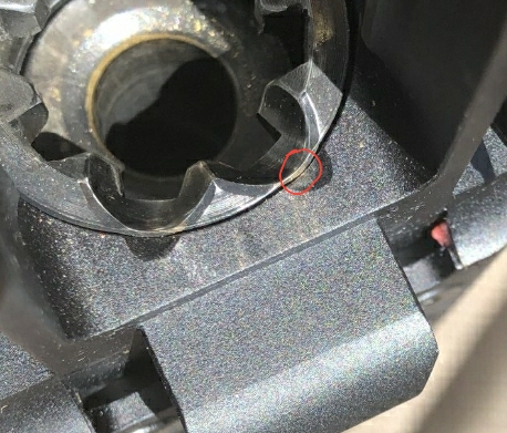

Is it catching on the lip of the barrel extension?
Sure looks to me like that is a catch point. Ideally that would be blended a little better between barrel extension and upper receiver.
2aBaCa asking a great question.
OP, might want to show that to SP, see if they would address that question specifically for you.
I don't see how blending that in yourself would bother SP but they may well take care of it for you.
Yeah, If it were me, as painful as it might be being a fairly expensive production rife I would take a small round file to it and make it a seamless transition.

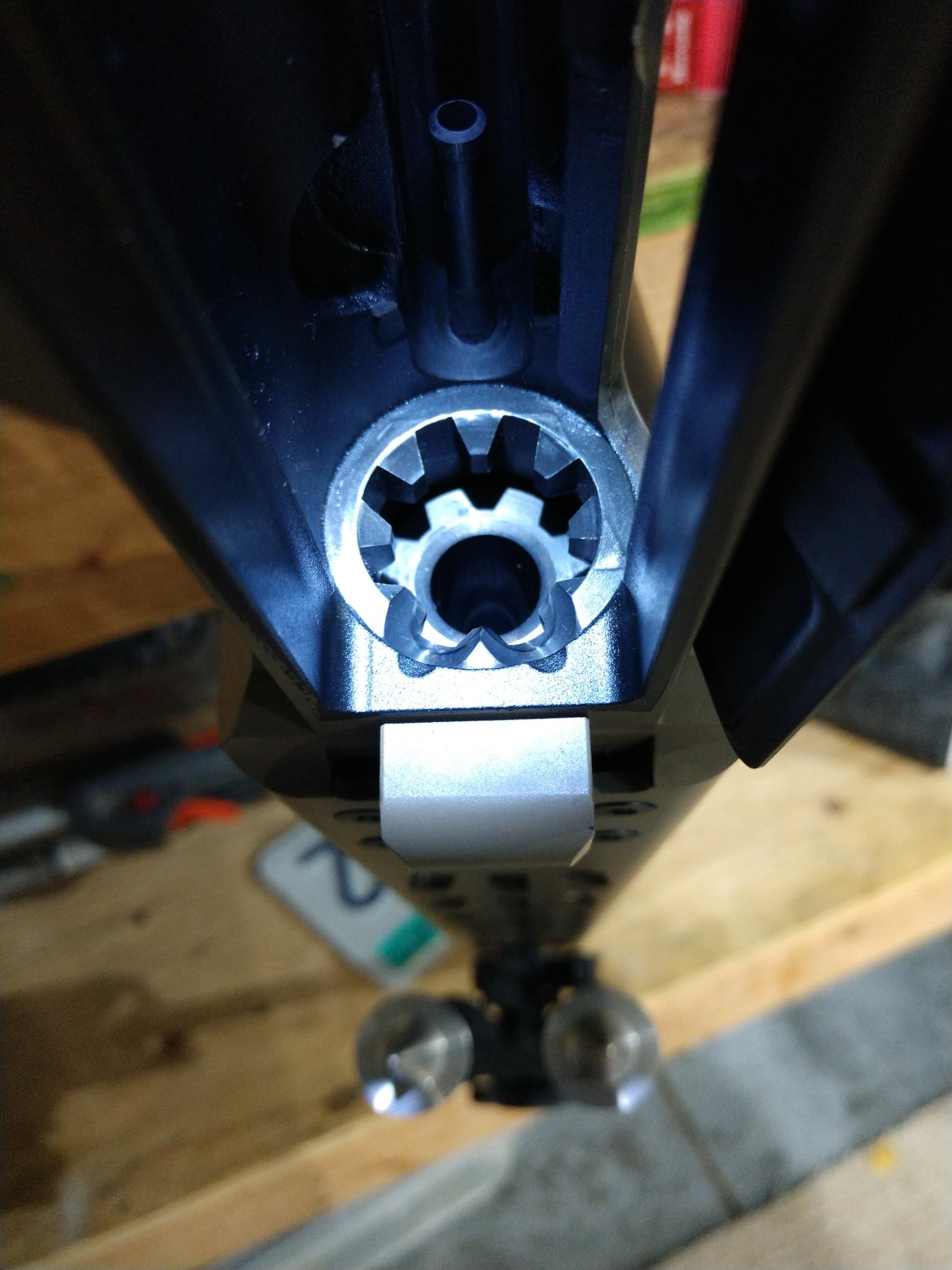

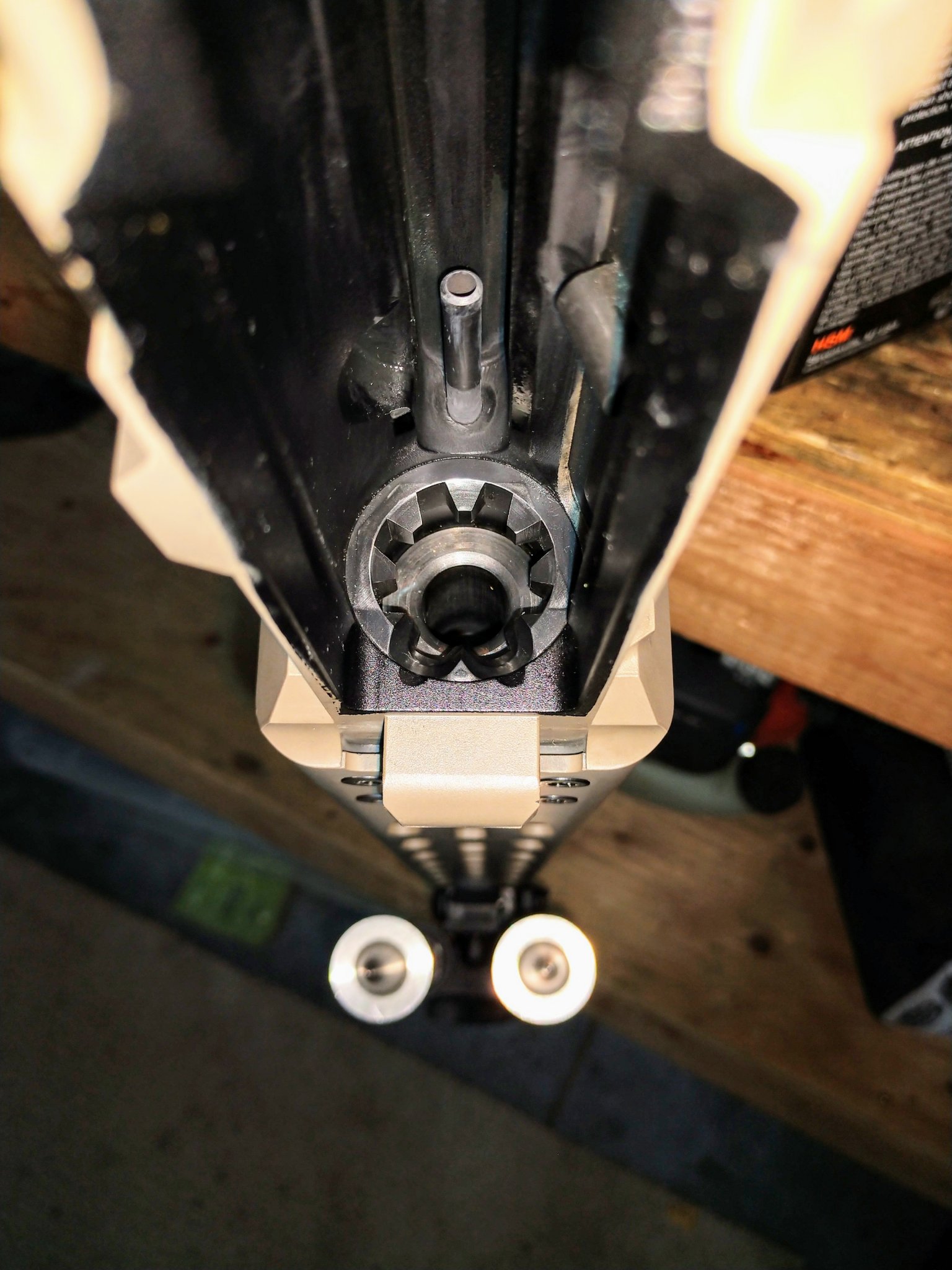

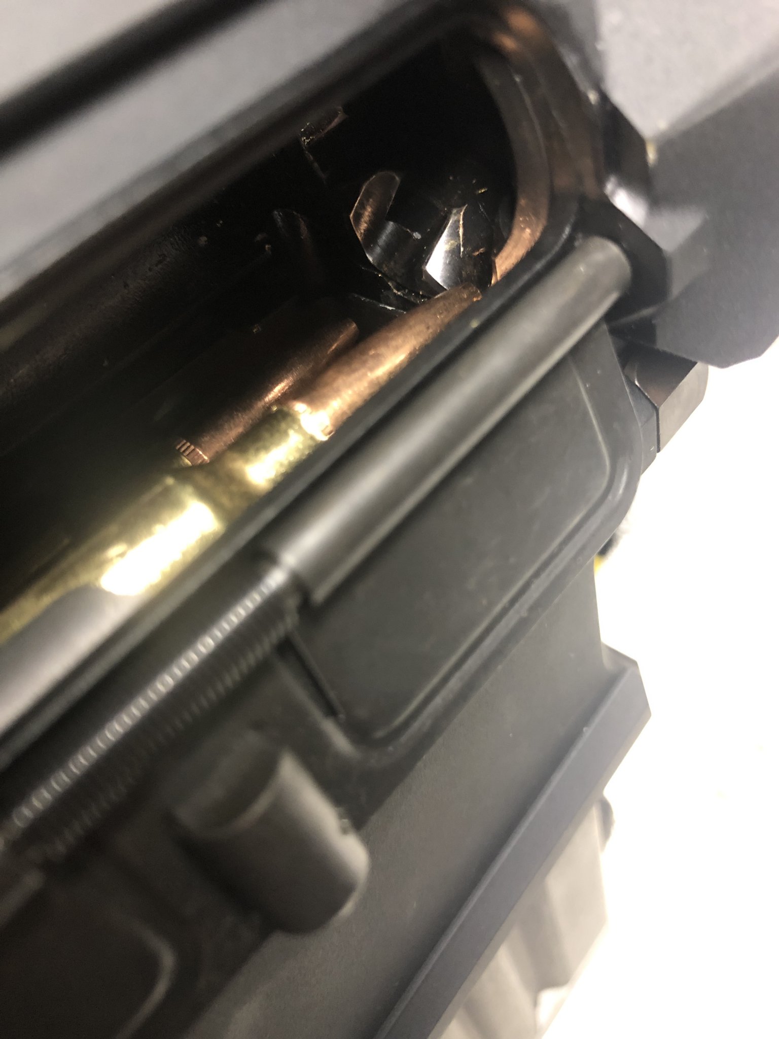

Just got a brand new Pmag and same issue. It manually cycled 4 rounds then jammed on the 5th on the right side
I well send it back to seekins for them to fix it.
Definitely an issue of blending between the barrel extension and upper receiver.
I'd send picture (New Pmag.jpg) to Seekins so they can see the exact issue.
I'm confident that Seekins will get that taken care of for you post hast once they see the root cause.
Reactions: mkris101
They'll make it right. Just sucks they dropped the ball not testing various ammo the first time. They cover shipping so that's good but wastes time unfortunately.

Not sure from the images you posted but It looks like the AG ammo tip would make contact with the feed ramp just fine.
If the round is pushed forward from the mag where is the tip when it makes contact with the feed ramp?
Now just to be clear you are getting a jam when MANUALLY CYCLING the rifle correct?
If you just drop the bolt carrier using the release will it strip and chamber a round?
Do they jam when you actually fire the rifle?
The Image you posted Cycle jam.jpg looks like a double feed, that is not a missfeed stopped by bullet failing to properly navigate the feed ramp, did that happen from manually cycling with the charging handle.
The Image you posted Cycle jam.jpg looks like a double feed, that is not a miss-feed stopped by bullet failing to properly navigate the feed ramp, did that happen from manually cycling with the charging handle.- That was a fired round. those rounds were AG 140gr BTHP
Now just to be clear you are getting a jam when MANUALLY CYCLING the rifle correct?- Correct
Do they jam when you actually fire the rifle?- Yes. It is better since I got it back, but it does still jam. Cycle.jpg is from firing. Seekins said they adjusted the gas block
If you just drop the bolt carrier using the release will it strip and chamber a round?- its 50/50 if it will feed or not
Looking at “New Pmag” picture, “Feedramp” picture, you still think an OTM or exposed lead bullet is going to feed properly?
I've shot in my Seekins SP10 6.5CM 123 ELDs, 129 interlock, 130 SMK, 140 ELD, 140 SMK, 147 ELD and 140 Berger Hunting LVD's
Absolutely ZERO! malfunctions, You need to send that rifle into Seekins and tell them to fix it, It shouldn't matter what size projectile you're shooting, If that was the case they should put a disclaimer on their website that their rifles will not operate with various ammo. Call and talk to Matty or Luke and only those two people and I guarantee you your rifle will get fixed.
Find the mag and ammo that is giving you issues and send it in with the rifle.
I was looking at the Jam1.jpg, looks like it should ride right up the ramp.
Pretty sure if you look at other pictures, you'll see why there is an issue.
Clearly the feed ramp on barrel extension is not blended into the upper receiver and is definitely part of, if not all of, the reason for feeding issues.
I agree with bigjake83, the SP-10 should be feeding any / all 6.5 Creed factory ammo w/o issue.
I reiterate, I'm confident that Seekins will remedy the issue. I'd send a copy of the pictures showing feed ramp/barrel extension not being blended in and the 140 OTM ammo jammed into the barrel extension.
Reactions: mkris101
I was just trying to get to that point with the OP... His Barrel extension is fucked up, that is not the correct Barrel Extension!!
Here is mine...
@mkris101 you need to send that shit back to Seekins and have them give you a new barrel.

Again, I agree with bigjake83 in that the feed ramp / barrel extension is not right in how blended to upper receiver.
Something tells me this is a older SP10, they went through some growing pains when they first released the SP10 in 6.5CM. This is honestly very unfortunate because it makes Seekins look bad and they are Tier 1 Company and the SP10 is a exceptional rifle in the sub 3K range.
Here is mine...
View attachment 7405638View attachment 7405639View attachment 7405640
It is going back! based on your photos, it looks smooth. Mine does seem to have a "ledge" at the transition point.. It sucks because it has to go back to seekins again!

Those above pics aren't of a clean chamber I just wiped it out with a rag before I took those photos but these are the tools I use.
(1) Spray chamber with Hoppes carbon cleaner.
(2) Insert Nylon Brunch and carefully use drill to scrub chamber.
(3) rinse with Carb Cleaner, inspect chamber and barrel extension. I use for flashlight and dental mirror. If you still have carbon and gunk in your chamber or behind barrel extension lugs repeat steps 1 & 2. Takes all of 5 mins. Once my chamber is clean and flushed I insert AR Bore guild and start on bore..... NEVER USE DRILL IN BORE OR THROAT OF CHAMBER.
I believe that you are absolutely correct. I bought it used. Original owner said he only had 40 rounds on it and it went to the safe. The BCG it came with had only a single ejector. Skeekins did replaced it to the updated BCG with the double ejector
