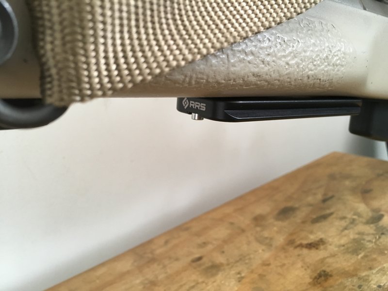

    To do this I used a 1/4-20 insert (amazon.com/gp/product/B002QUZNV8/ref=oh_aui_detailpage_o06_s00?ie=UTF8&psc=1) and drilled my stock (Manners). I epoxied the insert into my stock and simply use a D ring type screw with a 70 mm acra swiss style plate and attach it to my rifle. It takes all of about 2 seconds to do. I keep the plate in my bag when I am not using it.

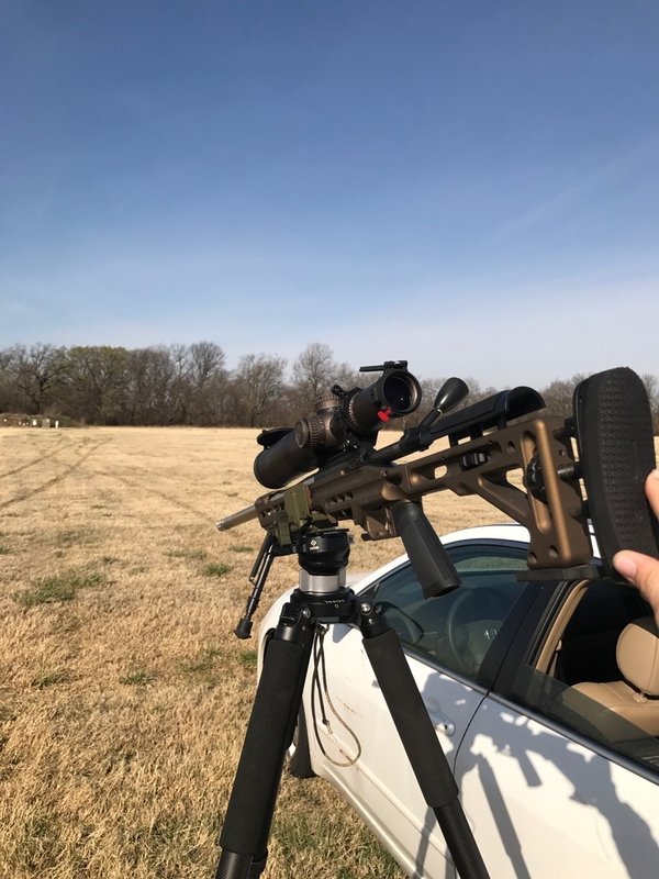

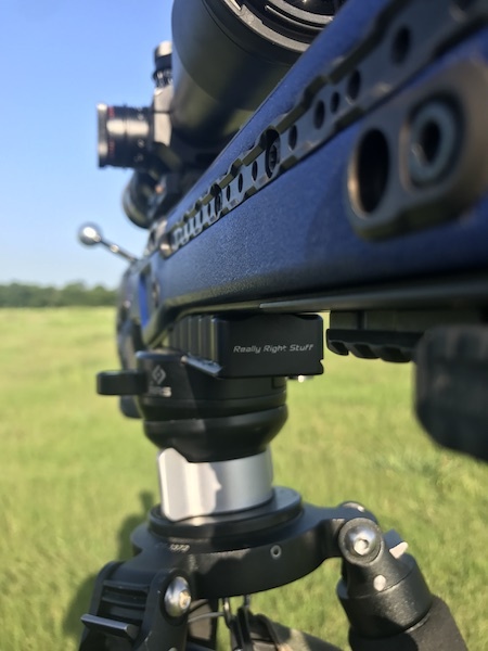

    Here are some pictures:

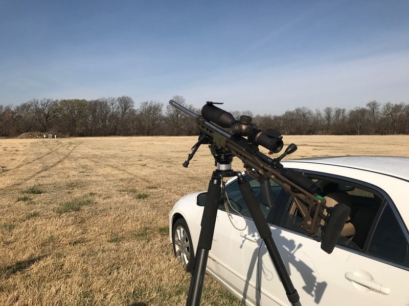

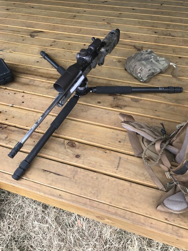

    Prone- This is insanely stable. Its almost easier than bipod and rear bag. It sits at about the same height as a typical harris/atlas bipod and works great! The difference here is recoil. The whole tripod will move a little which doesn't really allow you to see bullet holes at 100 through recoil like I can with a bipod and bag and solid fundamentals. Shooting prone like this takes a little getting used to. IMG_2621_zpsdqi4ig6m.JPG
    After they are removed you'll see a nylon threaded nut. Tighten or loosen this to adjust tension on the head. Once I found a tension setting I liked I removed the screw and put a drop of blue locktite on the nut and put it back on. I'd highly suggest adding a drop or two of locktite on this nut. The only issue I have ever had with this head was the nut coming loose and then tension not being very tight. Easy fix though.
    If you guys have any questions about this setup, parts, or anything else related to tripods and shooting. Let me know, I'll answer as best I can.

    With the leveling head, how much vertical adjustment do you have? I have been looking at this exact same setup but was curious if I had to have the vertical height perfect because of not having a ball head.
    15 degrees up and 15 degrees down. It really doesn't sound like much, but its more than you think. I'll try to get a video of that sometime soon. I'll get my new rifle together here pretty soon and get a video of it.
    If you need more adjustment, its as easy as just reaching up to the front leg and loosening it slightly taking the leg in an inch or two and re-tightening the leg. It takes all of 3 seconds to do.
    I have no problem shooting from 100 yard to 1320 where I practice. 1320 is as far as I can go there.

    It's really worth it to mount the plate to the stock.

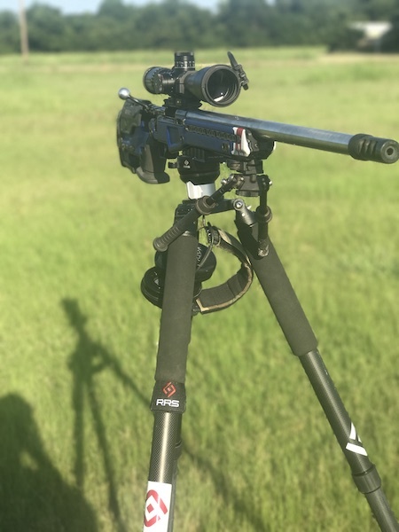

    RRS make a plate specific for the Hog saddle I have one and it clears the level bubble on my TA-3 leveling base.

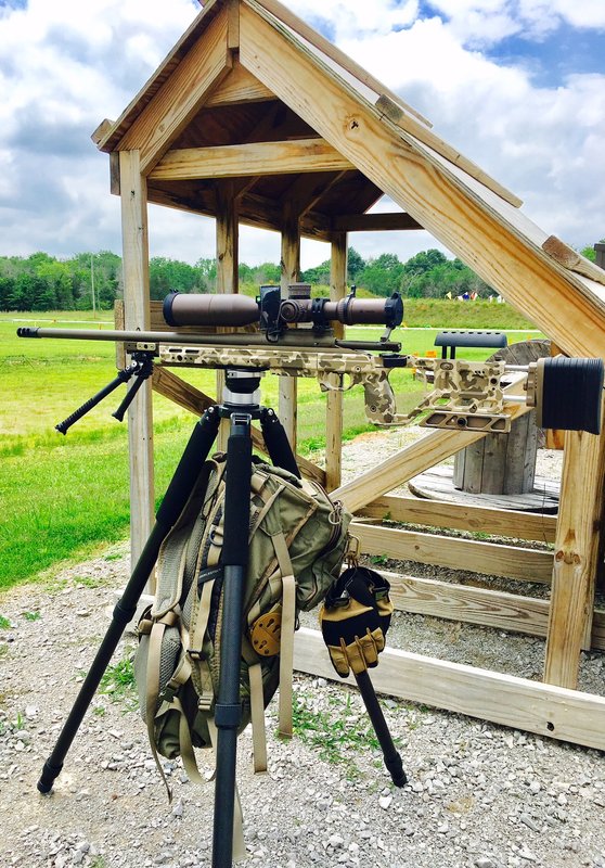

    I just picked this combination up and it is nice. I also have the RRS 55 ball head I can use, but right now that is on my Manfrotto tripod holding my spotting scope. I will be able to take it out next weekend to see how I bad I can shoot on a tripod :)
    I have the RRS AX plate for my 338, the RRS M-Lok plate for my RPR and a RRS Picatinny adapter for my other rifles. Will probably get the VYCE down the road as well.

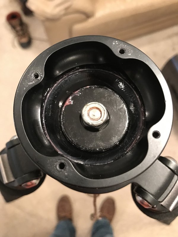

    I recently decided to upgrade my tripod setup, as a result of reading this thread. I was originally planning on buying the Feisol 3372, but I found a great deal on a used RRS TVC-33. It was not as cheap as the Feisol, but close enough that I felt being able to use the lower profile leveling base made it worth the difference. I also bought the RRS plate made specifically for the hog saddle. It does allow the torque knob to clear the clamp, but only if it's oriented over the level. It will still hit if the knob is over the clamp lever. Overall, the leveling base is the way to go. It's amazing how much more stable this setup is than what I've been using over the past twenty years. Thanks to the OP for this very informative thread. It certainly helped me make a much more informed decision.
    Glad to help man. Those RRS legs are awesome! Combined with the TA-2 or 3 leveling head and you can't beat it!

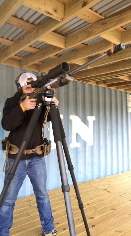

    Just received an RRS base and Feisol from BH in NYC . Wish I had
    jumps earlier , this shits on my old Slik with saddle . Sitting position is as
    good as prone for me now , standing needs a little work , will try the sling
    to belt trick next time out .

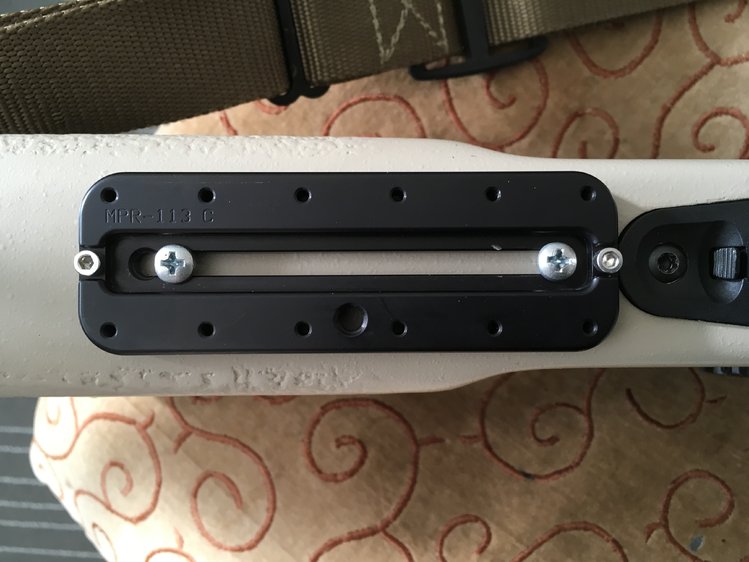

    RRS plate on T4A , attached with wood screws . Seems a little redneck ( guilty ) , but is rock solid .
    Didnt want hole saw large voids in the stock for T nuts or similar , seems like that would weaken
    stock .

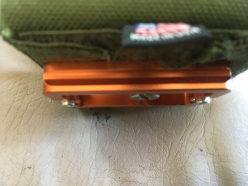

    Within 30 seconds of using tripod , I realised I'd need a lot more plates for everything else . Rather
    than spend $ 500 on RRS plates , got the orange one from a local camera store for $25 . Ordered a
    few more for other gadgets and rifles . The XLR will need the NATO rail adapter , which is on its way
    from RRS .

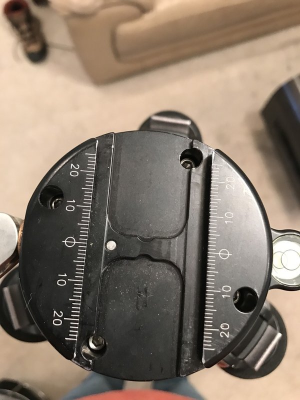

    Sweet man! Standing can be trick if your tension isn't tight enough. It wobble a touch. Tighten the tension and you should be able to set your reticle on whatever you're shooting, lock it down and be good to go.
    Quick question on the tension since I've never used a leveling base. Quickly adjustable tension is a must for me. I understand that you can adjust the tension in the unlocked position using the nylock nut pictured, but can you also adjust the tension using the locking mechanism? In other words, is the leveling base either locked or unlocked, or is there tension adjustment in between?
    As stated above, the silver paddle adjust tension. If you watch the video on the original post you'll see me slightly undo it to make an adjustment and then lock it down.
    The range of tension is set with the nut inside the head.
    The amount of tension increases as you tighten the silver paddle.

    Anyone using the RRS TV-33 that has direct comparisons against the universal head TA-U and the TA-3?
    I have a TA-U-LC, but would like to know how much real difference might be had if any with the TA-3. Seems any "bounce" or flex is coming from the TA-U-LC.
    DIY ELR Target Cam with DVR - well proven 2000m+ 2 camera, multiple monitors - link below
    https://www.snipershide.com/shootin...camera-system-with-integrated-dvr#post6291944
    The TA-3 is a little smoother than the TA-U. I've used both quite a bit and if I could I'd rather the TA-2/3. The TV-33 with TA-3 hard mounted is retarded good. There is a small but noticeable difference between a full RRS setup and the Feisol with the universal head.
