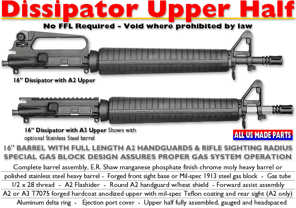

I would look at how you plan on using the rifle first.
If this is a blaster, CQB, ready up drill rifle than a 1/9 twist is just fine.
IF you plan on going past the 300yd mark with groups better than 2 MOA at that distance. I would tell you to run a 16" 1-7 twist direct gas .750 after the gas port with a 12" handguard. aka a Dissipator upper Then at the end of the gas port install a PRI flip up barreled front sight system.
This would give you the sight radius of a 20" bbl on a 16" and would keep it clear for ant optics like a Eo-Tech
here is a basic pic of a Dissipator upper I am talking about
Look at the barrel mounted sight to the left
Now with this setup your gas block is under the handguard
thats the smart money system for many smart reasons
