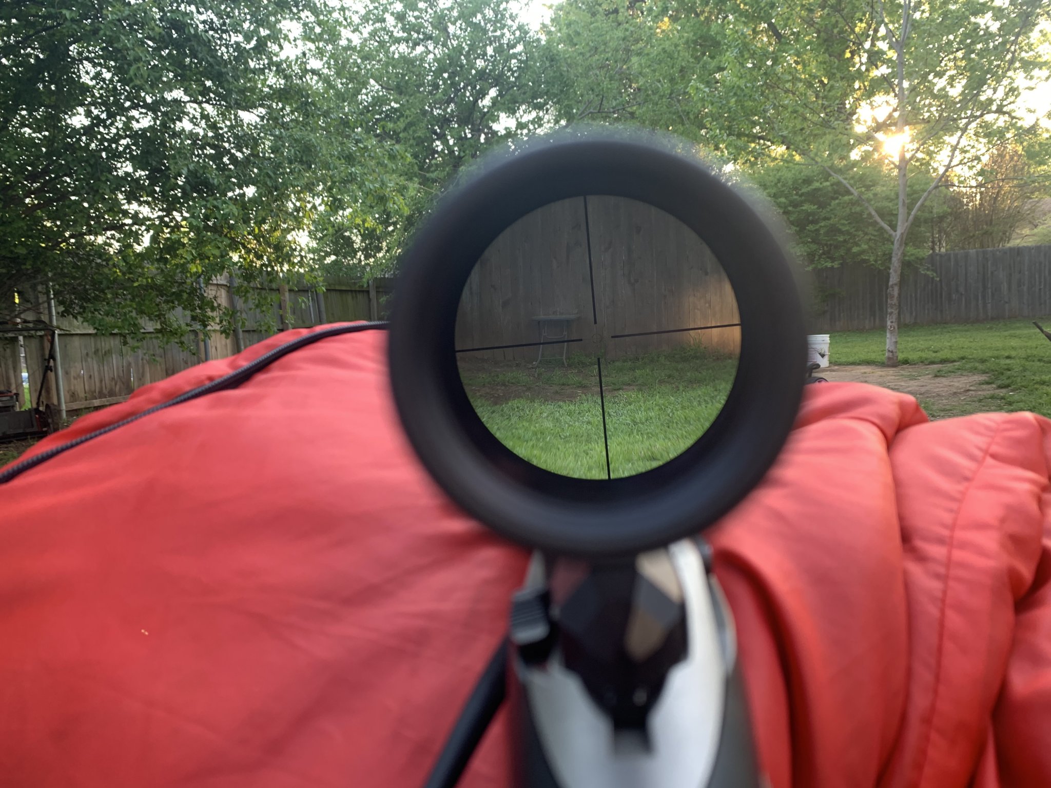

Addressing the weakness of FFP, here is a 3x pic through one of my 3-12 LRHS. Back fence is 25yd, it’s about 7:25 here.
If that’s the weakest point...
TBH the G3 reticle is known as one of the best hunting FFP reticles around because of that. Show him the picture of a MIL-R, or Gen2XR, or SCR. Its not the same ballgame. I agree with you that FFP is more useful in alot of situations, but MOST FFP fail in low light, low magnification situations.
Before you buy a FFP hunting scope make sure you look at it in a hunting magnification and make sure the reticle is still usable.
ALSO most hunters are going to be using a LRF and dial for elevation at maximum magnification if they have the time to do it. If not its inside 300 yards where wind and drop dont make a hell of alot of difference. If they miss the first shot, they arent going to have the same shot again to use the ruler for their miss. It wont matter the game will be gone.
