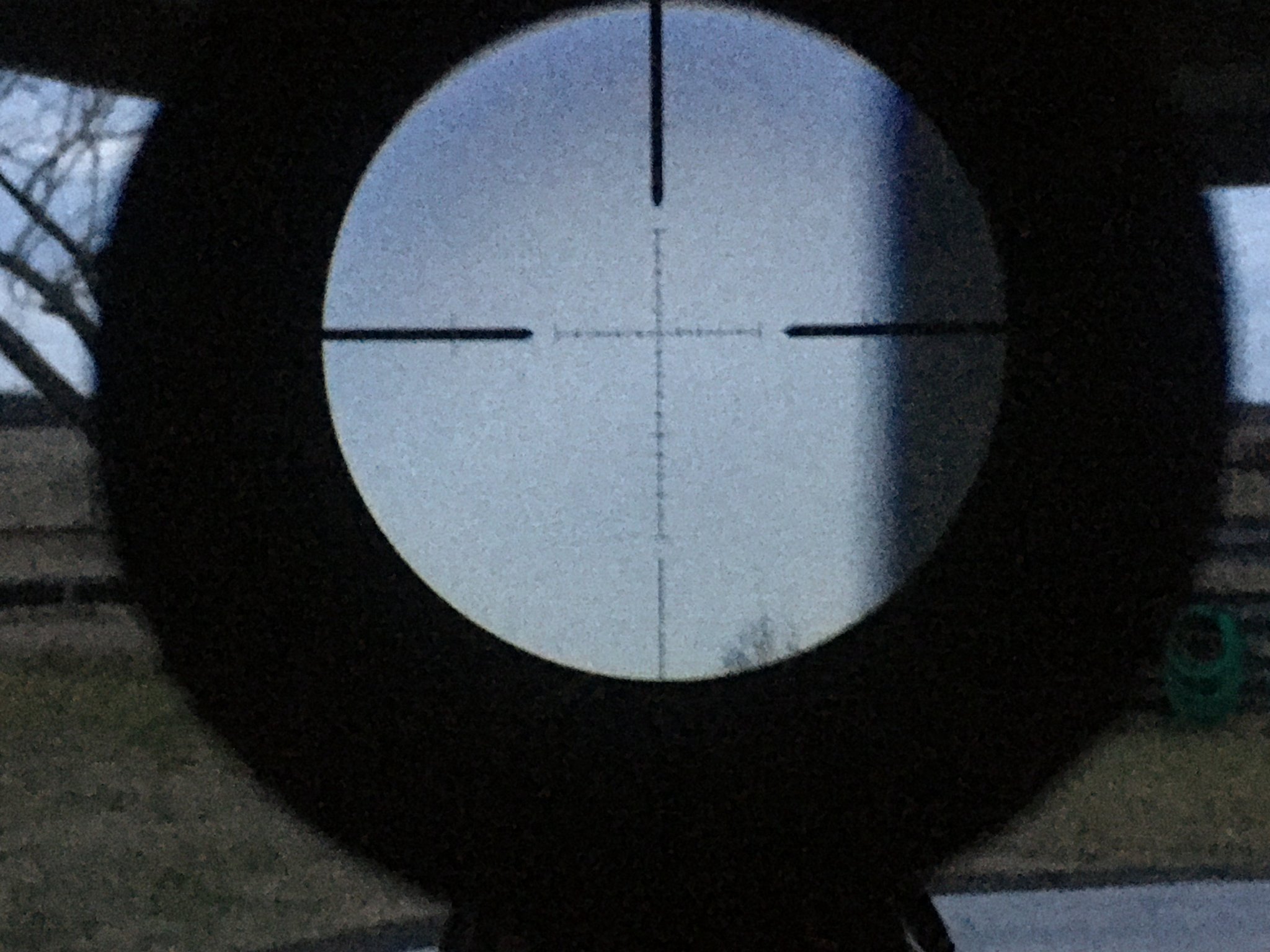

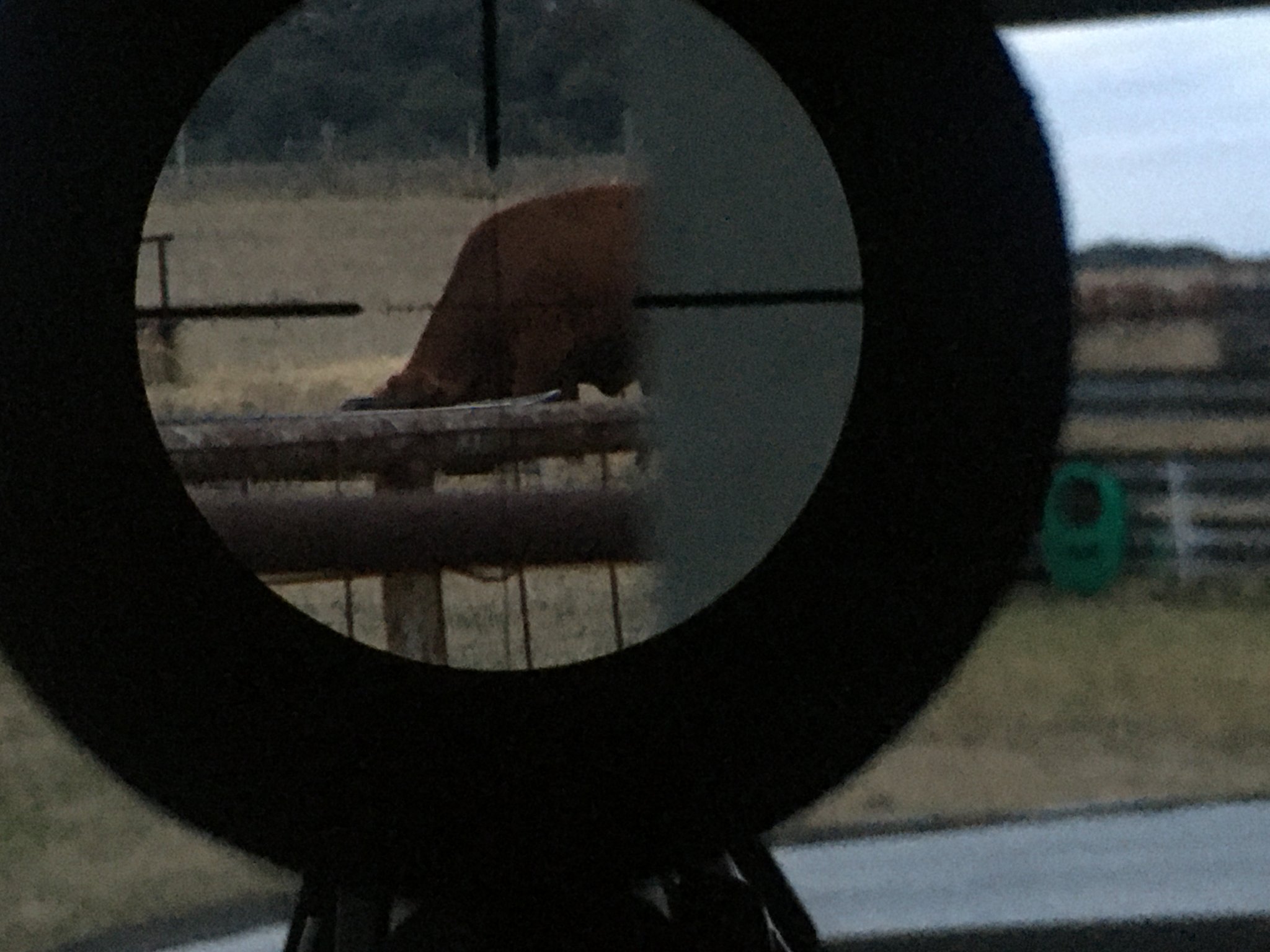

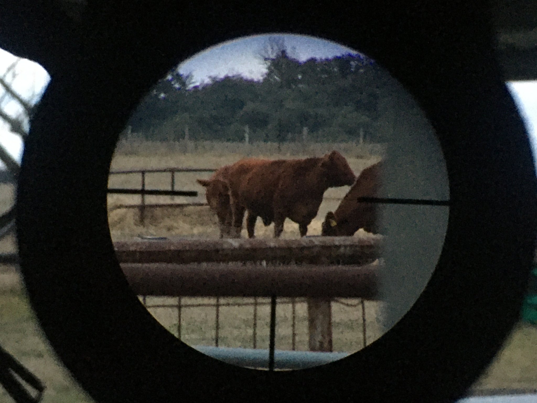

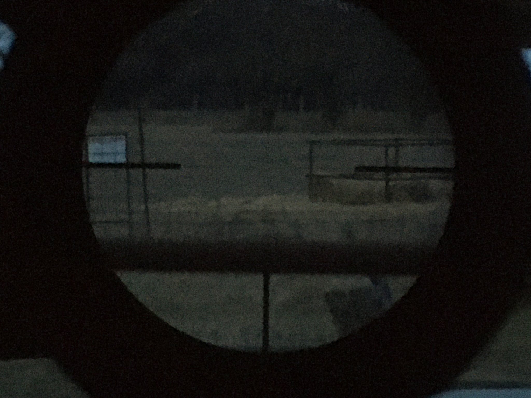

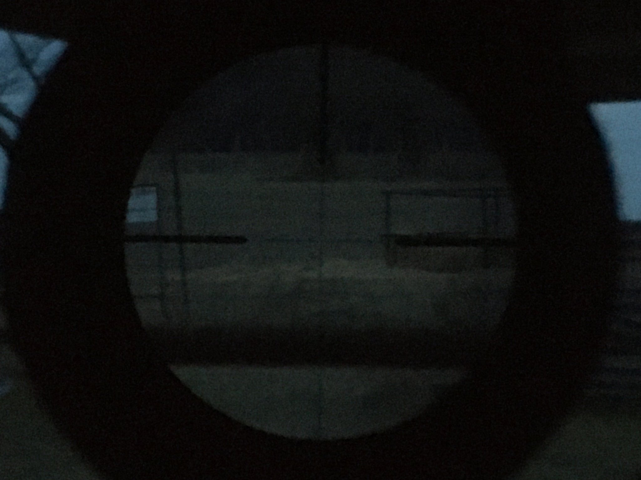

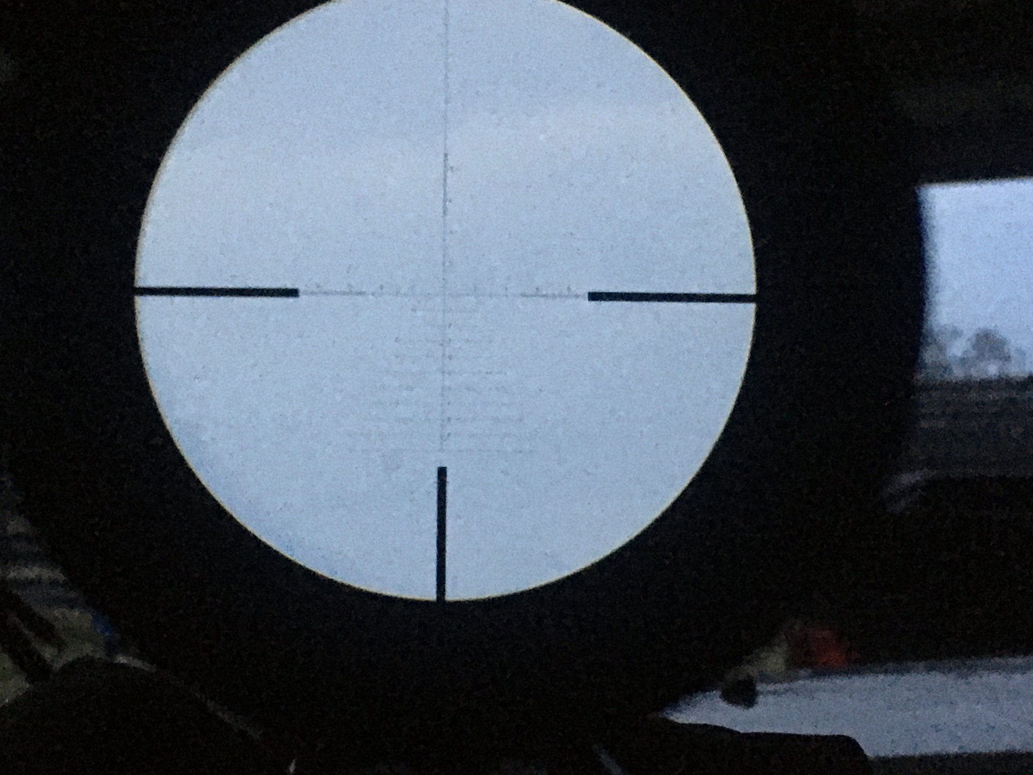

@wb00757 this is a comparison of a Vortex Razor gen ii with a .03mil reticle and a SWFA 5-20x50 with a .05 mil thick reticle both at 10x and roughly at 100 yards
The razor is the top picture of each set while the SFWA is the bottom of each set.
First two picks are 5 minutes after sunset and the last two are 20minutes after sunset.
where is the Razor reticle? You cant see the damn thing without illumination. Of course people will argue that ?‍♀️
Not the best camera work but you get the point. The camera on my phone wont focus very well when there isnt much light.
@wade2big
Awesome!
I definitely think I like the .05mil stadia lines better based off of those pictures but in daylight and I feel like I the thinner .03mil would still be usable at 10x with my eyes. I doubt I'll ever go that low in a match, but I could. Time to do some more research!
That really shows off the difference of low light performance between those scopes too. My 20x SS would look like a dark grey haze in those conditions. Lol.

10x is usable with the thinner reticles, it is just a little tougher to see when conditions aren’t bright out. These higher mag scopes arent taylored to the low end anyhow. I just usued that 10x to better show the difference that reticle thickness can have on visibility on the lower end. I doubt you would go that low in a match either. I really like my Gen II Razor’s and definitely didnt buy them to shoot at low mag!!!

I took pictures with illumination between the two scopes but didnt post them. It made a world of difference. I mentioned that in the post. The thinner reticle with illumination was better than the thicker without for sure. Illumination and FFP scopes go hand in hand.
