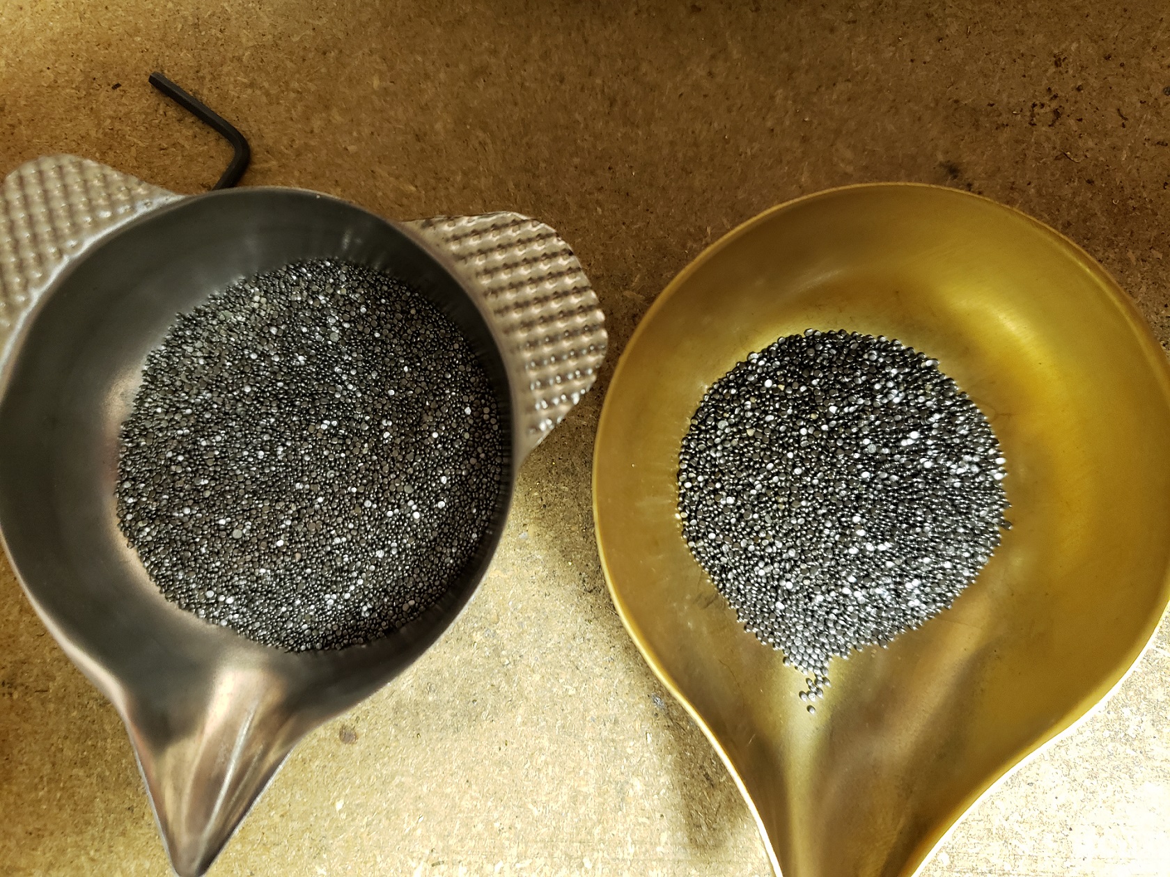

I ordered 1 box Product# GM308BH185 and took a few measurements and thought i'd post my findings
#1-20 in order
COAL - Case Weight - Ogive to Base
2.790" 412.9 2.137"
2.778 411.4 2.134
2.783 412.0 2.134
2.783 411.5 2.134
2.786 412.1 2.134
2.785 412.6 2.135
2.785 412.6 2.134
2.789 412.2 2.138
2.781 412.0 2.132
2.777 412.5 2.131
2.781 412.8 2.131
2.783 411.7 2.136
2.782 411.8 2.130
2.793 411.4 2.136
2.790 412.0 2.134
2.790 411.2 2.134
2.785 412.0 2.134
2.790 411.7 2.139
2.784 411.5 2.135
2.783 412.0 2.134
High
2.793 412.9 2.139
Low
2.777 411.2 2.130
Average
2.785 412.0 2.134
I pulled 5 rounds to take measurements
Case weight in grains
1. 182.6
2. 182.0
3. 181.8
4. 181.6
5. 182.0
Powder weight. Looks like Alliant 2000-MR IMO
1. 45.3
2. 45.2
3. 45.2
4. 45.2
5. 45.2
Bullet base to Ogive
.69" all 5
Bullet OAL
1. 1.344
2. 1.341
3. 1.339
4. 1.341
5. 1.341
I hope this helps anyone researching this ammo.
Hopefully I will get a chance to shoot it in the next few weeks
Finally got a chance to shoot this stuff today.
MV
2539
2525
2539
2544
2525
2549
2534
2549
2525
2530
2530
2534
2544
2549
2534
Pulled and Re-seated bullets
2534
2520
2539
2539
2549
I did 4-5 shot groups all were under .75 moa with the 2nd right at .3"
FN SPR A5 20" barrel
10/23/19
CFE223 was mentioned and I do recall the powder having a slight musky smell(maybe that's just me) and I have 1lb on hand
re-prepped the cases
FL resized
dry tumbled in corn cob media
de-burr
VLD I.D. of neck
Primed with federal 210M primers
sorted cases by weight and picked 5 of them in the middle of the weight range
Primed weights
181.6
181.6
181.6
181.5

Powder looks very similar to cfe223 but in my opinion its not. CFE223 looks to be much more spherical, the fed looks much more like a crushed spherical or flake. Color looks pretty spot on though.
CFE223 on left and federal on right:
Just got back from the store with a pound of CFE223. I put up an urgent WTB ad in the PX, but if anyone has or knows of a source that would sell some projectiles within the next 24 hours, I can charge and seat and have some data on 45.0 - 46.0 test loads this weekend.
