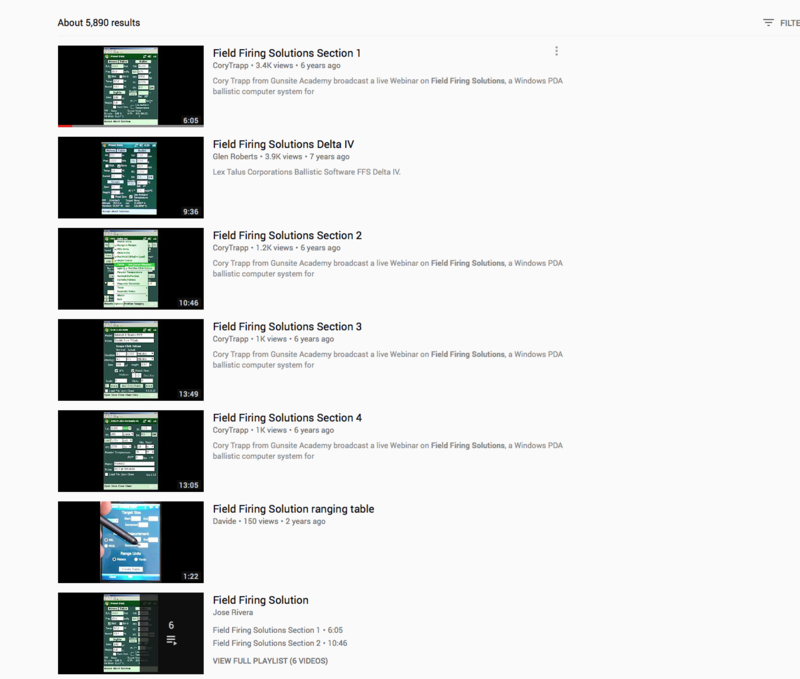

Cory Trapp has instructional videos on YouTube
<iframe width="560" height="315" src="https://www.youtube.com/embed/e0GqgKq_OVs" frameborder="0" gesture="media" allow="encrypted-media" allowfullscreen></iframe>
<iframe width="560" height="315" src="https://www.youtube.com/embed/dYQckhFwhII" frameborder="0" gesture="media" allow="encrypted-media" allowfullscreen></iframe>
etc...

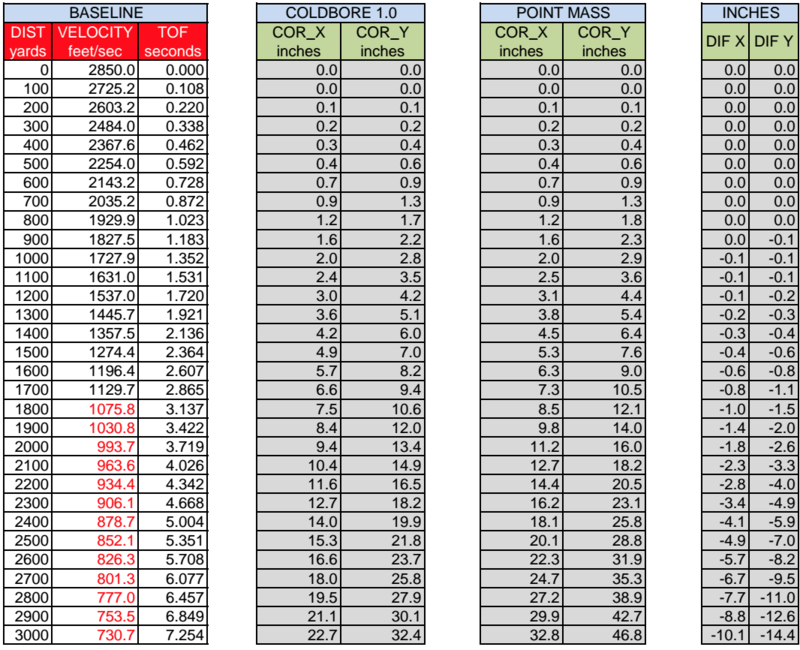

Starting at 1200 and really kicking in at 1500 the different apps are all over the place. In my humble opinion Trasol has been the most accurate - this could be that its just the easiest and I haven't spent enough time truing the others. That however is exactly the point, I don't have to spend a bunch of time truing to get great results.....
This is one of the most important points about the non-Point Mass solvers like FFS and Coldbore, I gotta say you nailed it right! this weakness is so common to see with AB, AE, etc.
It's also worth noting that "drag curves" ("custom" or not) are hardly new despite what the AB marketing machine likes us to believe: the first program featuring it IIRC was QTU (many years ago), followed by JBM, Lapua, Strelok, Nimoh and later Hornady. So, I'm sorry to say there is no such "breakthrough" ...another fantasy only taking place in the virtual reality created by AB ;)
Moreover, in a good number of tests, even some conducted by guys running AB with their "cdm", against Coldbore (untrued and fed with G7) the difference against real-world dope was significant while Coldbore was all the way better along the entire curve, speaking volumes about these solvers not based on Point Mass.
