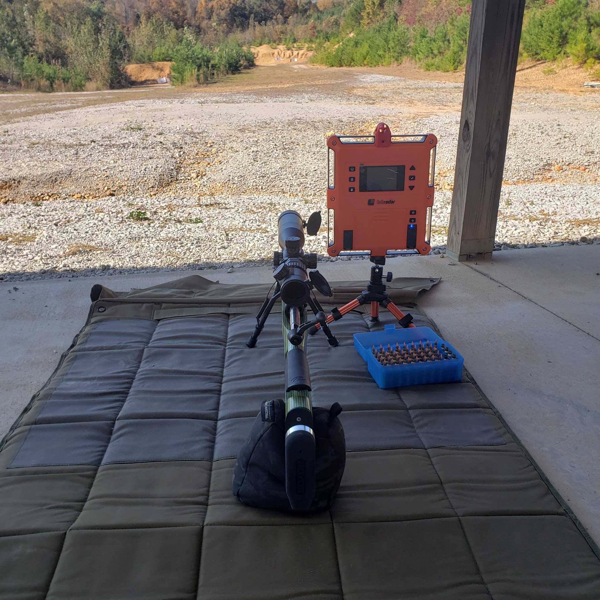

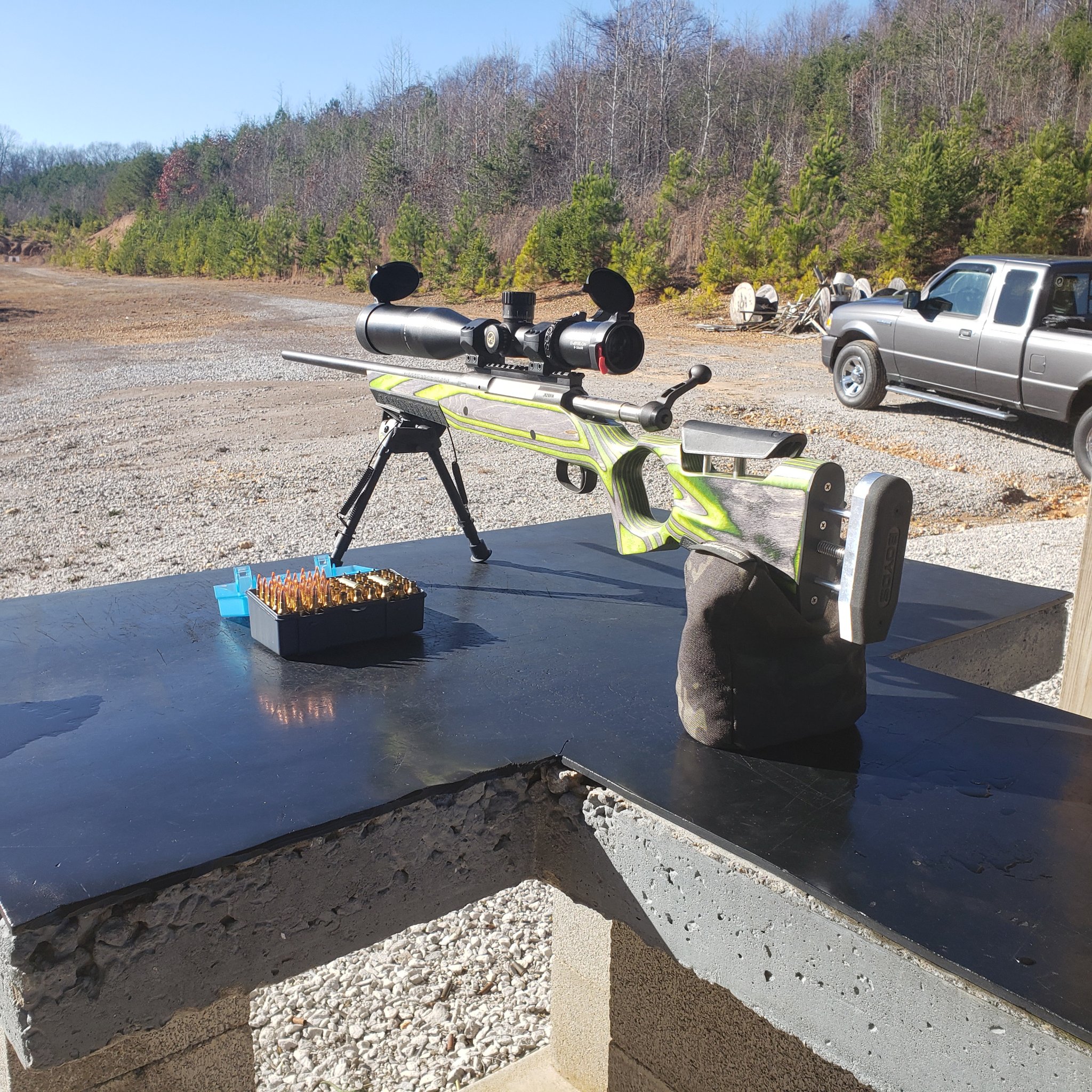

Hey Fellas, I was hoping to hear some opinions, thoughts and solutions for a problem I face and I’m sure many others do as well.
When shooting prone I always find myself fighting my rear bags. I tend to need to use a larger bag like the big green Caldwell type bags to get enough height in the rear of the bag and find myself straining and hugging/squeezing the shit out of the bag to maintain a steady position.
I know I need to have as little muscle tension as possibe and would prefer to squeeze the bag much less than I am currently doing.
I am currently using mdt buttstock with a bag rider and a bipod that puts me about 9 inches off the ground at its lowest setting (11 inches wide) and a Fclass adjustable bipod is not an option.
What are you guys using for your rear bag and what have you done to alleviate these issues? I am on the verge of figuring out how to machine my own adjustable height bag rider lol.

your bags look pretty small.
I don’t personally like using either of my game changers as rear bags but they appear to be larger than your rear bags.

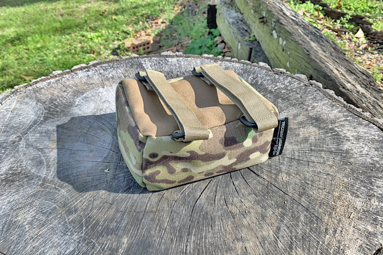

I threw together a bag to take to a match the other day and it is basically one of these with no straps with ultra lite fill. I filled it pretty firm.
I wanted it as a supplemental bag in case the Recon Micro I had on the Arca rail was not big enough to fill a large gap on an obstacle. I ended up not needing it but it would be perfect as a base to add height to your regular bag if you were shooting a downward angle. It’s grippy on the top and bottom and weighs a few ounces.
