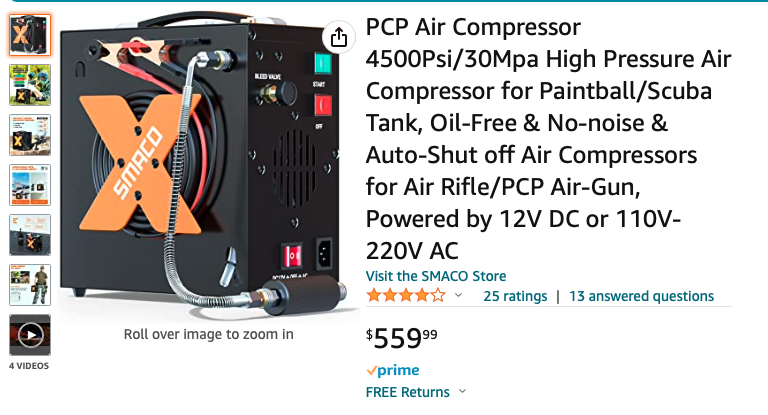

I just bought this one and it's good so far. I did buy the 3 year extended warranty. I also bought a better filter system for it.

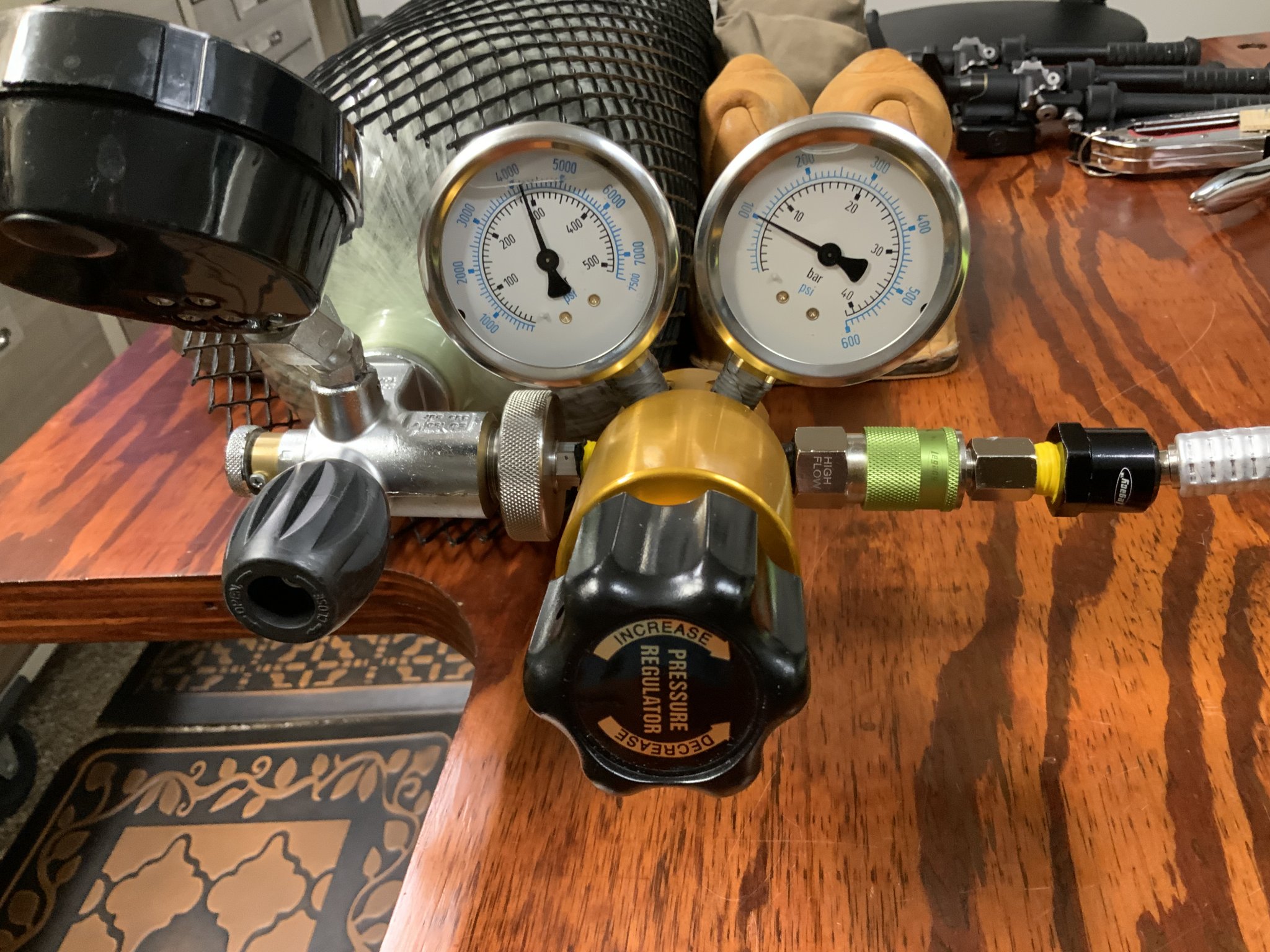

I'm not sure of your needs. If you are just wanting to fill your rifles to 3300psi or so (with 700 cc or less), then you can get away with allot less compressor. If your looking to fill 74CF to 100CF Carbon fiber tanks to 4500 PSI, then your requirements (and cost) goes up considerably. I'm in the first camp and bought one of the Chinese compressors off Amazon last year for $265. So far it works great and meets my needs nicely. Fills any gun I have in 3-10 min, has auto shut-off and needs no external cooling source. I splurged on a 4 year extended warranty for $35 just to make sure I'm covered for at least that long. I figure if I can keep my guns filled for less than $75/year, I'm good. Here is the one I purchased but I'm sure there are others that are comparable in the same range.

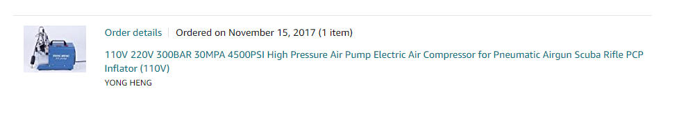

I agree 100%. I have a Yong Heng and 2 tanks. Although it is a PITA, I like the fact that I can help control the temps properly with cool / cold water.
Check the output flow capacity of the pump you are buying...I did and was / am suprised by the output of the Yong Heng. It isn't the best made, but unless you are planning on doing tons of shooting, then it is one of the better places to start.
