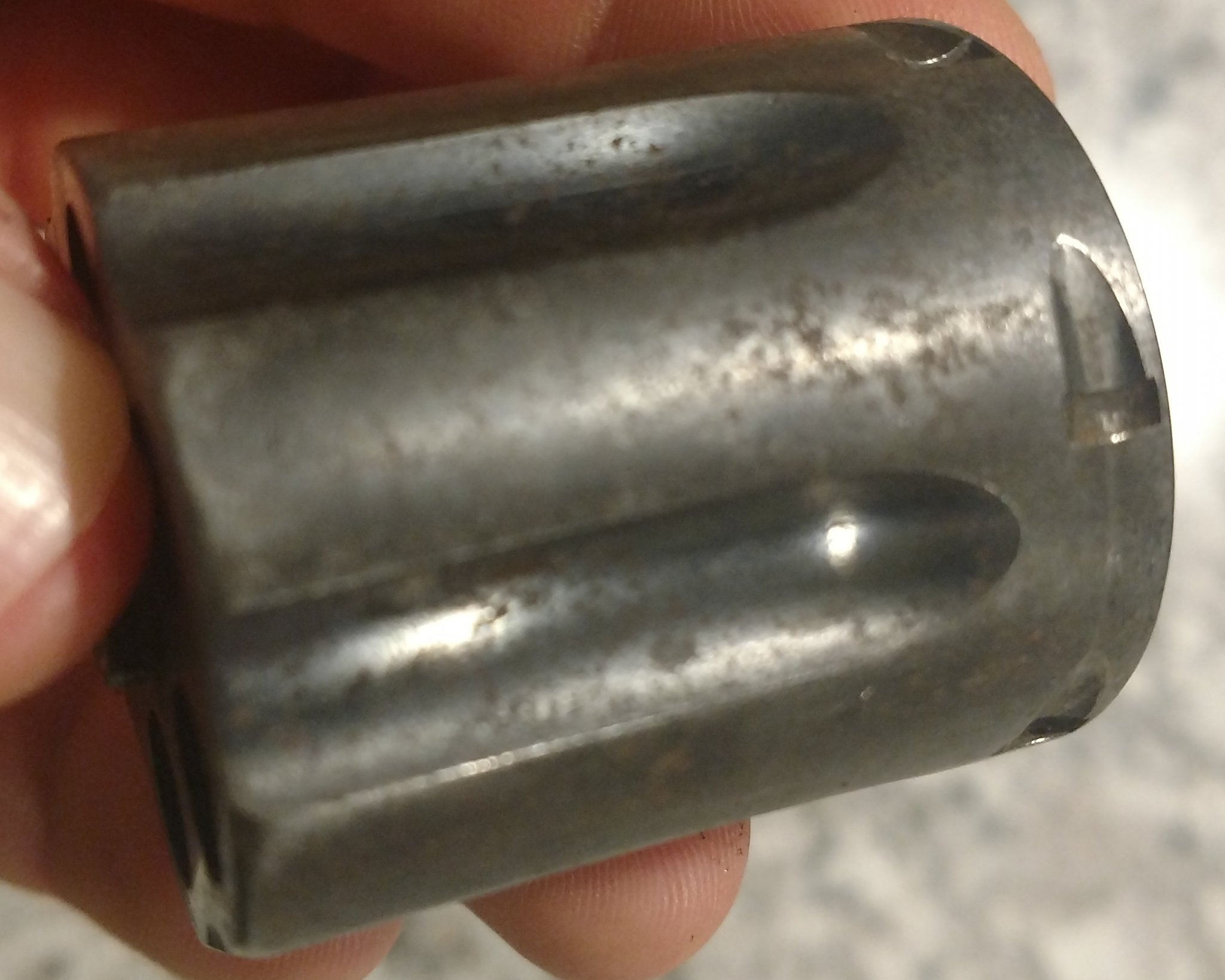

Ok, here are some idea of what it looks like after removing the rust coat. The pits left here are too deep to file / sand out without removing a substantial portion of the frame

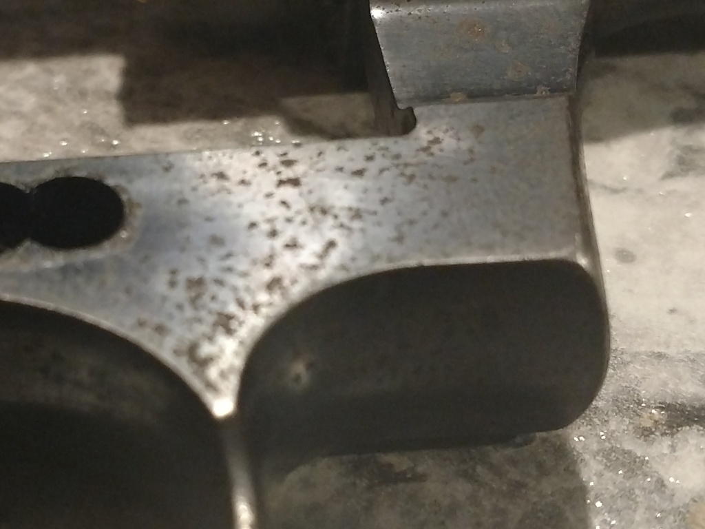

This picture doesn't show it well but it's the same pitting as above covering the entire pistol, with just random heavy pits
That pitting does not look deep, I would not hesitate to refinish that gun.

I'm not able to show it well in the picture but let me explain the top pic
That is after sanding off all the rust I could get. The spots you are seeing are holes / pits / divets / pockets .... Whatever I should call them
First degrease everything, then you have to get rid of ALL the rust out of the pits, a diluted muratic acid dip will take care of that.
Then get some auto body spot putty, a small rubber squeegee and 240 and 320 grit wet/dry sandpaper from the automotive supply.
Use the squeegee and spot putty to fill the pits, let cure per directions.
Sand it all smooth.
Use air dry Cerakote and an airbrush to refinish.... or simpler, but not as good, a spray bomb gun finish from Brownells (many choices).

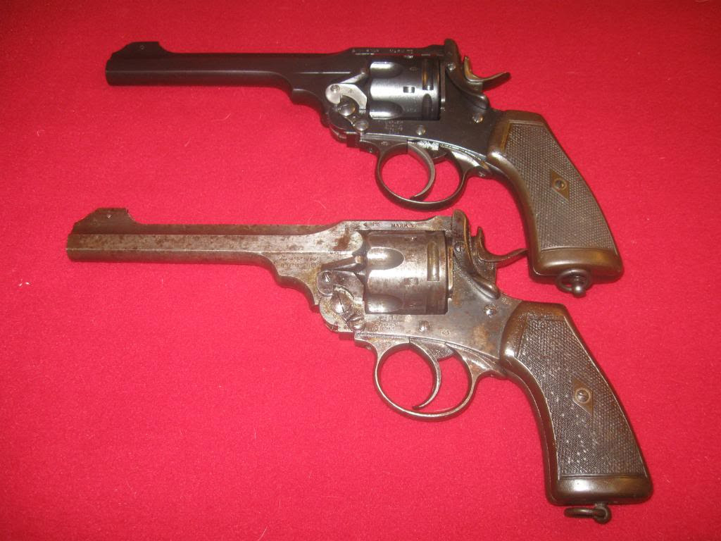

That's often the case. You need to use a sharp file first, the sanding comes after when all the pitting is taken care of. It will probably take two of three days to get the metal ready for the bluing process. The bluing will probably take another day unless you have access to hot bluing tanks.
If it's worth doing at all it's worth doing properly. Get the book :)
If you want to know how to refinish your gun buy this book.

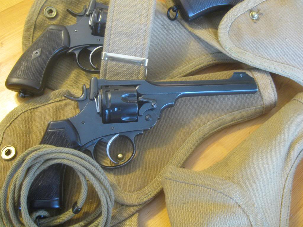

I'll check it out, doing a rust blue is not new to me though, I've done a few over the last ten years that came fine. Usually polish defects out and it comes out fine. The rust on these is too deep for me to just polish out though... If I blue as it is it's going to look like a teenage boys face hitting puberty but with a nice even completion
Those Webley's pictured above were very rough, at least as bad as yours or worse. I did not measure the depth of the pitting, the thought never entered my head. Get the book, it taught me a lot.
You worry too much. :)
BTW I used Radocy HOT rust blue on those revolvers, it's much better and quicker than cold rust blue.

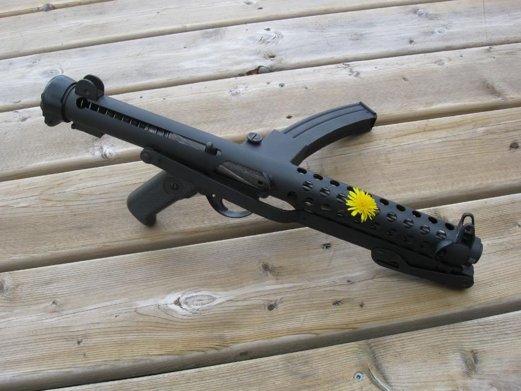

Automotive high temperature engine block paint is just as good as Cerakote, it's also ceramic. Cheaper too. It's perfect for Sub machine guns, not much else.
Automotive high temperature engine block paint is just as good as Cerakote, it's also ceramic. Cheaper too. It's perfect for Sub machine guns, not much else.View attachment 6999725
