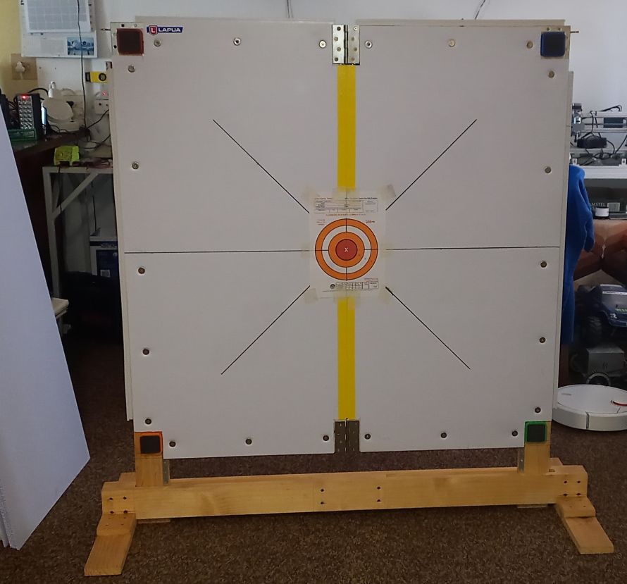

Hey guys just wanted to share this "shot marker" stand from Detour dynamics it looks like a great piece of kit. I'm sure you long range ninjas could appreciate it.
https://detourdynamics.com/
I have to look at this from the perspective of anything downrange is going to get shot eventually so you want it to be cheap and easily fixed or built like a tank so it can shrug off hits. You can't really protect the microphone clusters so the first solution is probably the right one.

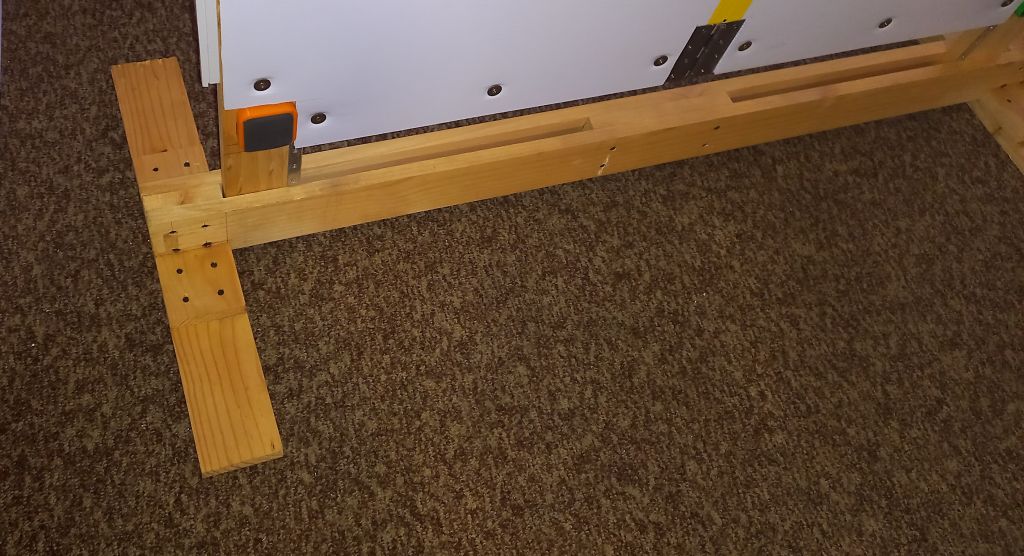

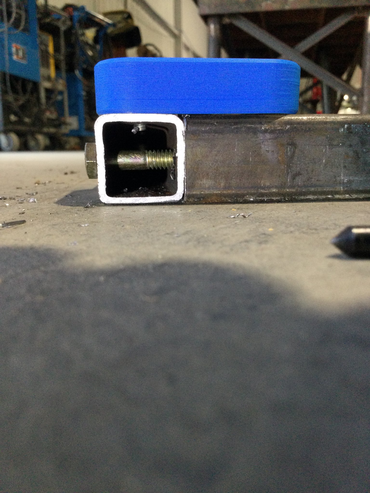

I just bolt up 3"x1" aluminum tube, use wing nuts and it breaks down to straight sections for transport.

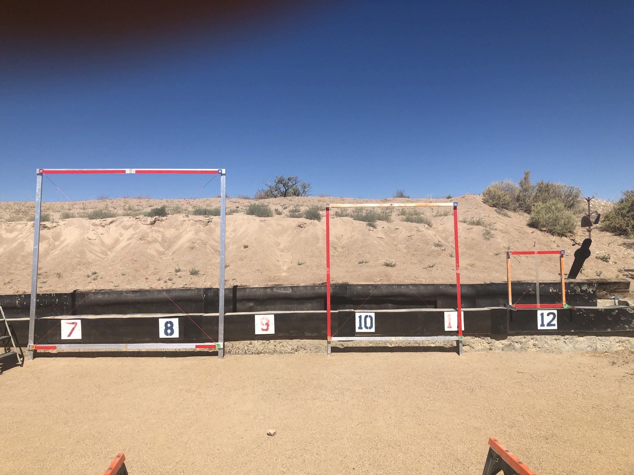

I just added a third frame to the stable. We will now have a 1500/2000 yard target. In fact, we can now set three targets in line at 200/400/600 and capture 4 velocities on a single shot, as well as relative shot locations. The new frame is just under 10'x10'. We are also adding downrange wireless wind sensors for the calibration ranges.
Nice. I wish we had the land on the east coast to build a facility like this. Probably the only thing I miss about living and growing up out west. Open land.

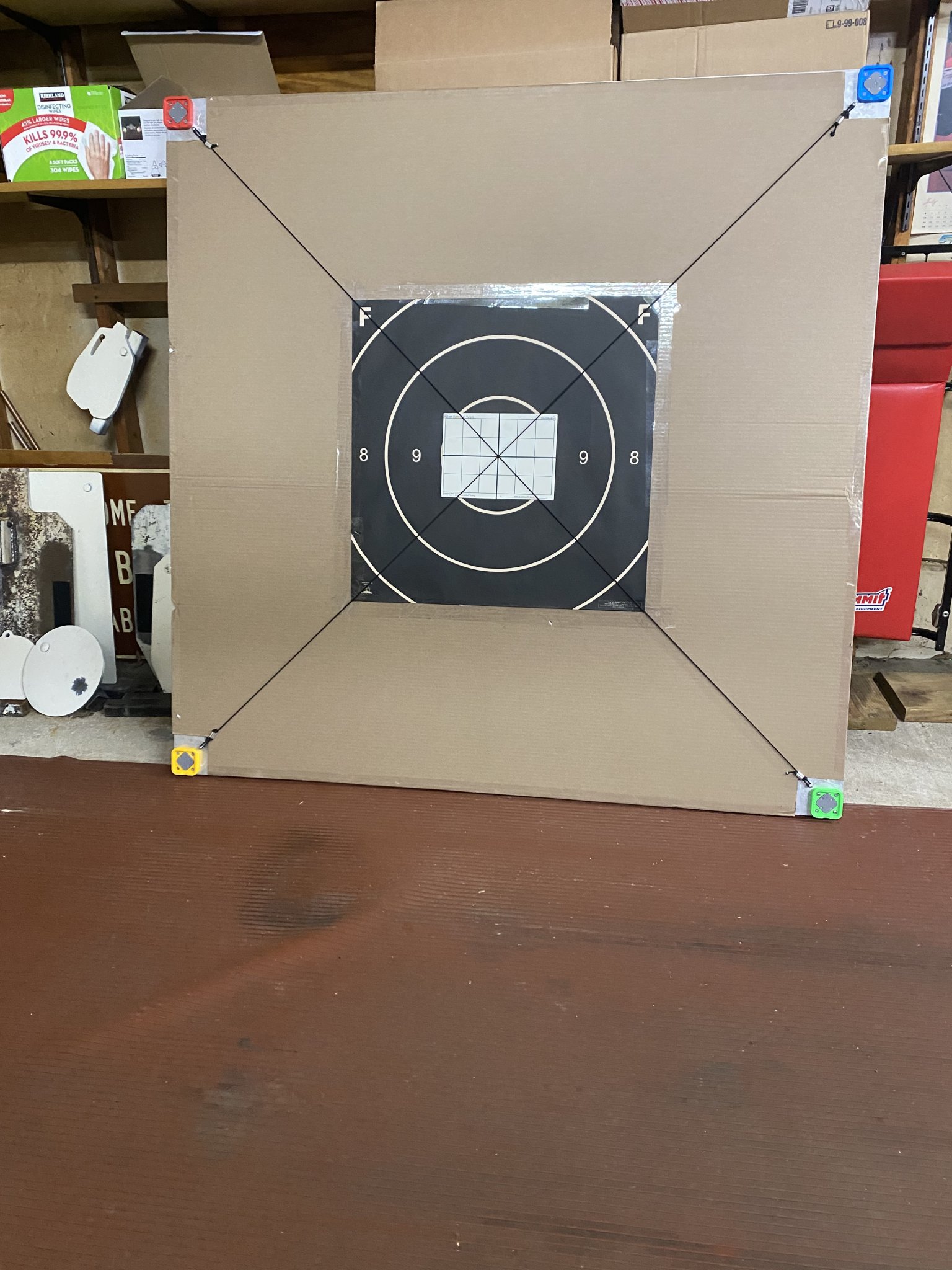

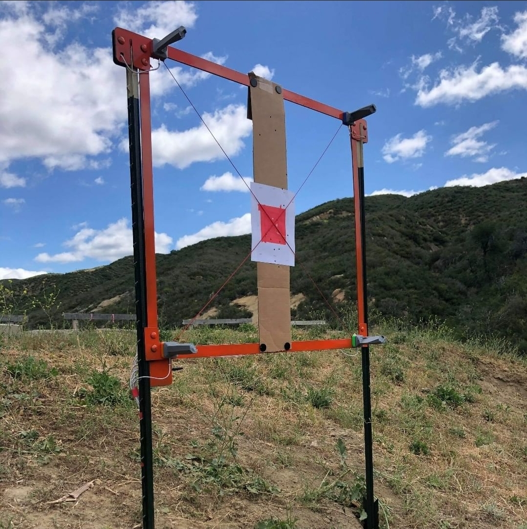

Sorry for my stupidity… what’s the string for?
The crossed string make sure you post the aiming point in the center of the sensor block. I just use some strips of fiberglass tape, hold the aiming point perfectly even in a high wind without vibrating the frame.

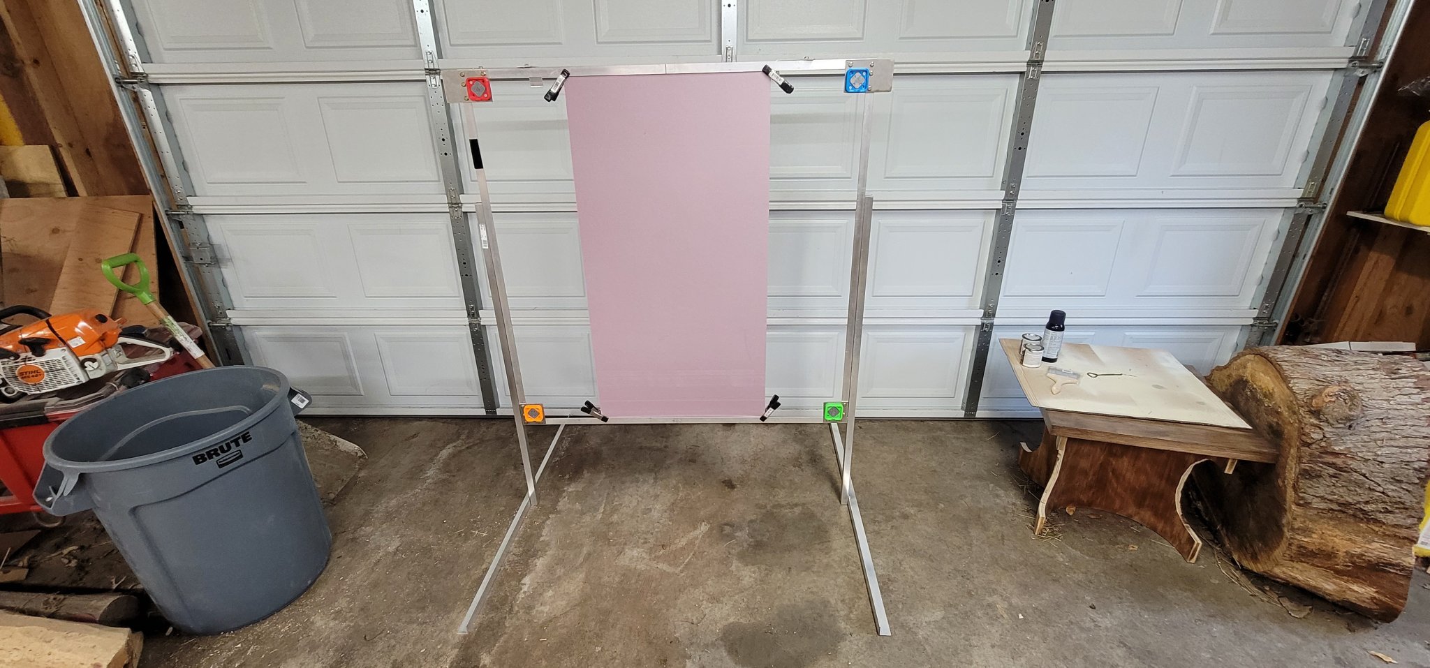

Well, not in the class of you guys, but I got a Shot Marker at a price I could not refuse, and since a Suzuki Jimny is somewhat limited in internal space, I needed a fold-up target that could fit on the, small, roof rack.

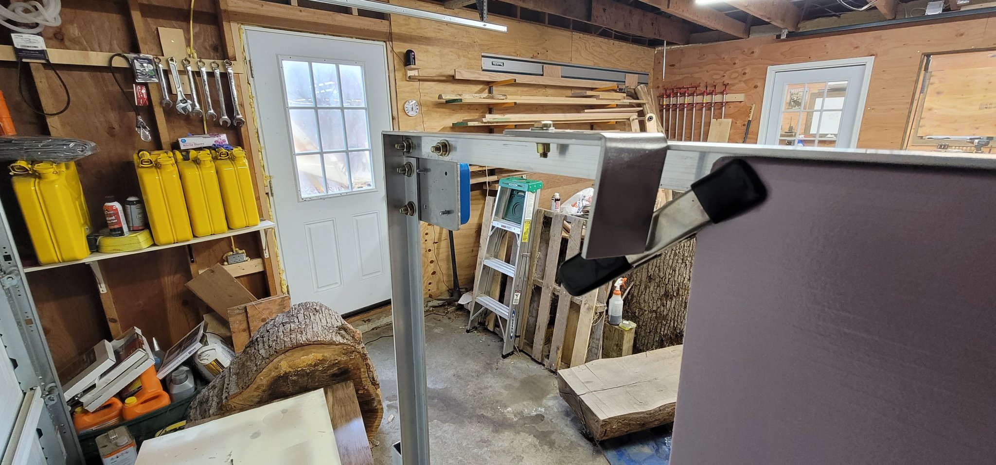

Borrowed heavily from F- Class John, this is what I came up with.
Reactions: Mr.BR

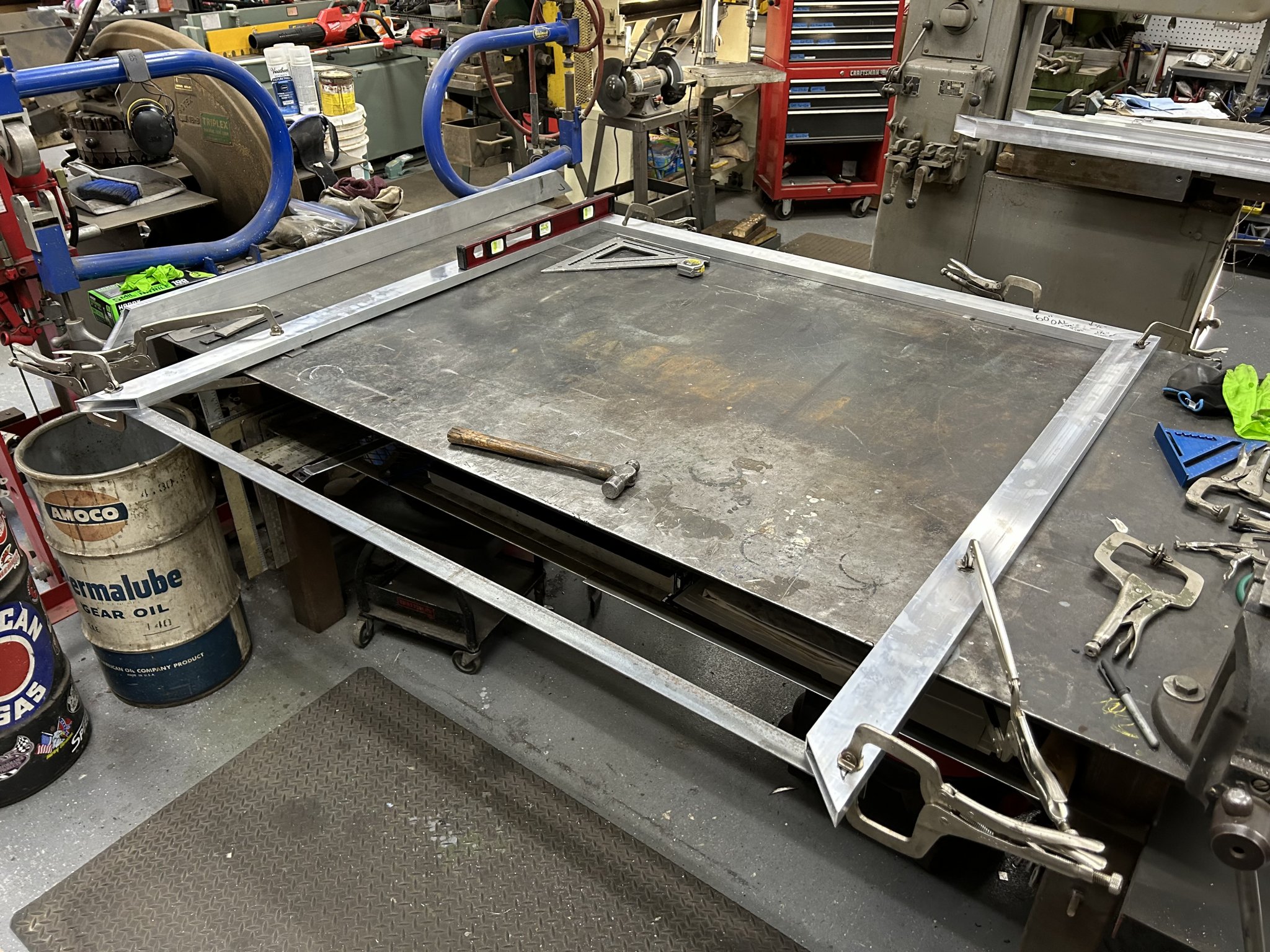

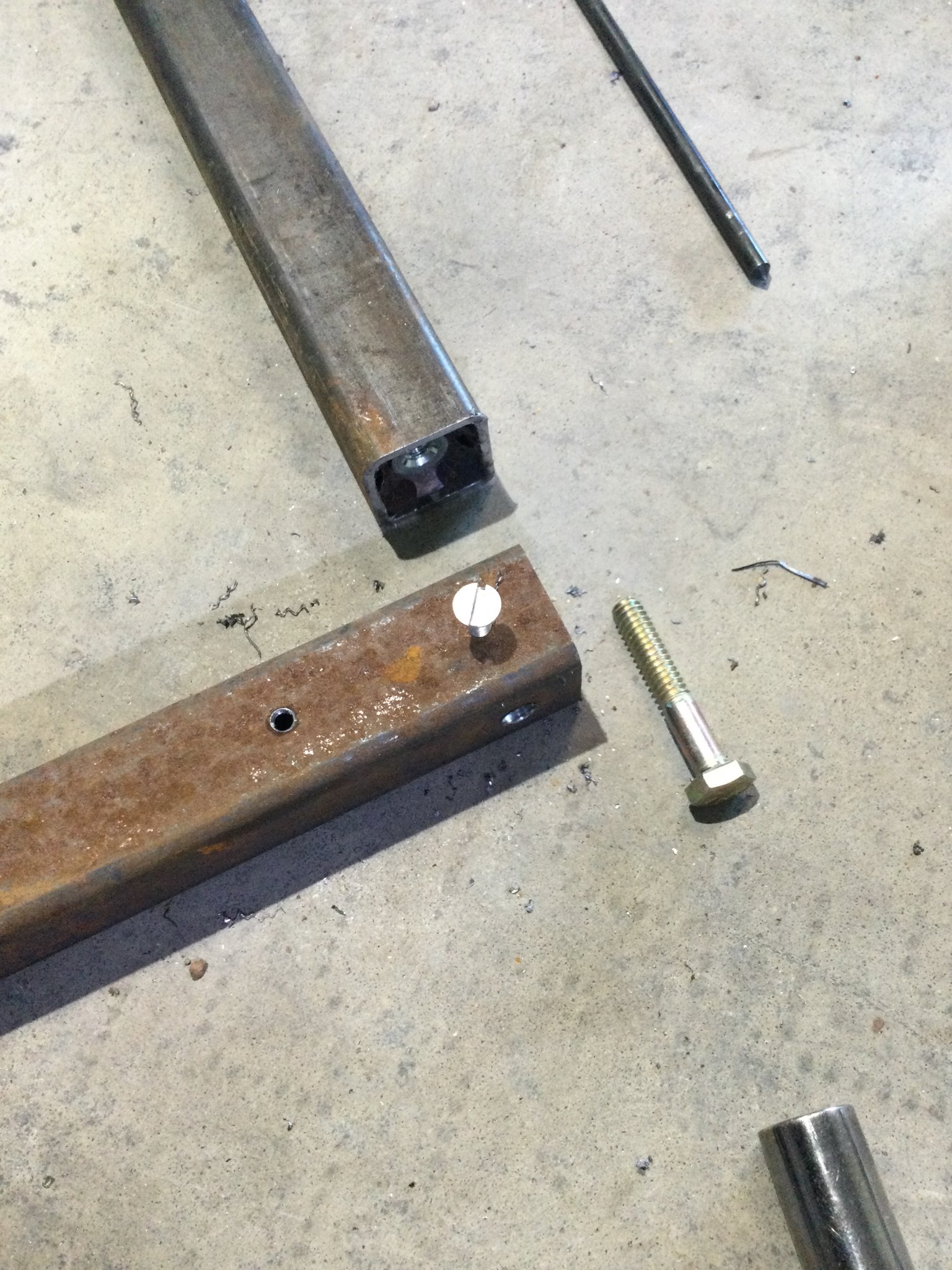

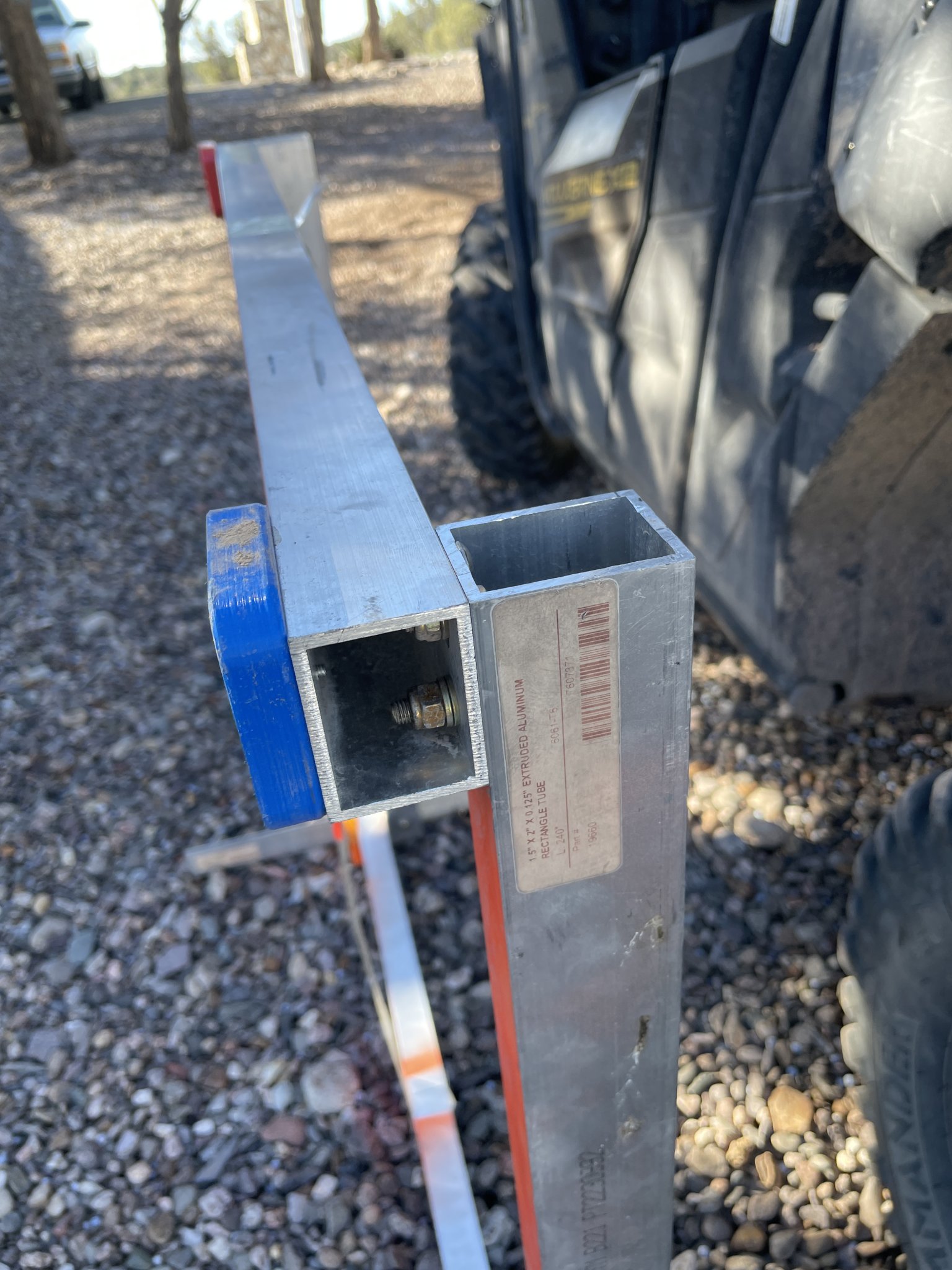

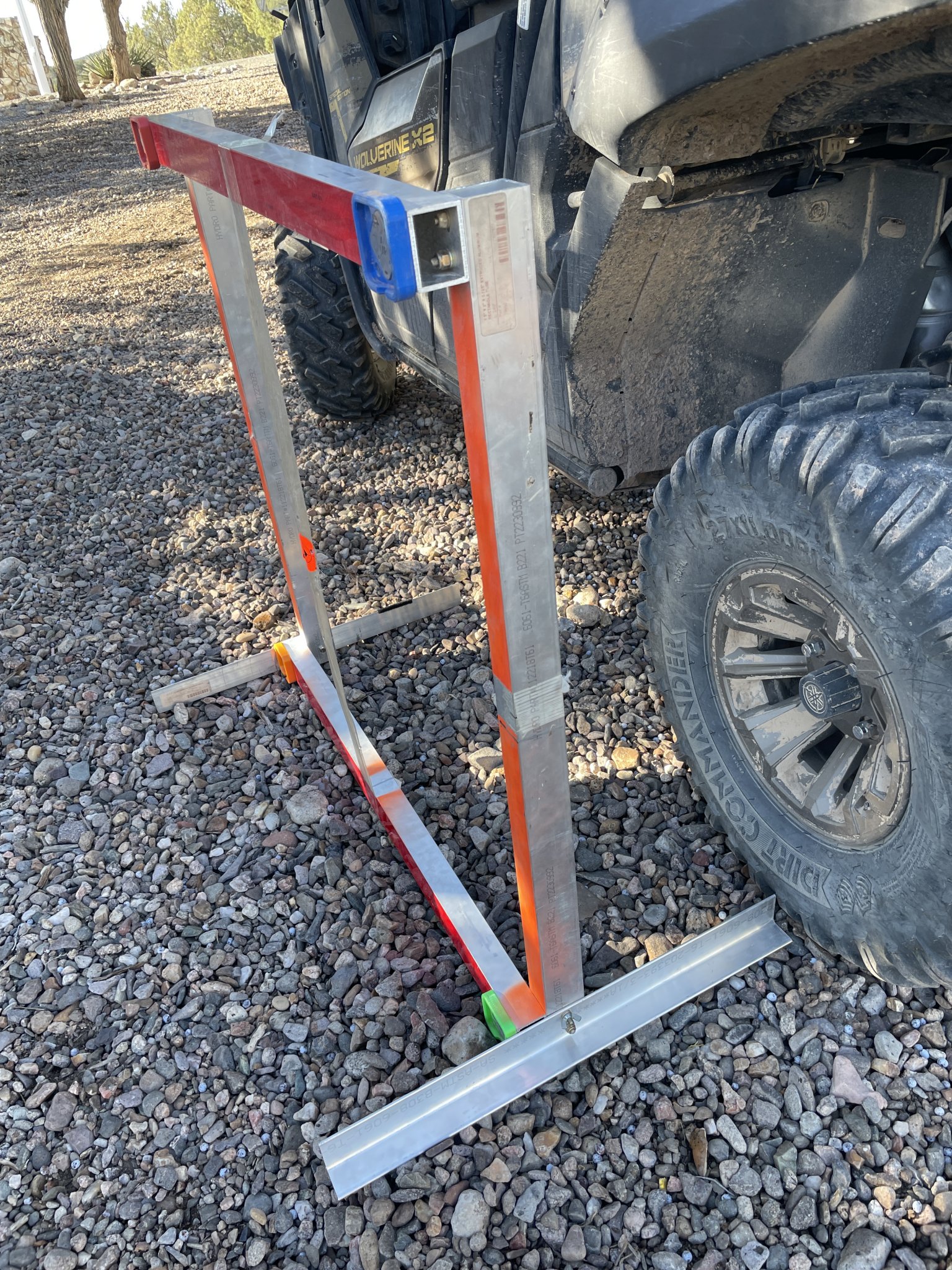

I wanted a large frame and wanted it a bit more portable. I cut and machined the cross bars square on the ends and installed 1/4-20 thread inserts and drilled the verticals as a matched set. I use a 7/16 nut driver to assemble with the 4 bolts once I get there.
In the playing around mode now though and need to do some more testing. Thinking about ditching the plastic holders and just sticking the sensors directly to the steel frame, I made some weld on tabs that I drilled and tapped for 8-32 screws for the mounting brackets but then thought a 1/4” section of 2.5” box tube welded to the frame would do the same job as the 3d Printed holders with better ability to be kept out in the elements.

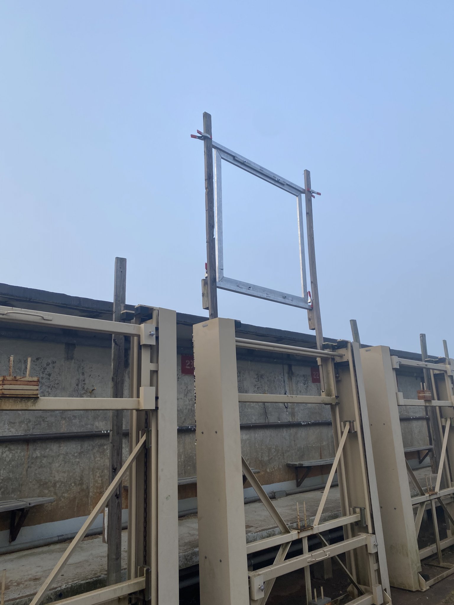

I’ve been fortunate to be able to shoot on Quantico’s 1000 yard Range 4 nearly every weekend for the last 20 years or so.
A couple of guys I shoot with have been Shot Markers for the last year so I figured I’d forgo my usual 25x15 IPSIC steel target and get one of the systems.

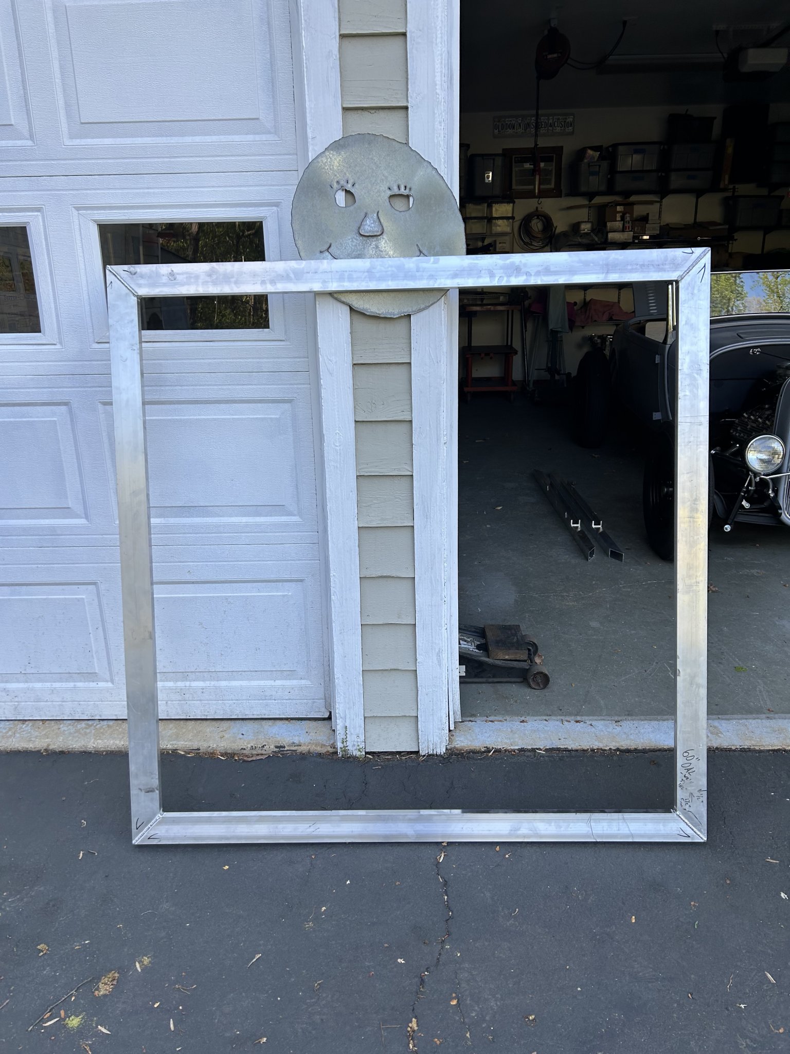

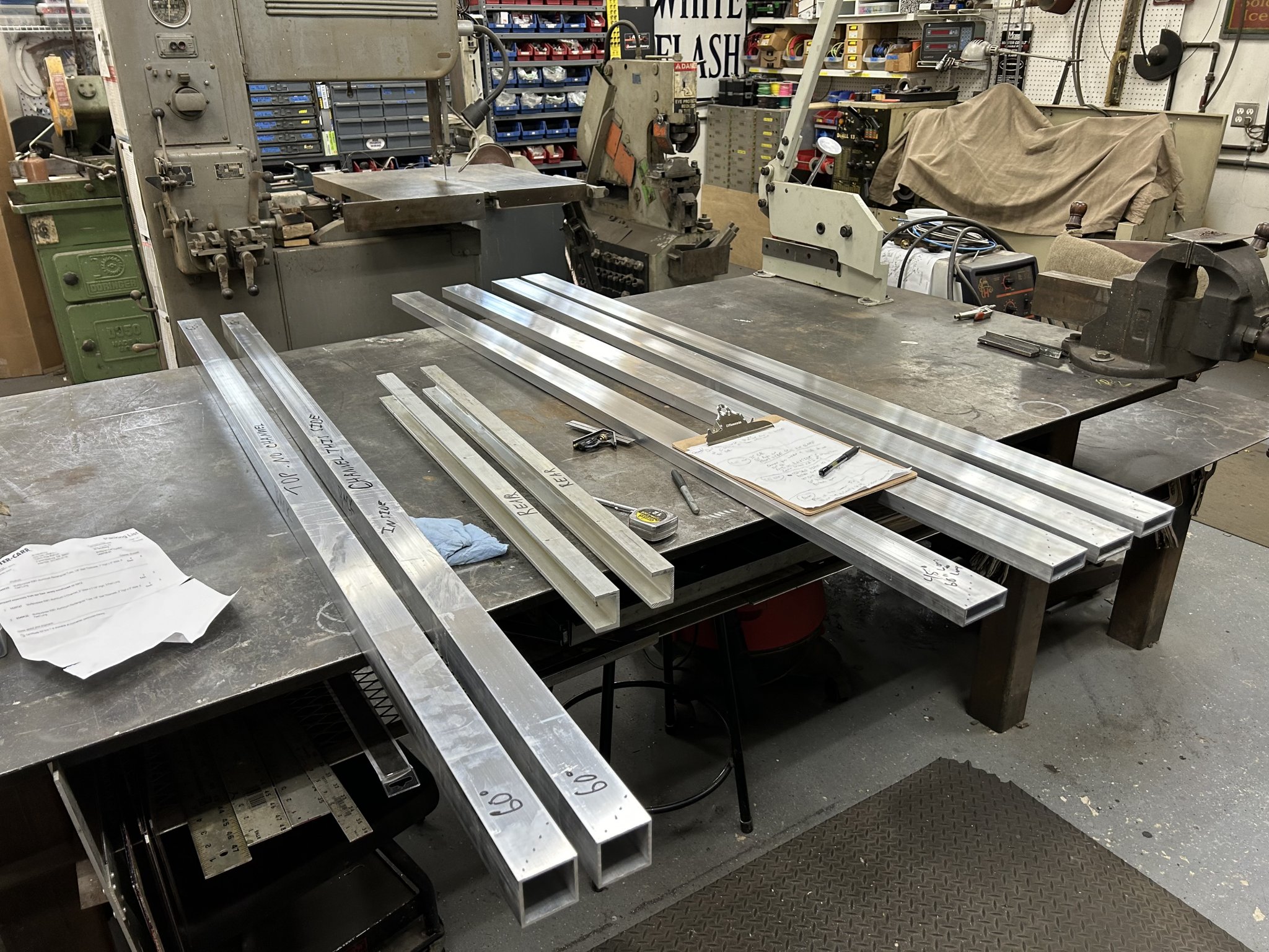

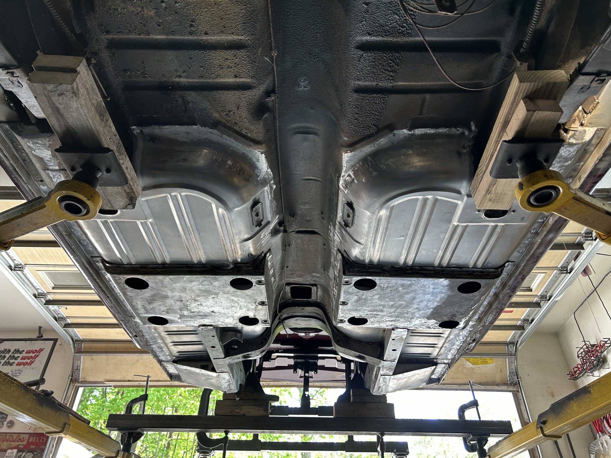

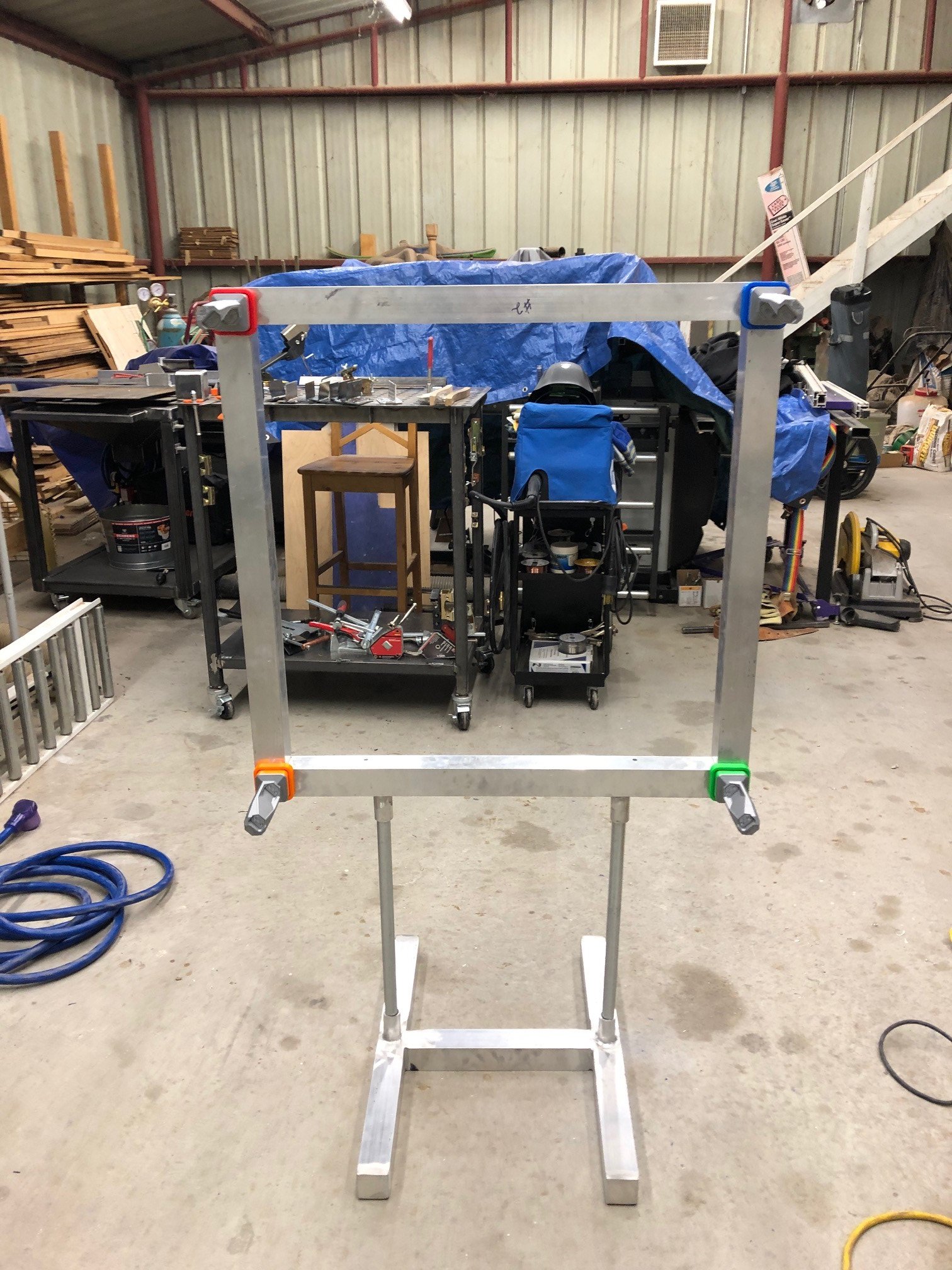

After ordering a Shot Marker last February I had a bunch of aluminum delivered to my metal fabricator/hot rod guru buddy and gave him a primitive drawing so he could assemble a frame for me that would fit one of the target carriages on the range.
He began to assemble the fame when he got to a stopping point on the 69
Shelby convertible he was working on…
During assembly he said the frame was the flattest, squarest thing he’d ever made. He couldn’t wait to start welding on it and warp it….

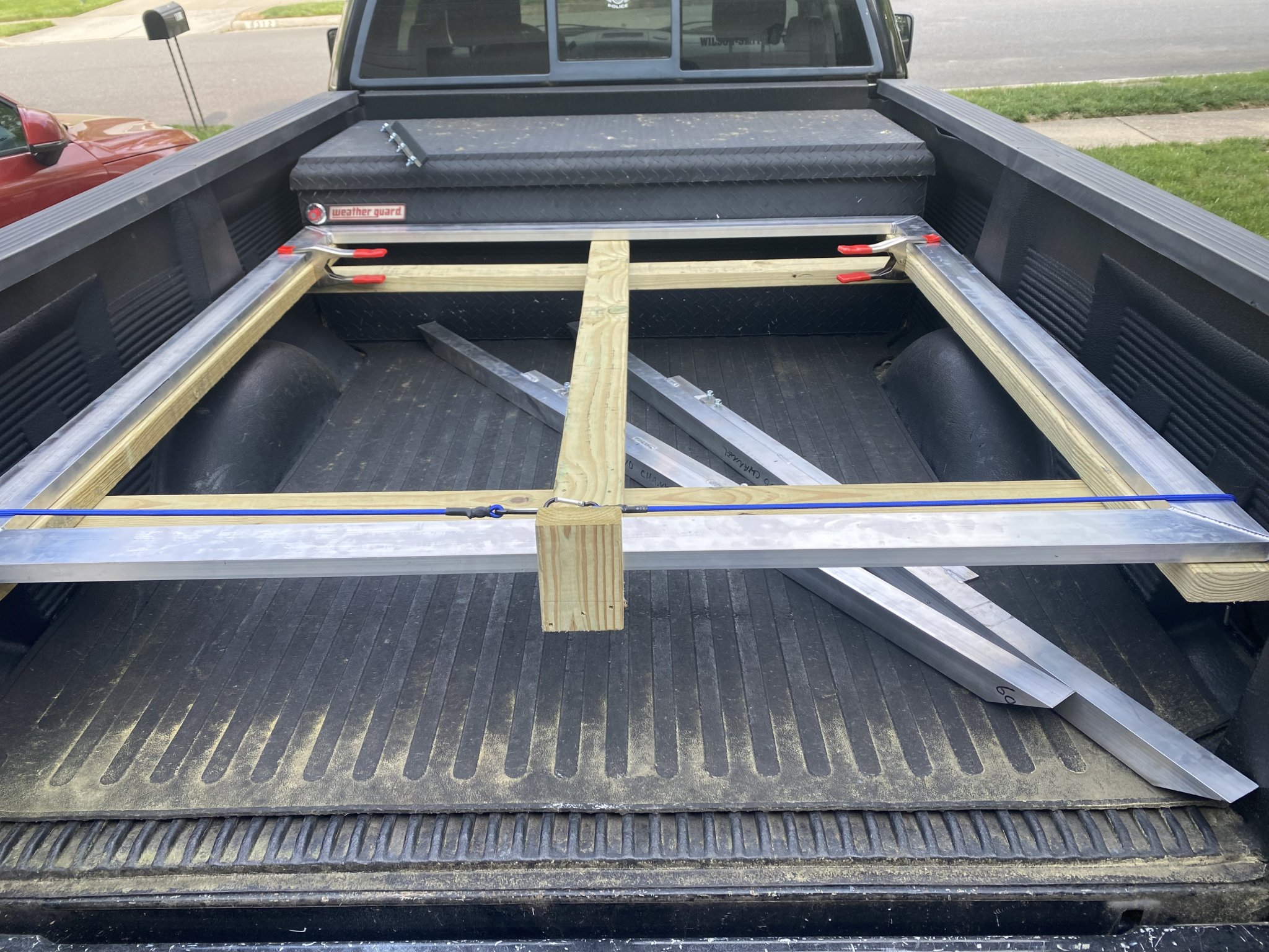

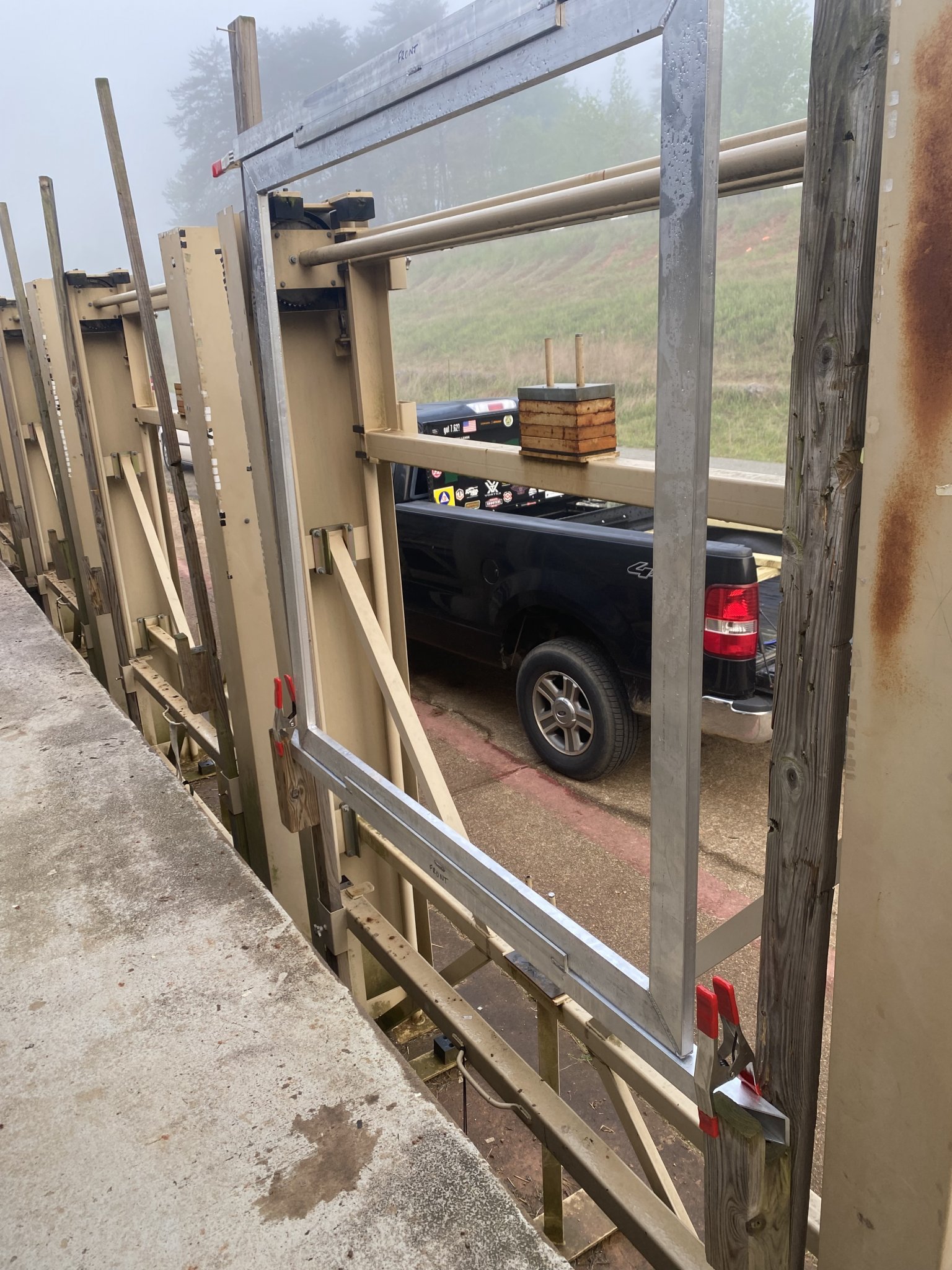

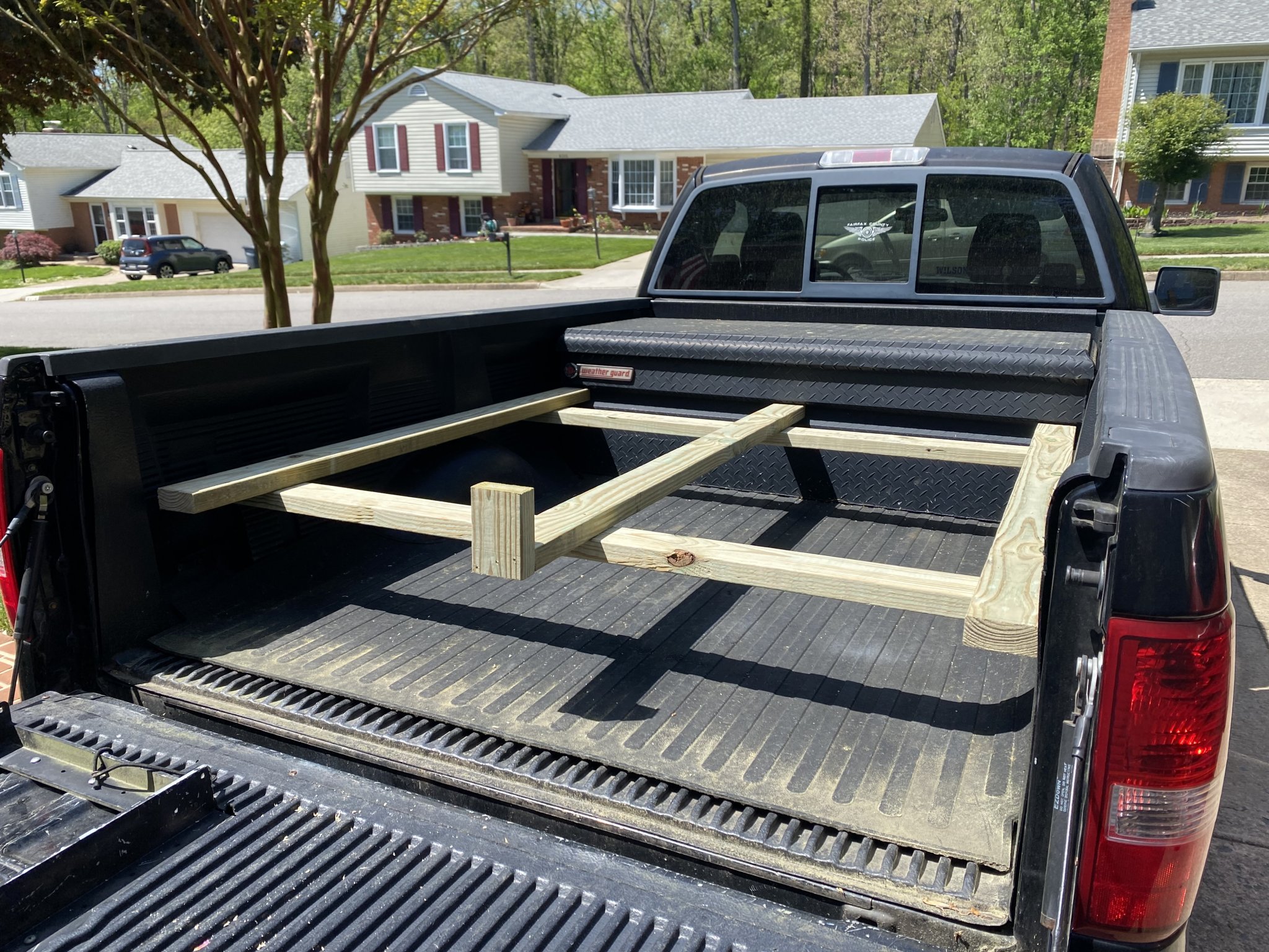

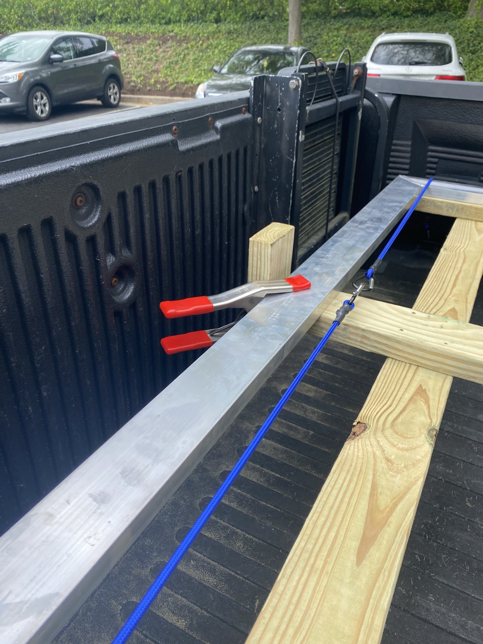

When he finished it, I had to figure out a way to transport it, so I built a rack for the bed of my beat up F150.

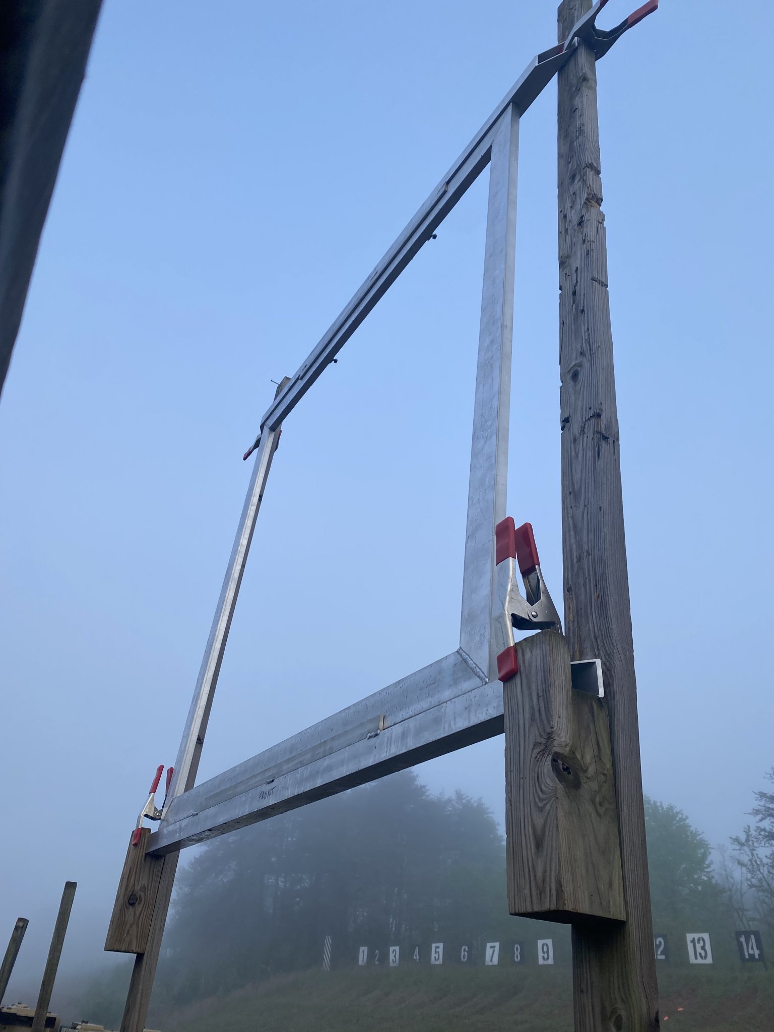

I took the frame and mounts to the range to test proof of concept. It worked!

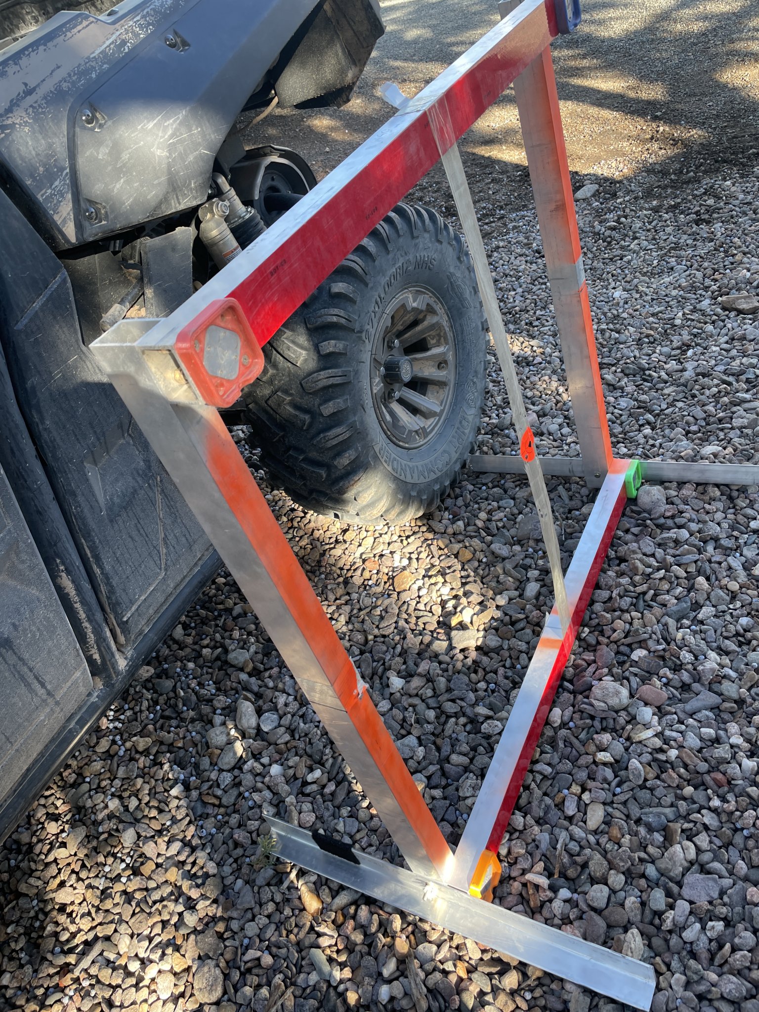

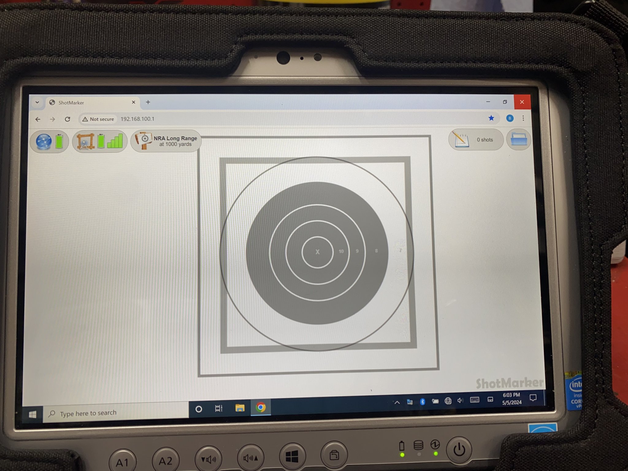

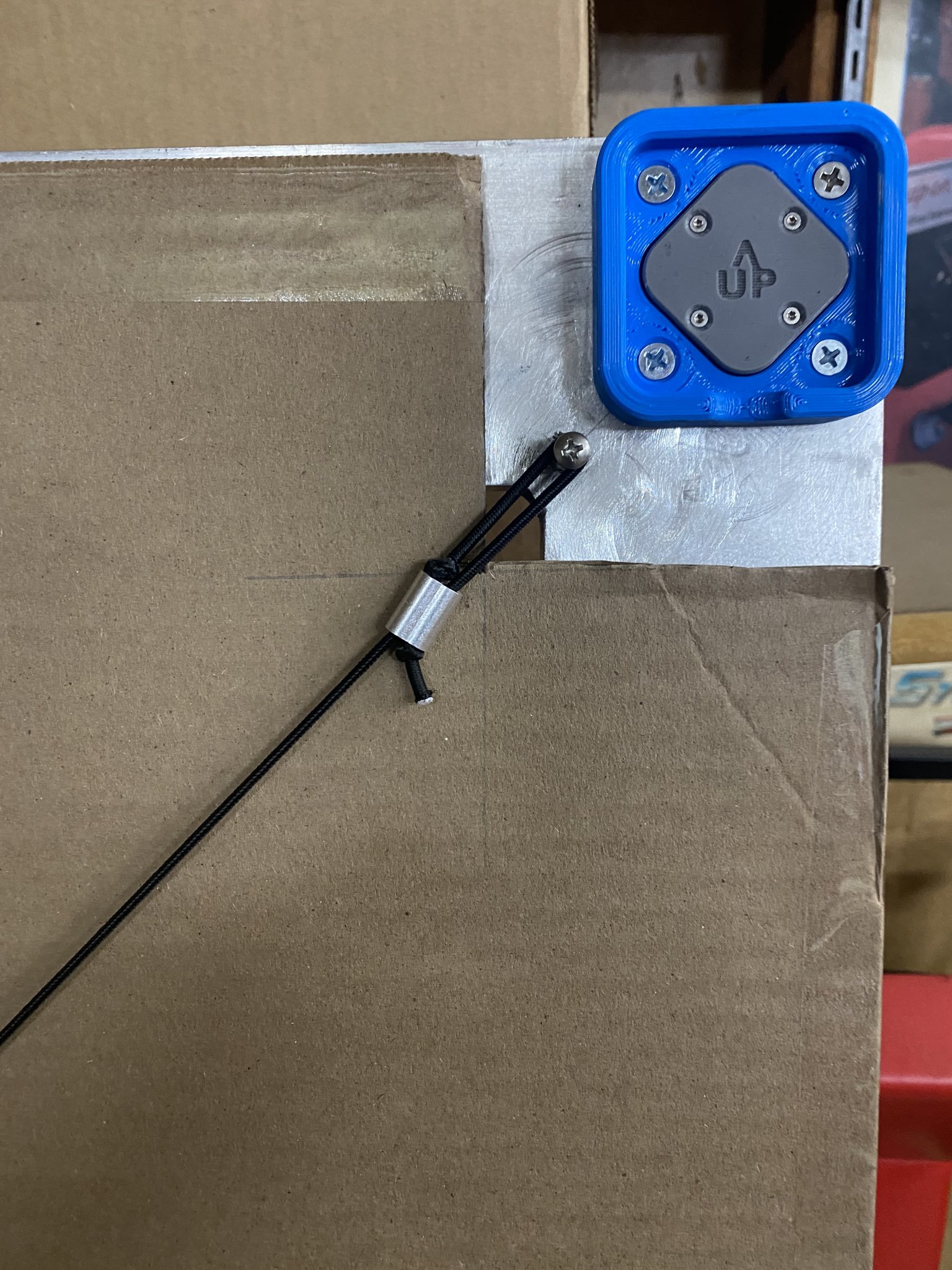

The Shot Marker arrived week before last and I began assembling the sensor mounts, etc.

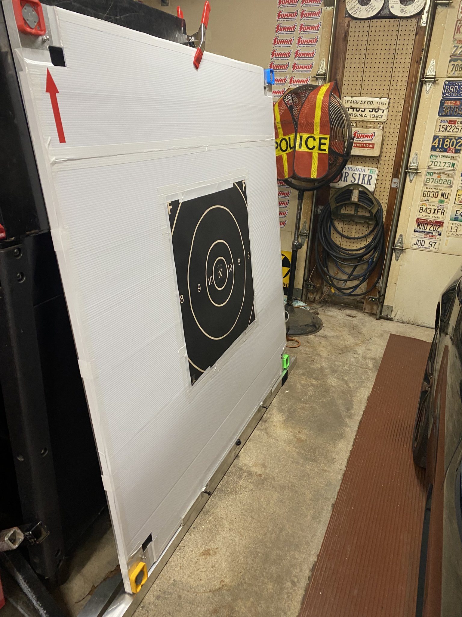

Believe it or not, you can get five sheets of 60x60 inch cardboard for $52 shipped. A free wooden pallet is included.

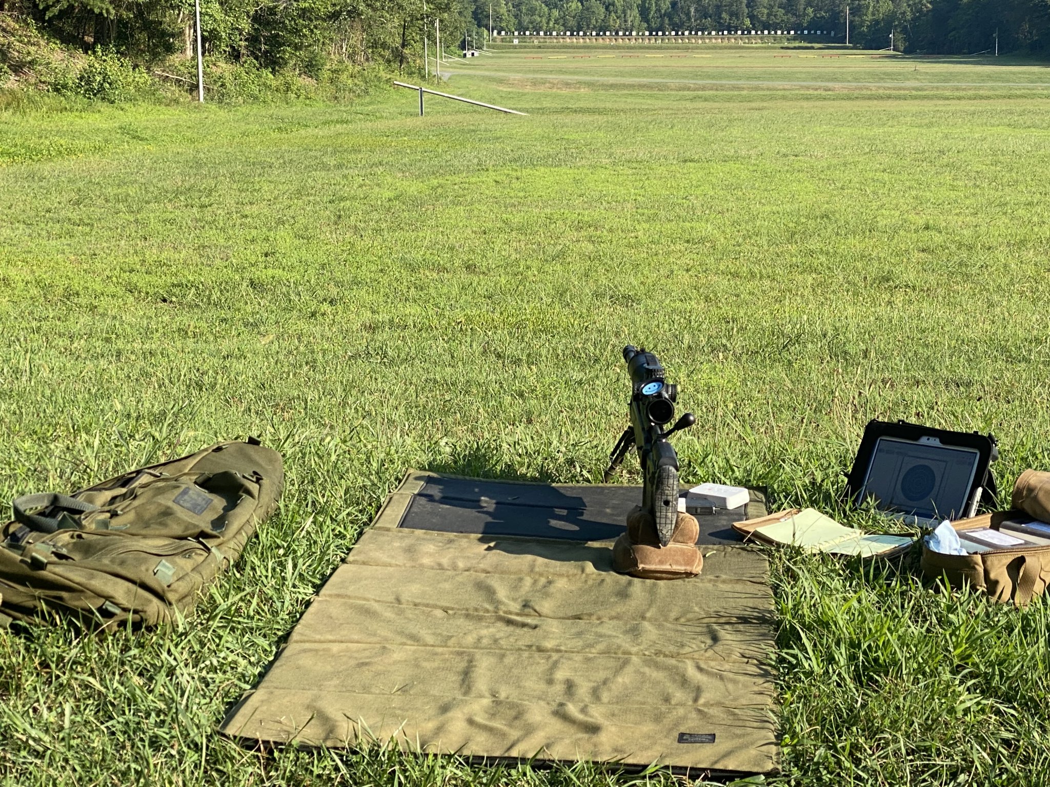

This past Wednesday i calibrated the target @ 100 yards at the Northern Virginia Gun Club that’s 110 miles down and back I95 from my home.
The reason I mention the distance is because although the calibration was a complete success, the adhesive on the packing tape I used to attach the backer to the frame failed about 10 minutes after I left the range….the hot sun melted it and the backer ended up folded over my tailgate @ 65mph….
I hit Home Depot and got a 4x8 foot sheet of corplast and some white duct tape.

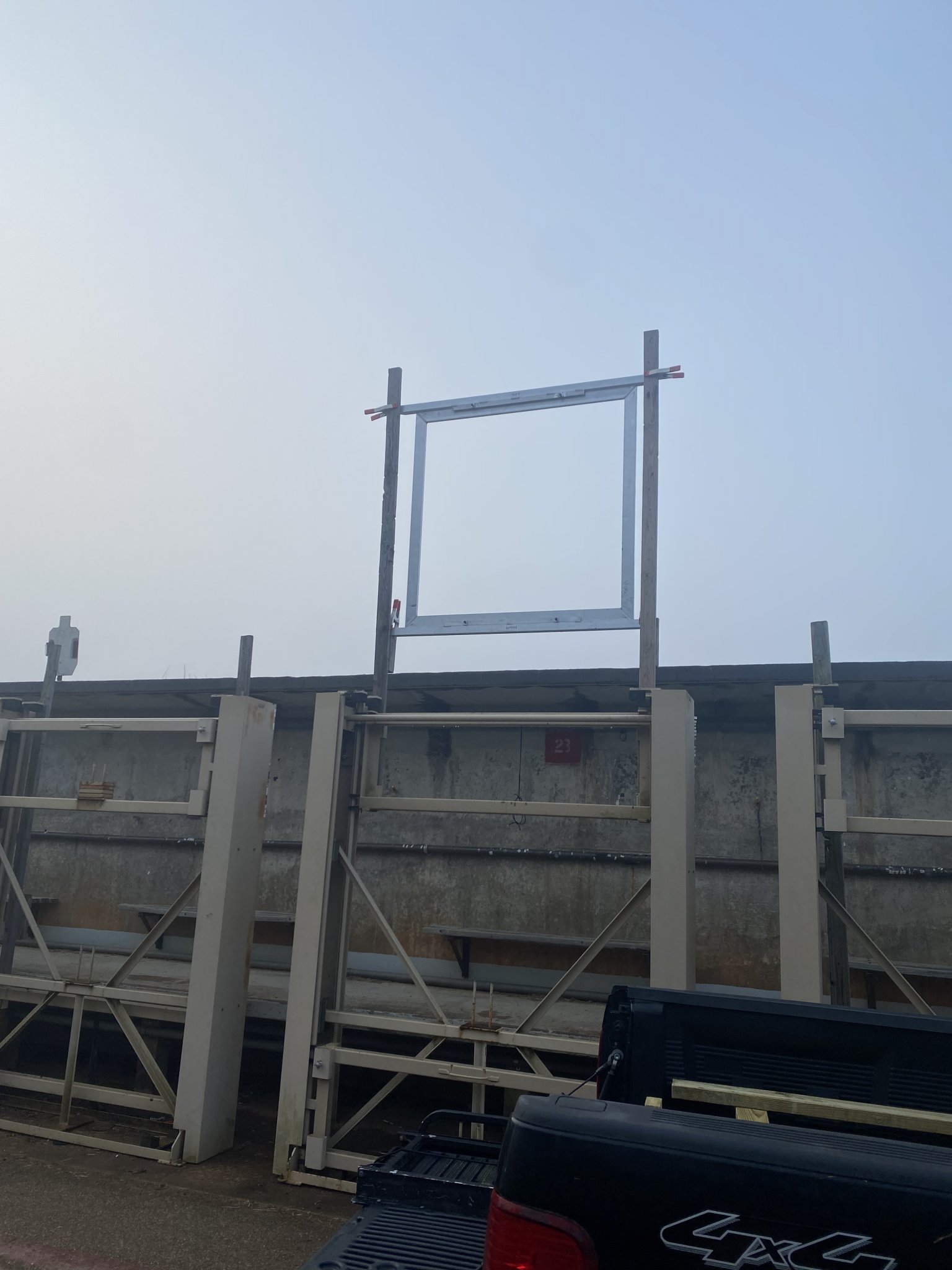

I was all set to RSO and shoot my target on Range 4 tomorrow when the Marines needed the range at the last minute and canceled us.
Maybe next weekend…
Spent a lot of time in those pits...
Looks like a good build. FZ-G1 is a great choice for the interface. Nice and bright even in full sun.
Only concern is a rather obscure rule from a few years back about metallic targets downrange needing to be Hardened steel. Pretty sure that rule came out of S3 rather than QSC. It was the result of injuries from ricochets off mild steel targets though and shouldn't logically apply to an aluminum frame but you might want to clear it ahead of time unless you think begging forgiveness is a better way to go. If so, just paint it coyote tan so it looks like wood at a glance.
-Alex
-Alex

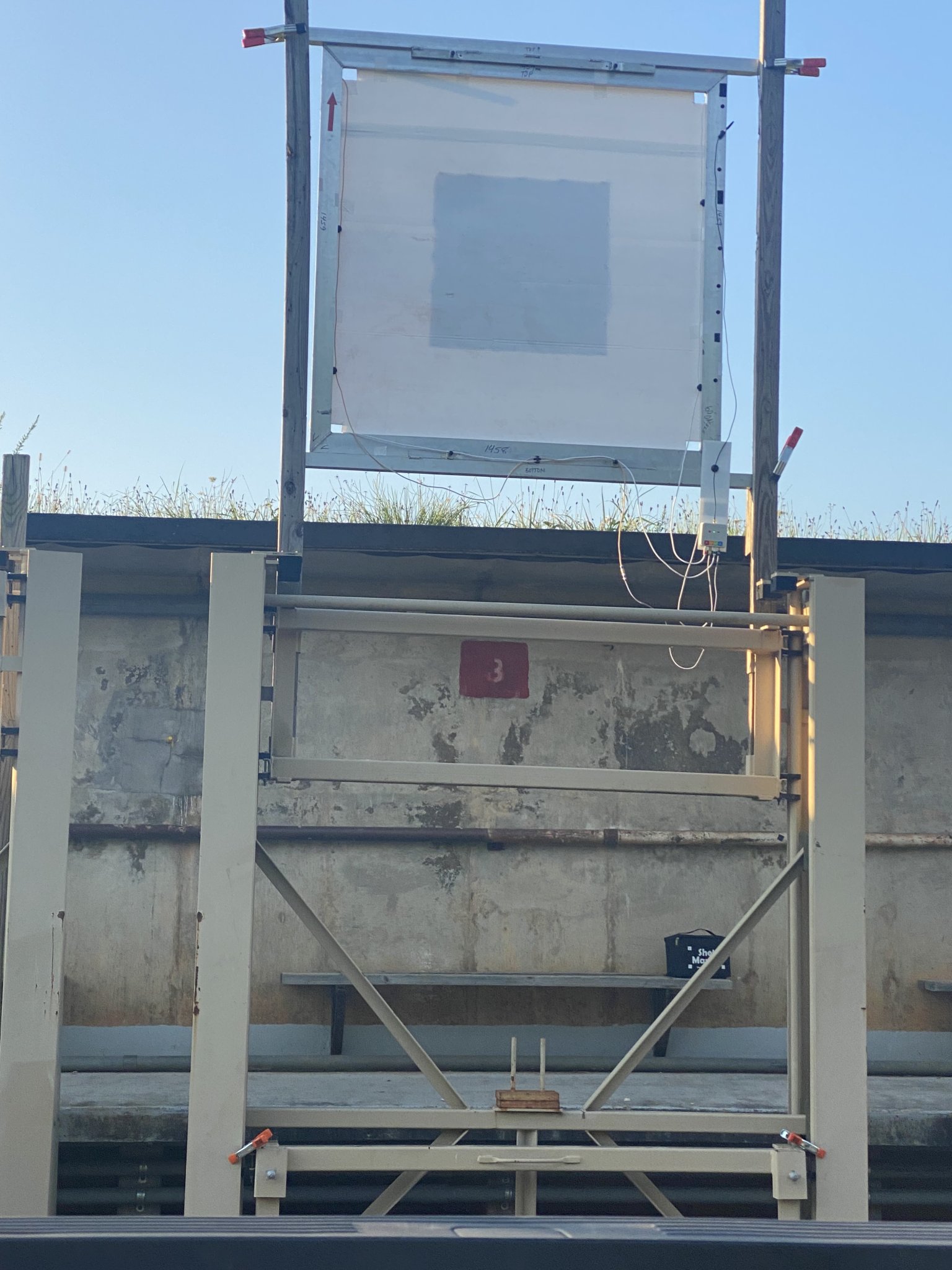

For three months, there was a complete Shot Marker system mounted in a wooden target frame, sans the access point (receiver), with all the sensors, cables and the sensor hub, leaning against the wall under the overhang at position 25 of Range 4, like they were weather testing it. Then it was gone.
Saw a white board in the RC conference room with “Calvin Lloyd Complex Improvements ” listed as number three…
When I asked what the improvements were, I was told “ We’re only responsible for the ranges and the RSO’s , not capitol improvements. I read that as “Don’t ask.”
Reactions: Defender3

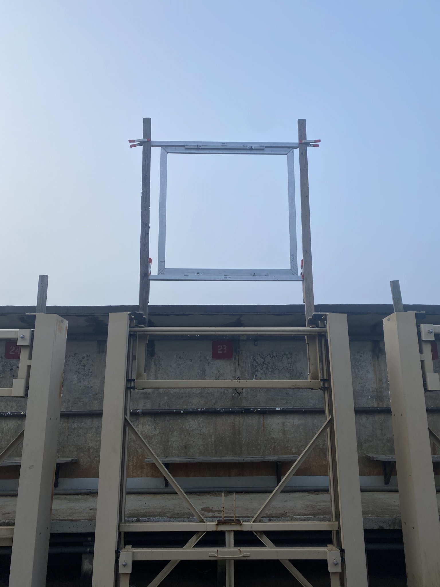

After two months of improvements on the Calvin Lloyd complex, we were finally able to open Range 4 and I got a chance to try out my new Shot Market target system.
I’ve gotta say all the waiting was worth it. I’ll never shoot steel again on Range 4 again. Apologies to @Fixr whose spot on the range I swiped while he’s on vacation.
