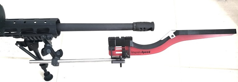

    I was not happy with the bench rest (caldwell the Rock) I used for this chrono data, not as stable as I expected. I do not know if the poor groups are a result of the chrono, the rest, or me in this setup, could be a combination of all three I am sure.
    I then moved back to my atlas bi-pod, and rear bag on the bench with the chrono removed and shot 3 groups (top 3) of the Hornady 140g, and 2 groups (bottom 2) of the S&B.
    I agree and maybe its just me but when I use my Mag Sporter barrel mount chrono my groups open up. So when I load develop now I don't use the chrono on when I am checking grouping. I have mashed together a few load dev techniques into one. I only shoot with it on to gather intial data to see if I am going to pursue a load....then at the end when I have it grouping right to verify velocity etc. Makes me a happier man.
    Using a magnetospeed ALWAYS jacks with my groups. It's beautiful for muzzle velocity data, not for groups.
    Reactions: seansmd

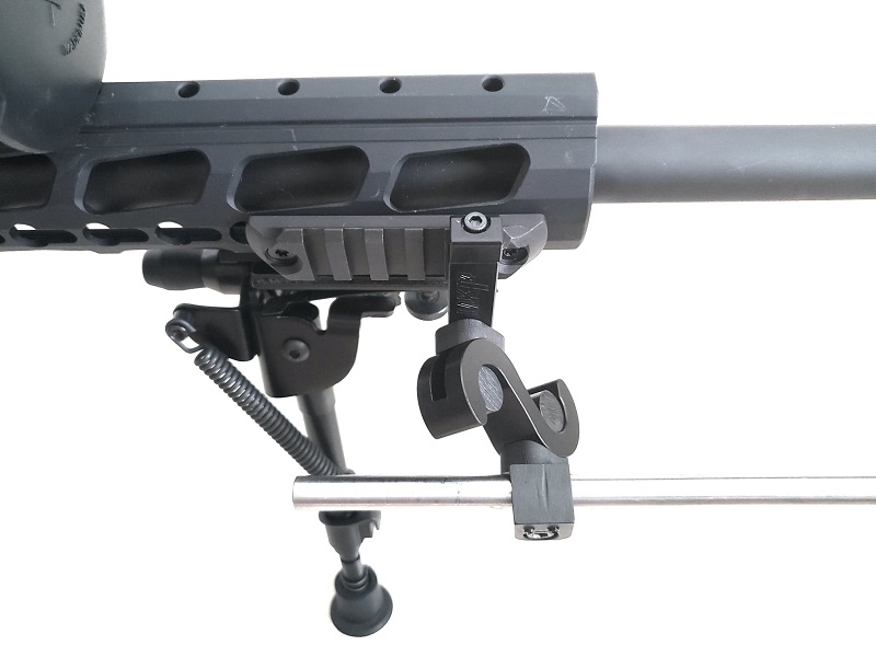

    Not touching the barrel at all... mounted from a pic rail on the handguard. There are two mounts that I'm aware of... One from MK Machining. The other from Wiser Precision (?). I have the MKM.
    Interesting, and you don't see a spread using this mounting option?
    I wasn't sure if the spread was the barrel harmonics or the MS in the path of the gasses and bullet exiting the barrel.
    There is definitely an effect on barrel harmonics (with SOME rifles) when it's attached to the barrel. There is no debate about that. Whether the presence of the bayonet has an effect on gasses and shockwaves leading to a change in groups is subject to debate.
    I have not seen a spreading of the groups with this off-barrel mount. I'd have to do more testing to determine if there is a change in POI. Again, it's difficult to nail down if the change is ME or the gear. So, it would take a large sample size to determine a trend. I just haven't committed to testing it myself. The guys at MKM say they've tested it and found no change.
