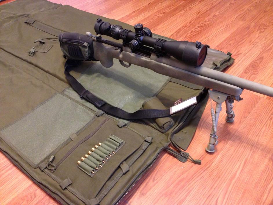

Just wanted to post a pic of my rifle that I just put together using same barrel.
B&C M40 Stock
Rem. LA
AAC 260 Rem. Barrel
Weaver 20 MOA base and Weaver 6 hole Tactical rings
Millet TRS 1 4-16x50 MIL/MIL
Condor Drag Bag/Shooting Mat
