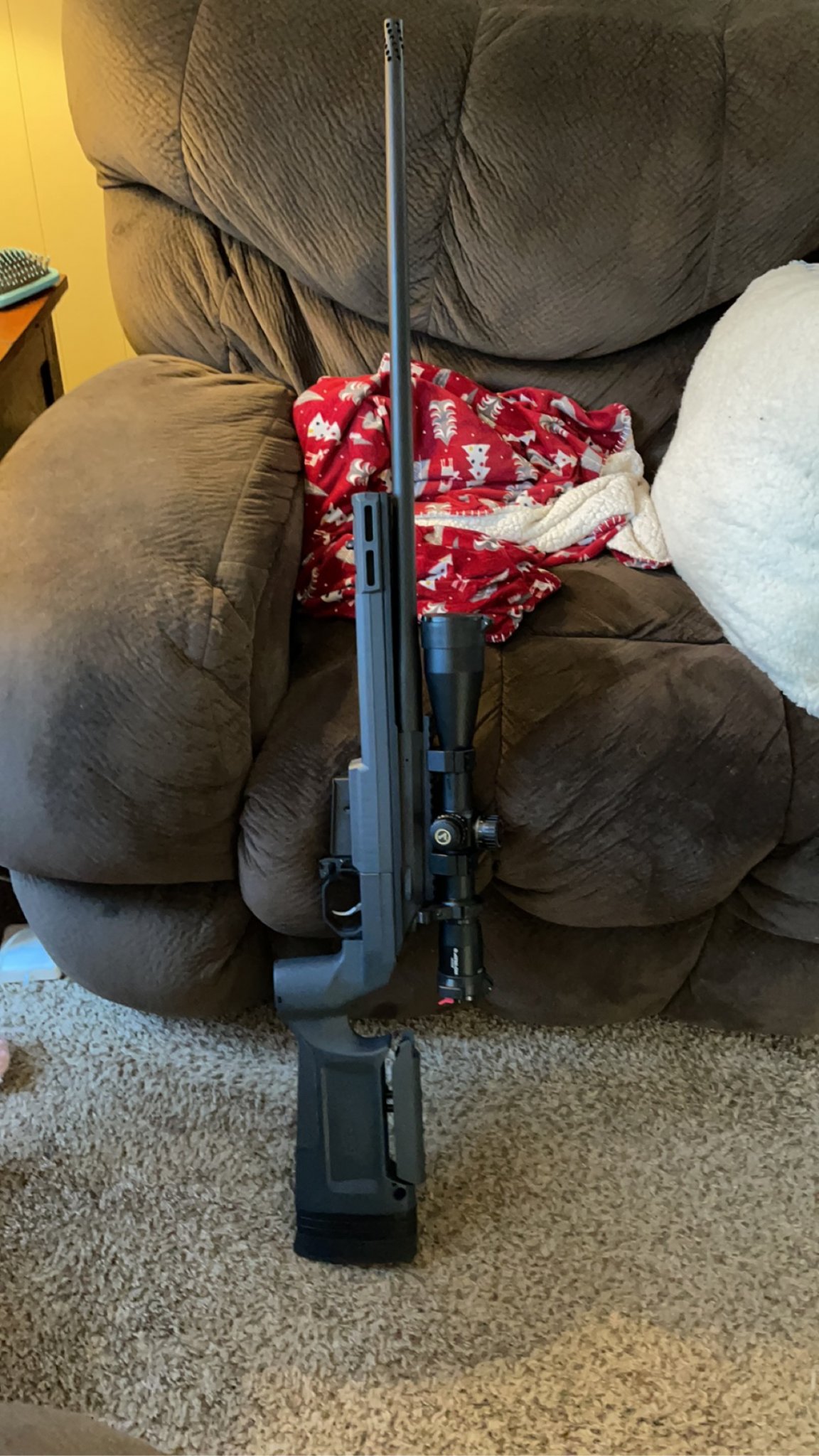

Sorry for the crap picture but here is my new setup. Haven’t shot it yet. Just had in bore sighted. But will be throwing factory federal terminal ascent 200gr rounds down range. This is my hunting/distance rig. Will be shooting 700 yards. Might try 1000 if I can find a spot.
tikka t3 300wsm
Rock creek #4 sporter 1:10 5r barrel (installed by Pederson precision)
Krg bravo chassis
Athlon ares btr gen2 4.5-27x50
Vortex precision rings
Reactions: eder

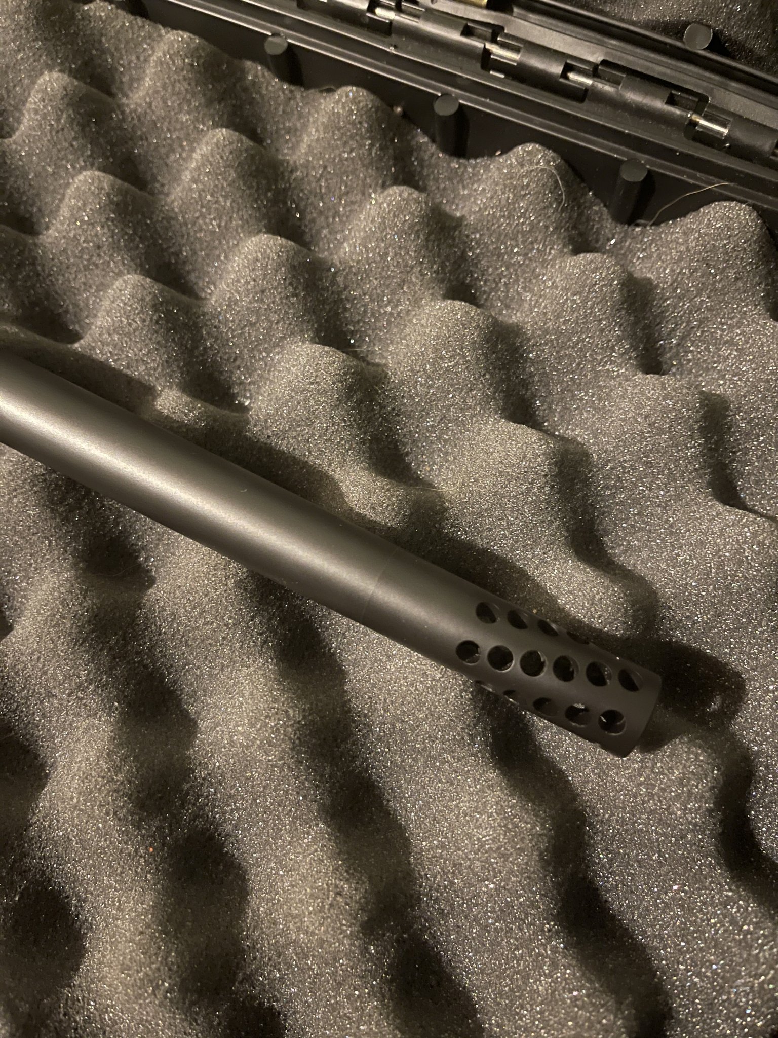

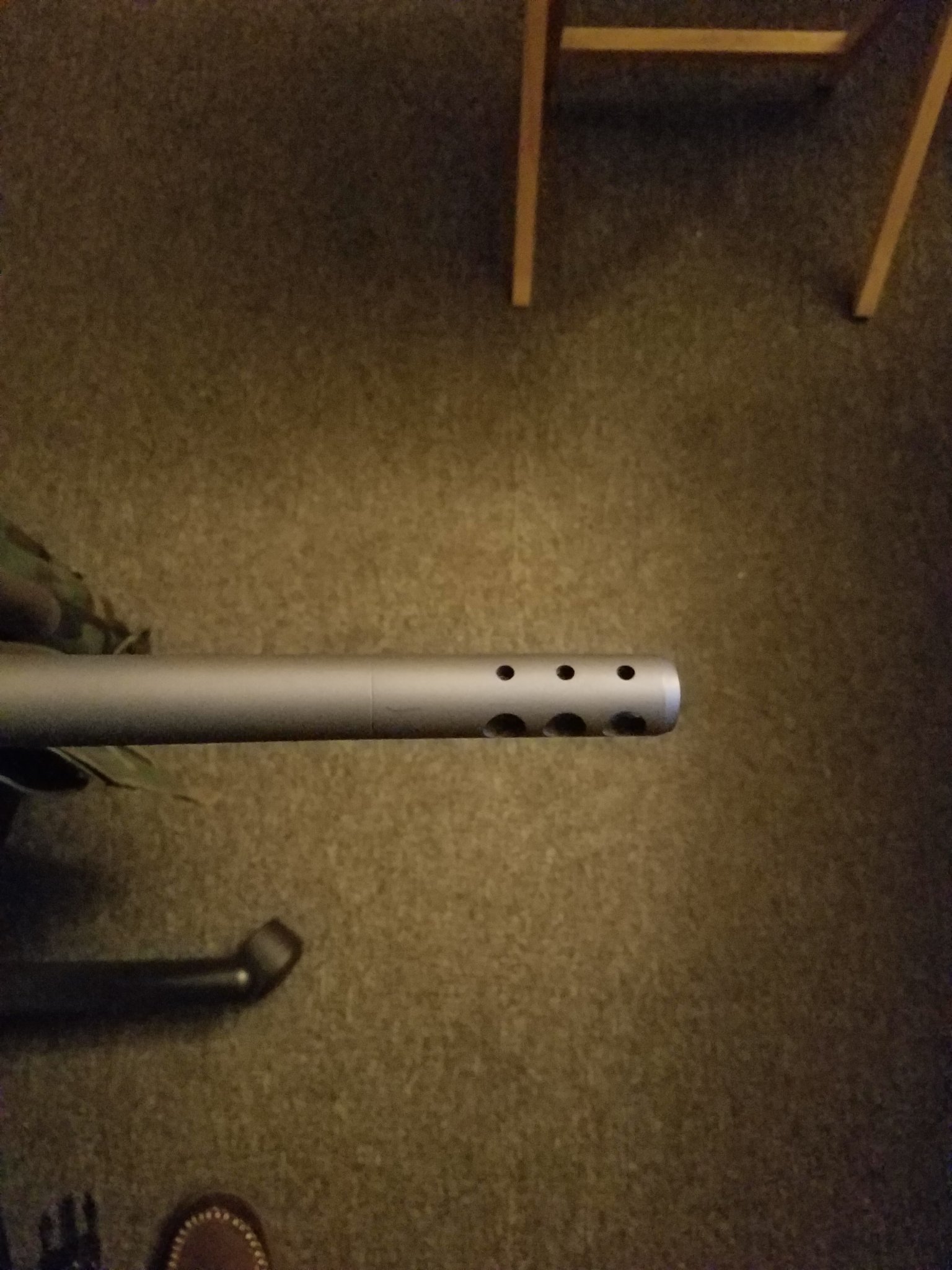

Very nice work! Similar to a rifle I built last year, a 7mm-08 on a Mauser action. I made the brake to match the barrel taper, then Cerakote.
It looks like old school shotgun barrel porting rather than a muzzle brake.
tikka t3 300wsm
Krg bravo chassis

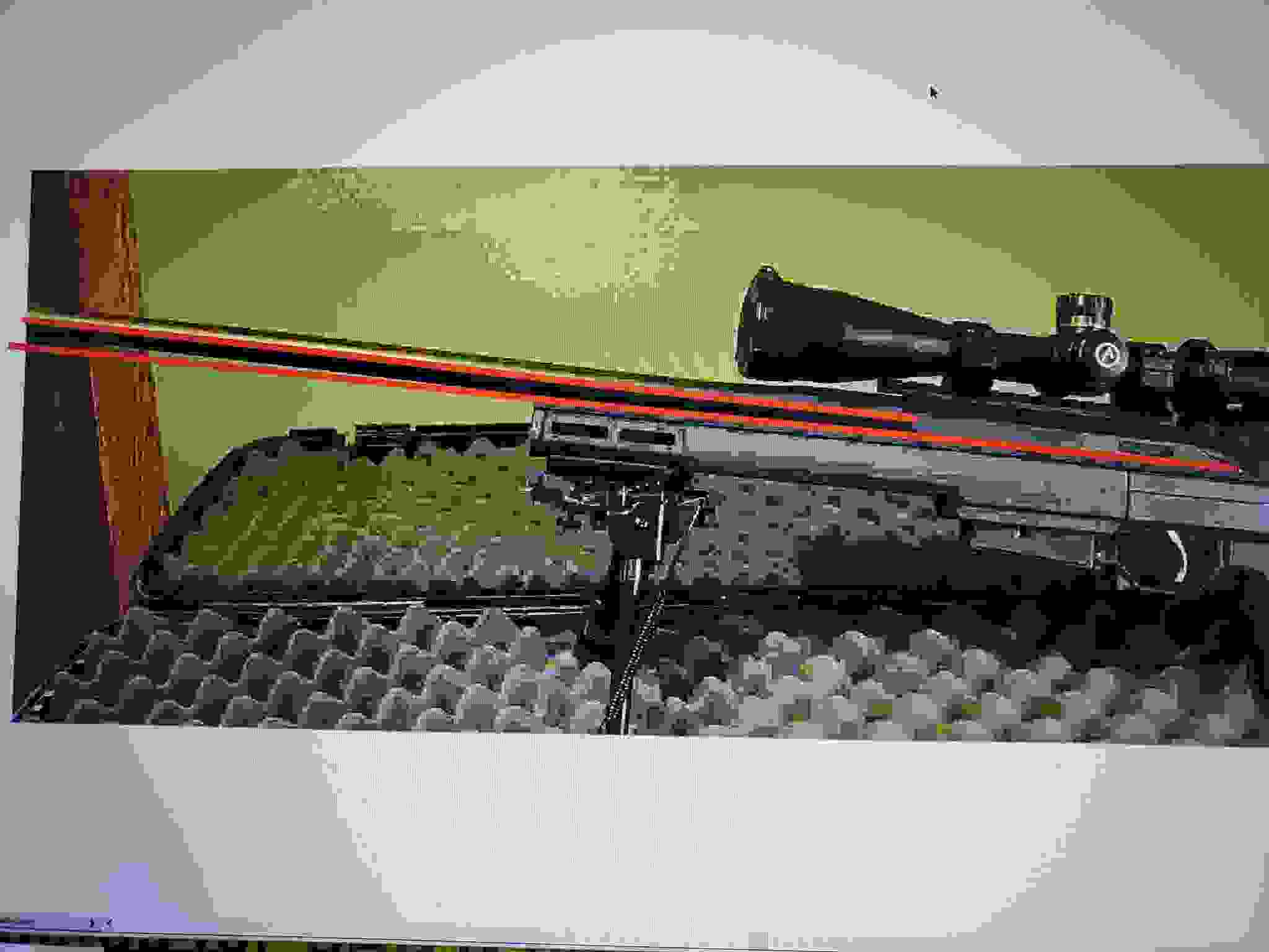

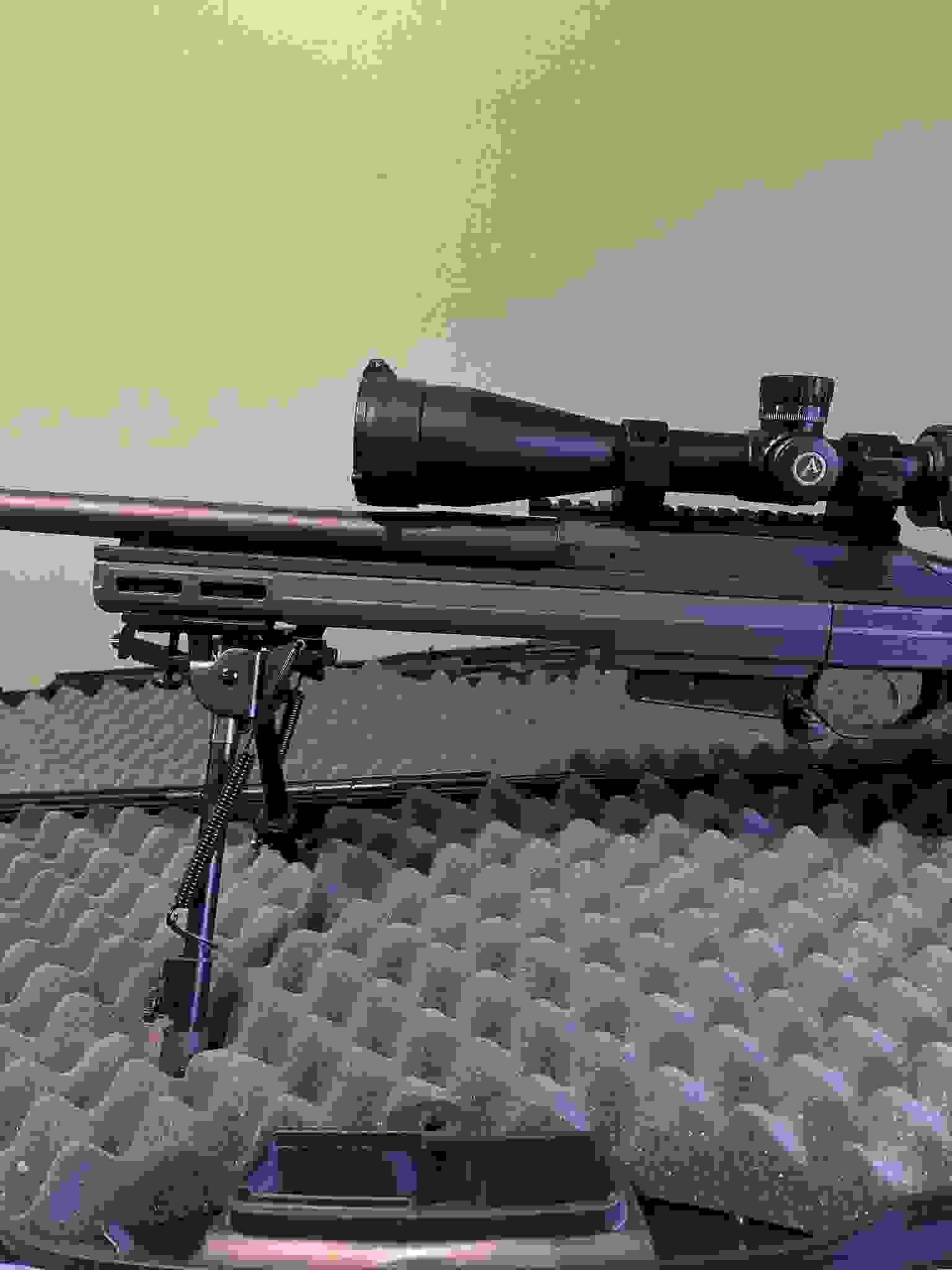

you need to reinstall your barrelled action. It’s not sitting in the recoil lug
This is what it looks like on all of the rifle I. The bravo stock. I don’t have a super Harvey barrel.
also I don’t know how you ca tell it’s not on the recoil lug my just looking at the original picture
I just double checked. Reinstalled per the instructions. Rifle verticals pull down to make sure it’s against the lug. And it didn’t budge.
so how can you tell from a picture that far away it wasn’t against the lug?
the action doesnt look parallel to the chassis to me either
as if the slot in the action is sitting on top of the lug that's in the chassis.
