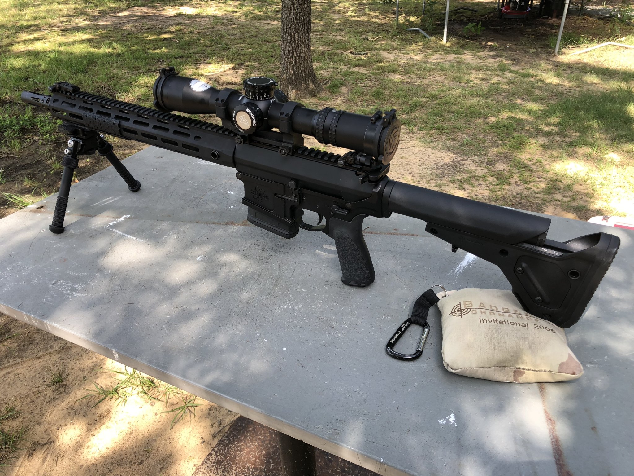

    I’ve been struggling with finding the right bullet/ powder combination since I received it. Last weekend I loaded 155 AMAX, 155 SMK, 168 AMAX, 168 SMK, 178 AMAX and 175 SMK. Along with all that, I shot factory Hornady 155 Tap and the best I could get was about 1.5 MOA.
    As it turns out, I just needed a little more control of the recoil impulse!
    The MAMS did the trick. Now just about everything I feed it is at or below MOA.
    Reactions: RTH1800 and KZP
    I’m running the upper on one of my Mega Maten lowers with a Geissele SSA-E until the LMT MARS-H arrives later this week.

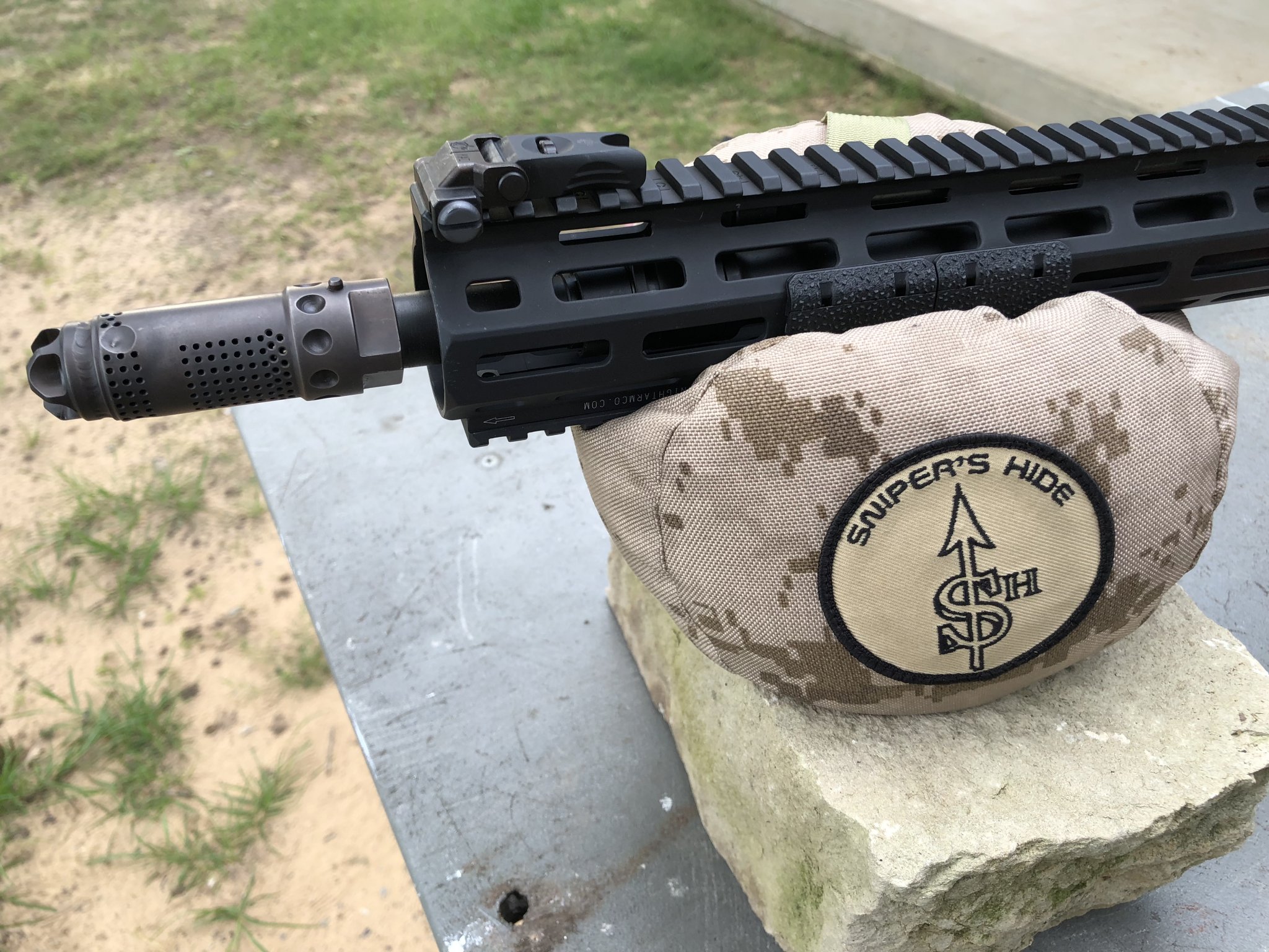

    Perhaps the previous muzzle device was torqued on too tight? Interesting that simply changing the muzzle device made such a difference.
    I took a flash hider off and installed a brake. Huge difference in recoil reduction.
    No argument on recoil reduction. What I was speculating about was whether the previous muzzle device was torqued on too tightly and having some effect on the barrel. Seems to me that recoil (or lack thereof) on a .308 shouldn't make much difference on precision unless you are shooting fast...which you should not be doing if you are trying to determine ultimate precision of your rig.
    How is it shooting? If shooting well, than zero to worry about.
    I realize but started reading up on over tightened devices after you mentioned it. I’m sure I’m no where near damaging the barrel but with the rockset, it’s pretty permanent at this point. LOL
    I should have used the next thinnest washer to make removing for cleaning easier.
    Tracking. Let the end of your barrel sit in boiling water for 10-15 minutes. You will get that muzzle device off pretty easily.
    I just did it last weekend. When my kids walked in and saw my Noveske upper sitting barrel down on the stove in a pot of boiling water, they both looked at me like "Daddy...WTF, over?"
    Reactions: DRAM40A1
    That may well be but I can shoot mine more accurately with the MAMS and less recoil.
    If shooting more stationary targets at a distance then the FH is more accurate according to Jack, and I'd trust this information given what he does for a living with KAC and after having a taken a class from him.
    That said, I run a MAMS on my ACC because I prefer the trade-off of being able to put more rounds on target at a faster and more consistent rate without giving up much in the way of medium/long range accuracy.
