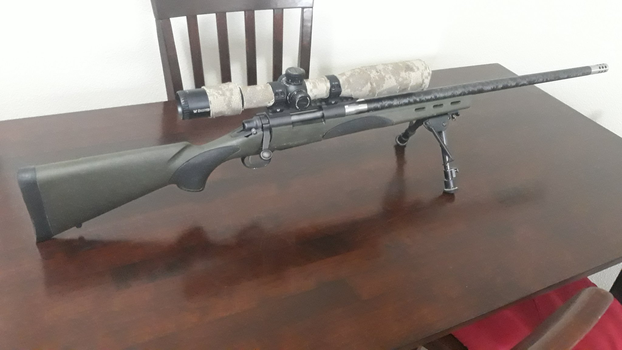

had this VTR since they originally came out so a long time, and it never shot. tried everything i could think of, i finally put a new barrel on it and Im super stoked to be done with the original.
.308
26 inch 1:10 twist carbon six barrel
carbon six brake
jewel trigger
floated and bedded
vortex diamondback tactical in vortex pro low rings
i had an old shitty sight mark scope on it that broke last year and decided the rifle was only worth putting on the diamond back tactical but now with the new barrel i may have to upgrade glass again.

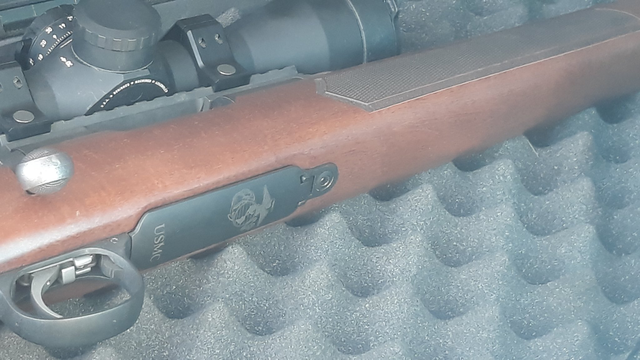

also looking at putting a wood stock on it, anyone have experience with the stockys monte carlo? looks like it could be the ticket. https://www.stockysstocks.com/stock...lnut-stocks/stocky-sr-monte-carlo-deluxe.html

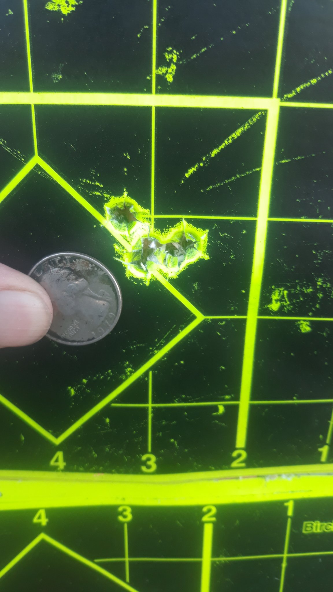

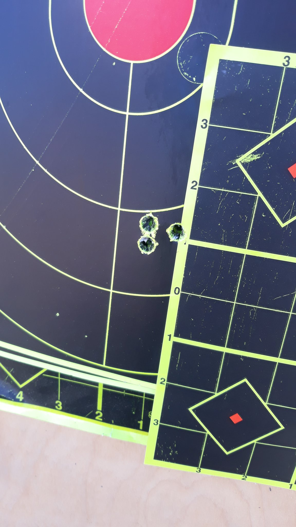

did the break in with mil 7.62 ammo so I could get a rough zero before i did a ladder test with some hand loads i was testing from the old barrel. I measured the lands on the new barrel and re seated them .030 off. was pretty impressed with the group with that ammo.
here is a group with the 7.62 ammo was really surprised with how well it shot that ammo

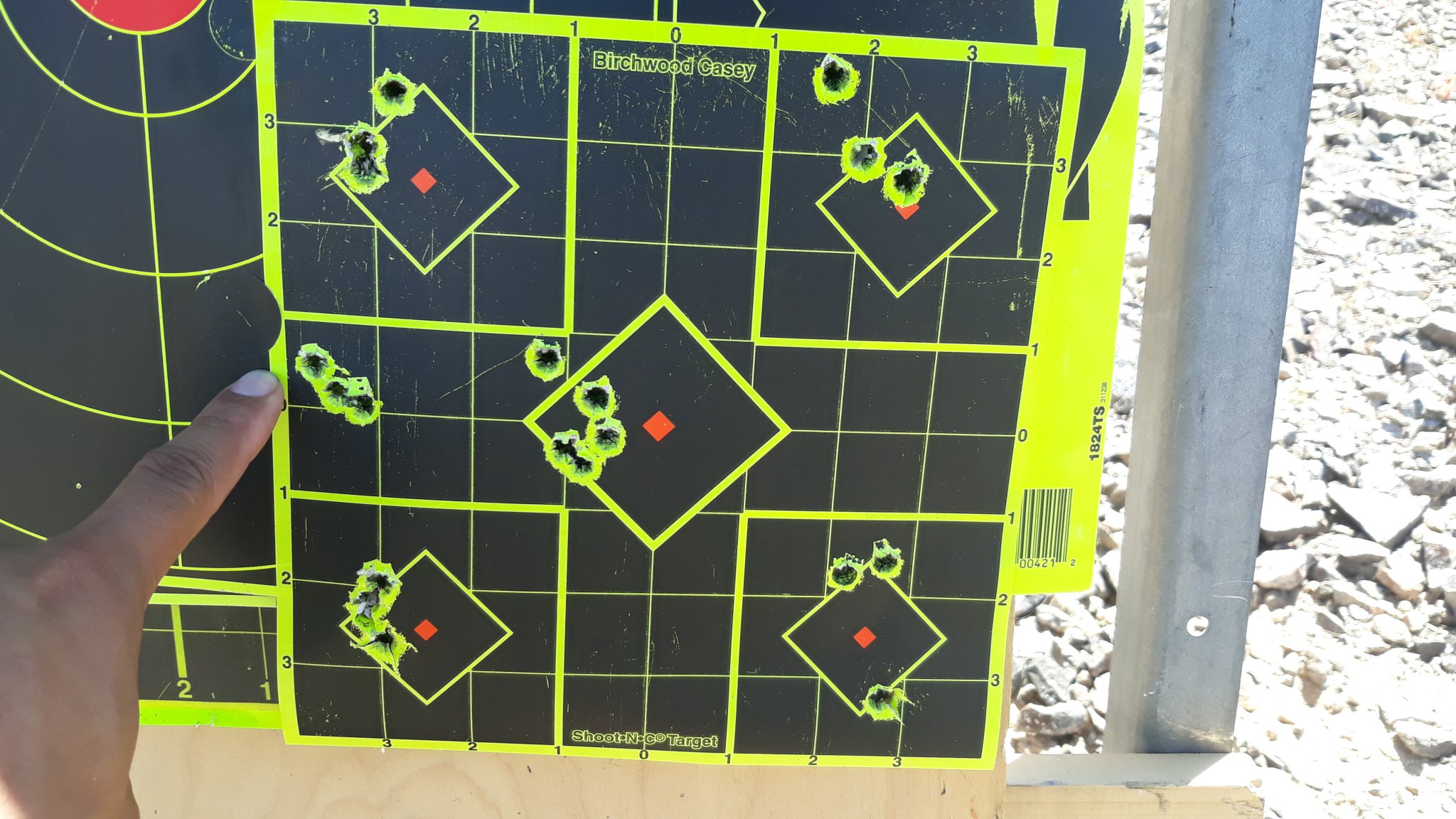

started the ladder test aiming at the top left aim point and ended up where my finger was 2 inches lower, was really surprised at the POI shift being that dramatic.
shooting order was
middle left
middle
bottom left
bottom right (heavy bolt lift started here)
top left
top right
.3 grain intervals, going to load some more of the first 3 groups and try to go down .6 as well. think i got lucky and found the upper node pretty quick.

Have you thought about a hs precision take off. You can pick them up for about half of the laminate your looking at. Glad you resurrected the ol girl.
im really wanting the classic wood look i was scoping out some custom stock builders and may end up getting one made, but i do like the bedding block that the stockys wood stocks offer though. looking for something that looks similar to the some of todd ramirez' builds without the 10k price tag.
I assumed that it was a laminate stock but I just looked and it’s solid. I can definitely understand what you see in it. Solid wood with aluminum bedding block for $400, you can’t beat that with a stick. The only problem I see is it’ll be to pretty to take out and shoot.
Reactions: dspjaggar
that will help me keep the round count down bc im already in love with this thing and once im done with load dev im sure it will make me like it more.
but ill def still take it out, i surprise people when they see how i use my other nice rifle. the desert can be harsh on equipment but i bought it to shoot not stare at.

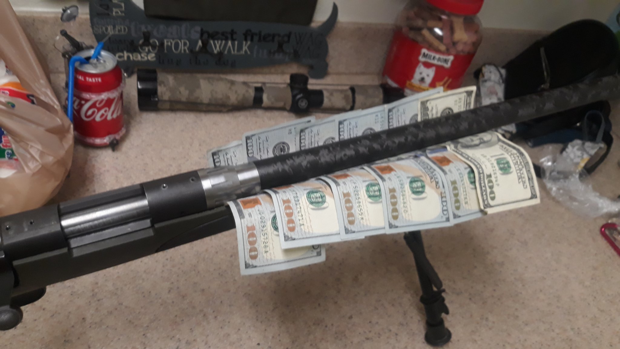

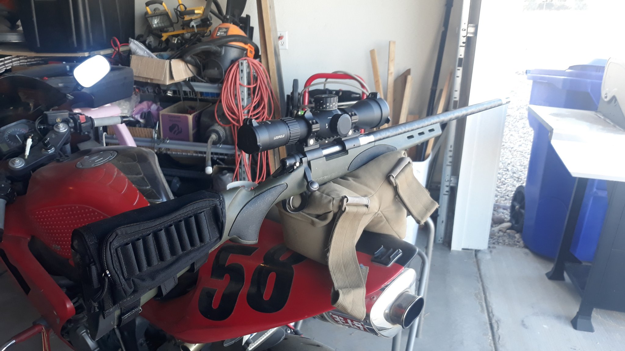

So this build has come along some more, I was asking to see floor plates that had been engraved and Mike from tac ops offered to help me out for free in the thread below.
Blew me away with how generous he was. Mike ended up giving me a bottom metal that was in far better condition along with some tac ops goodies.
Also got a leupold from the bass pro deal that we all capitalized on.
Just ordered a solid walnut stock from stockys and I'm almost on the fence with it, because this thing looks great.
Thank you so much @MikeRTacOps

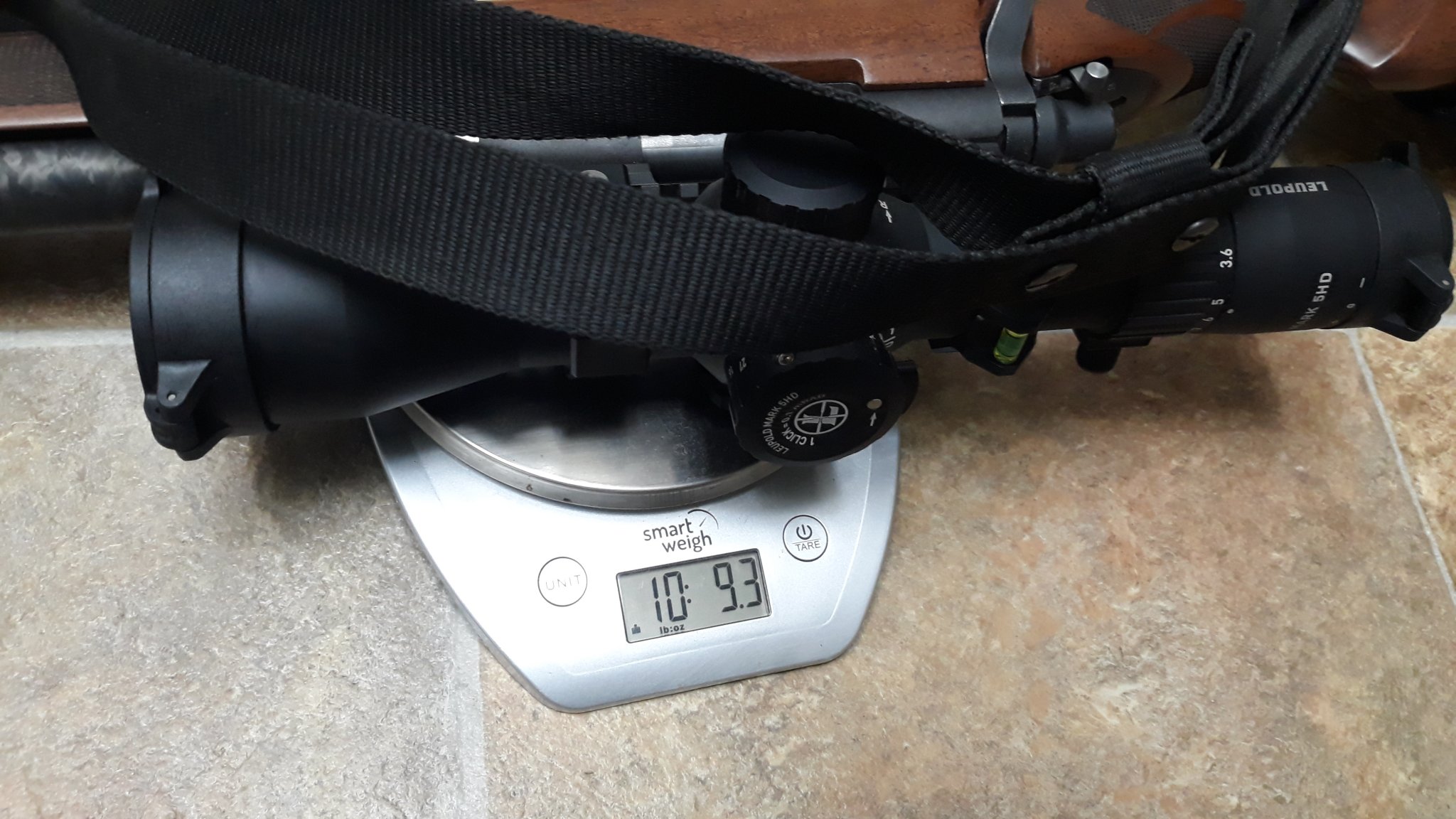

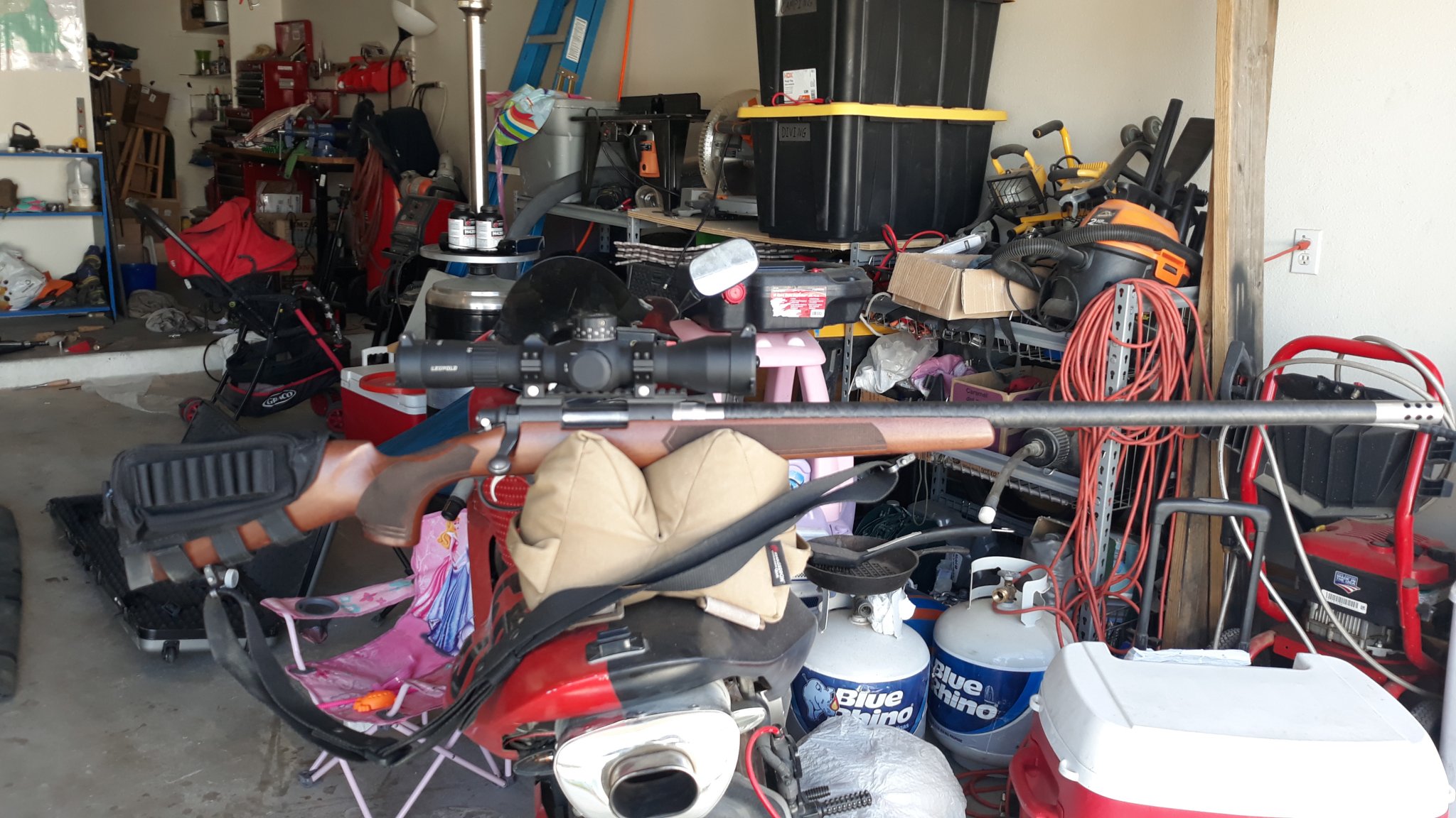

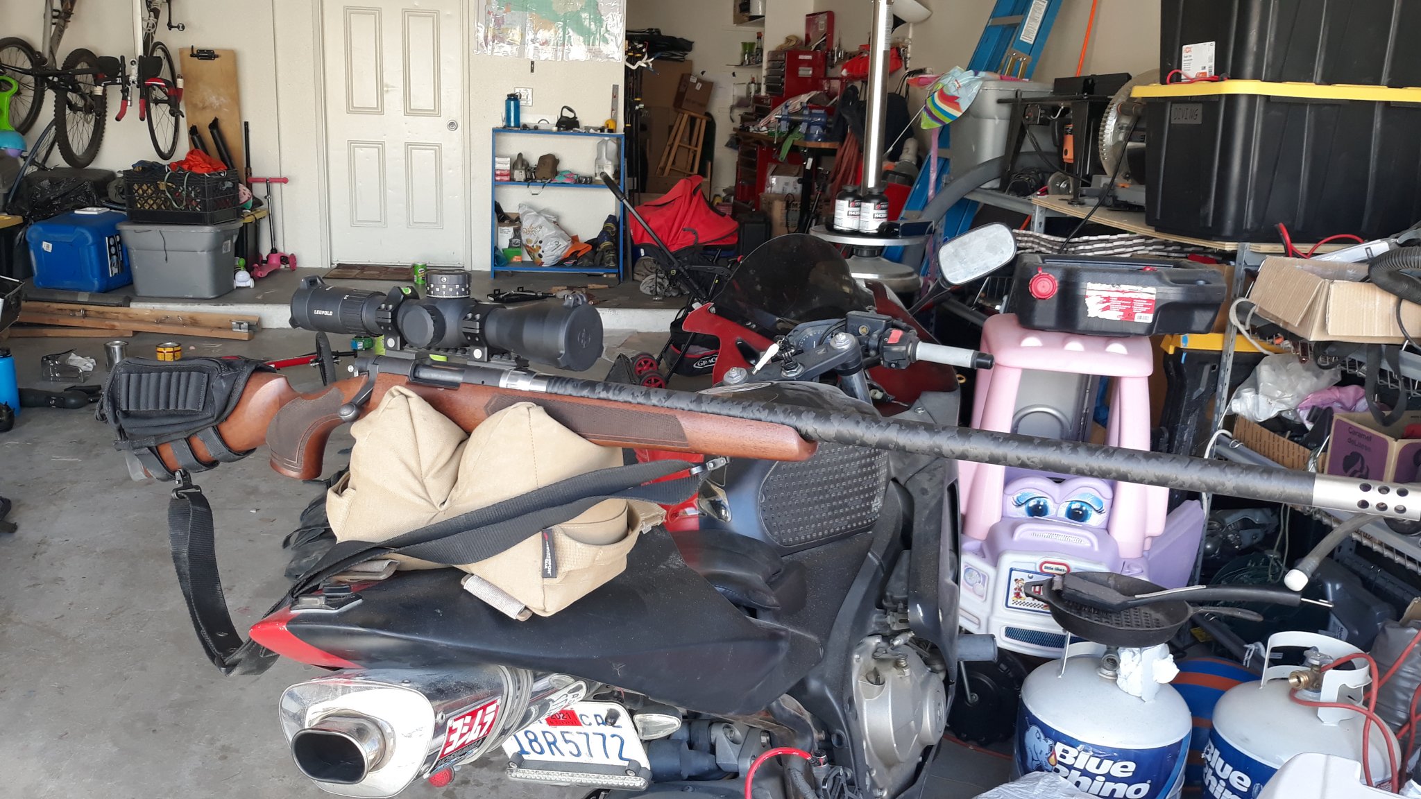

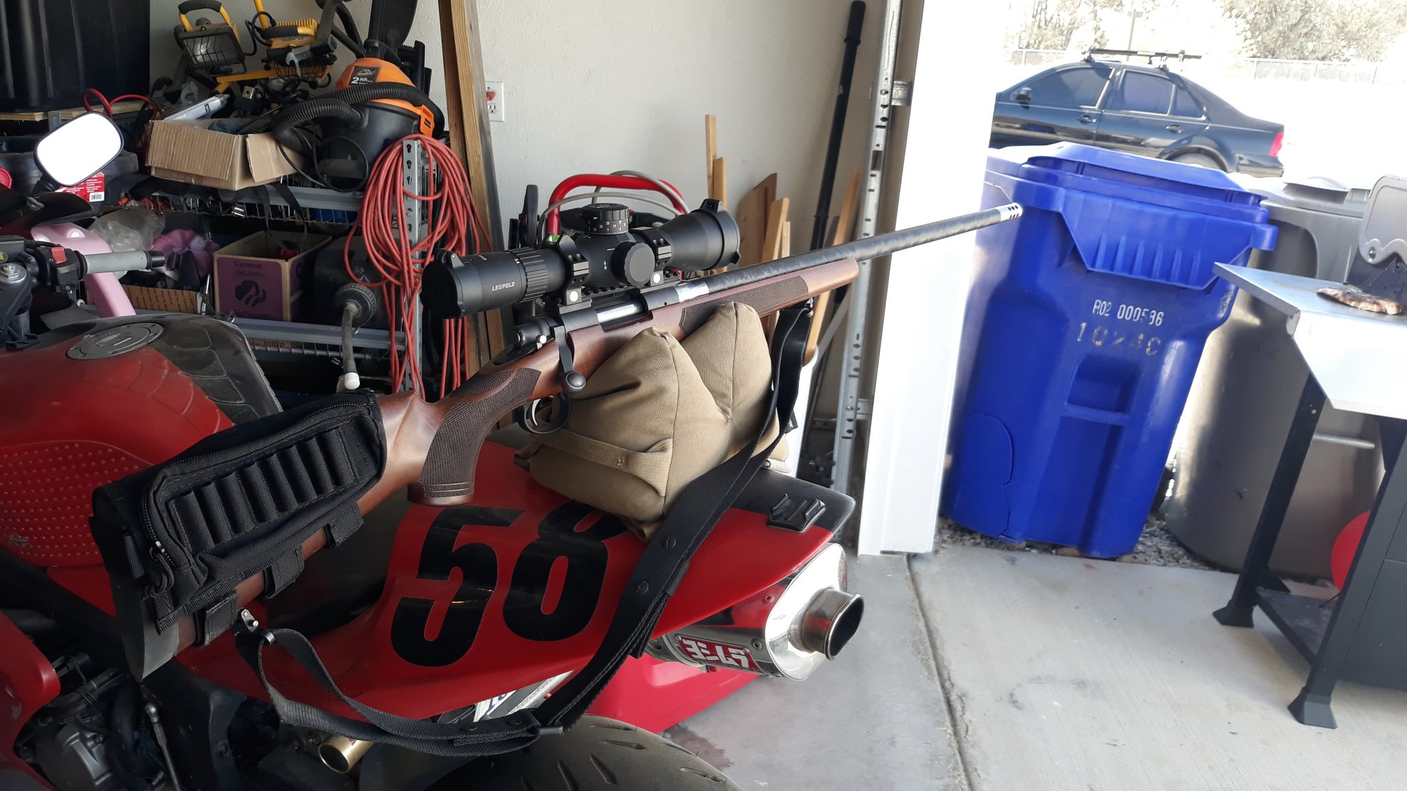

Finally finished this build off. Got a monte carlo stock from stockys and had to immediately modify the bedding block to fit an oversized recoil lug and had to take out a shit ton of the barrel channel to even start to fit the barrel, floated the barrel and it shoots pretty good. 5 round group with the first 3 being like .25 almost wished I stopped at 3 shots
Super stoked at how nice this thing turned out
Looked for a long time for reviews or any feedback on the stockys wood stocks with the bedding blocks and although it was a lot of work to get it to work right I'm happy with it so far. Hope this helps someone else in the future make a decision.
Good looking rifle and decent group. There’s always a flyer or something to mess up a one hole group. I’ve had to fiddle with fitting a stock and it’s a pain. I just buy take off HS precision stocks now. They’re usually about $200 on eBay and are great stocks. Enjoy your tac driver👍
