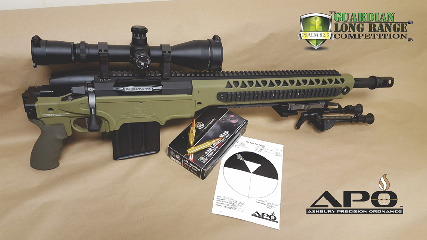

    I searched and toiled over the chassis. I was 100% set on a used AX (remember I'm cheap)but nothing was coming up. Then I came across a used Ashbury precision chassis here and almost bought it but it was silver and I really wanted FDE. The more I looked at the APO chassis the more it grew on me. I got with APO and they had a sale going on that I couldn't refuse. Their rep even let me swap rail colors to get it exactly how I wanted it. It will be FDE with black rails and 10 round CIP length mag. Once I ordered I searched to see if I could find a pic of this color combo and found an image that I think was from a hide raffle. This thing is freaking beautiful! I encourage anyone looking for a chassis to check these out. There were a few hiccups in the price/ordering process and APO went above and beyond to make it right. Thank you David Myles!

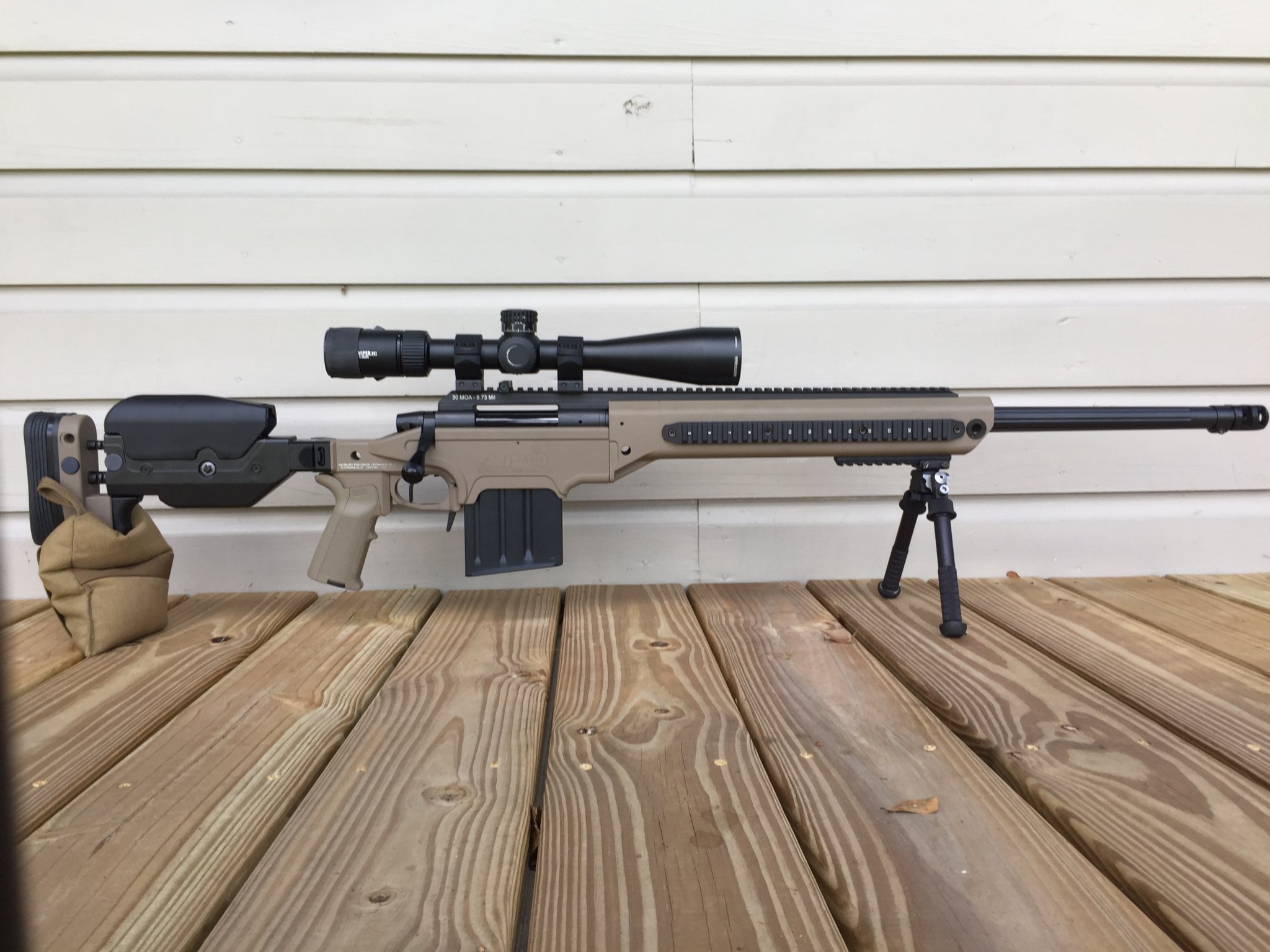

    Got it out today to warm the barrel up and make sure everything was gtg. Had a little issue with the extractor but after talking with RWS we suspected the ejector spring may have been a little stout. Clipped about 1/8 of an inch off of it and it was smooth sailing after that. Guessing the PTG drilled hole for the ejector was a little shallow or the spring was just too stiff. It took a ton of force to depress it whatever it was.
    The rifle did really well, especially for just shooting some light loads to break the barrel in a little. The heaviest load I shot was 84 gr of Retumbo with ELD 225 and I was getting around 2850 FPS. That is promising considering that it should speed up as it breaks in and I can hopefully go up another 2-3 grains. Three shot groups were probably .75 which is dang good considering I was a little rushed and also doing some cleaning between groups. I def wasn't putting a lot of effort into accuracy. Hoping to get back out tomorrow and push it a little and see how good it will shoot. Side note, I was very curious of what the recoil would be like on this. The badger mini FTE seriously makes it feel like a stout .223. It def moves a lot less than my unbraked 6.5.

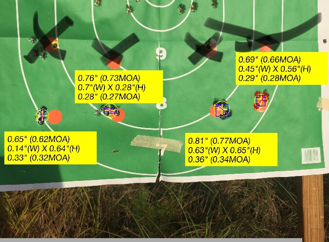

    So far 92.5G of RL33 and 230 Hybrid Targets have shot pretty well. The rifle is def shooting better than me which is good to know because I feel like the recoil is forcing me to get better as a shooter. I’m getting 3020 FPS from a 26” barrel. That’s faster than I was expecting.
    2nd outing testing the middle node.
    Back to play with seating depth at 200 yds. I read where frank was talking about it being easier to shoot larger magnums at 200 than at 100, it is definitely easier to shoot this gun at 200. Two shots thrown out as they were obvious misses by me, not the load. I am getting a lot of horizontal when I am not square on the rifle or if I flinch a little. I’m def not quite there yet technique-wise with it but the fact that it shot well despite that fact is promising!
