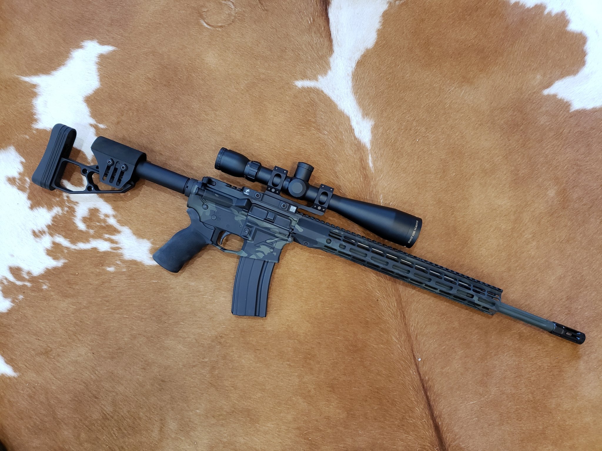

    I put a Grendel together a few months ago as a half range / half hog gun that will occasionally see some thermal work (whenever I can get Sellmark to fix my Thermion...I digress).
    Rifle is an Aero receiver kit with Aero LPK. Trigger is a Larue MBT-2S. Barrel, BCG, and the rest of the upper components are all Wilson Combat...save for the CMMG SV brake I out on there since I took a photo of this rig. Barrel length is 20 inches.

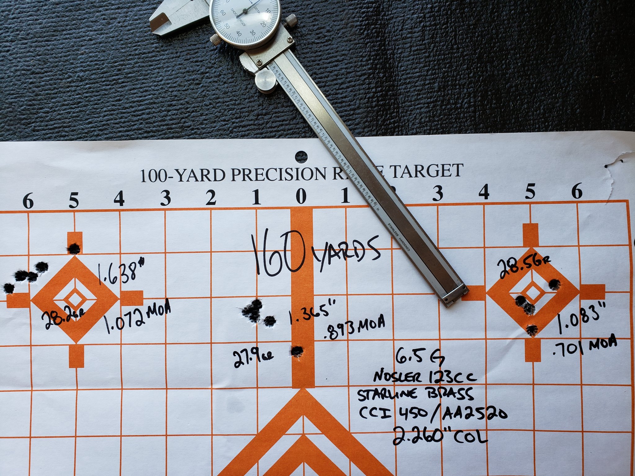

    Shot 10 rounds for break in with a middle of the road handload. 1-2 sighted in and cleaned, 3-5 initial group (MOA) and cleaned, 6-10 group (MOA again) and cleaned.
    Shot it today at my 160 yard range (my back shop door to my pond berm). Yes, it's an unusual distance, but the math isn't too hard (watch, I screwed it up). Anyway, the first group was GTG with a cold bore a little far away, but still sub MOA. Group two barely above MOA, and the third group was pretty decent with just a hint of ejector swipe in 85 degree weather.
    I'm not going to screw with it too much now. I'll retest the two best loads and then start playing with some of the Speer Gold Dots and SSTs that I have on hand to get a decent hog load.
    Have same barrel, and it took about 75 rounds or so for it to truly shoot in. Have has excellent results with AR Comp and 123CC’s and 123 Sierra BTHP. 8208 and CFE work quite well also. Would be helpful to know your velocities vs POI for groups you’ve shown. Look for your barrel to continue to improve.
    Reactions: diggler1833
    Somehow I ended up with 16lbs of TAC and another 8lbs of 8208 XBR (and I still have 10lbs of CFE 223. I like the potential velocity with some of these ball powders like the AA2520 for hunting as my primary hog rig is a 6.8. Obviously the 8208 isn't a ball powder.
    I'll probably try some of the extruded powders when I start shooting the match bullets again. I've only got two boxes of Nosler CC, so I might try some of Hornady 's stuff. I am done with the SMKs...their meplats are all over the place. I have had .017" OAL variation in my last box of 69gr. Not as horrible if loading for a bolt gun, but for mag length loading in an AR its completely unsat.
    Totally get the issue with BTO variation-have seen up to .024 in Nosler CC seconds, so either sort ‘em or avoid ‘em. Have been working off of same lot Of 2000 123 Sierras and have not had any issue. You’re GTG with Tac and CFE. CFE seems to work best near its upper working range, and have gotten 2650 in a 24” Satern barrel with VG accuracy in summer heat, but approach cautiously. 2550 same load in 20” Satern.
    Am keeping most of my WC 20” loads right around 2500 with VG accuracy using AR Comp in low 27ish range.
