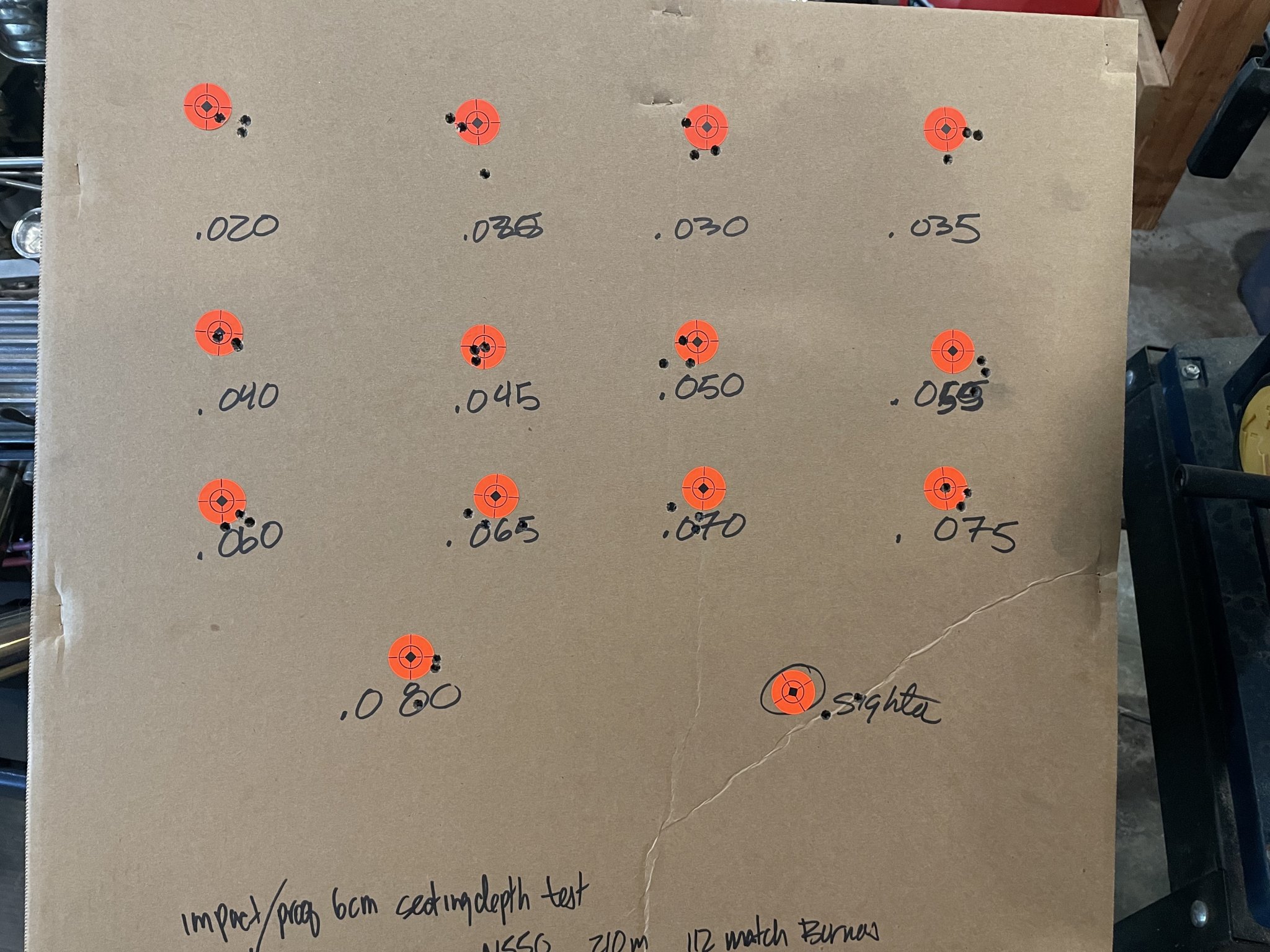

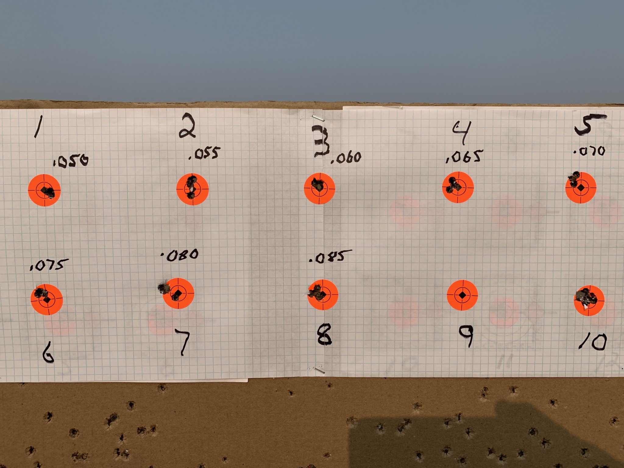

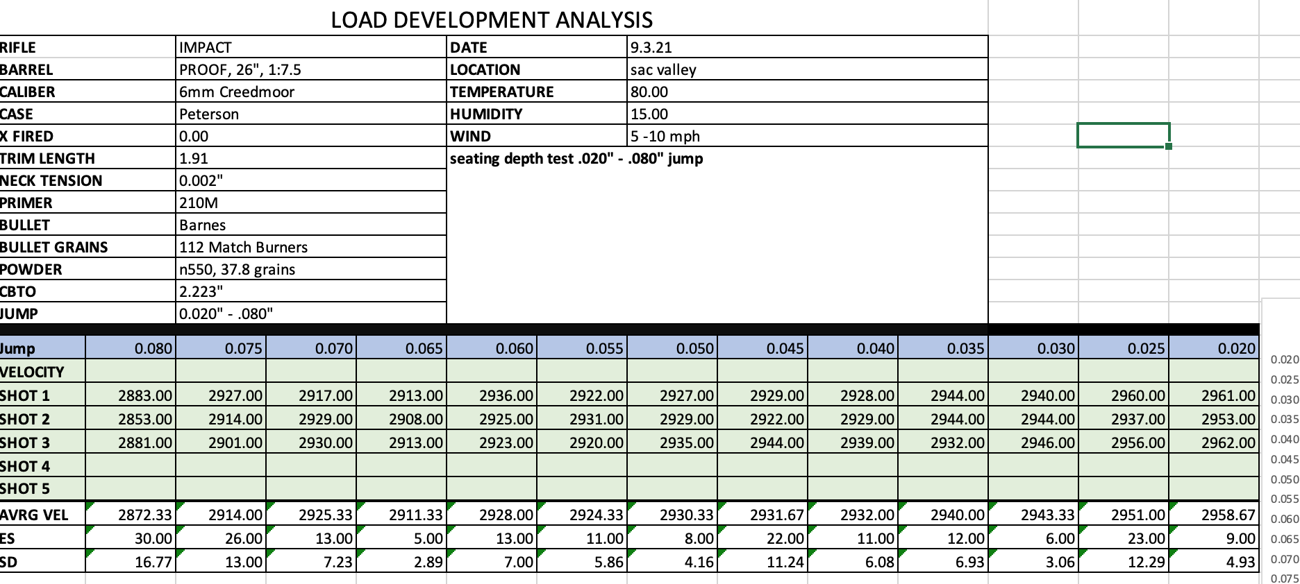

Thanks for the replies gents. What's a good seating depth interval to test? I did the velocity test seated .020 out.
Well, .020" off the lands has been the ubiquitous defacto standard since the beginning of time... that said, times change, and depending on what you're shooting and what style of shooting you do, you can get more adventurous if you want and go with a bigger jump...

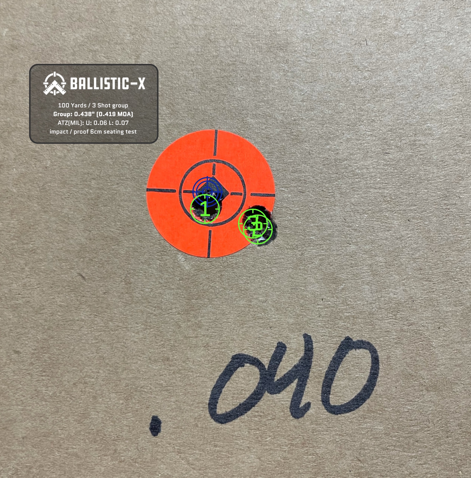

For me, shooting 6mm creedmoor and for PRS-style shooting, I jump like a MF'er since I spend most of my time shooting 600+ yards and don't want what groups look like at 100 influencing my decisions too much (especially since most of the time a bad group has more to do with the a-hole pulling the trigger than the load). But, I could give a shit about examining groups at 100, I want "baseball or less" at 600... for the life of the barrel if I can get it.
Currently I'm jumping ~.100" with 112gr Match Burners and have done the same with thousands of DTAC's... my rifles shoot pretty much the same from 200ish rounds on 'em until they're dead and I mostly don't have to adjust a damn thing until it's dead. I also get a lot more barrel life than you used to typically hear of with 6creed: running "slow" Dasher-ish speeds with a healthy jump I'm getting 2000+rds easy (I took my last barrel off at 2300rds to spin a new barrel on since I was selling that old rifle to a buddy, and I was actually kind of bummed taking off the old barrel because it was still .5moa at 100 and .5moa 1000... I was hoping to find out how long it'd go...).
I don't even test any closer than .060" anymore.

Thanks for the advice fellas. I just loaded a seating depth test:
6 CM Peterson cases (unfired), 112 Match Burners, 37.8 gr. N550, 210M primers
loaded 3 rounds each in .005” increments from .020”-.080” jump.
My target velocity is 2975- 3025 FPS.
my biggest trepidation on this test is the unfired brass on a barrel with only 60 rounds on it. I’m worried about chasing my tail as case volume expands etc. I’m hoping all variables will achieve an equilibrium of sorts with the barrel speeding up whilst the case volume increases. My experience is limited but I’m sure I’ll learn something regardless
I’ll share results as soon as I am able to carve out some range time.

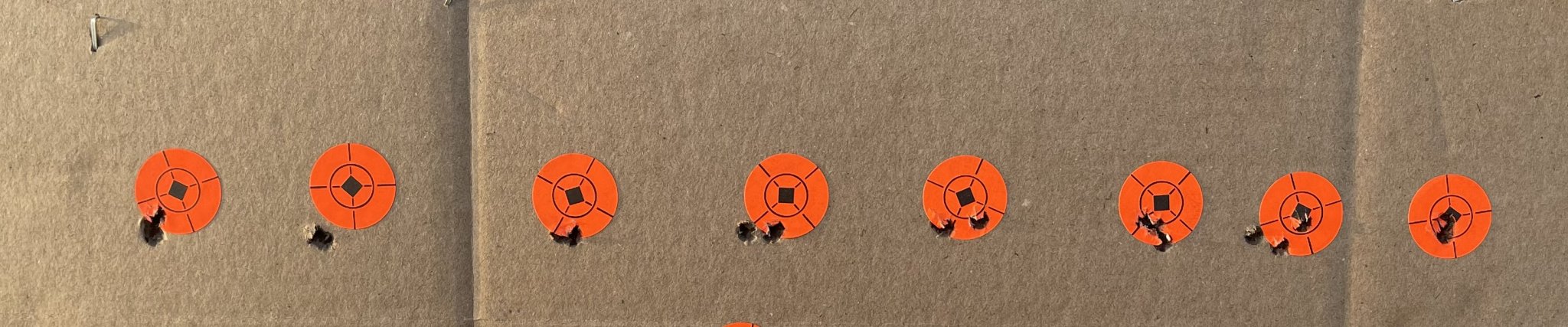

Alright fellas, I just returned from the range. I'm not the greatest shot combined with some mirage and switchy winds, I don't feel I shot that well today, but here are the results.
6 creedmoor
new Peterson brass
37.8 g N550
112 Match burners
210M primers
26" Proof barrel with 60 rounds on it at the beginning of the test
I am interpreting .040" & .045" jumps being the besrt as they were significantly tighter and the impacts were at POI. ).040" is the tightest group, but .045" seems to be consistent. would you load long and go with .040 to account for throat erosion? My SDs were pretty good (I know, 3 shot groups) across all seating depths. I'm hitting 2930, a little slower than my target but I anticipate the barrel speeding up.
How do you guys read these results?
Thanks for the knowledge and advice.
6 creedmoor
new Peterson brass
37.8 g N550
112 Match burners
210M primers
do not take this wrong but i have to ask....how long have you been shooting?
first looking at the target you posted i see either a lot of shooter error or your gun does not like that combo you are running.
second IMHO unless your shooting the same combo from the same brand/reamer/smith ECT barrel you had prior to this barrel then starting load development before having a 100ish rounds through it is almost a waste of time because when it speeds up everything is going to change.
N550 is a double base powder which personally i would only use if the choices were use a double base powder or dont shoot...ive shot a lot of double base powders over the years and do not like them because of the temp issues and you being in Sac you see the big temp swings from morning to afternoon...we have the same swings here in nevada.
you have equal amounts of H4350 and N550 correct? put the N550 away for now and run the 4530....the rifle gods themselves developed H4350 and RL-16 for the 308 based 6mm and 6.5mm cartridges your going to piss them off running that N550 LOL!!
this is what i would do now that you are closer or at 100 rounds...clean the barrel and load a few foulers to start your testing off....4350..210M..112MB .050 off 1 round each and pick a velocity from 2850ish to 2930ish then run another seating test from .040 to .070 at .010 increments so 40-50-60-70 off.
now to make this even simpler and faster buy a lee hand press and take it your seating die and calipers to the range and do the seating test right there....find your velocity fisrt as i mention above then load up 50-60-100 or how ever many rounds you want at what ever seating depth you decide to start with then shoot 3 round groups and seat each set back .010 at a time then when you find a good load shoot it at 3-4-500yds and adjust as you see fit.

Here is one of many, many targets I have across different chamberings/rifles. This one happens to be across 2 full grains of varget. You can also ping @Ledzep for some pretty long term data which hasn’t uncovered anything that doesn’t fall in line with basic velocity math and such.
Reactions: CK1.0
Across 0.010” seating depth with acceptable accuracy for PRS standards across all 3 groups with negligible POI shift across the groups.
I’d choose a 1.775” CBTO seating depth and likely shoot this for the life of the barrel.
