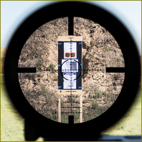

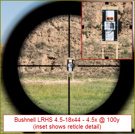

I would also recommend the Bushy LRHSi/LRTSi 4.5-18x44, I know it's slightly above your 4x request but does have a pretty generous FOV. Not sure how the price would translate but call up Tract and ask Jon about the Toric 4-20x50. I found the Toric to be every bit as good optically as the LRHS/LRTS series from Bushnell which is impressive for its price. I highly recommend the Toric, great company and great optic, if you call Jon and ask about sales, they are usually discounting them around the holidays... Veterans Day and Black Friday/Thanksgiving coming up is probably a safe bet they'll have some great deals.
You can read my review from last year - http://opticsthoughts.com/?p=2354
Reactions: drewdude and Schaaf
Thank you for that, great review btw, seemed honest. As far as the eyebox goes and the depth of field, I hate having to hunt for eye relief, I used my uncles hunting rifle the other day and it’s a Zeiss Terra Ed 4-12.... it had a terrible eyebox. I also dislike having to play around with parallax and focus trying to get an optimal depth of field... you mention for a short scope it’s great... but is it really great for a long scope too? I hear the Nikon fx1000 has a great eyebox, I just don’t like that the turrets don’t lock. The tract seems to tick off everything I’m primarily looking for though... well done

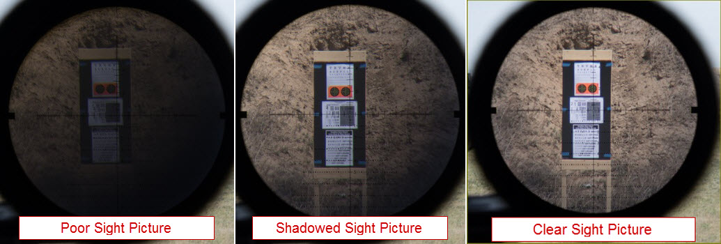

Your perception of the forgiveness of the eyebox has MUCH, MUCH more to do with whether the rifle is set up properly than how forgiving the eyebox actually is. I would spend less time chasing an optic with a forgiving eyebox than I would trying to buy a stock pack or a stock with an adjustable cheek and set it up so that when you shoulder the rifle, your eye just falls perfectly in the right spot. Then you'll forget that eyebox was ever a concern.

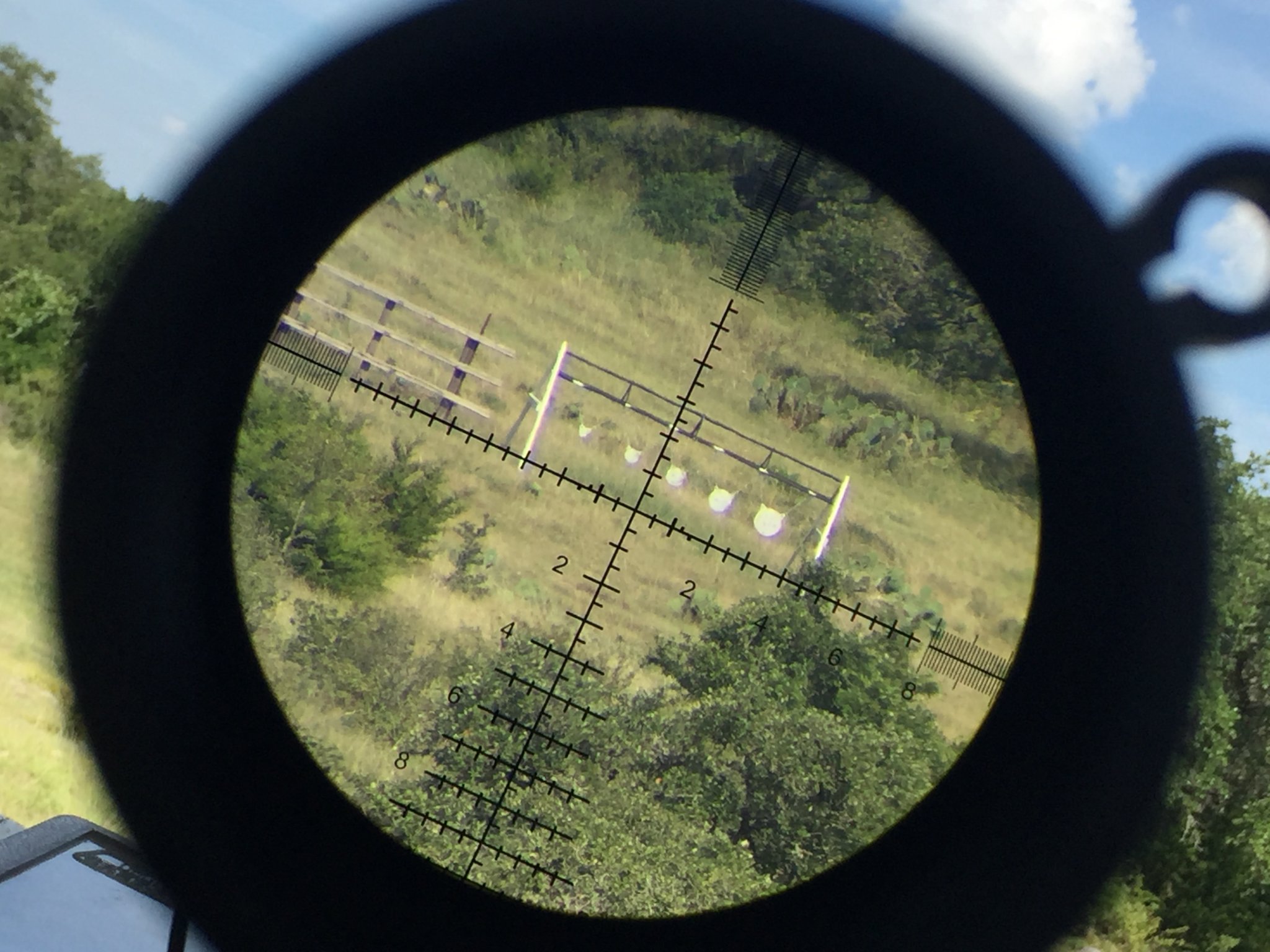

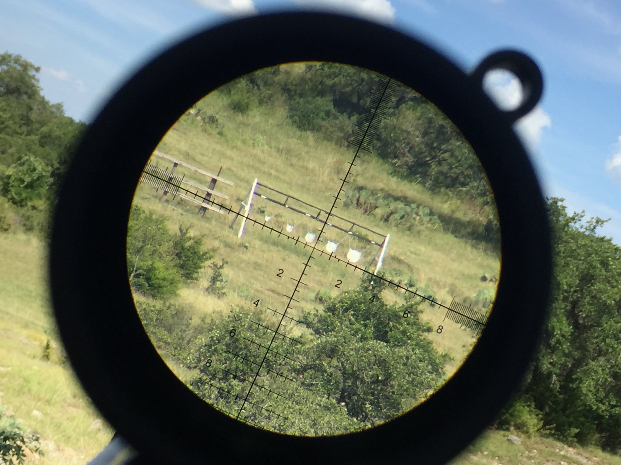

Let me see if I can find my example from a few months back of the G3 reticles on my phone real quick. At 18x and not 4.5x so low end appearance isnt represented but its what I got and what I can share.

Let me see if I can find my example from a few months back on my phone real quick. At 18x and not 4.5x so low end appearance isnt represented but its what I got and what I can share.

Here was my LRHSi 4.5-18x44 at 18x and also at 4.5x, I agree with Nacho (Spife) above as well. The LRTS/LRHS is a LOW design and most of their designs end up being top performers in their class. Here's some pics of the reticles from my LRHSi with G2H reticle which I regret selling!
Reactions: Bender
Thank you guys for the pictures! Got to do a little more research on the LRHSi and it seems like exactly what I’m looking for except after extensive searching I cannot find any available in Canada below 2000 CAD (not including 15% sales tax). That’s a bit steep for me. I did notice in my research a delta optics titanium 3-24x56 MRAD but SFP with capped turrets and decent illuminated reticle. I would consider SFP in a scope like that, I could work target at 24x, game at 12x and 3x to make the measurements manageable. I just haven’t heard you guys mention it... I could get it for 1000 usd price. The only thing I’m not to keen on about it is that it is not really well spoke about on here and it only has a 10 year warranty.
