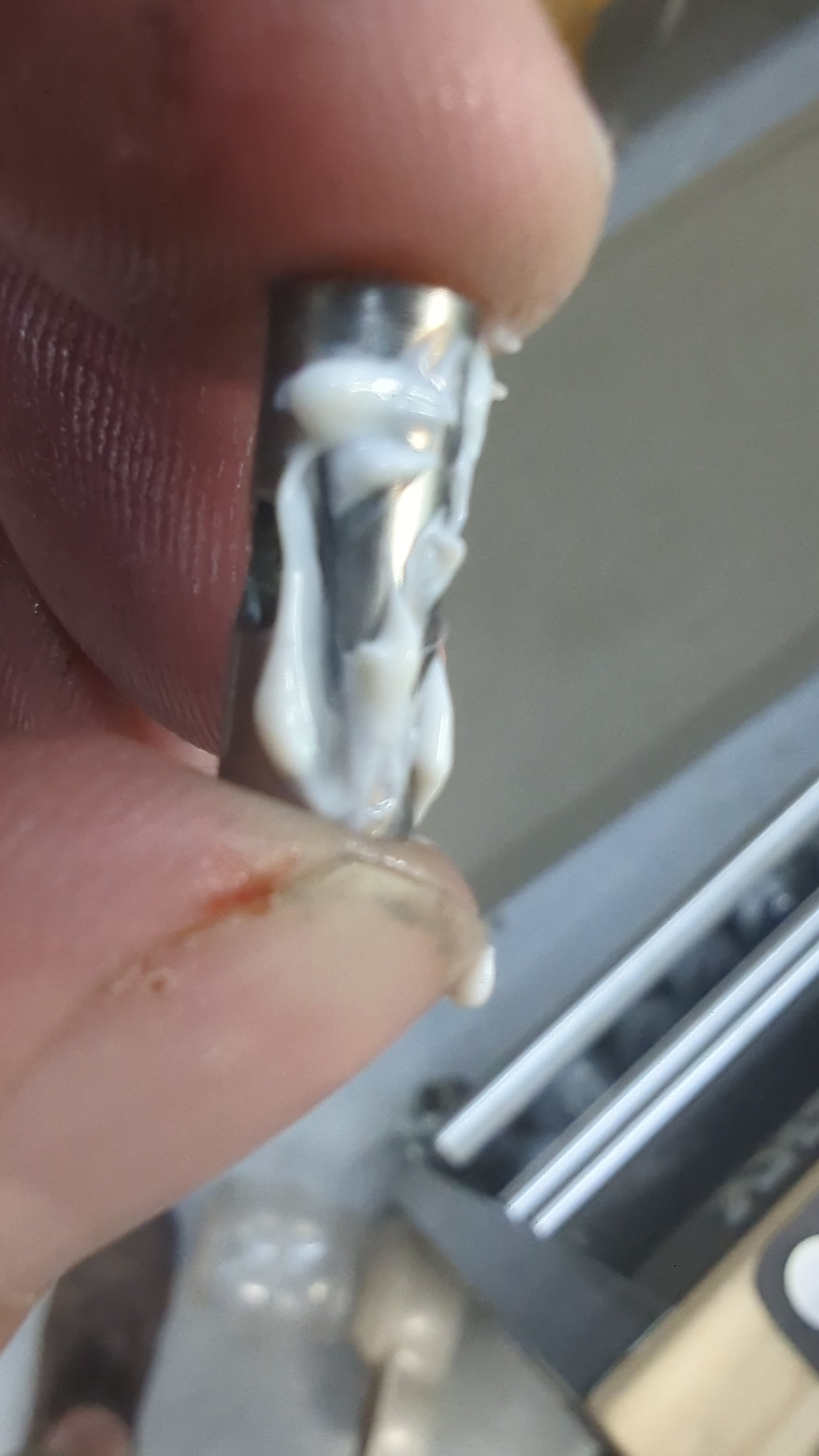

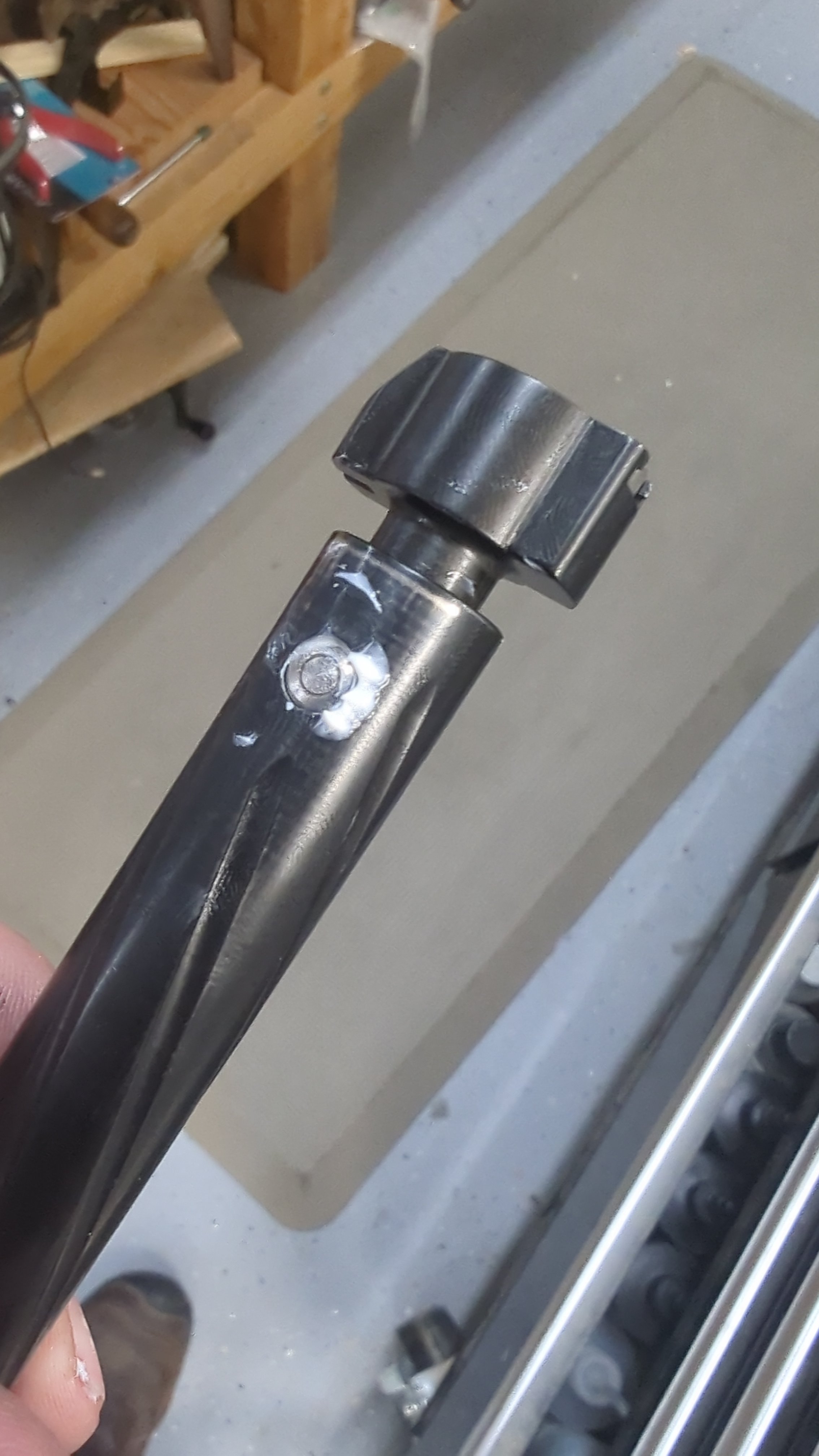

Okay, I went out and played around with this a bit, and jogged my memory.
Take the wave washer out from behind the bolt head. Take the spacer / baffle out too, otherwise it'll rotate independent of the head, and cause all kinds of grief.
Yes, the toggle pin / cross bolt will then be loose, and prone to falling out now that it's no longer under tension. Not a new problem; Savage shooters dealt with this years ago.
There are a couple of ways to handle it if it were a Savage, but they kinda hinge on some particular quirks of the Savage bolt that do not generally apply here. The one that does is pretty damn simple: put some grease on the toggle pin, and stick it back in the hole.
The more 'sticky' or 'tacky', the better. But even the mil-spec TW-25B stuff will work.
Video clips of two different Origins
Caveat - if you let the bolt drop too much, or if your grease isn't very tacky, then the toggle *might* try to come part-ways out over the mag well. Just reach up thru the well, push it back into place, and continue pulling the bolt to the rear. By the time you get to the bolt stop, it'll be safe.
