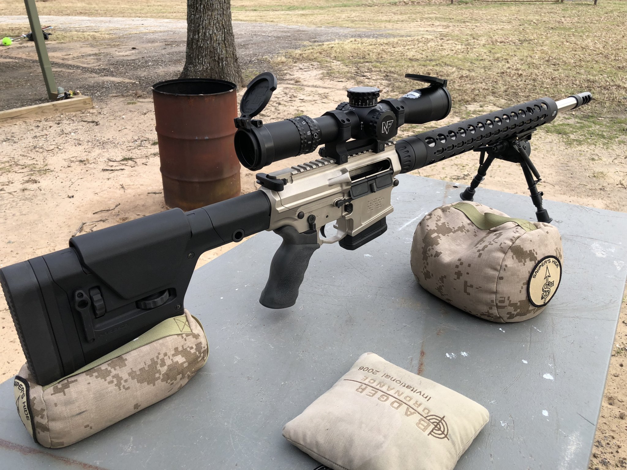

That is correct. I've played with all combinations of steel and tungsten weights and all springs. I run 1 tungsten and the yellow spring with LMOS carrier and brass has no damage and super soft shooting.
So far so good. I’m after “sexy padom brass”... lovin my MEGA. Definitely don’t shoot it enough.

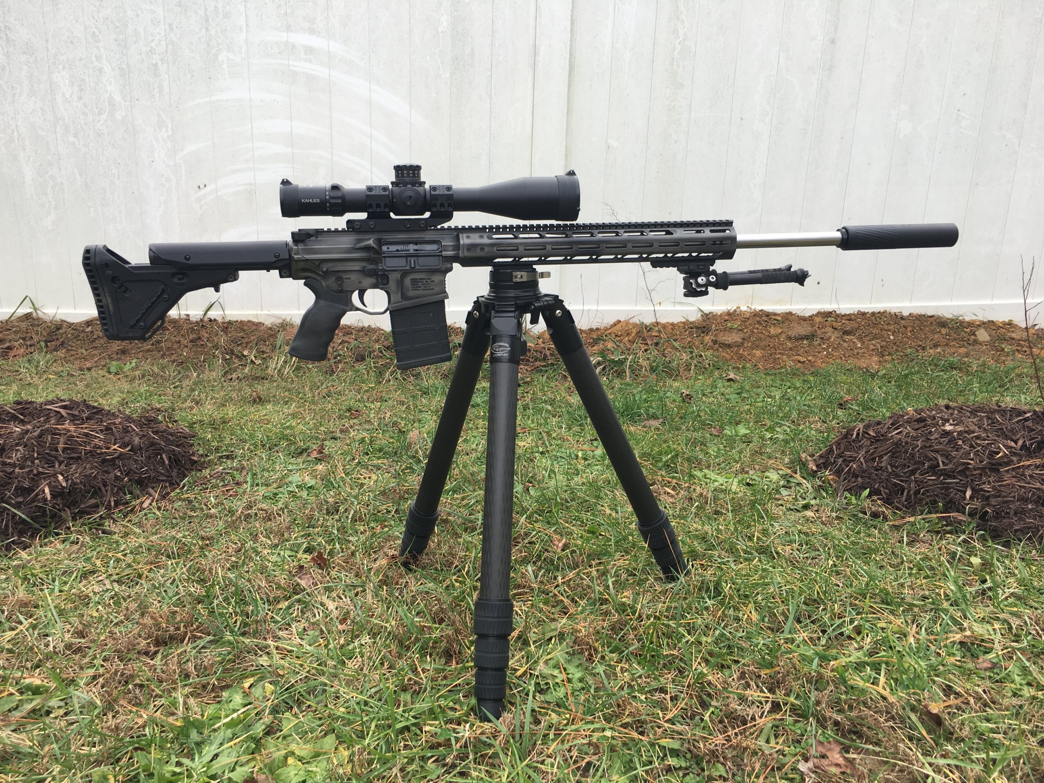

Can’t believe I missed this until now. I’m running ful JP internals on my 24” 6.5 (+2 Gas) and it runs beautifully. But I’m not above dicking around with it more for improvements. Tagging for later.
