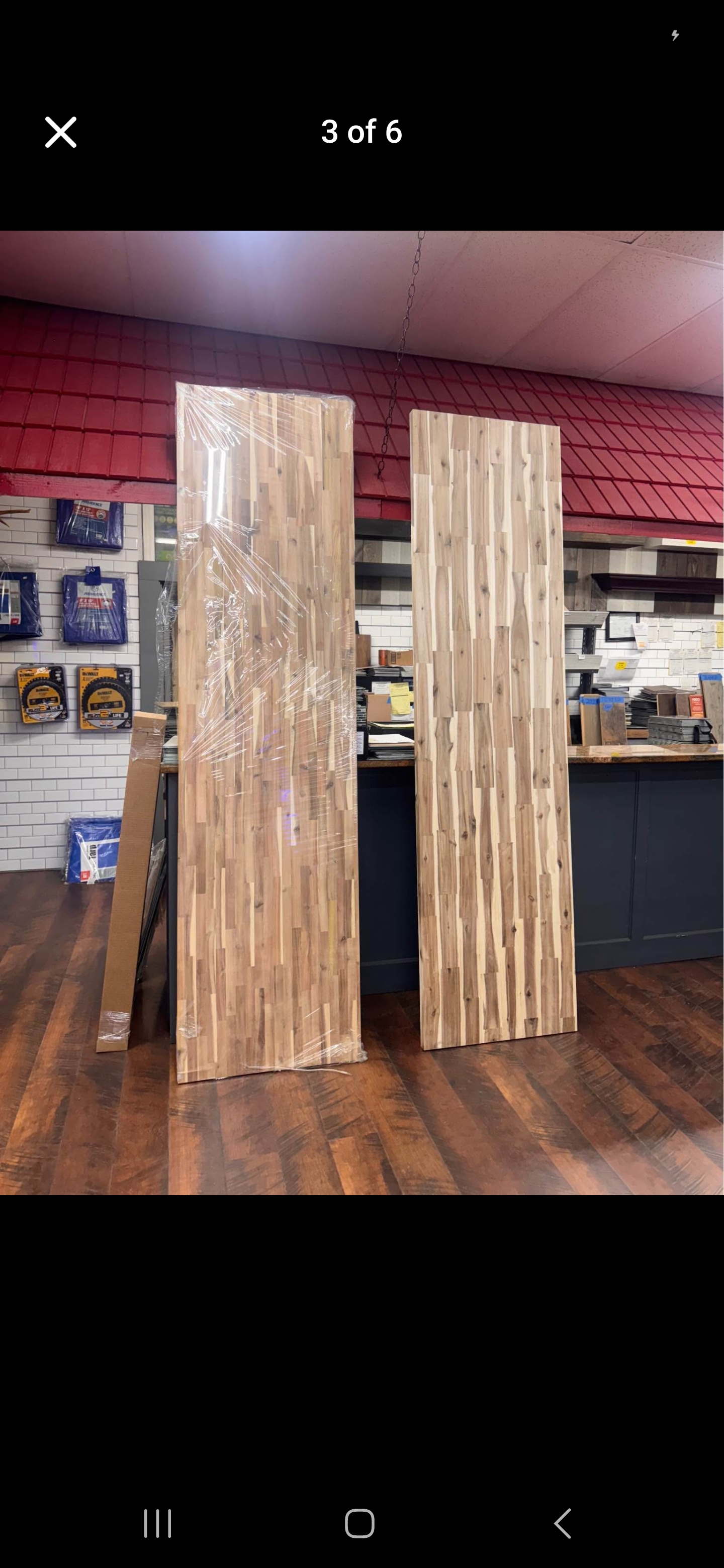

Hey guys , I moved a few years ago (to the humid south) and finally am getting around to building a new reloading/ work bench.
I have gotten a butcher block to be the top of my bench, but I'm not sure what I should finish or seal it with ? The block is unfinished so I will sand it and want to seal it with something that will withstand the humid climate.

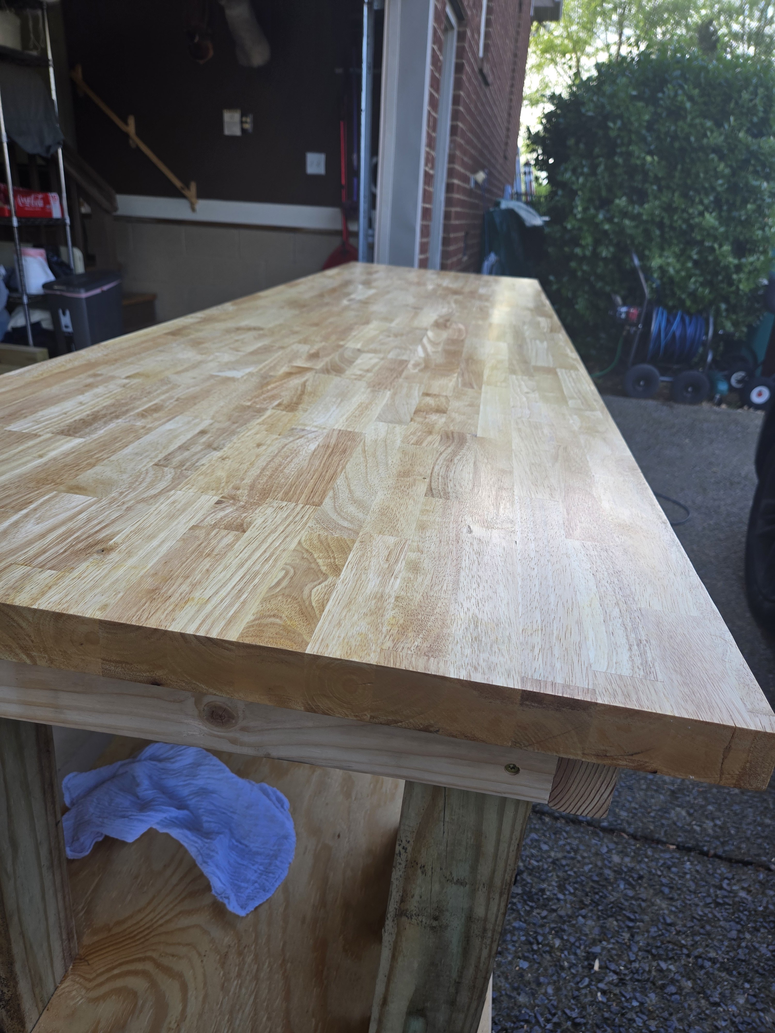

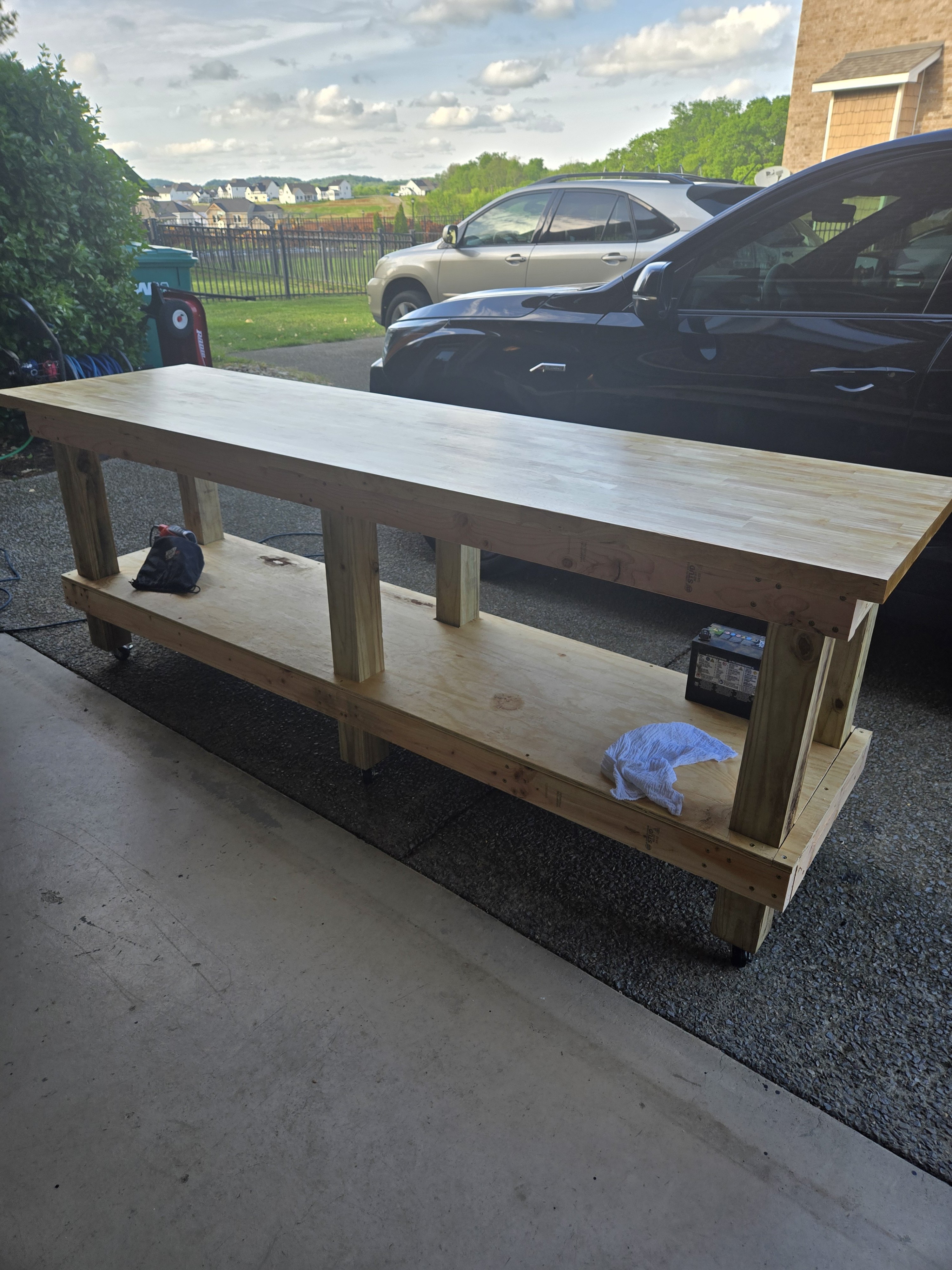

Finished the bench in the process of putting coat #3 of poly on it. Figured i would share some pics. This was my first attempt at building a bench (anything with wood really lol)
My carpenter skills are terrible ,but the bench is sturdy and it's level so I'm happy with how it turned out.
It's not even finished and you have it collecting junk. This is the way.

That looks solid and functional, I'd be happy with that.
Reactions: sgtsmmiii
Dam sun! That is a beautiful bench. I would have recommended poly, with a bunch of light coats, to resist oils n such. The other is 100% Tung oil with 5-6 coats. Tung oil is like a poly but polymerizes from within the wood. 🪵 My favorite.
